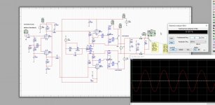

The problem with bass when go class D is supply bus pumping, special with low frequenties, so going full bridge is the way to go, for me it is just a interest, because world changes, I have hybrid tube mosfet amp as you have heard already the music form it on youtube, a new oe who have total no feedback except mosfet source follower itselfs, but mosfet has high gm so no problem.
I have also sim a circlotron with tubes and mosfets, I have a bunch of amps designs, most are combinations of kwown idea.s
picture 1 is circlotron with tube/power jfets 2 is a local feedback allfet amp both never build.
but offtopic, these are liniair amps.
regards
