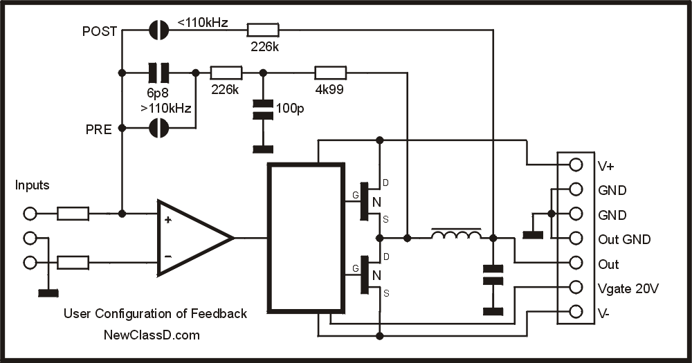

I see there a lot of investications about D amps, I had the idea when without feedback making digital a triangle signal because when it is precise and liniair the amp give the lowest distortion.

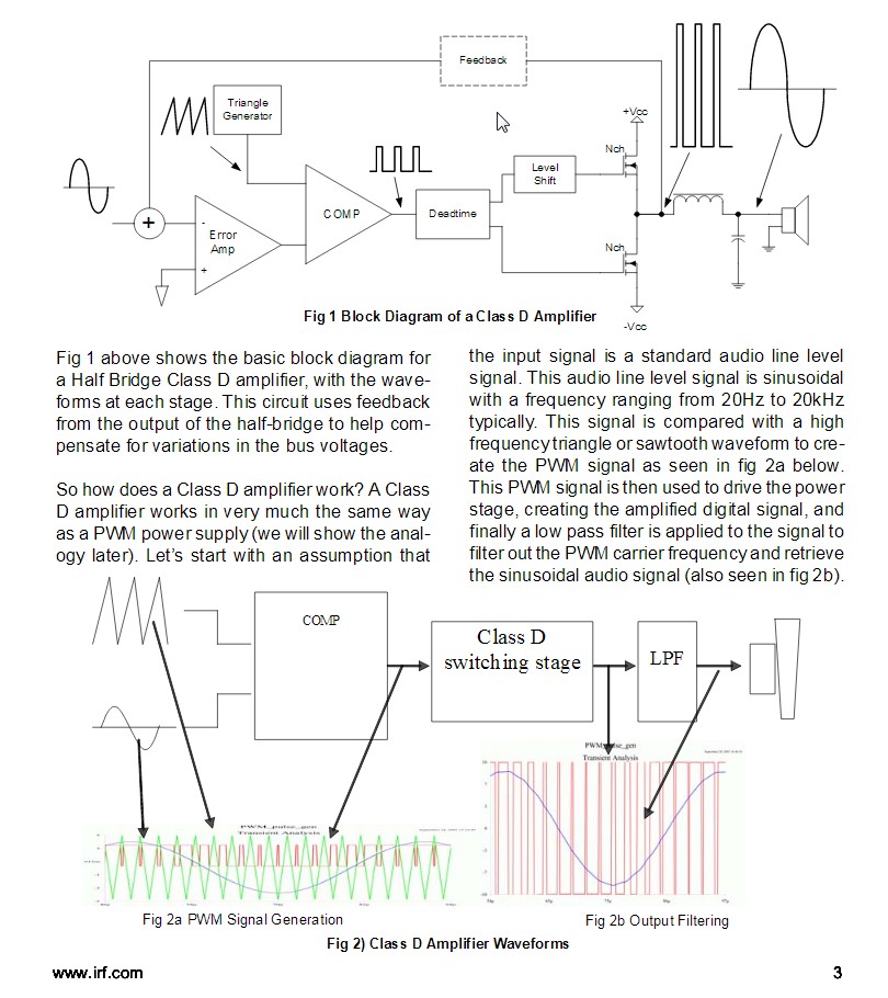

A triangle is used as input for modulation, this has to be a very presice signal because it has direct impact on liniarity. Making this digital with a pcocessor is maybe a way to get a low distortion class D amp, even without feedback. I have to say also that the death time is also a uge factor for distortion, use of a extreme fast mosfet is needed to get as less death time as possible.
In principle it is a digital amp, it is a power digital to analog converter with use of demodulation coil.

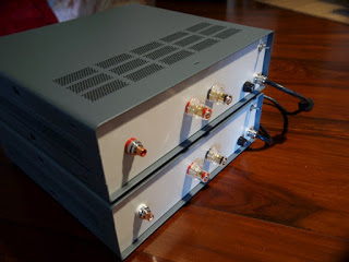

Here are some images of my latest Class D; a T3 150W Tripath monoblocks. The PS for each block is rated 420W and each module will deliver 300W into 4ohms and 150W into 8. The caps are Mundorf MLytic 2X 22,000uf, ultra low ESR audio grade.
More images.
I have tried tripath. This is the best sounding non UcD I have ever heard. Some people say this is like tube sound.

What you descirbe is how class-d amps would be made 20 years ago. Today class-d amps do NOT use at triangle generator.
Modern class-d amps are self oscillating build around a integrator (op-amp).
