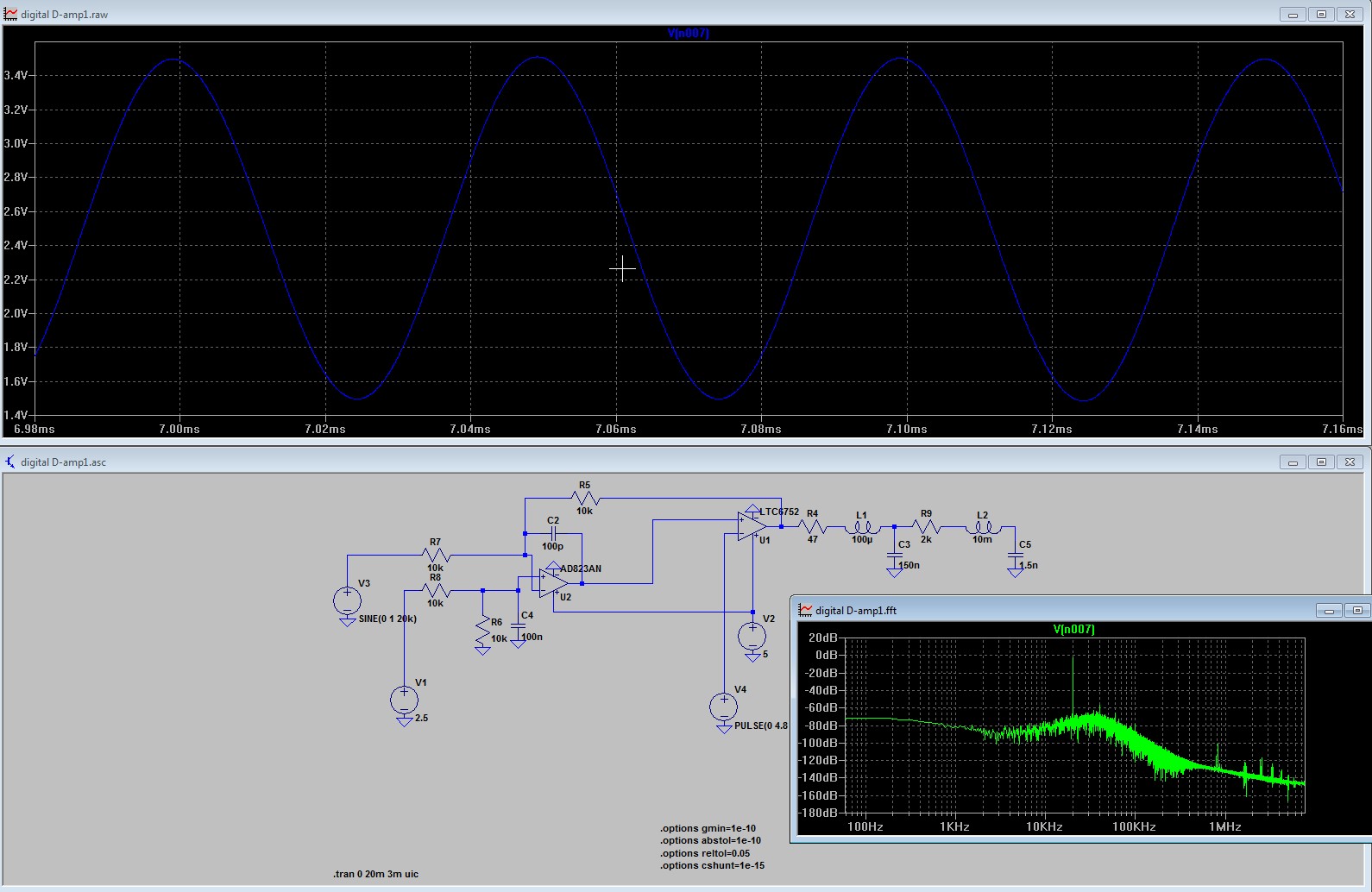

Using a opamp with very high slew rate can make a very good integrator making the amp more liniair, good quality pcb and parts, I am not busy with digital amps but read about she involve very well and people dare to compare with single ended tube amps.
Most trouble is not in modulation however but are in speed of mosfets and deathtime and demodulator coil.

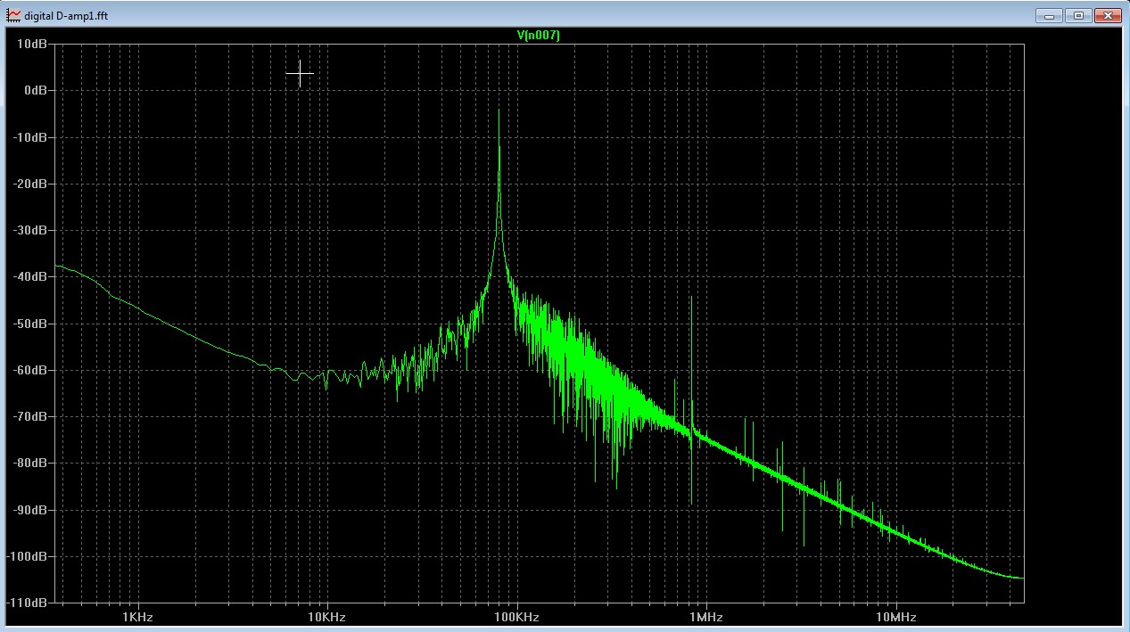

Wile my circlotron amp is under test I did burn mosfets with runaway) I was curious about the D amp and did sim a kind of modulator with very fast opamps (freq 800 khz), did give a nice sinusoidal back with this smal test schematic. Middle picture is 80 Khz demodualted test signal.

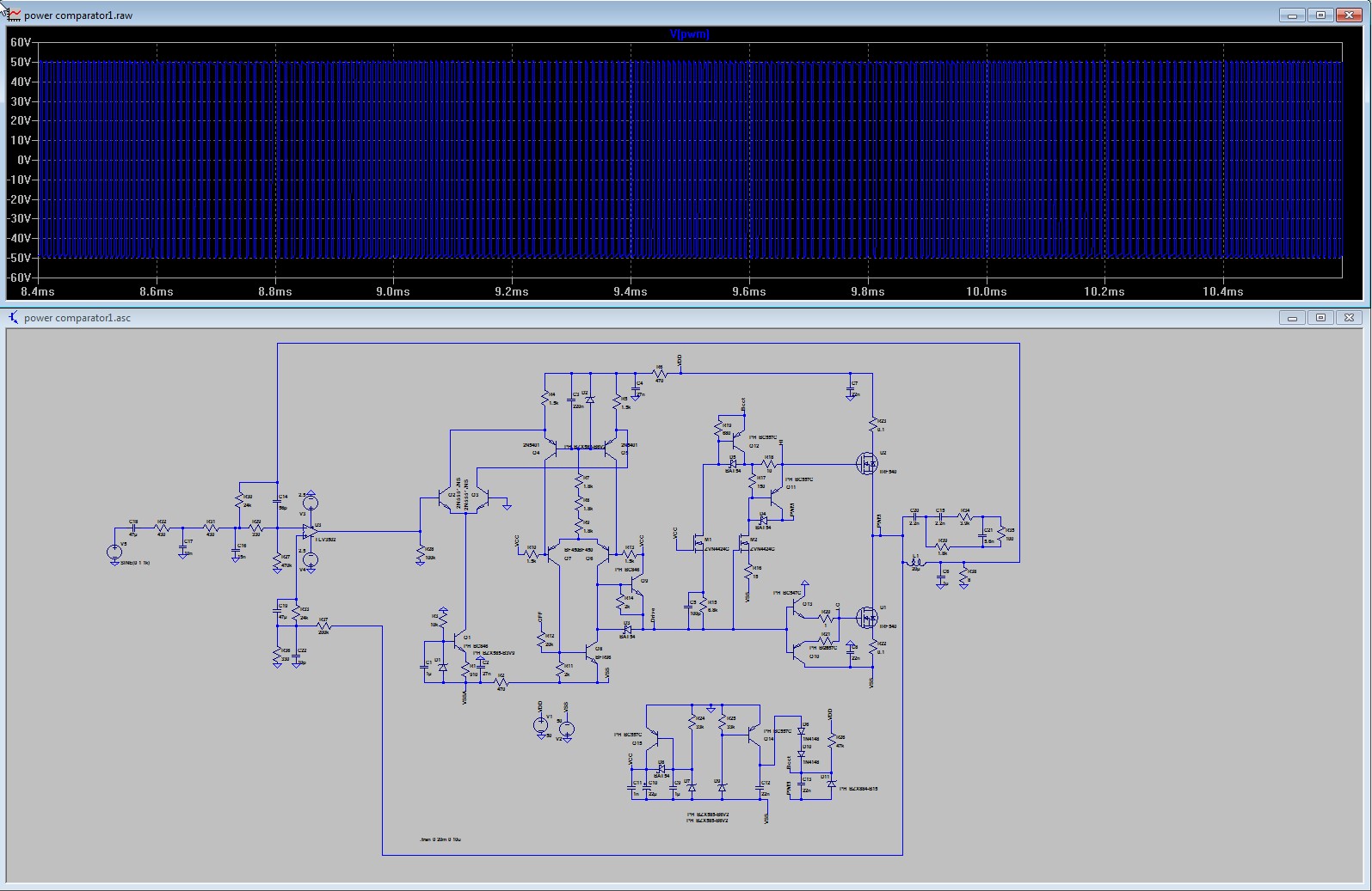

I was testing with some things and a power comparator, it is a lot of fun but after new year I get go on with the liniair circlotron.

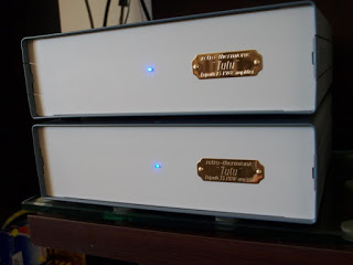

I may have mentioned that a pair of quad 63s tookout my hifimediy 150W T3 monoblocks. On receiving replacement T3 modules one fails after 5mins of use. After many emails to hifimediy they kindly sent three replacement modules.
My T3 monoblocks are now up and going and sounding as good as I remember them. Hifimediy are very helpful and I think their class D amp modules are the best. My T3s - "Tutu" are the best sounding Tripath class Ds I have made and heard and possibly the best amps I have heard anywhere. The Sanders Magtech may be better but I have not compared. Glad to have Tutu back.
I hear you ask "Tutu"? Well it is in answer to Bruno's Mola Mola brand name for his Kalugas. I wanted a double sounding name. Not only that there is two of them - Two Two.

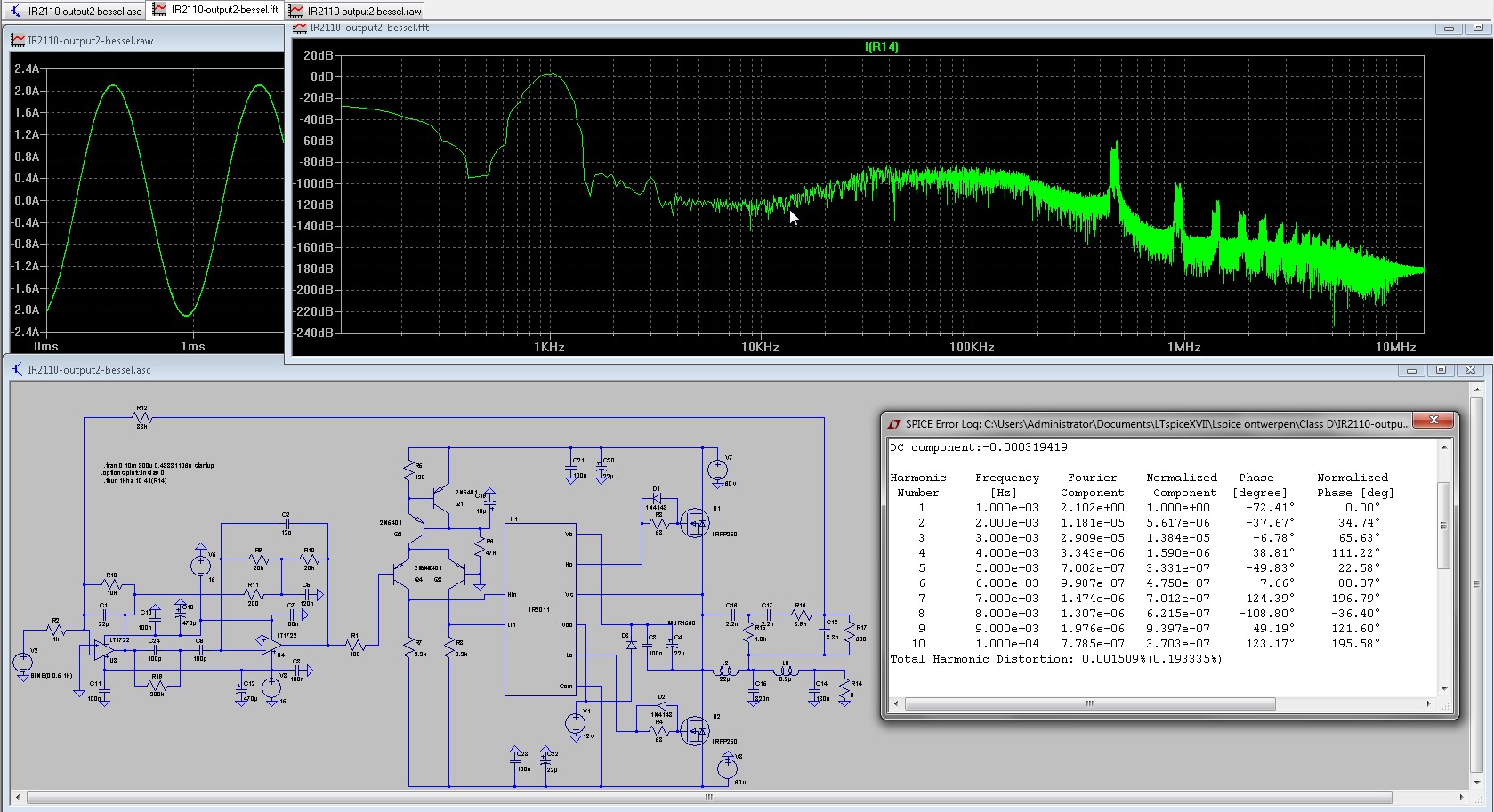

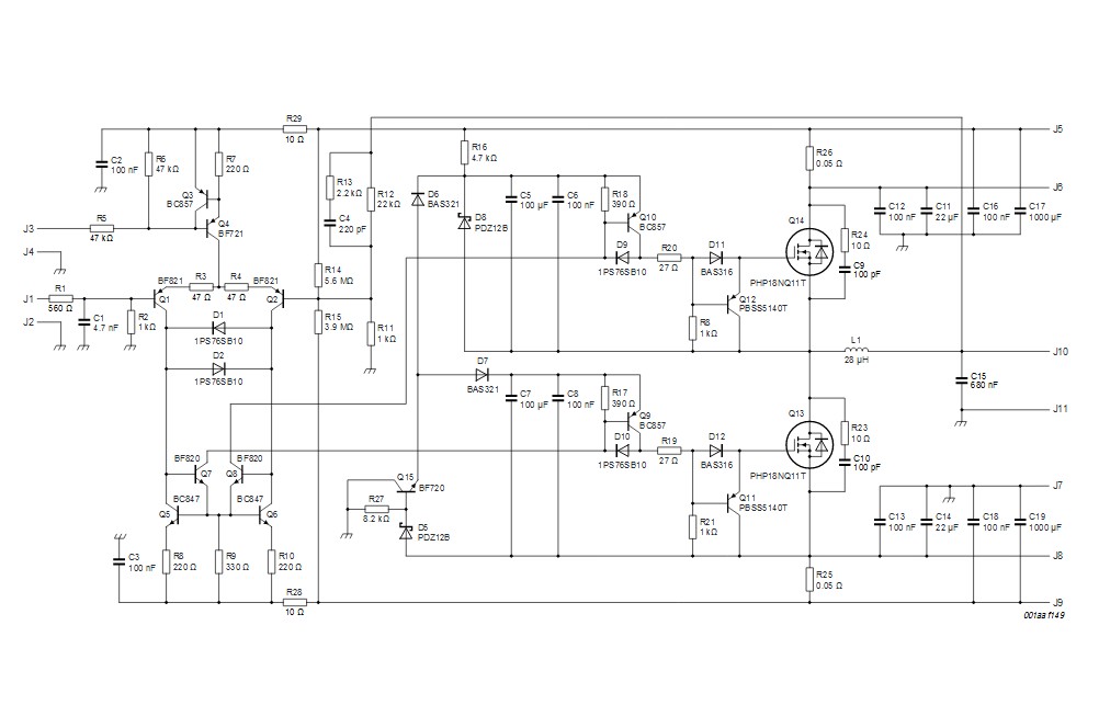

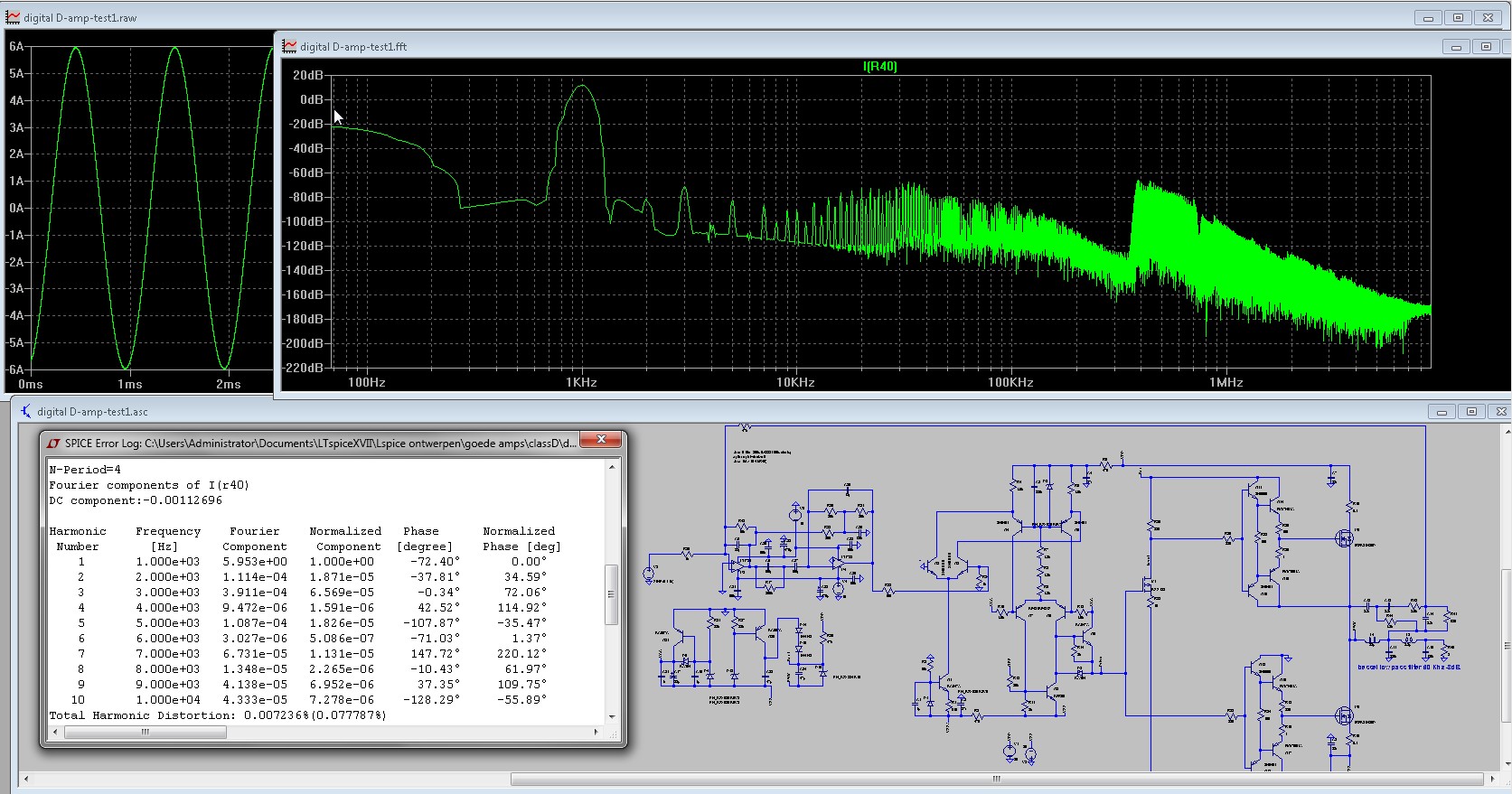

I have to wait for parts, so I did some sims on class D.
I can get low distortion however I see that on negative sinus output signal it get shoot through, and not on positive output signal.
Version with the IR2011 I think I have to include a deadtime generator but need to see how to do it in ltspice.
I did read about gate resistors as setup for dead time but I think it is better with a gate driver, I did use a discrete comparator like the phillips, it had pretty low HD with use of poles.

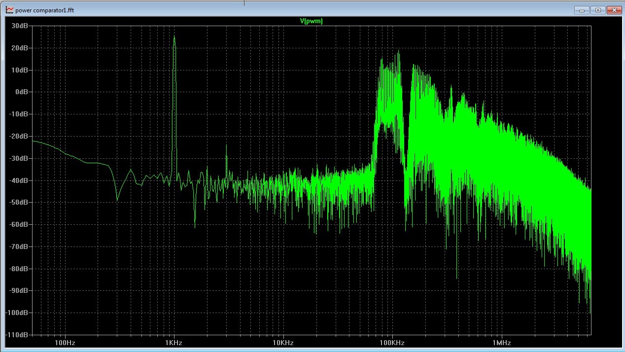

I don't think this can be stable. you have to put square signal at input and see if output is stable in time domain.
Low THD is good, but who cares about 0,1 or 0,001 % THD (probably cant be heared), my opinion, but unstable amplifier can be heared I would say.

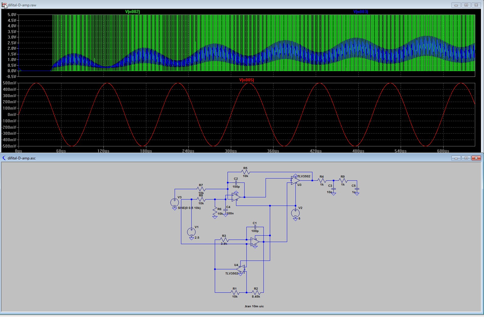

You say 0.0 or 0.001 do not hear, this is dependent of the kind of distortion, if it is even harmomics the amp get warmer with it, if it is other stuff it sounds bad, I try high end, so need very low distortion, I try to make the modulation liniar with poles, I have that from a paper, the power comparator is a existing one who is stable.
Thanks for the tips, I try a square, but then I get a lot of mudulation interfacts, who as I presume is needed to see how it is with stability.

MOST basic UCD (Putzeys patent version) gives about 0,1 % thd, and I measure mostly even harmonics.
But it is completely sable with square input... if you add more poles/zeroes.. it is not..
I would say that stable simple ucd must sound better then unstable one with very low simulated thd..
