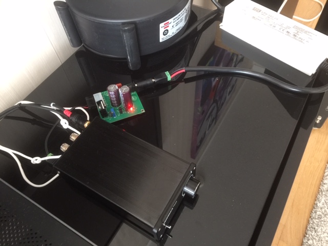

I can recommend the capacitance multiplier from Allo to clean up the power from SMPS . Its a stand-alone card. I use two of those in my active loudspeaker system, with my two Aiyima a04 tpa3251.
With the card, the sound gets slightly better with better bass and a slightly bigger soundstage.

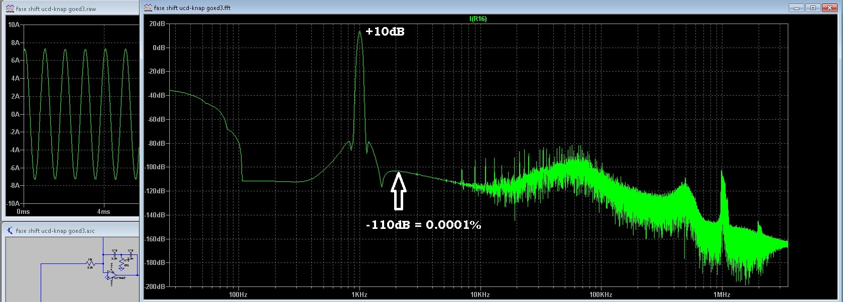

The chips does draw not much so clean these up is not difficult, but important,the output switching part does has impact, for Class D it is quite inportant that there is a good supply rejection otherwise it get bad, more bad then with analog amps.
A class D open loop does sound bad because there is no rejection, a smps supply on a 100 Khz switching frequency does better then a analog supply who has much more ripple and at 100 Hz.
I do now still the circlotron analog stuff but has in past did a version three level who is free to build for everyone here, no time myself but curious about what it does.
For the chip to get clean supply, also the opamp part you can use a regulator, a good one who can de adjusted with resistors like LM317 has deep rejection, good caps close to pins to prevent 100Khz signal is all over the place, separate the analog from digital is very important.
But I have not to say this because people here and you already now.
regards
