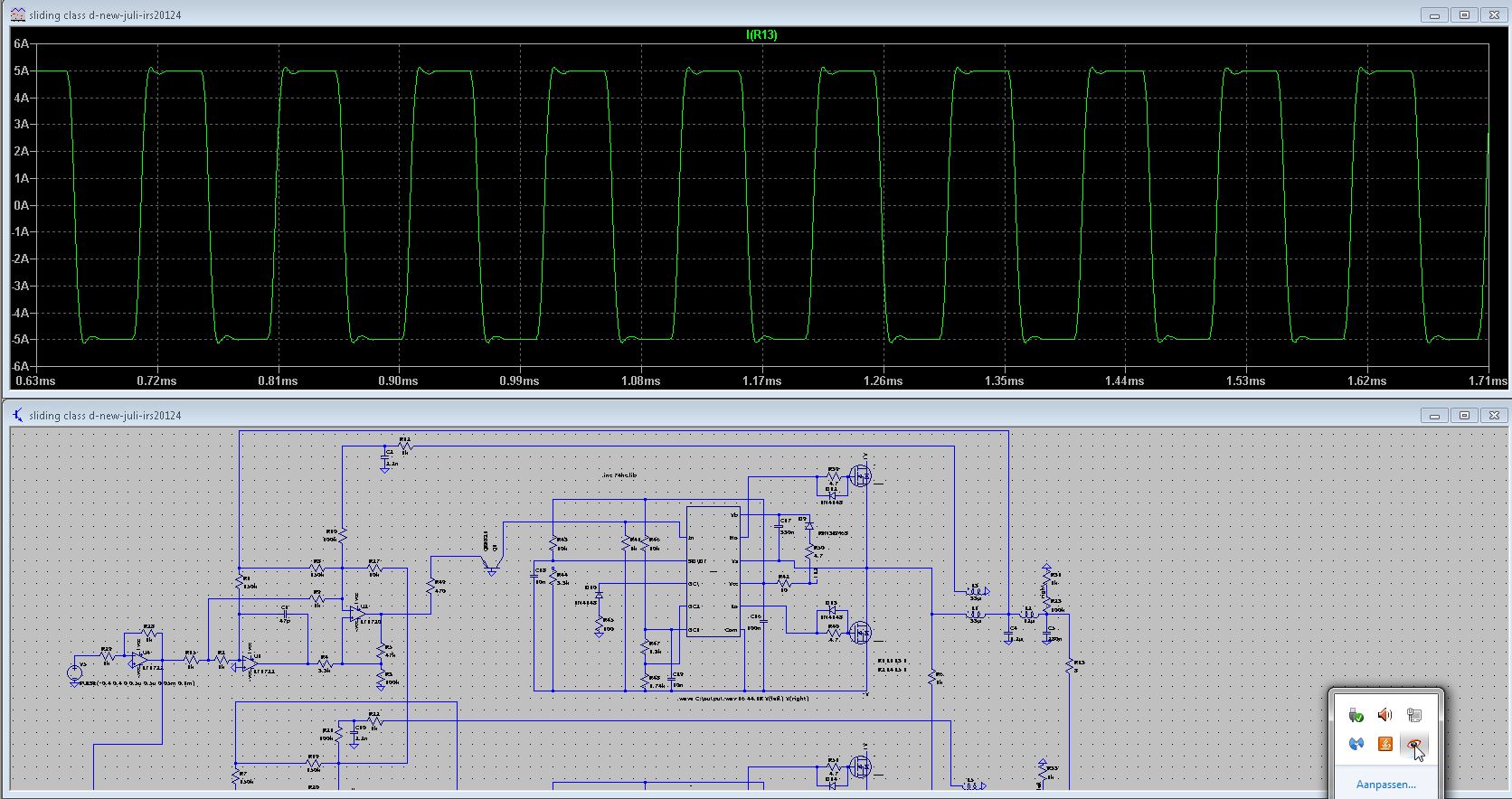

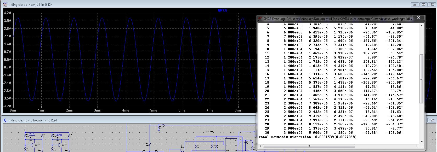

This is maybe not the place for own designs, I have own place gere, but not yet updated, but maybe it is nice to see.
Mine go to start soon, I make now a pcb and search a good idea for protections special OCP.
It is based on slide technology with current feedback and postvoltage feedback with hysteric comparator, to get that right is a long simulation effort.
pic,s is specs, however how this will sound, time will learn after build, I use low components count, and the amp is three level means carrier is 700 Khz because is multiplied on the end..
regards.

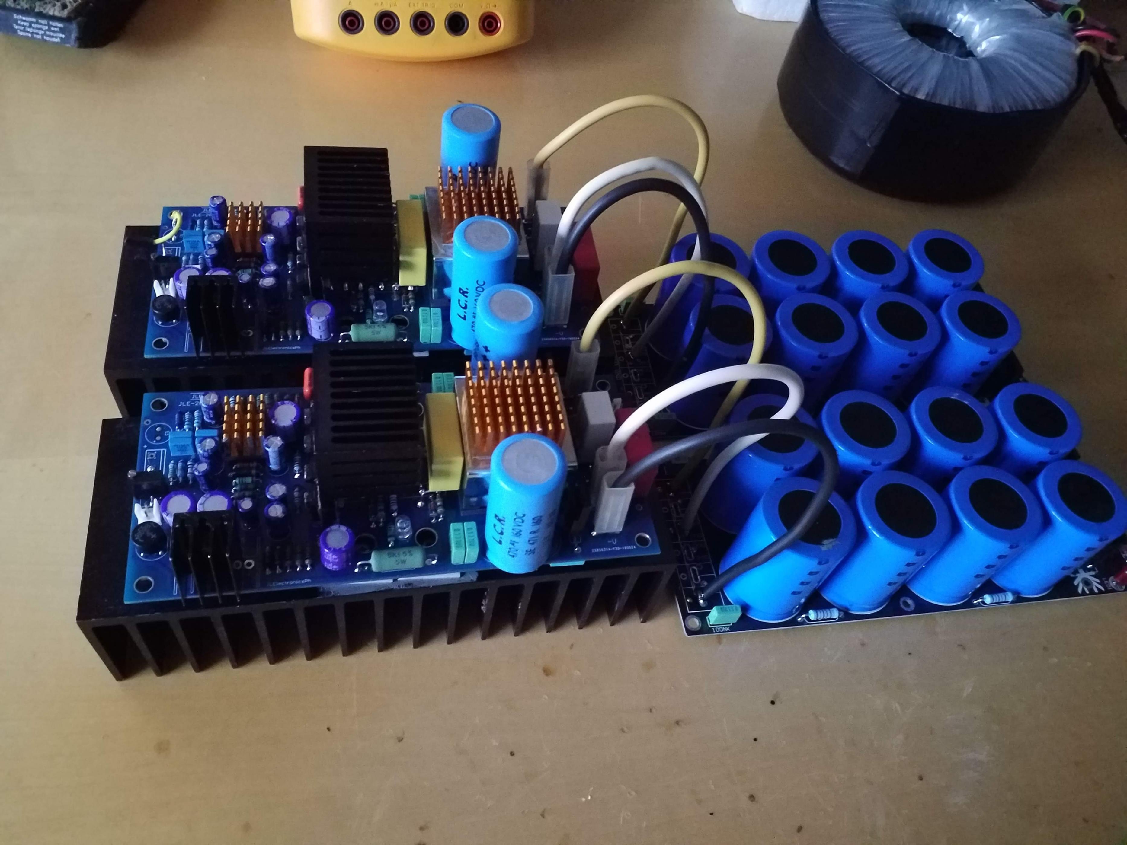

My iraud based modules, they sound brilliant and with stunning headroom, still needs enclosure though.
I vote the proven irs2092 high.
Very nice construction...
It's your PCB?

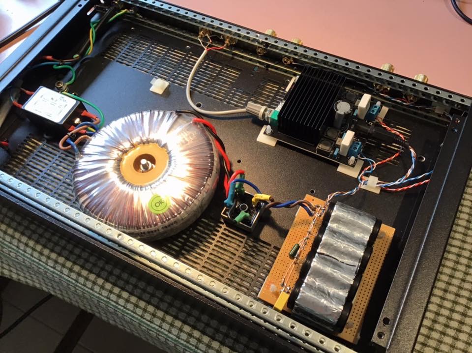

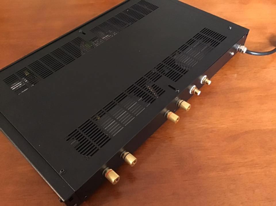

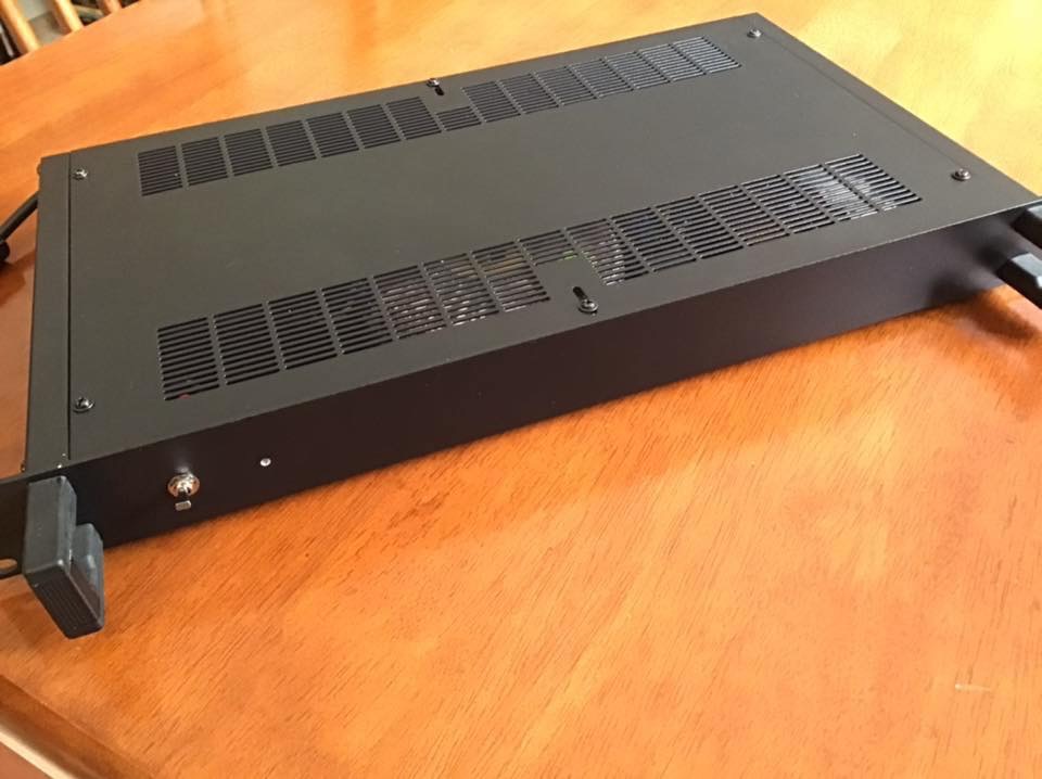

Just built a super low profile 100W Class D amp in a 1U smart ash black rack mount. Single 36V rail and power filter with 19,000uf of filter caps. Uses a single stereo modules about credit card size. Very happy with the sound will do over 70W into 8. Based on the TDA7498 chip.
Mhouston, I want to give a tip about cap placement regarding class D. The impedance of 10cm of wire is really high at 3-400kHz. That cap bank is not able to work the best with such thin cables and beeing placed so far away. In class D design the caps should be placed millimeters from the demand. Look at Gmarsh's Wiener tpa3116 thread to learn about class D placement designs. Its very informative. If you made your design deliberately to avoid cap bank oscillation disregard this post.

While I will agree the power wiring does seem a bit light, I do wonder if you missed the large bulk capacitor on the amp board itself. The supply will be operating at 60hz and outputting DC to the board.
