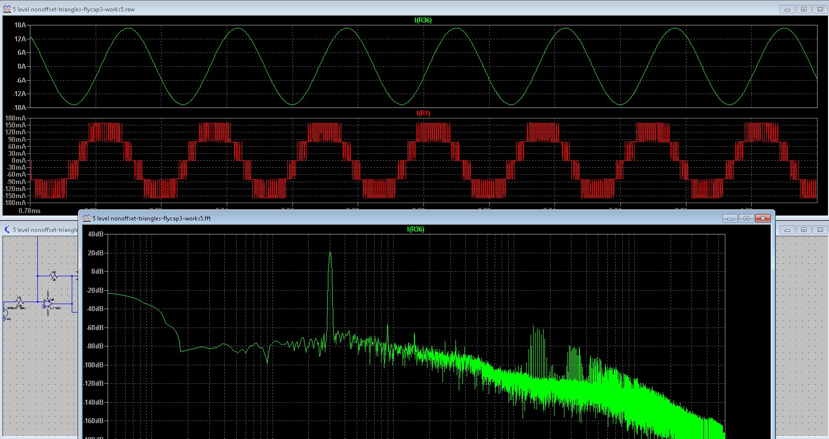

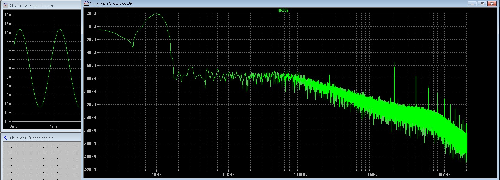

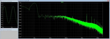

Multilevel are also interesting, even open loop. Yes it needs a PID controller for postfeedback, and brains for the calculation, but I learn, and get it slowly, yes when 62 brains get slow, so some beer help.
post output of a 5 level post feedback and a 8 level openloop. The 5 level has low distortion on 30 Khz, also the same on 1Khz, it does not change much.
I think verything above 5 level is of no use for audio amp, because of much higher parts count, for high end it is maybe (when usable) not so bad for more parts because there is more mony for.
This I am busy with cirlotron but I go do look at it in near future.

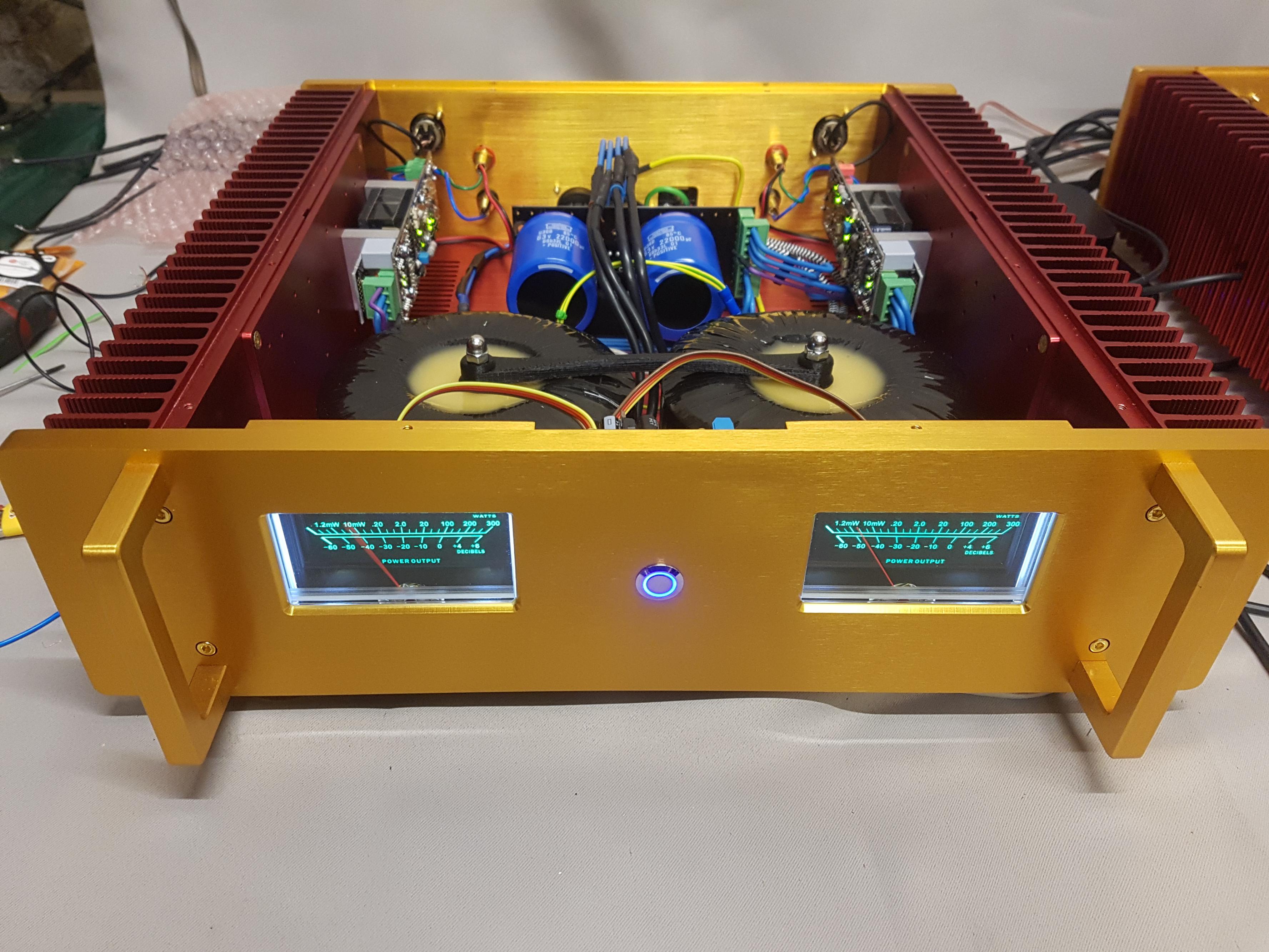

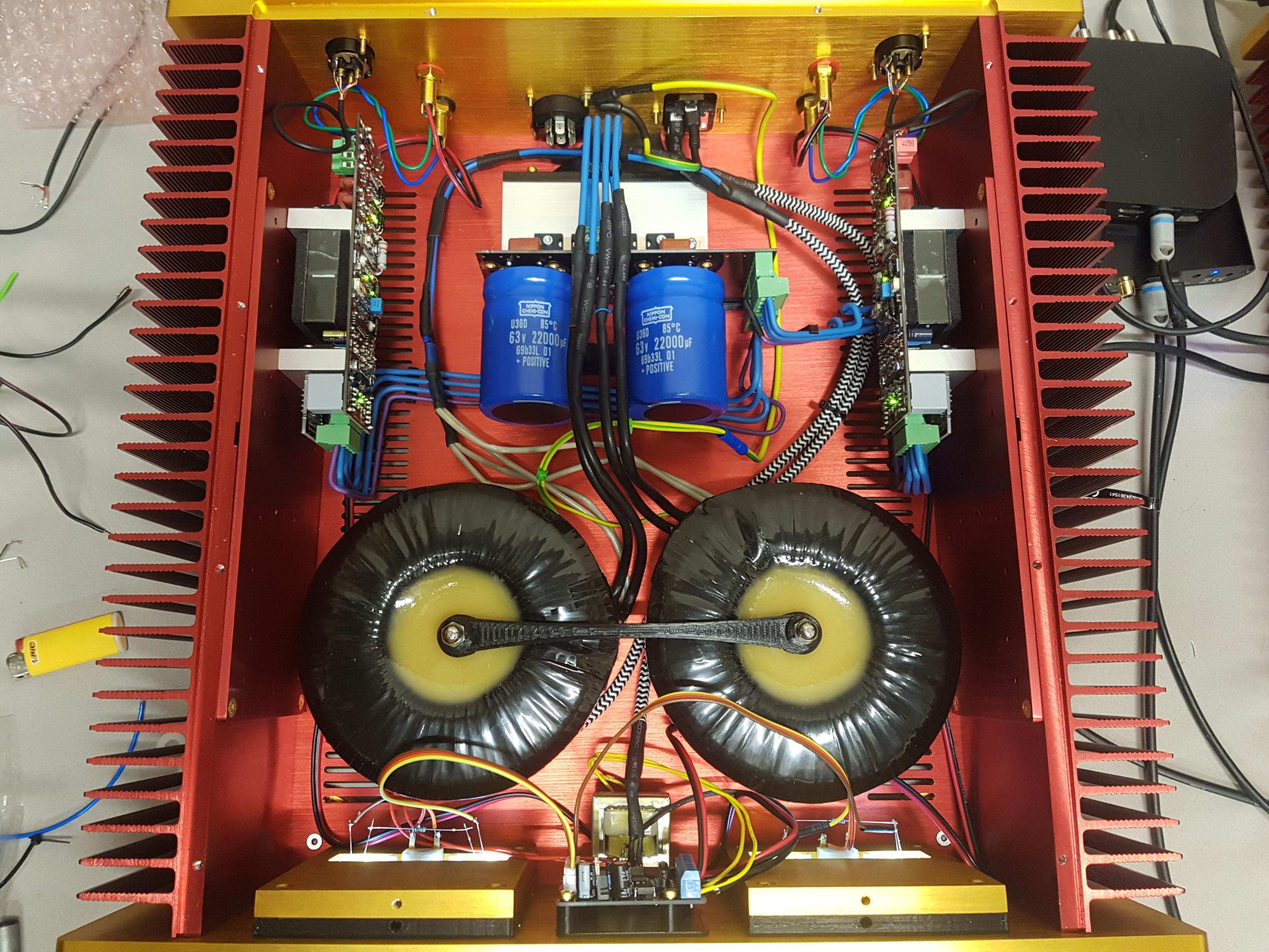

I'm currently running these amp modules through their paces and being it's only been 12hour in, I'm loving them!
Okay I can't do a AB test but there an improvement on the Pascal S Pro2. It maybe argued however having a linear power supply instead of SMPT really makes a difference?

where did you buy this beautiful 19 inch case with VU Meter ?
is it from alieexpress ?
Haha, I wish! long story short, I wanted a solid aluminium amp chassis. Yes I know most of the DIY community use Steel stamped chassis' at a fraction of the cost but the way I looked at it, why put an expensive modules is something cheap?
Anyway, being a true DIYer, I wanted an amp chassis that could be versatile, so I did a heavy redesign of an existing amp enclosure allowing me to install a range of branded amp modules without having to drill and tap for each one. So far I've as you saw, it can handle NewClassD with a linear PS, I've fitted pascals (upto 4modules), hypex and ice power with out any problems. I'll admit I'm not completely happy with the back as I've restricted myself when it comes to using a DSP modules, so I'm working on that now.
I'm glad you like it, I didn't think anyone would be interested? Though I shouldn't have been lazy with the colour pallet however they are sexy in the flesh.
