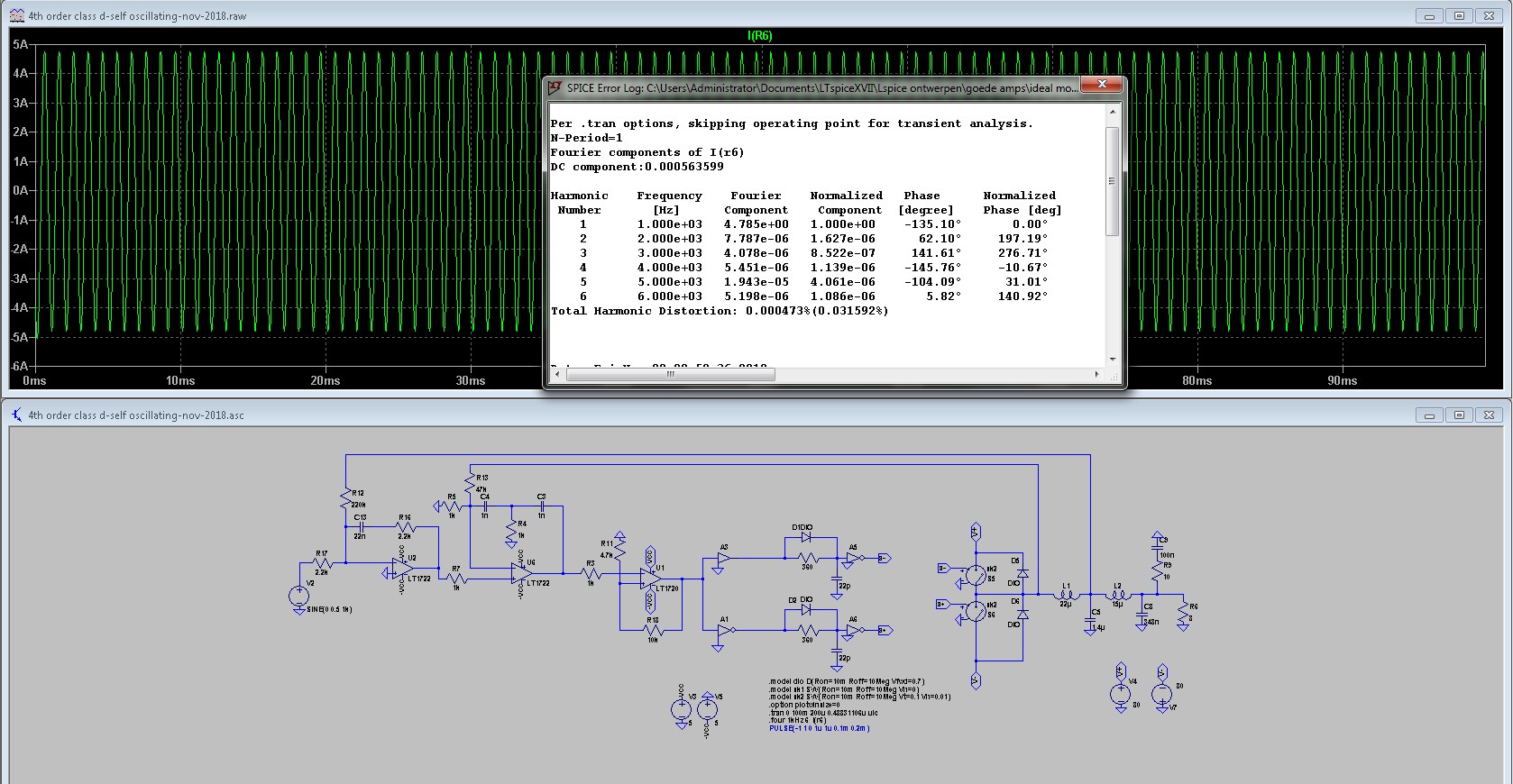

Optimized work I get this HD with only prepost feedback, it use a triangle carrier, it is not ucd version. Pic 1 is 3 amp output, and pic2 is 16 amp output 8 ohms. full bridge 3 level shifted switches,
You see it can also be low in hd, see also the last pic, where the shaper is removed and the difference.

Hmm, I wonder what is sound difference by listener, Pre filter feedback (not so good impulse response, filter not in the control) and post filter (UCD type) feedback.
Ncore is post filter feedback but very low THD. Maybe having the most simple UCD post filter feedback (THD about 0,2 %) sounds best due to good impulse response (phase, delay, etc)..
Some people here claims UCD400 exhausts people, is this because too LOW THD? Maybe sone distortion is needed for listening hmm
This is precise why I do simulate and look at what is best, sharpness in the highs is because there is feedback not so effective, but to much and amp sounds dead, so I go on and see what I come with later.
I did, with the use of a 24dB version, did also bessel here, and not bad, bessel has constand fase over bandwidth, but have less output demodulation.
Do not care about the 60 Khz peak, it is due to the simulation and can not find where and why. it is not harmonic.
Why would too much feedback make amp sound "dead". what is definition of "dead" sound? Do you refer to too bad impulse response due to feedback (and bad delay of high frequecy signals) .. All in all high feedback amp has bad impulse response (non repetitive signal have infinite spectrum theoretically) So impulse resposne to be good you need filter inside loop, and loop gain should be relatively low (and THD not that low)

Mine purpose was no feedback like the hybrid, and these also have not that low impedance, but sound wel.
I can include a postfeedback as well, most is the setup of lead lag, because the poles of low pass need to corrected, most with post feedback the higher frequencys are not so low HD, the open loop get less there, so I am busy now with 5 level who has low distortion of his own.
Do not forget, I use air coils, and these are lineair with ceramic and oil filled or mkt caps, I think a amp with very low hd needs a very high open loop, maiking it lineair before feedback as possible is the way to go for good sound. All these error corrections do notmake a good sounding amp persé.
The triangle I go now make with a adder and some digital stuff like d flipflop.
Dead sound I mean with it is tamed, to much tamed, things like air and deepness but also resolution is less in feedbacked amps, I admit, I do talk about lineair amplifiers where current feedback do a lot better, it's lack of IM and independence of bandwidth is inherent of this type of feedback, however dc drift is more a problem.
Class d are switching, and only the postfeedback can be seen as a real feedback who touch audio.
Mine hybrid who plays here has a tremendous deepness and resolution, I have test it with feedback with a high end listener present, it was clearly less beautifull sound, like driving a car with your feed on the break, that is feedback. I do not talk about the all plate amp.
But in class d I do take it in considering as test.
regards

if the circlotron is ready then I go try a class d design, I have a simple one who do work nicely and is self oscillating, but can also work with a triangle, the first approach has lower HD, and then the quenstion how it sounds, I do not yet now. Seen the transition to these new class D amps, I need to deep myself in it.
