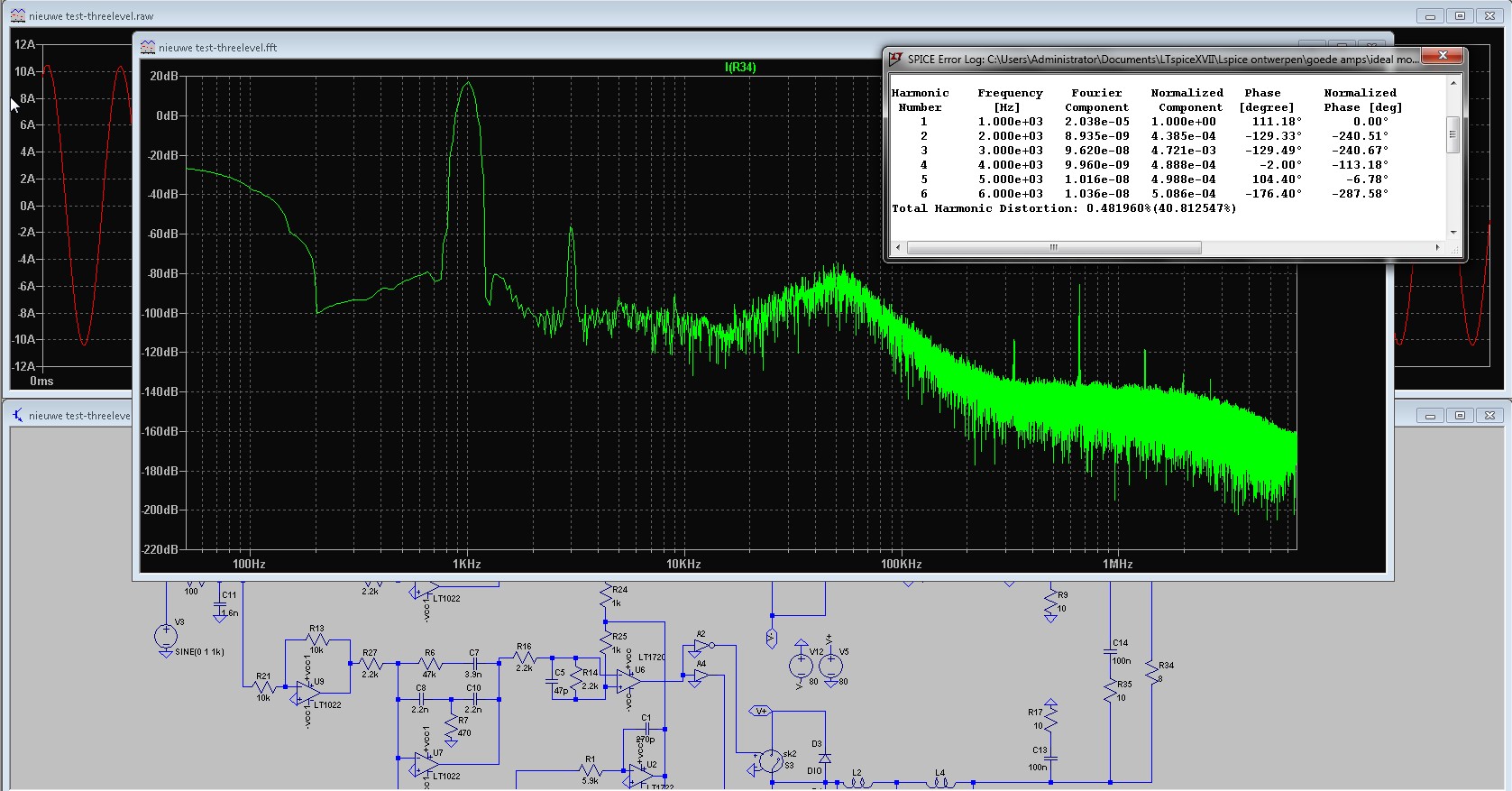

Hi All
I have done now some schematic work and sims, combine different ones.
I do however not understand the 3th harmonic who is high and the rest is very low, even under -100dB afcourse in sim, not real, these version is 3 level, however I get not get that nice 3 level output, however, the signals are shifted, can the models as lossles switches what I use the reason that it do not work, maybe #grizlek can explane. the only way I get the three level as it has to be on output when use two triangles one inverted with offset, so there is one above and one below zero, that way comparators can do there job better, but in books, a shifted output puls train has to do the job just with two audio signals and one inverted no offset.
I have to say I do not see the three level singals on the output but see that the carrier is effective doubled to 600 Khz so it does work in some extense..

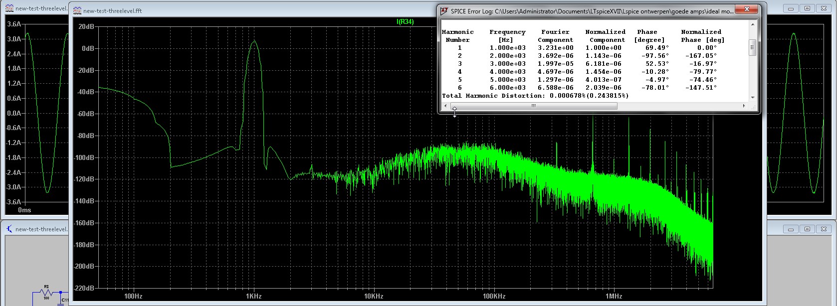

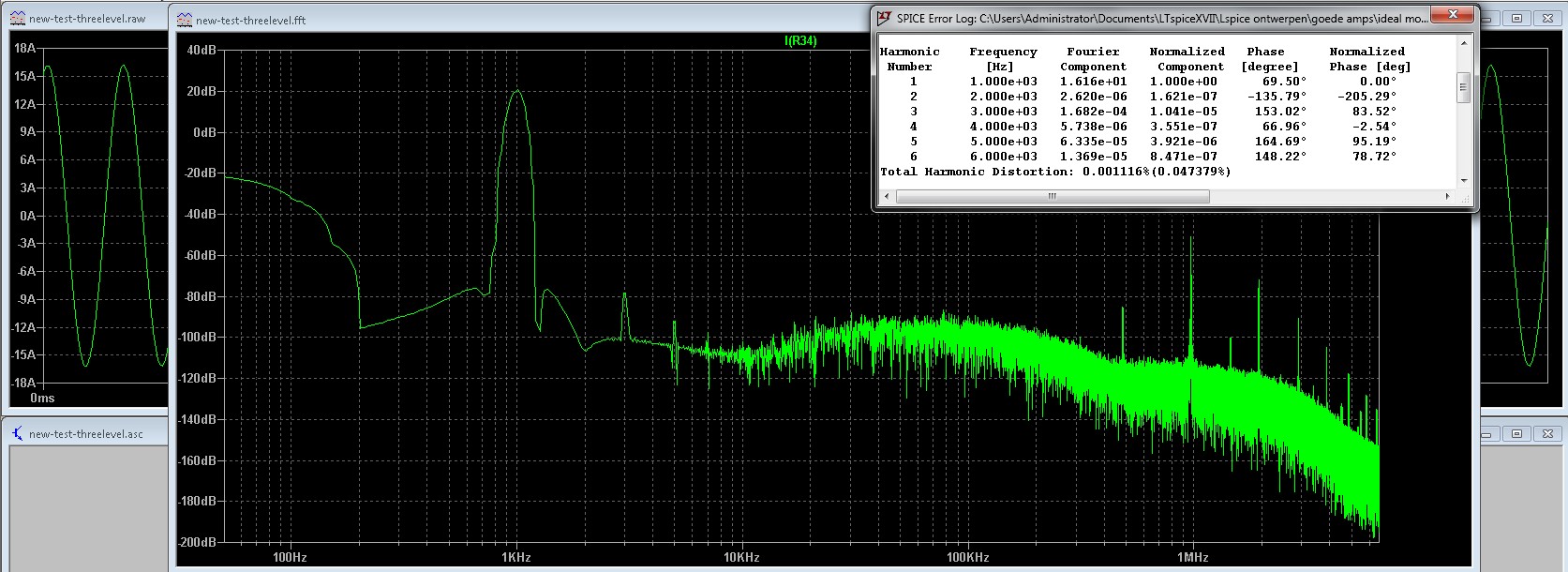

Optimized work I get this HD with only prepost feedback, it use a triangle carrier, it is not ucd version. Pic 1 is 3 amp output, and pic2 is 16 amp output 8 ohms. full bridge 3 level shifted switches,
You see it can also be low in hd, see also the last pic, where the shaper is removed and the difference.

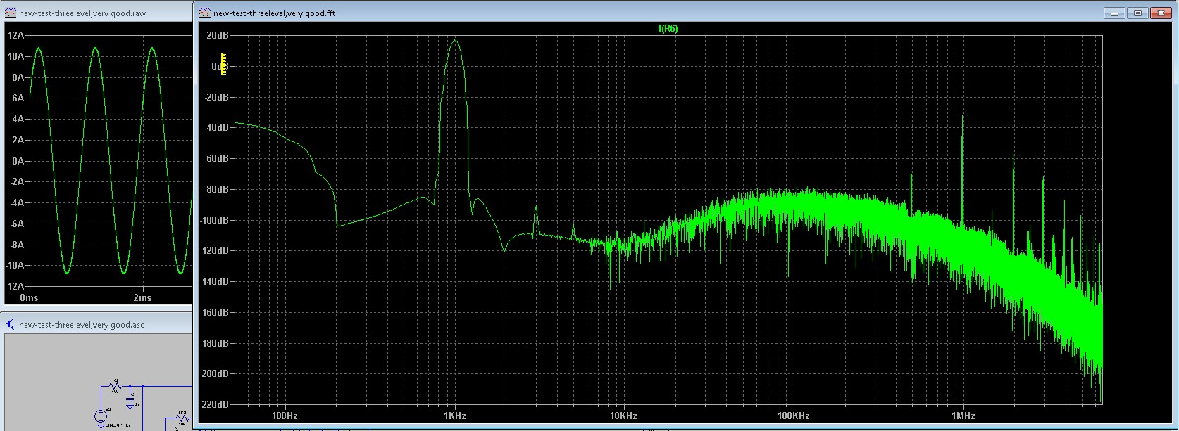

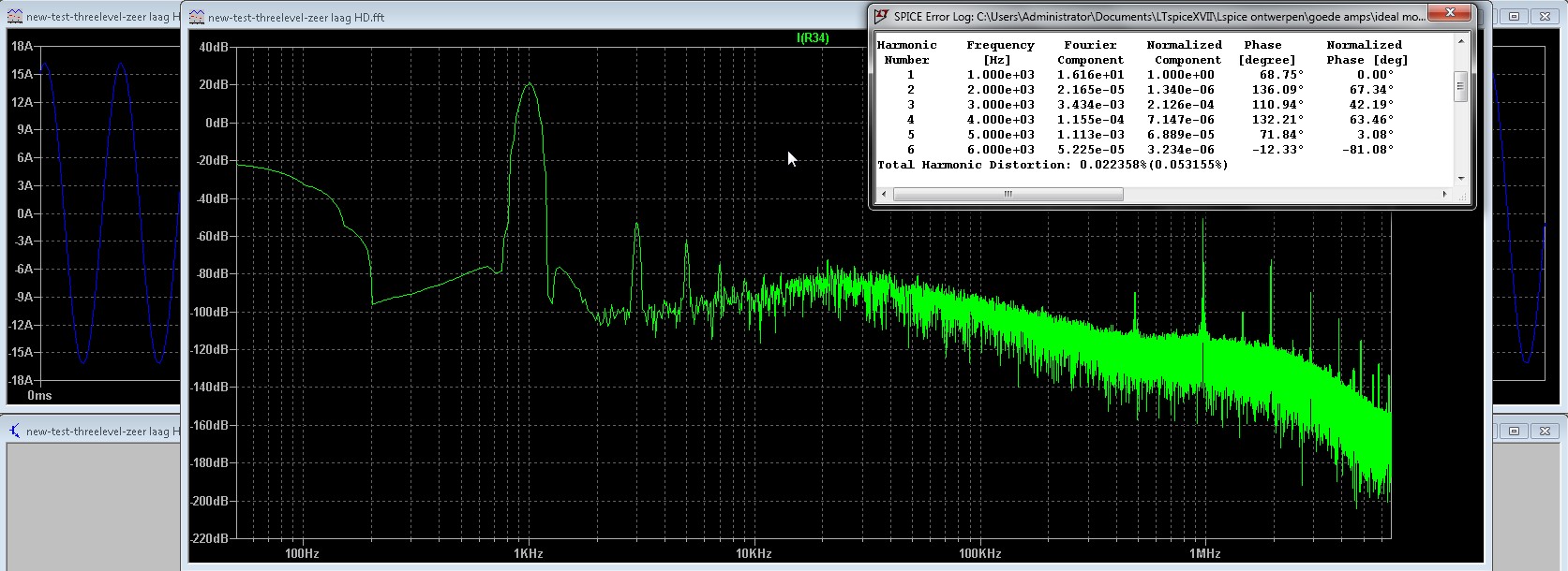

Triangle driven class D with feedback.
quite low HD, with 2e order feedback path, only before low pass. if tit is real I do not now.
carrier is doubled to 1 Mhz, input 500 Khz as is normal with these 3 level.
audio bandwidth is 100 Khz.
