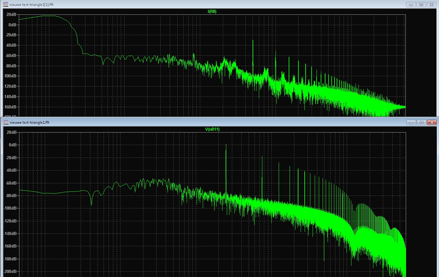

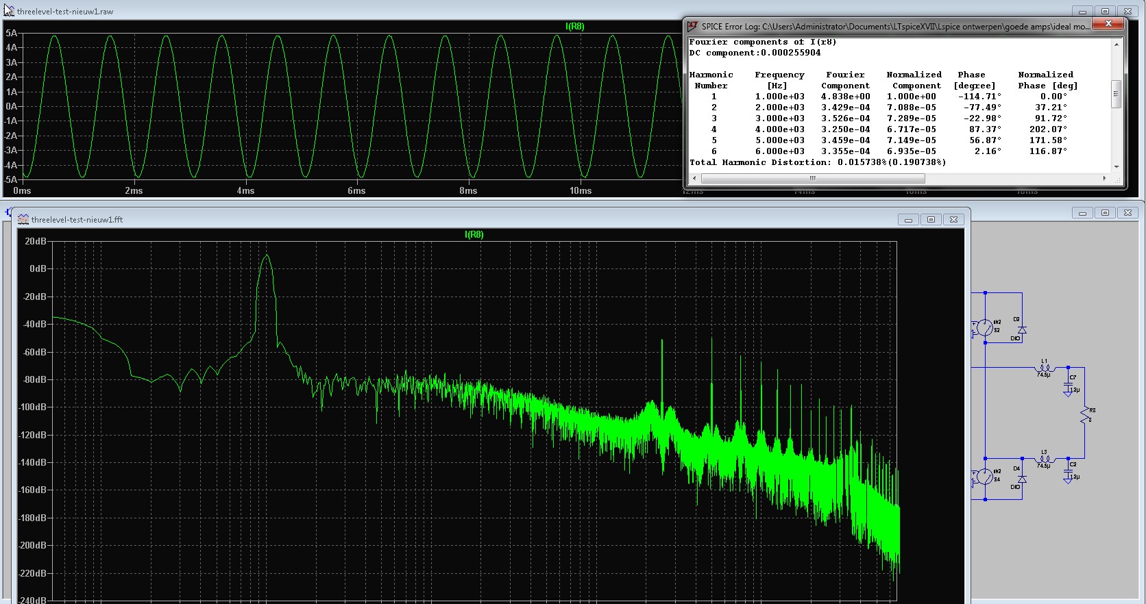

If I read the books wel, but also see the schematic of the K1 K1 crown amps who is in fact a BD modulator but she uses two buck converter outputs, who is by the way tricky, nice to see the resistor banks who prevent thermal runaway when she do overlap it.
I drawn the triangle generator and she do use there a adjust with a pot for overlap, in other papers she do use triangle with +vcc and -vcc and two opposite input audio signals who give then the two signals, a lot is unclear there.

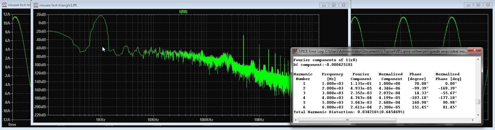

Do seem that I did get a low hd amp, no DB, did not work well, but some other form. See pics of output amp setup. -100dB distortion😱
regards

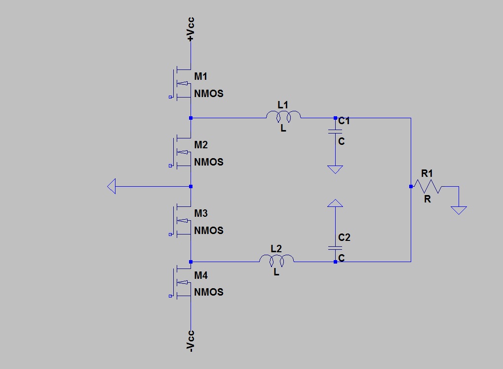

When you say two buck generators, do you mean self oscillating class D topology or class D topology with separate triangle generator. ?
This schematics seems to be self oscillating, but this resembles more like two bridge amplifiers, hmm? BD modulation , heach half bridge should see only half of total voltage I would say. Like +Vcc and 0 V for one and 0V and -Vcc for other.
Question is what is needed to convert one AC audio signal (sine signal) to two signal, one signal is only positive part (top of the sine) and other half is only negative half (bottom of the sine). Problem is that in self oscillating topology we dont have two triangles.
Probably class AB inverter should be used.. Topology from AB class amplifiers.. Something like that

But still am am not sure if you are using right topology. I will draw just BD modulation output topology.

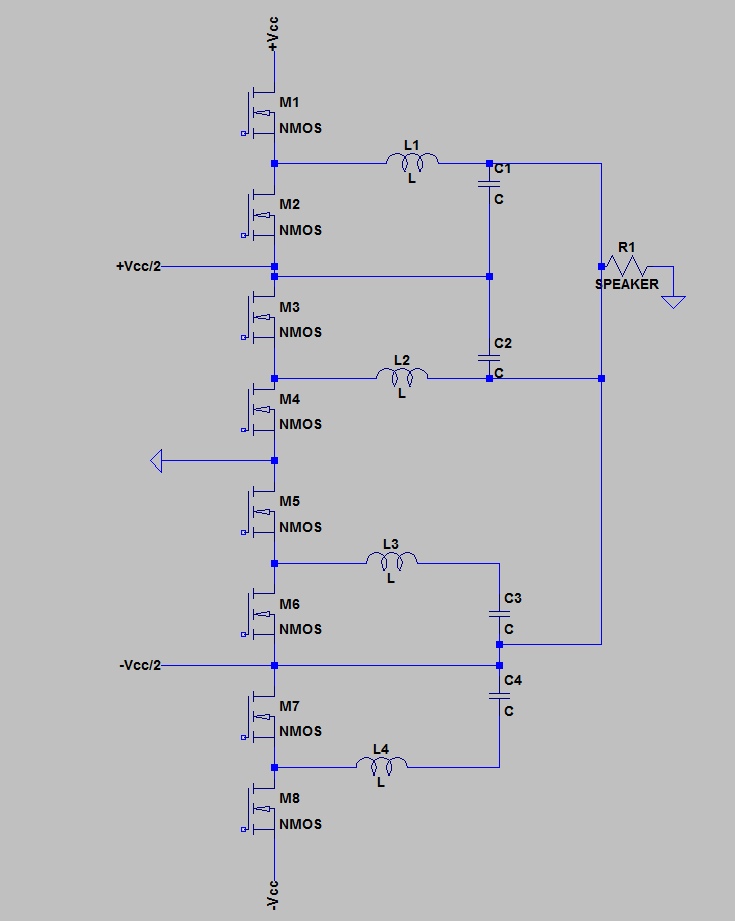

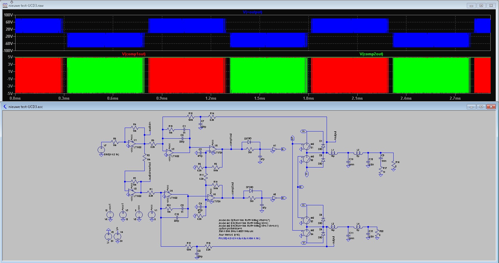

Here schematic and signals from comparators and output, clear see signal opposite from zero voltages, even with diff supply on output section, comparators do decide how it does. in picture two you see the output sinusoidal with uge crossover signals, these because it is self oscillation and as such it is maybe difficult to include the bias adjust section, maybe on the + inputs of comparators or inject small pulses making it a bi-bd version.

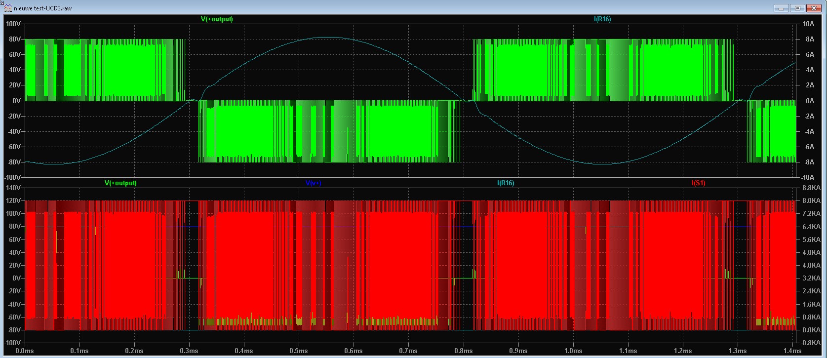

I have separate the section, and still I get uge shoot throughs, and as you see crossover, I did try to overlap, however with a self oscillating version, I do not now how, did try some offsets on the comparator and such, maybi opposite offsets needed, otherwise BI-uniform bd.

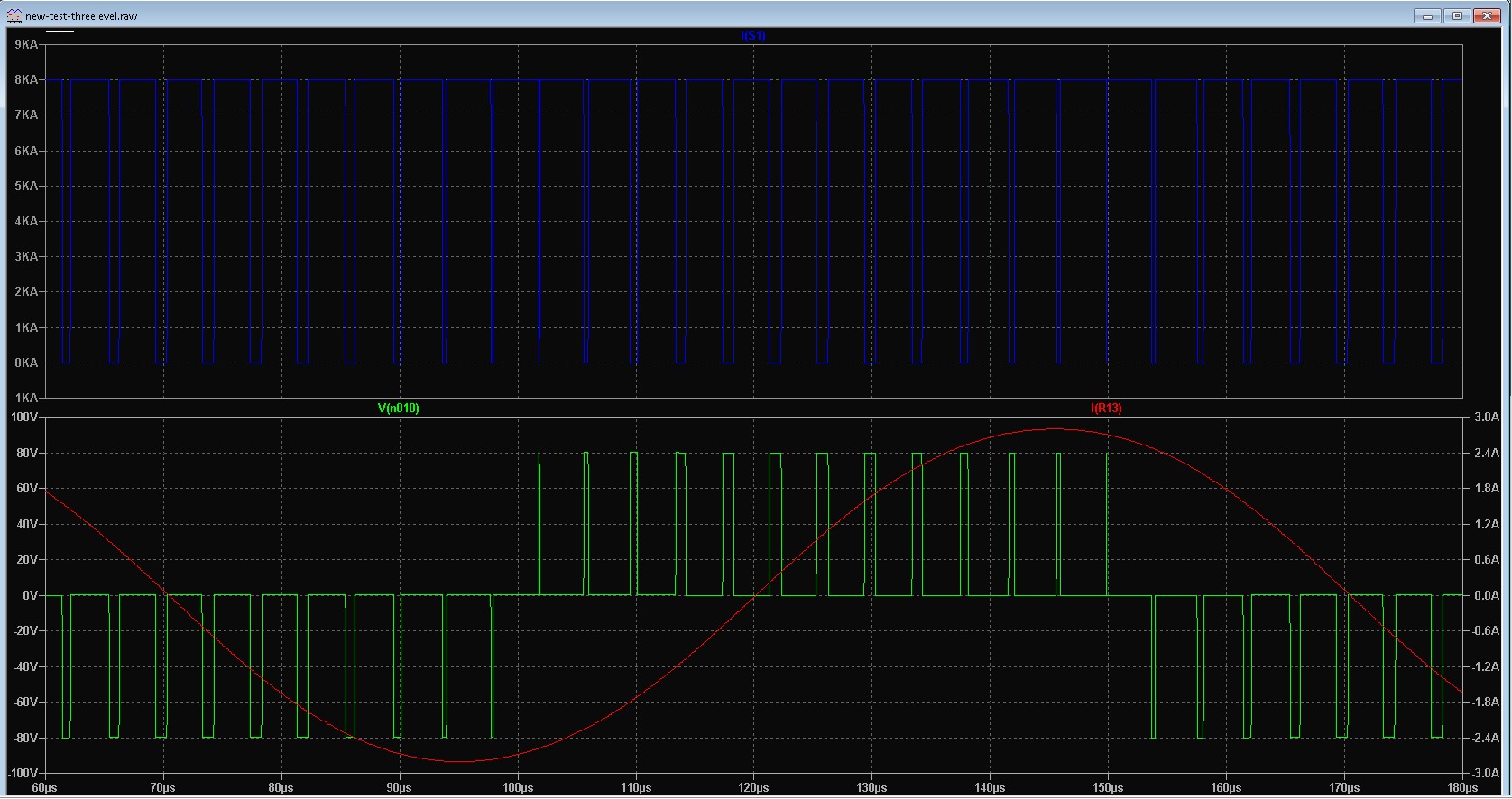

Pic one I have separate the two halves, on the output, still get 7 K-amp shoot through.😱
Have you tried adjusting the control settings on the switches
If i try to overlap things get out of offset, I do not now if a self osc type do work, most we need small pulses injected in tho zero zones to get a bias in the coil so crossover dissapair.
normally dead time is not needed here, so the high current I see is strange, maybe grizlek who made the sim switches and such can answer, maybe diode problem, freewheel current..

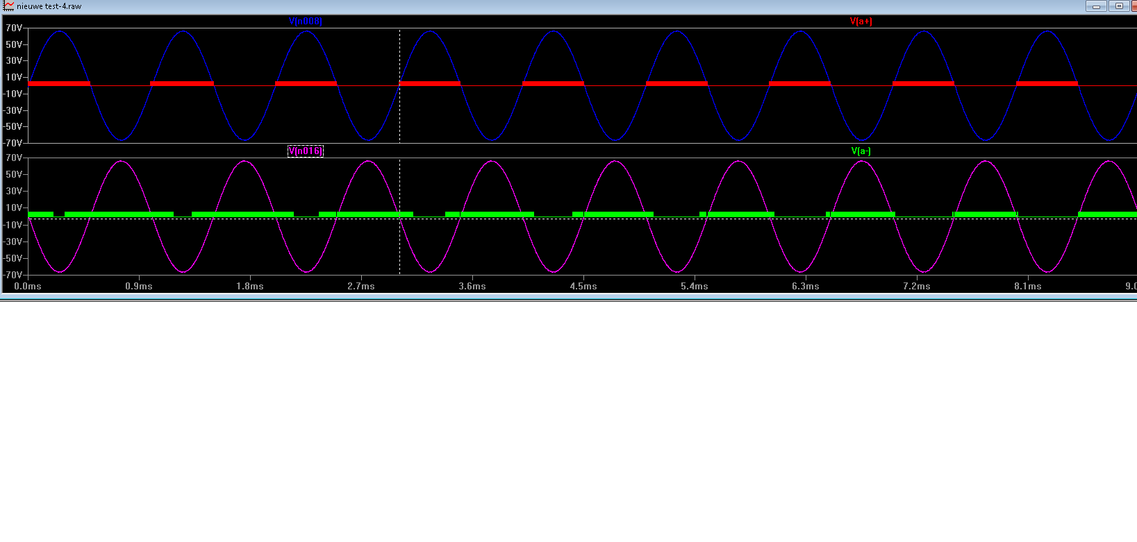

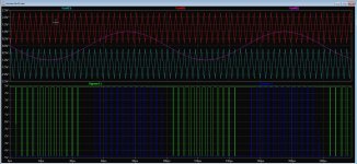

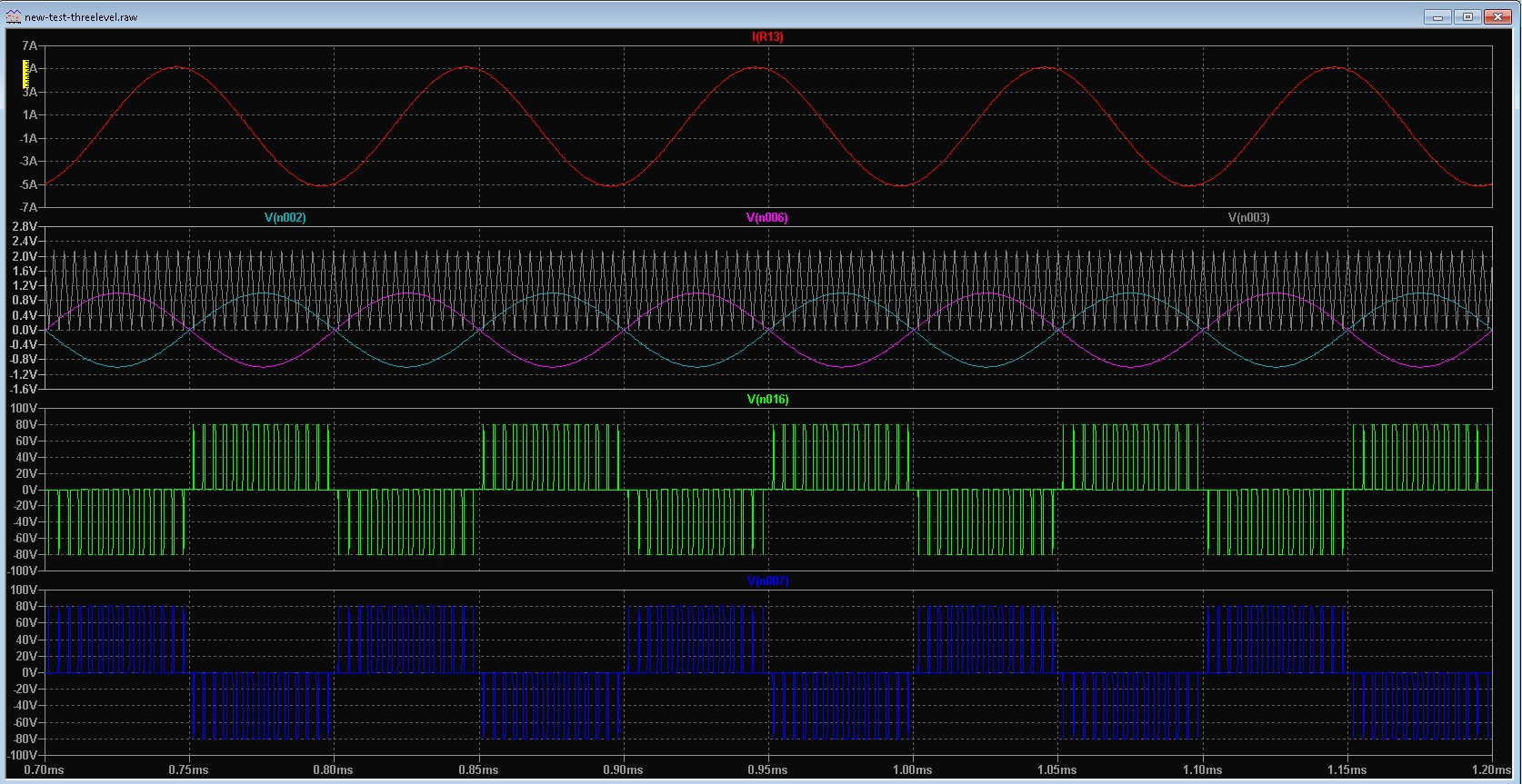

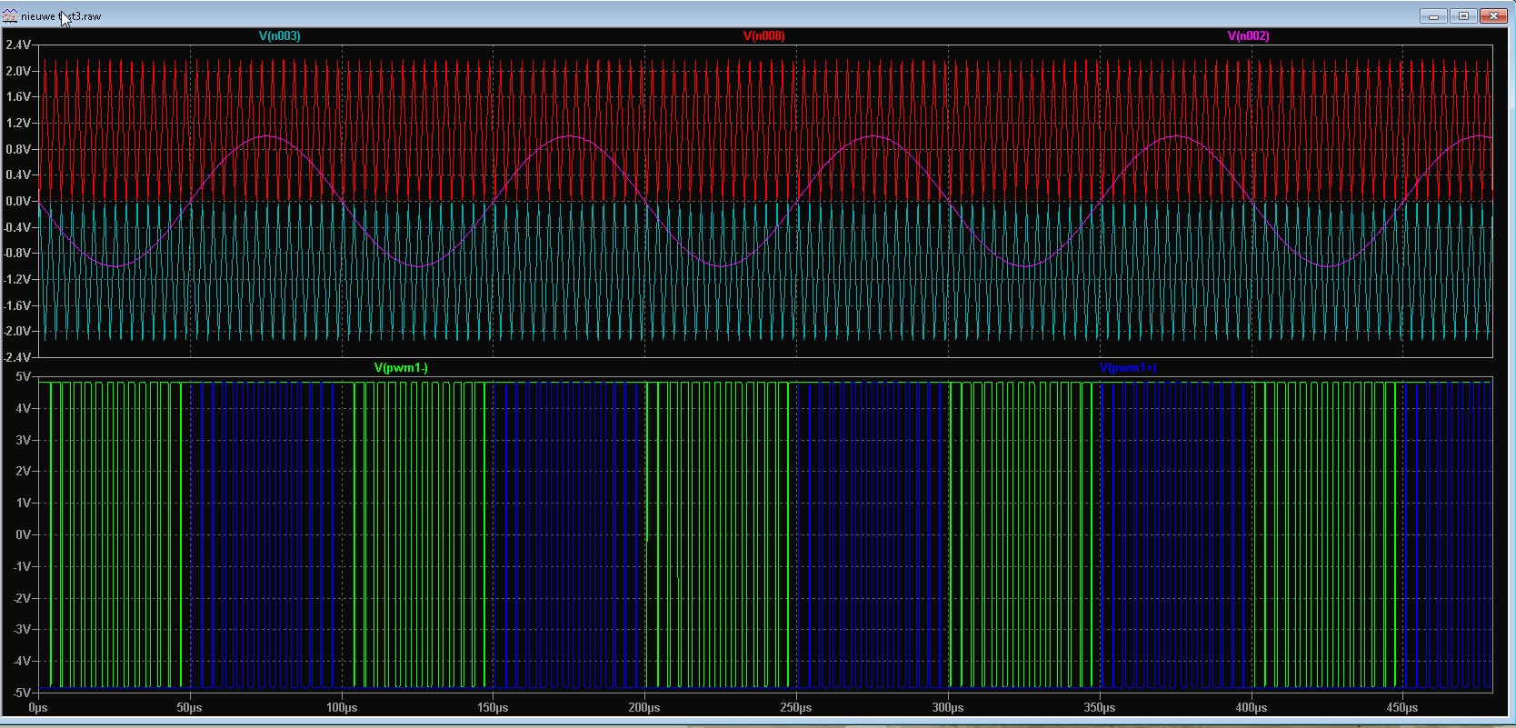

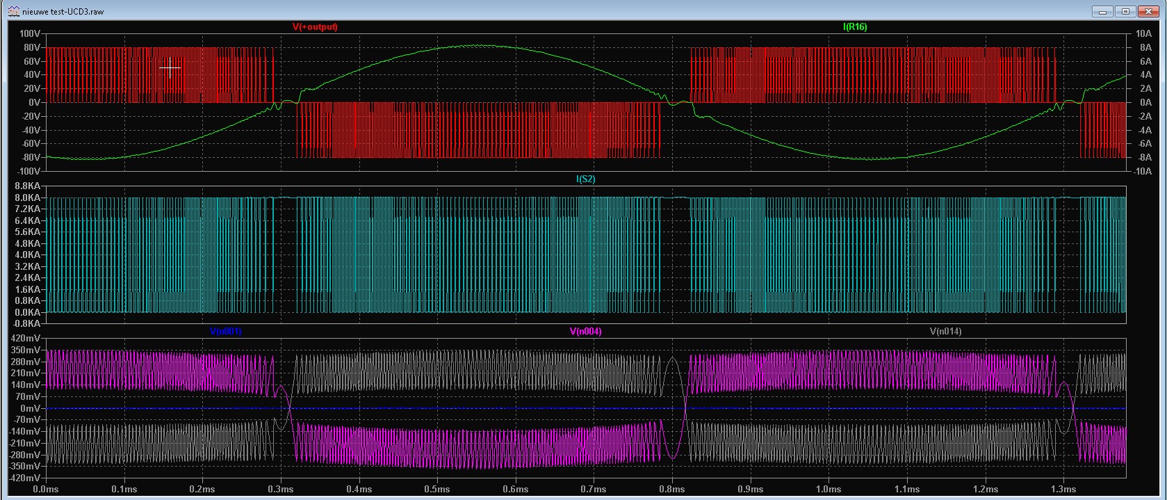

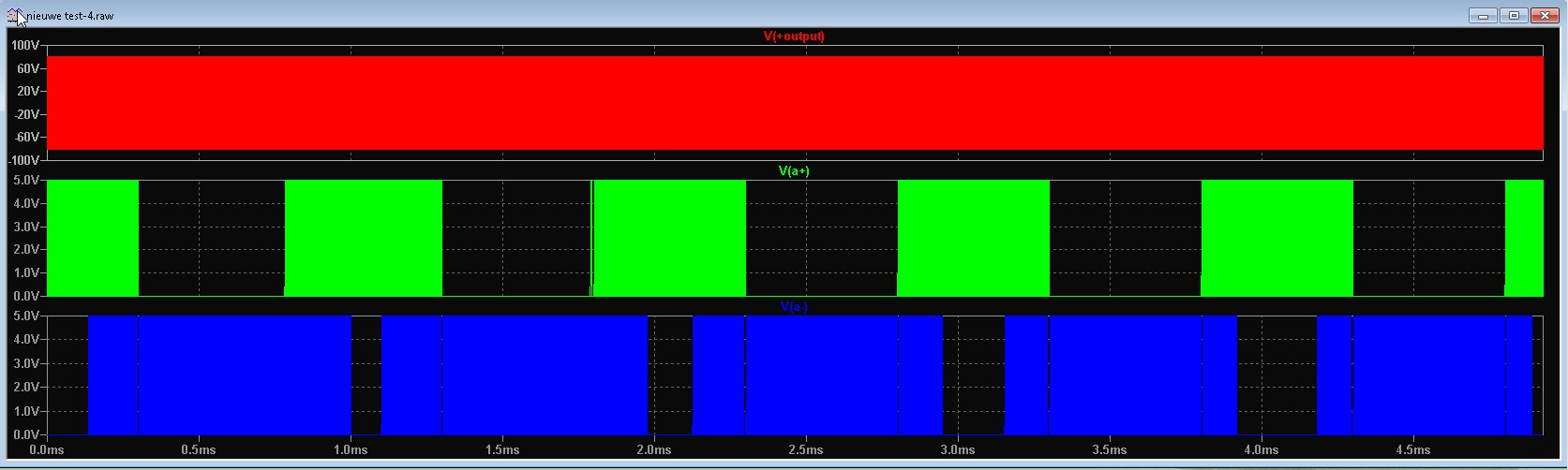

This pics it do work but much rare voltages on output.

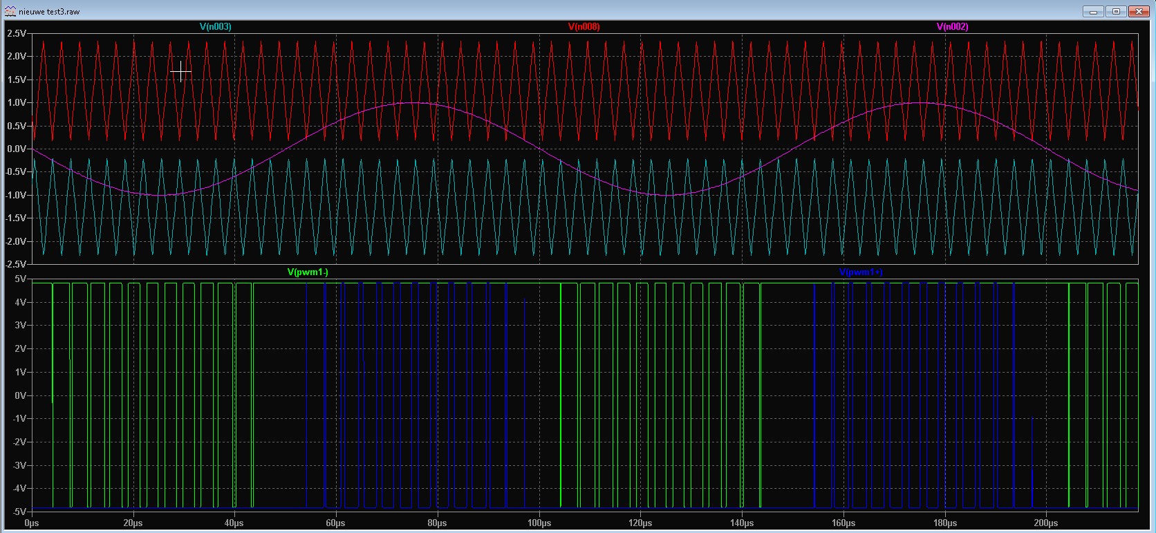

Pic 1 = you see it does double the carrier frequency, I put in 250 Khz and it doubles.
Pic 2 = for a open loop it has quite low distortion on 12 amps output.

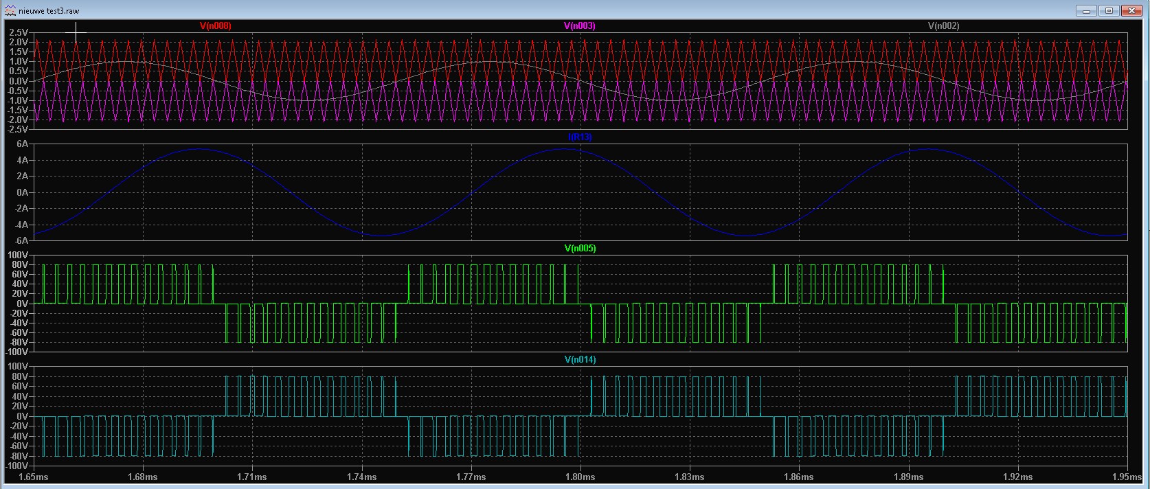

Pic 3 = all signals, I do not see the alternating signals on the bridges, strange.
Pic 4 = schematic. I have the triangle generator taken from crown as test.
regards

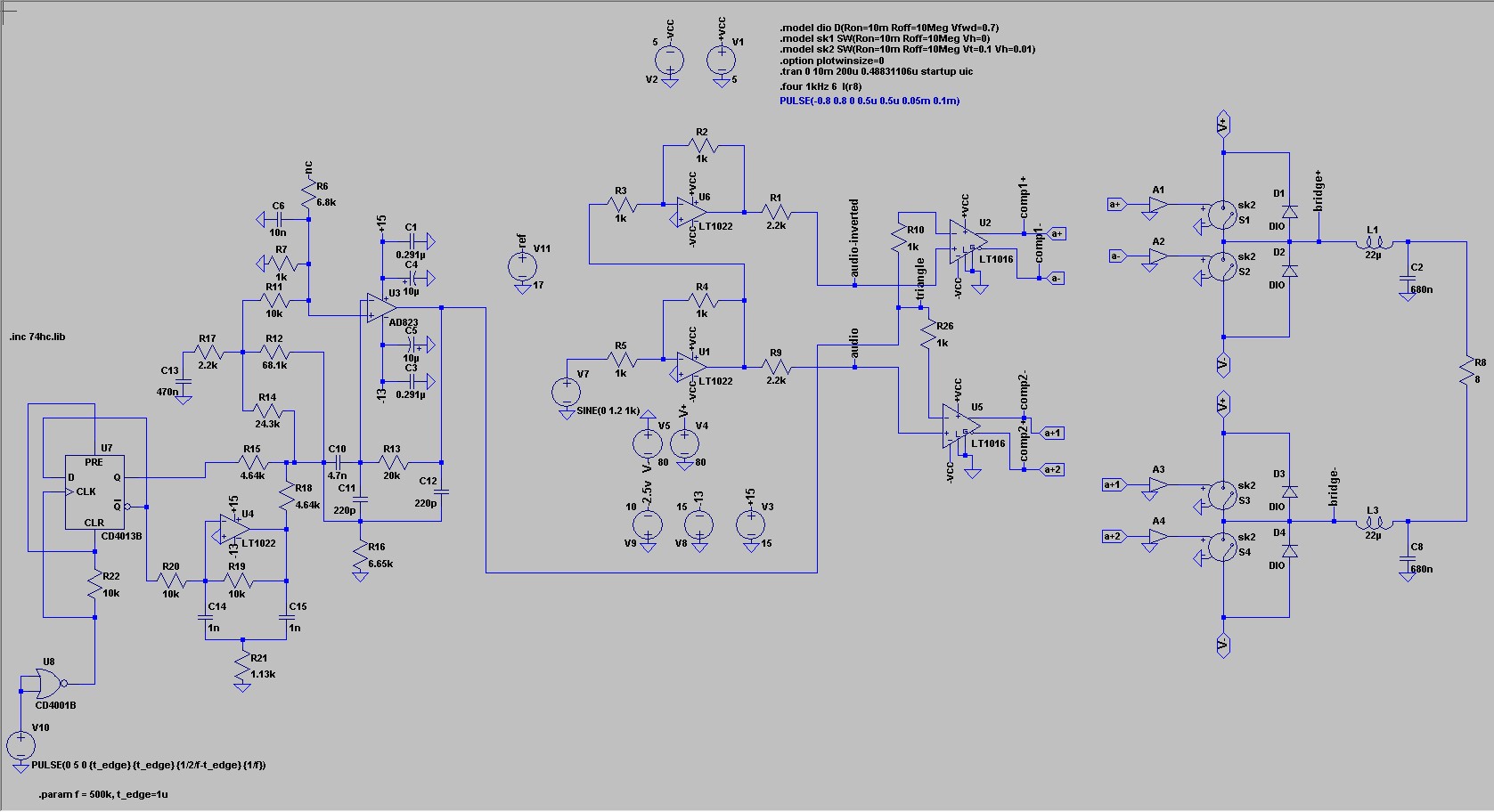

I inverted the Vswitch drive signals.
I already try that, still get strange outcomes, not switching from null to plus and min voltages but go to supply lines.
You did remove some parts from comparators, that are hysteric parts, needed to make the comparators schmitttriggers.
Last picture was from your changed version with schmitt triggers. still switching between rails, and little strange output

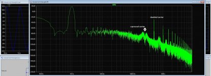

comparators. the first picture is a triangle version with also rail to rail switching, but do double the carrier and suppress
the original carrier frequency, what means it work, but in sim it is not clear.

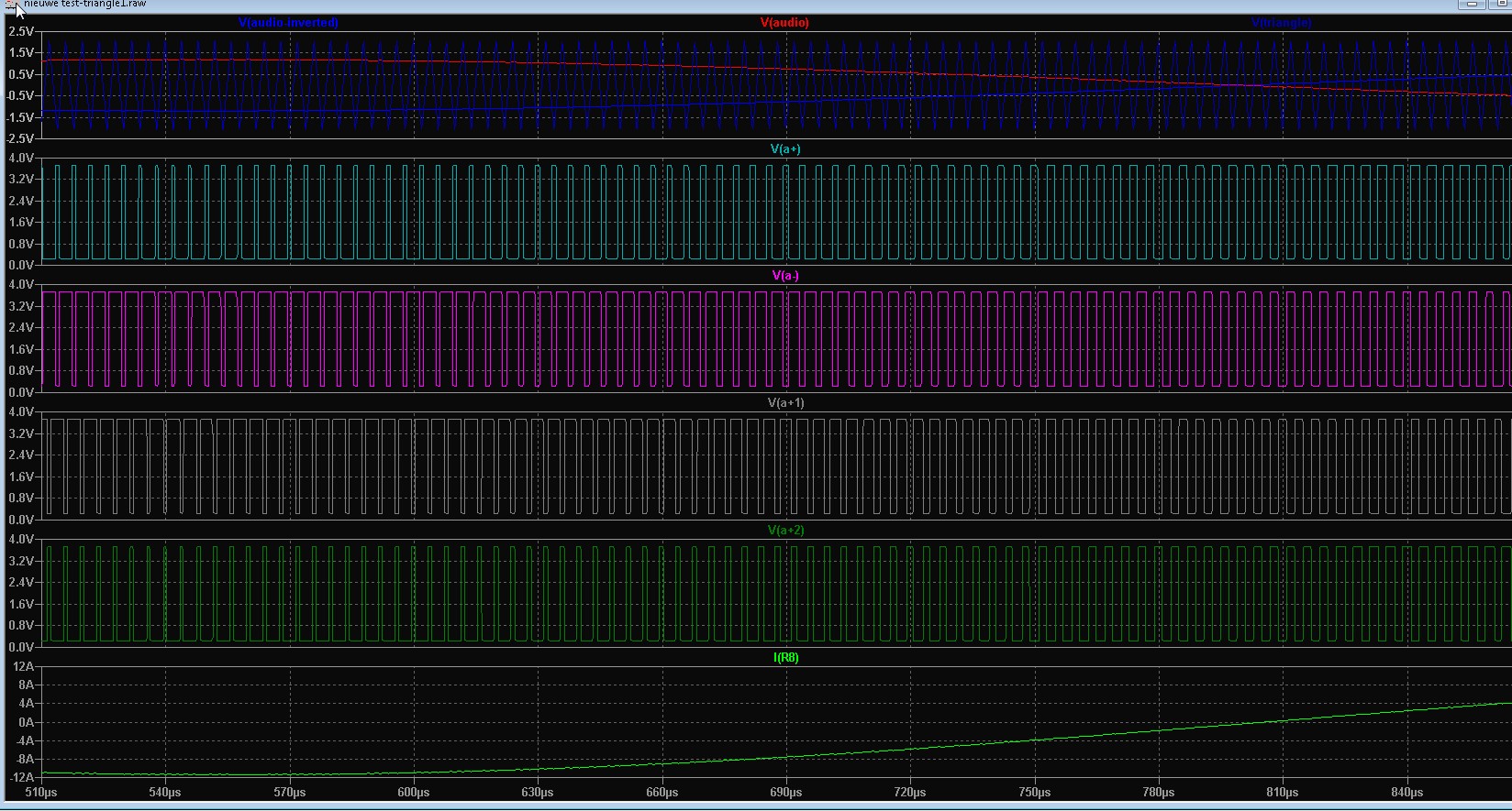

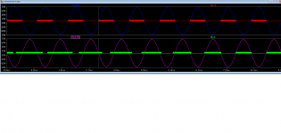

I see crossover distortion here...
Also why a+ corresponds with one sine, and a- does not correspond with other sine?
Ok I figured out why. on the schematics RC snubber is JUST ON ONE side, and missing on the other side. This was causing imbalance.
Adding snubber to other side, reduces THD 5 times, and now is only 0,05 %.
Also adding snubber to both sides, crossover distortion is not visible any more !
Did you swap the input signals to the Vswitches when the inverters were in the circuit?

Last pic uge current, that is not possible with the given output signals going from zo to plus, and minus rails, maybe @grizlek it is in the models? setup pf switches or diodes? freewheeling current?.
