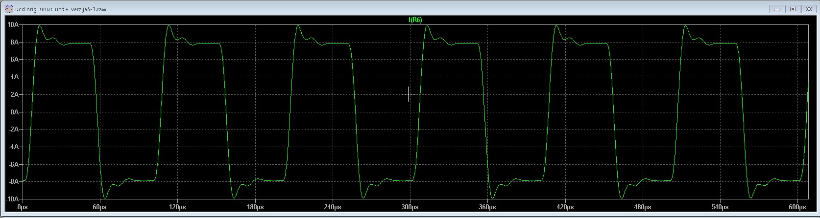

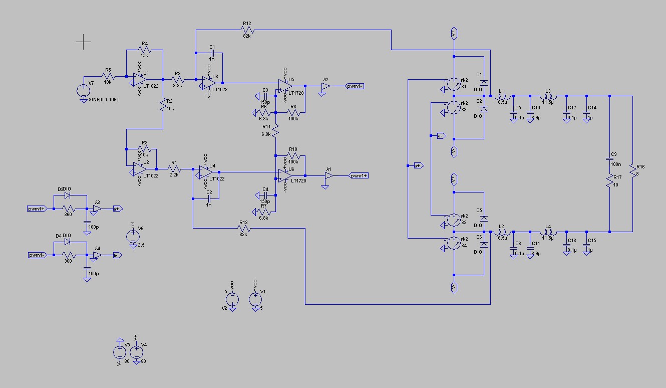

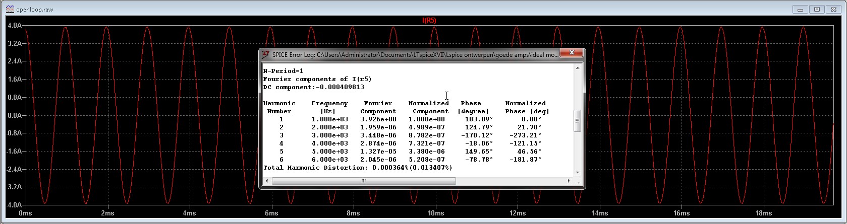

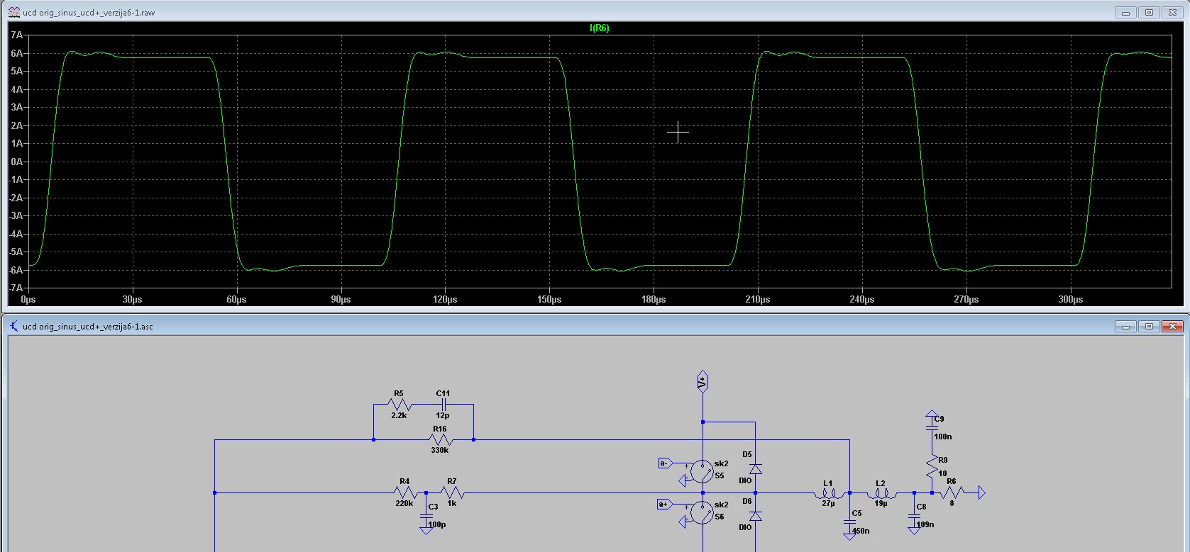

I have try now a combination of things like a extra integrator, capacitor current feedback and voltage feedback.
I get quite low distortions, even with a dead time 250nS I get -80 dB with 4 amp output current.
regards

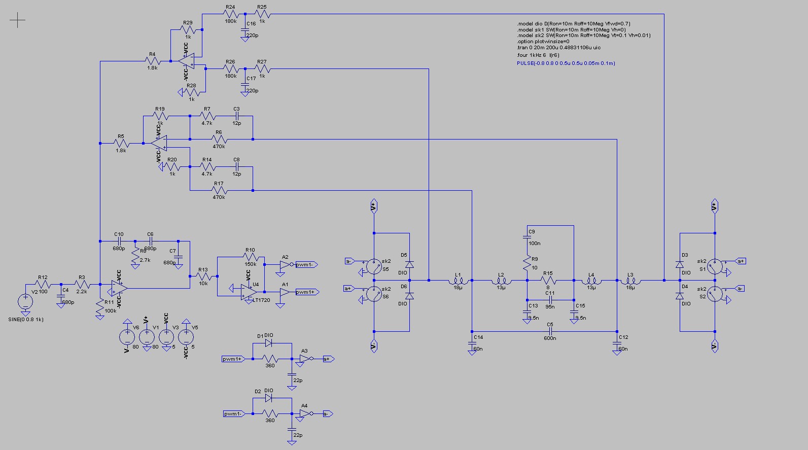

This is related to the latest schematics ?

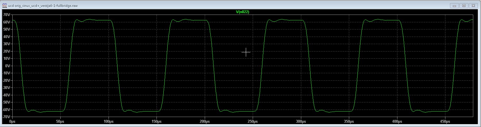

This one, double feedback, voltage, the current is not yet very stable, but if quite faster regulation. Fase shifts are the big problem there, also with voltage the low pass poles do shift making things more complicated, it can be done, but needs more electronics.
I get however on 60 Khz a harmonic who I think is from the simulation itself, maybe in the parts models things are cause.
regards

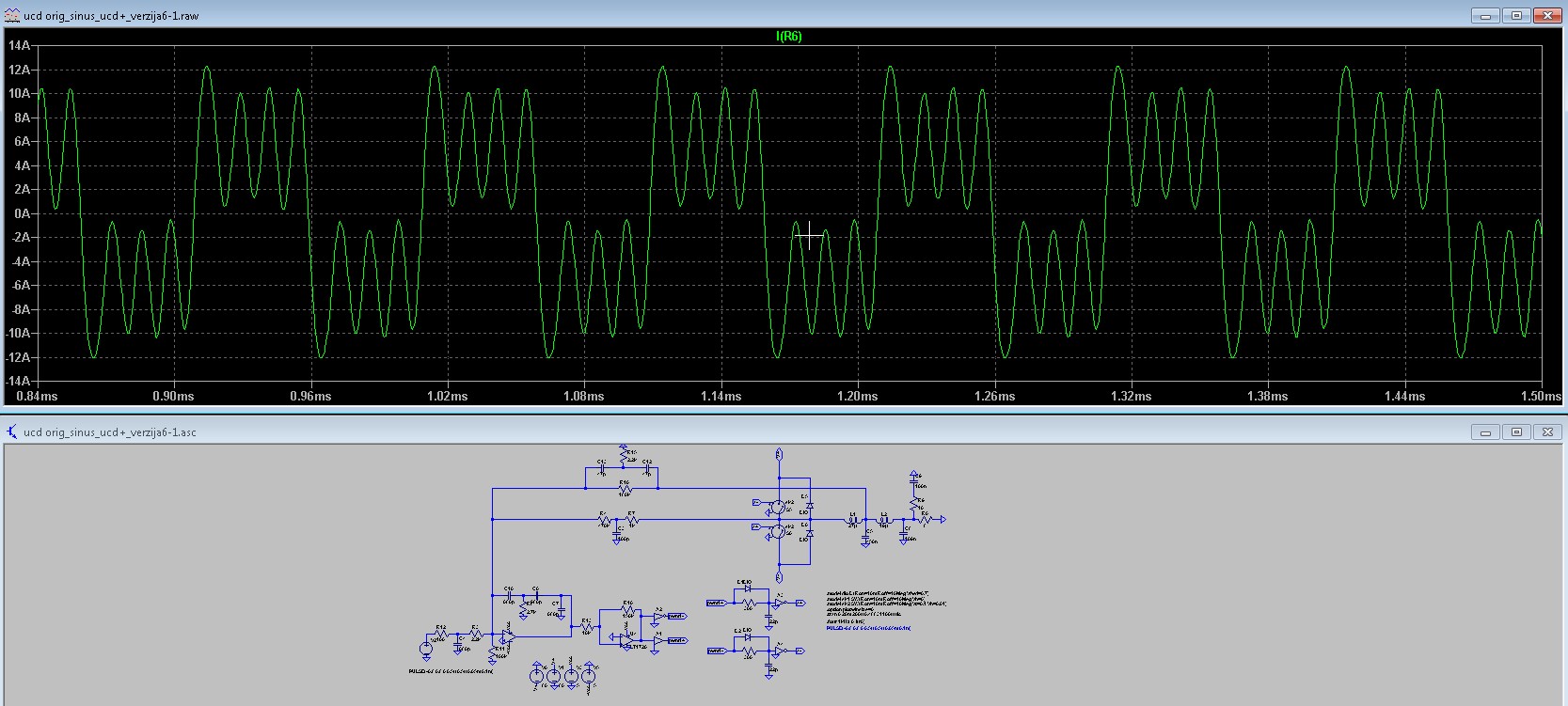

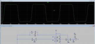

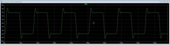

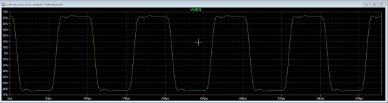

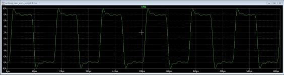

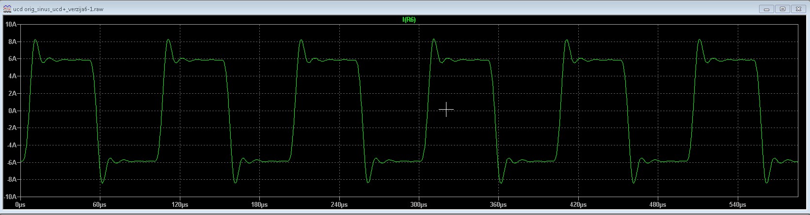

As you see I get very low distortions, the square test is unsuccesfull when I use post feedback as the dominant one, with the tuning of both feedback we can get a nice square test.

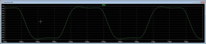

See some more pictures, after tune the feedback lines I see that the prefeedback do make a nice square, including the lowpass making it worse, after put in a little network with resistor and 12 PpF capacitor the peaks are gone, but do slow down the speed of the amp, the fastest speed is when use only prefeedback, so I do try that with a air coil and oil capacitor, both high quality, size is not important with a high end class d, and see what happens.
Current feedback I did try looks like work better when a 0.01 ohm resistor is between amp and null of the supply, amplify that give a nice triangle who can included in the feebback loop, not tryed that yet,
regards

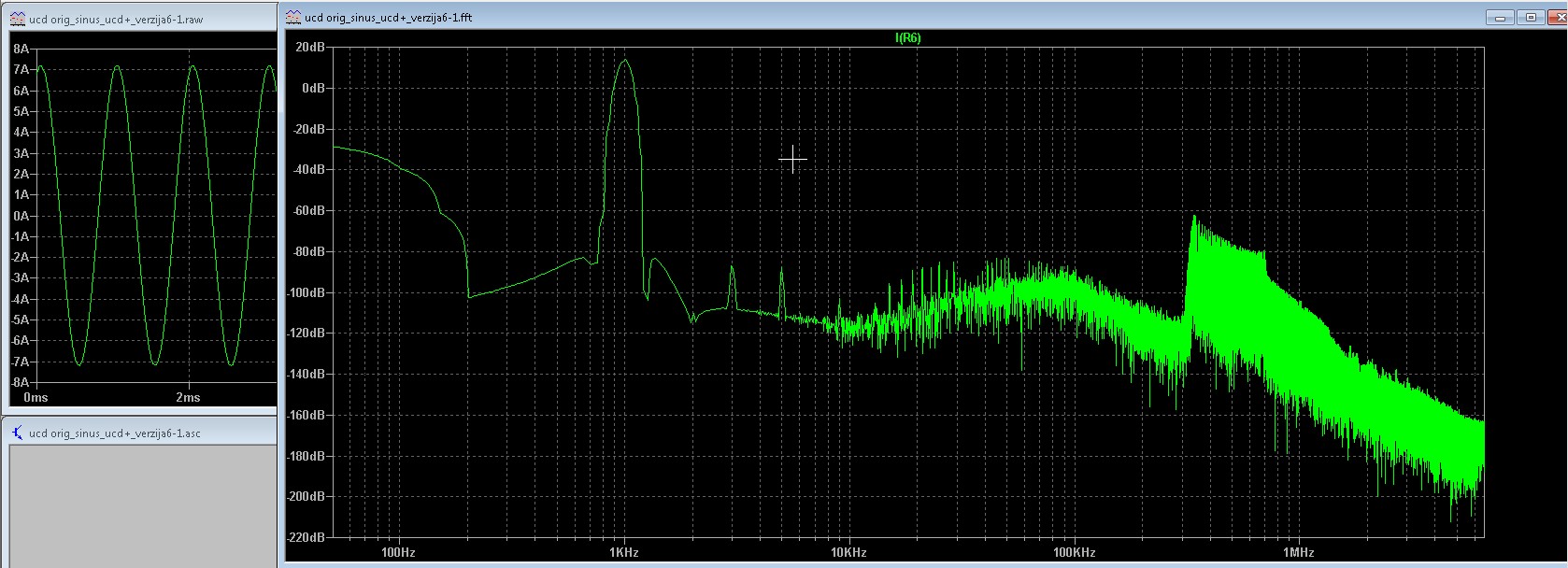

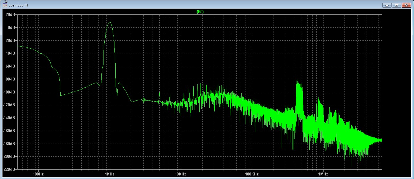

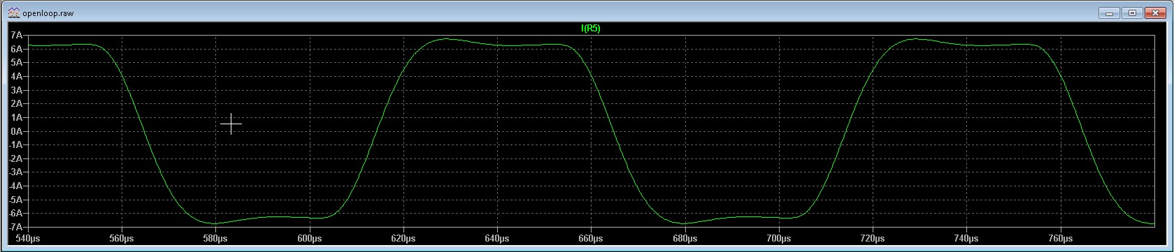

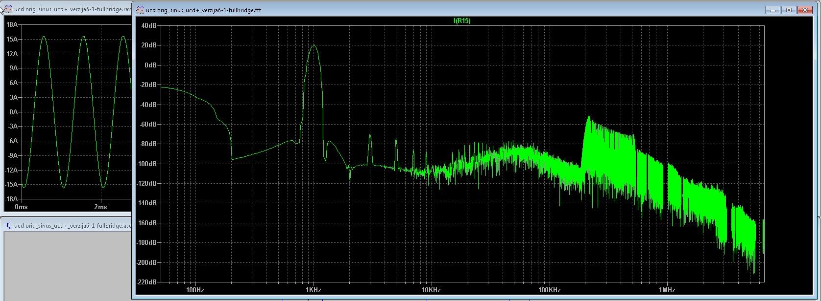

Here I see only uneven harmonics, and no even. strange for a single bridge.
but is low, on 8 amp output current.

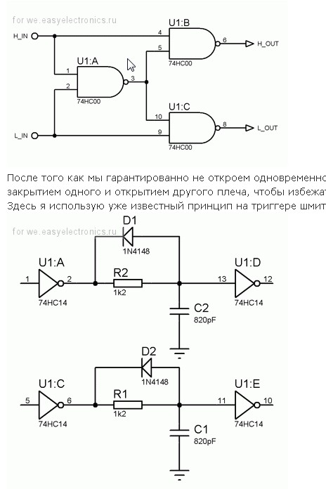

Question, what is the best way for dead time, see picture.

I am missing model, it seems you are using OPA134 ? It is slow audio op amp, try faster op amp?
Why about adding transistor network to shut down poles if when signal is too strong, to prevent unstability?
You can use LT1722 also for sim, the opa627 also is fast enough for input opamp.
LT1722 is in your ltspice.
a AGC is possible yes, but two diodes antiparalell and good setup feedback will do, use a series resistor for soft clipping, this is enough, just make enough power output so you never reach diode clipping exept with small accidents?.
OPA134 is 8 Mhz, 20 V/us opamp, so quite fast and very good sounding ones also, the OPA627 is best, but expensive.

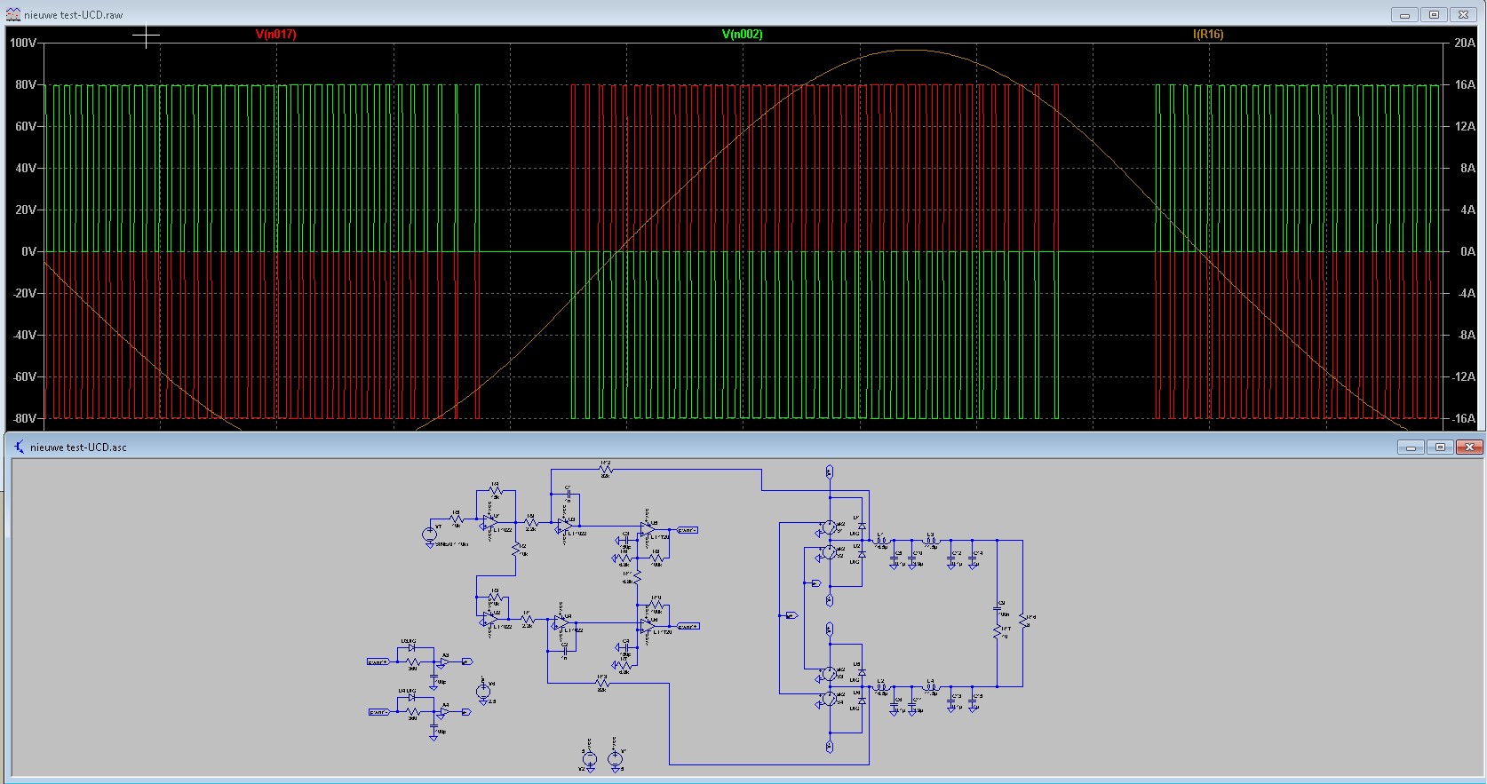

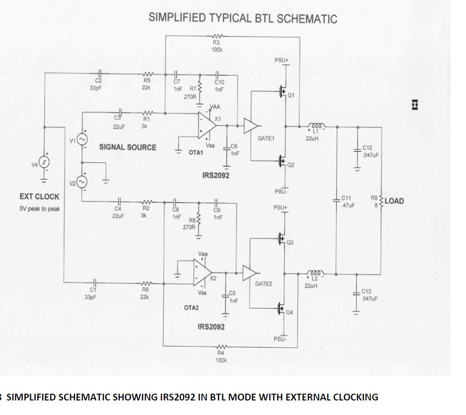

I have play with a BD modulator UCD, self osc.
I get quite shoot through's so I do something wrong, maybe I need some more info about these, it is quite a nice idea, even usable with buck converter like output, act as a class ab, small pulses injection I have seen, making it a bi version bd.
someone here can advice me why I get such shoot through, I do see both negative and positive are in line, making it short circuit, in paper I see both a shifted 180 degrees so it do not make trouble.
regards/
Someone? I try this and get not what I want, like the BD modulation scheme as in pic two and lot shoot through. Need the 1 Khz modulation input a offset? like minus for the lower comparator and plus for the above one.
I thought this is not complicated, it is not but sim not oke. Some help welcome.'I read some papers about this and the buck converter system looks nice.
