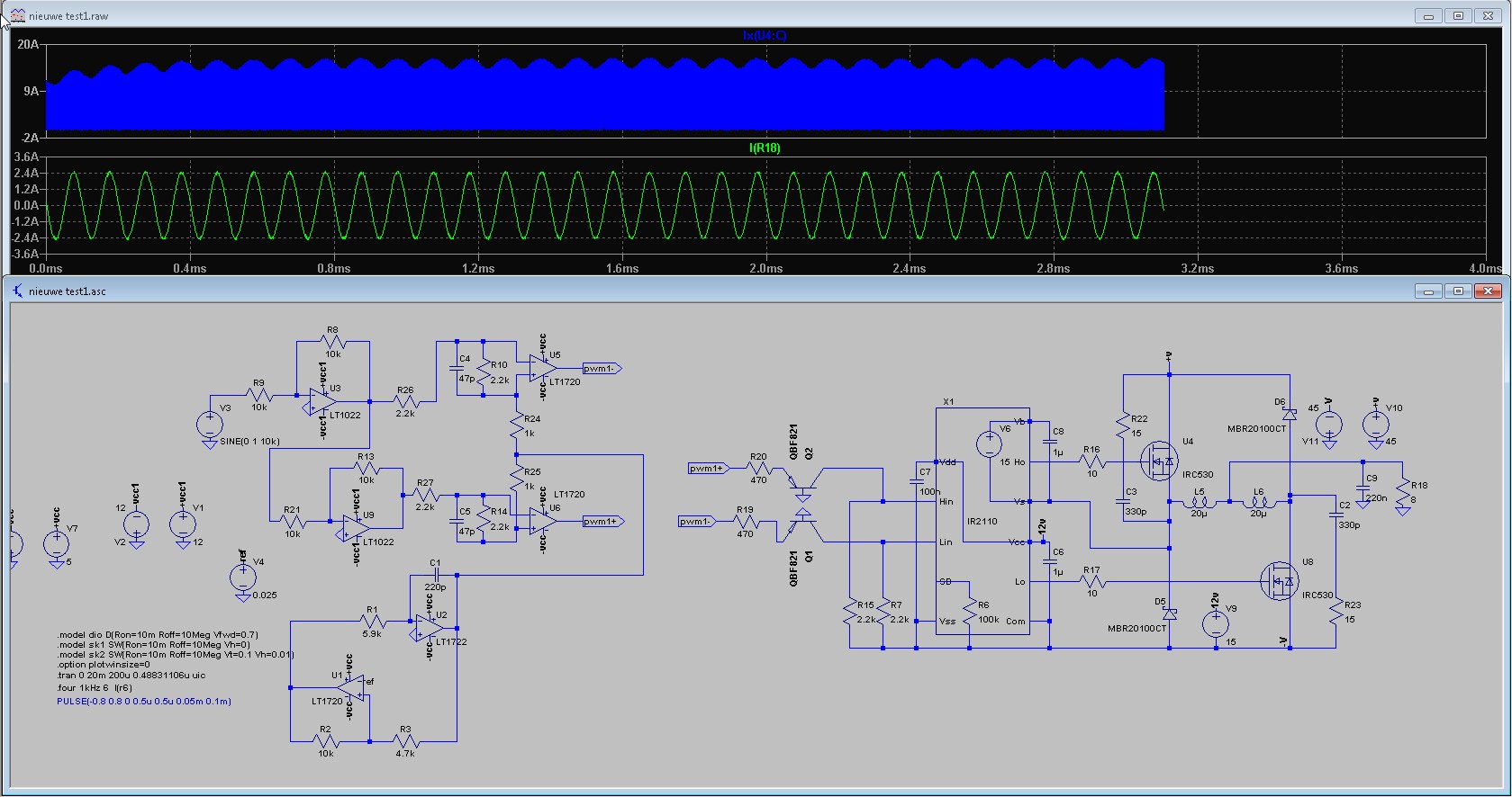

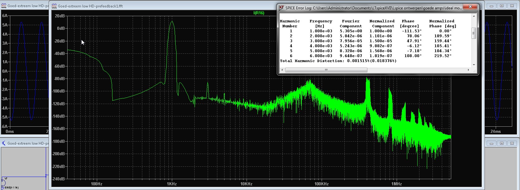

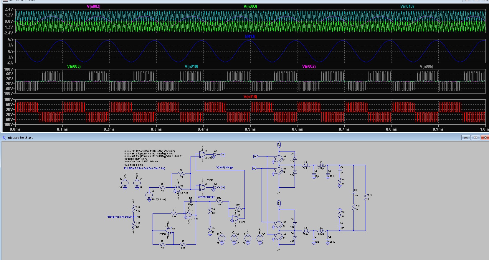

Ok I figured out why. on the schematics RC snubber is JUST ON ONE side, and missing on the other side. This was causing imbalance.
Adding snubber to other side, reduces THD 5 times, and now is only 0,05 %.
Also adding snubber to both sides, crossover distortion is not visible any more !
Thanks for the help, now I see, why things go wrong, I feel very stupid today, I am used to put snubbers over the speaker, not to ground.
I keep in mind for future.

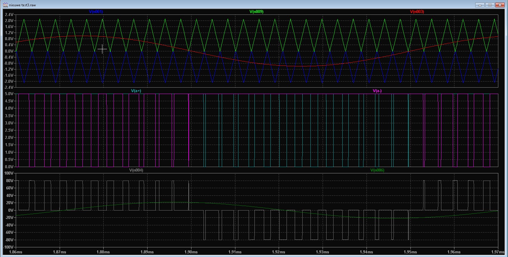

Hi, I had a strange result with that prior circuit. When I added a bit of dc offset to the grounded pins of the comparator to add a bit of overlap, it increased the crossover distortion, regardless of the direction of the offset.Hi
I did simulate as it was, after editing by you. <snip>
I observed how the Vswitch drive was high when low was needed for off-state, for one of the Vswitches. That was causing the very bad cross-conduction. That was on the both the prior and most recent circuits.
My thought about the switching of the output going from rail to rail rather than just from rail to output is that the output choke is resetting itself through flyback. I made some changes on the latest circuit to remove the 8kva shoot-through, and the amount of flyback was so great that it was cancelling out almost all of the audio output with a 10khz audio input.. Apparently, the 8kva shoot-through energy had been absorbing the flyback energy prior to that.
That definitely showed some distortion.And overlap the triangel a lot, well, give trouble.

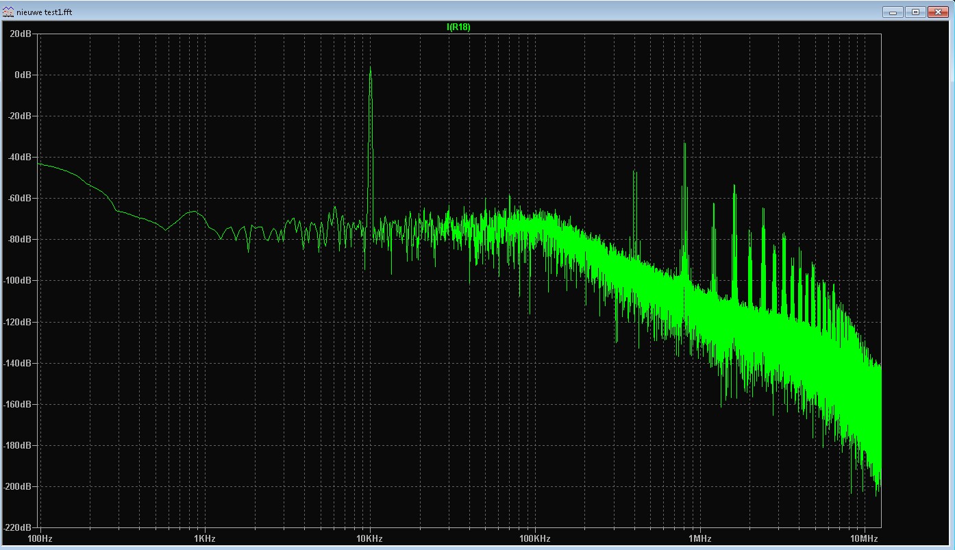

Still I have problems, the promised book respons is not there I did try this like crown amp does, but also here strange things happen, the bias adjustment however do work, changing the triangle offset against th audio input signal do give bias, I can even adjust for 70 amp bias😱
But I do not see the right respons of output stage as a 3 level has to do.
Oops that was a wrong plot.
regards
The last pic of crown, here I did again see errors with sim, the nodes where mess up, like comparator output was on mosfet gate, en vica versa was all troubled, the output however was as it has to be.
The IR2110 mosfet output I use was from @Tekko I hope he don't mind.
Distortion of open loop triangle version is quite low. I have use parts of the crown schematic, like the resistors on input comparators and #tekko output.

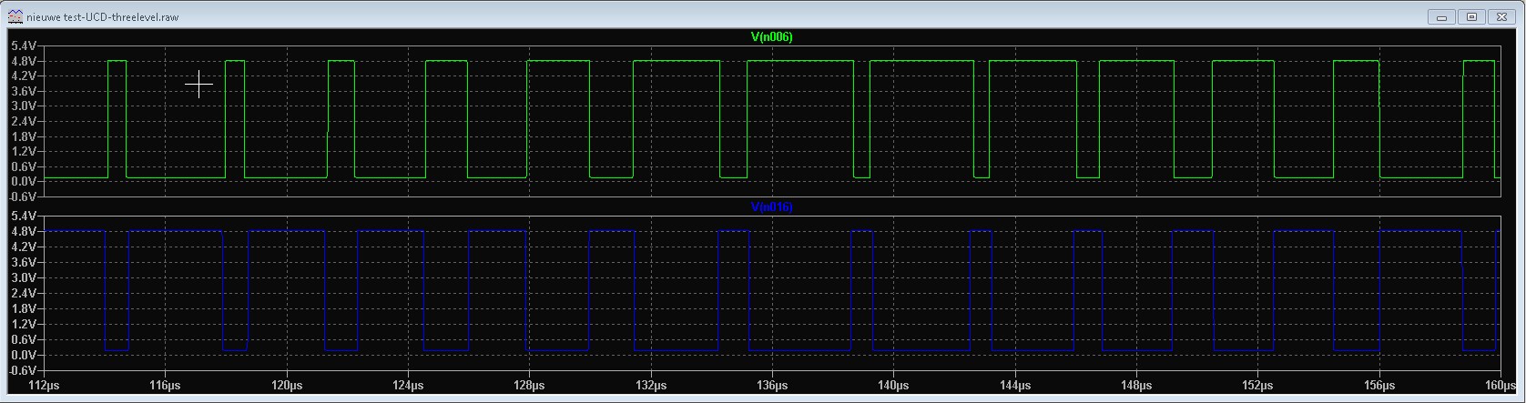

I was thinking similar to that--it should be better to invert the audio rather than the triangle wave.
Still I have problems, <snip>
I am not interested in triangle generated D class at the moment .., only in self oscillating, those self oscillating are much better. (I presume so)
I am refering to three loops in relation to self oscilating version, no triangle generattion ..
I do try both, the version we have do work, needs some polish and more, 3 level and self oscillation is quite tricky.
a triangle version is for shure not more bad then self oscillation, with a liniair triangle I get quite nice results, and it do not drop, it stays where it is, and double the frequentcy also, so using 400 Khz it doubles to 800 Khz, with a 3 level, self oscillation do not.
I am on this time do learning about more kinds of technologies, so I need time. and also understand, mine goal is no feedback if possible, using air coils and oil cap lowpass, so we need 3 level for much as possible suppression of carrier, special because of aircoil. keep follow me.
your help is welcome, thanks already for the simulation files.
The trianlge wave is not needed to invert, one above and one beneath the zero, I did invert one but is not needed, this because of double sided modulation what occurs with a triangle, a saw tooth is an other cookie who need inverted then.
Using one triangle who is above zero or from zero and up and invert the audio do work also, I use then the half sinus of signals.

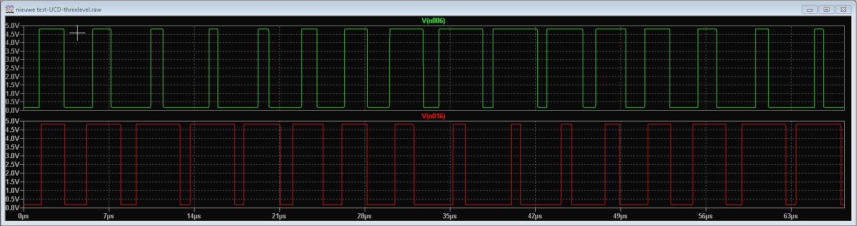

Book are a little confusing about 3 level modulation, but it is quite interesting because it doubles the carrier frequency and and make ripple suppression a lot more easy.
If I do see well, the triangle can be used the way as on pic, inversion or not inversed change nothing, because of the double sided modulation, I am right?

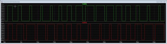

I am busy with one who has three feedback paths, and a way to let it oscillate very tightly, it can do three level but still do not want wel, I presume that possible the comparators are the cause in ltspice, I use one who is for one supply only, I do not now if the signal for three level is also present on the comparator, strange behavior in spice with it.
Signal is as in pic, oke, has to work as papers say, and the other is when I change the output stage, now suddenly I lost the signal shift in pic two. But I get closer, so I con on learning about class d.
