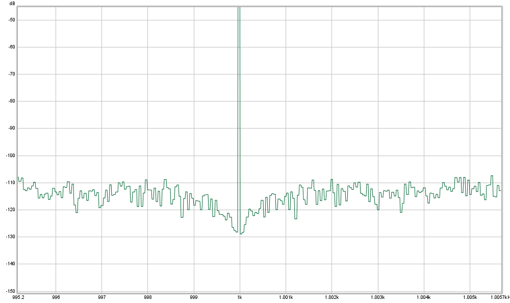

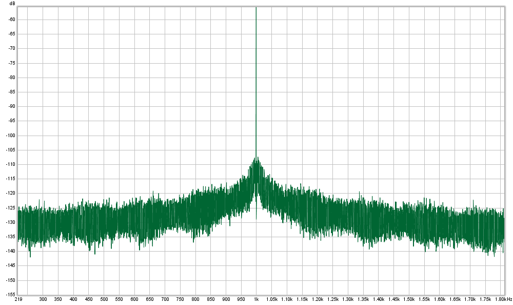

I modelled resistor excess current noise, multipling a pure bin-centered sine with an 1+x factor, x being a low-level pink noise.[...], but when a carb-comp resistor is subjected to an AC signal, it generates an excess noise proportional to the instantaneous amplitude of the signal, smearing and widening the original spectral line
It turns out that the resulting spectral line is still exactly one bin wide but the noise floor around the line is elevated. Zooming in, one can see that the noise skirt actually has a wing shape, very close to the test frequency levels drop to the value present at very low frequencies.
You know practical pink noise is band-limited at low frequencies? That's why you see the wing shape.
If pink noise were not thus band-limited it would have infinite power. Perhaps you can tweak your simulation to have more (or less) LF bandwidth to confirm if this is the explanation.

Confirmed. When I steeply high-pass the noise multiplier data at 100Hz the "wing center" get wider, exactly 100Hz to either side of the spectral line and the slope follows the highpass-slope. Interesting property of this kind of noise modulation I wasn't aware of, thanks again.You know practical pink noise is band-limited at low frequencies? That's why you see the wing shape.
