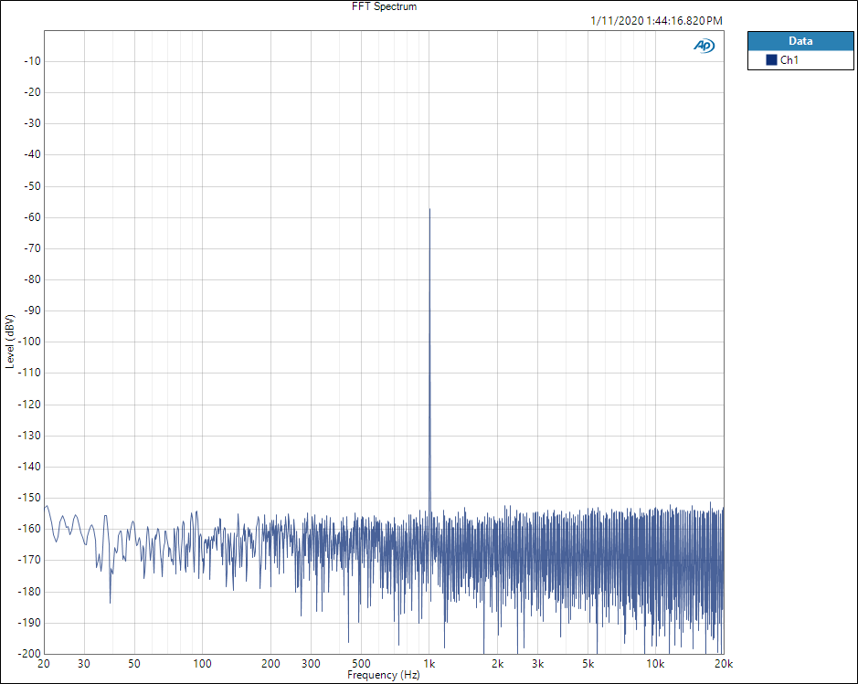

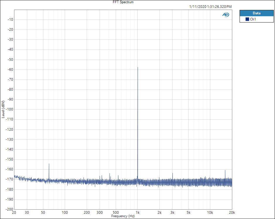

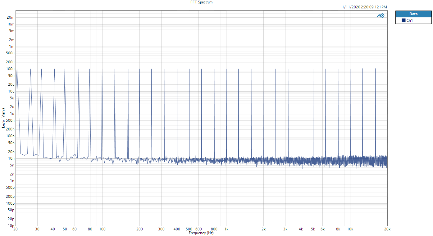

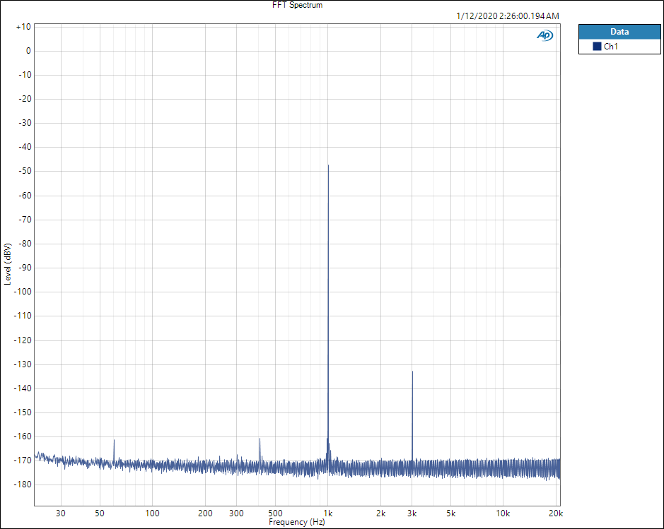

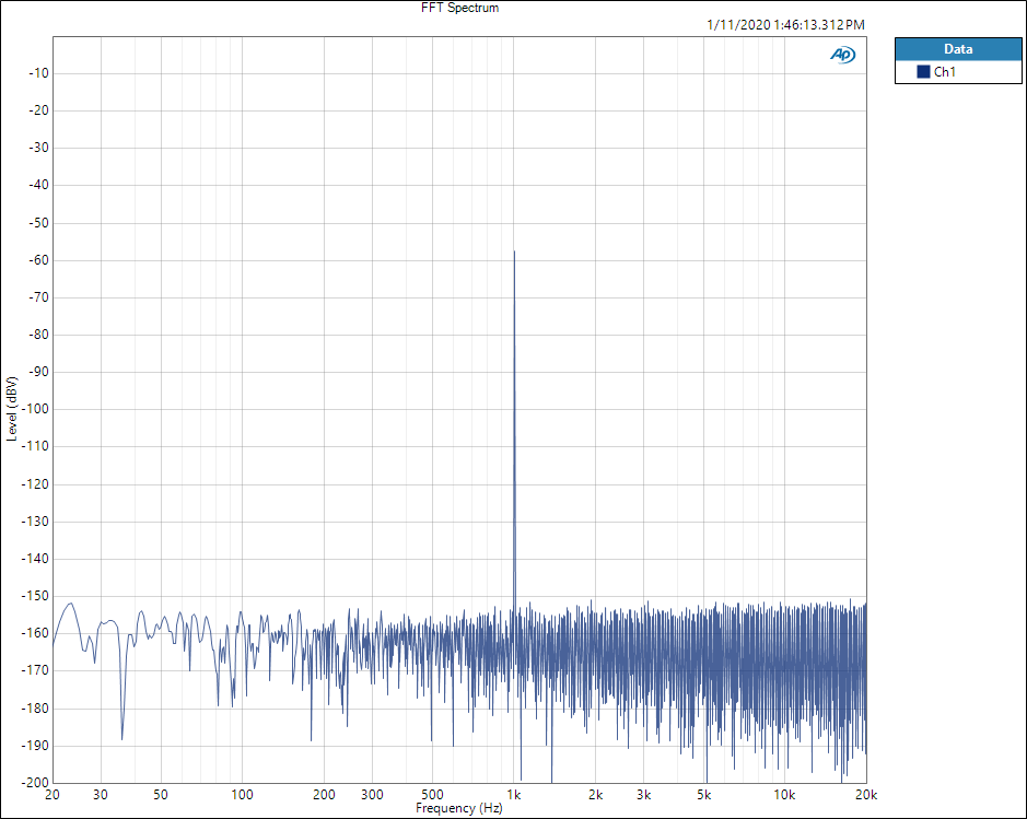

Hello All,
I went to Mouser.com and purchased a few PTF65 1K Ohm 0.1% 10PPM TCR resistors to do a little testing. See the attached test plots. I used the test Wheatstone-Bridge similar to the bridge used by Ed Simon.
Once you could see the harmonic peak at 3KhZ peak above the FFT noise floor it shot up quickly with increasing applied voltage. Sometimes there was a hint of a 2KhZ harmonic. Power or heat input goes up with the square of the voltage.
Note, long FFT lengths and a large number of averages reduce the apparent FFT noise floor. Also note that the levels of distortion harmonics we are talking here about are well swamped and masked by real time noise.
Thanks DT

Looks like your testsignal is almost -60dB? Is it ref 1V? So the testsignal is ca 1mV?
The TC and VC effects should only get to measurable levels MUCH bigger than that. ? Even using a CC resistor.
Could you do similar tests with large signals, and compare to 'worst type resistor' such as CC or the like?
Hello,
The test signal is 6.3 volts, or +16dB. That puts the 3rd Harmonic at -179dB relative to the input voltage.
Using 0.1% resistors allows for a deep null across the bridge.
See the attached plot with 20.0V +26dB input.
Note this is sort of proof of concept or not. There are 10 resistors in the test bridge. It seems to be a stretch to think that the measured harmonic spikes are isolated to only one or two of the resistors. At this point I am thinking that the measurements are in the category of relative or qualitative. I do have a box of CC resistors that I will pull off the shelf in the morning.
Ed, please tell us what you think?
Thanks DT

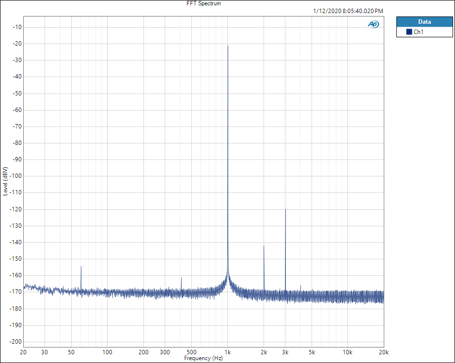

At 6.3 Volts into a 1,000 ohm resistor the distortion as shown if I read things right, was .707 nV without allowing for the distortion of the other resistors in the bridge. The thermal noise of a 1,000 ohm resistor would be around 4 nV per root hertz. (The distortion of the 4 resistor unit should be 12 dB less on each side and the result is doubled by the bridge technique assuming the resistors behave similarly. So the absolute error should be less than 25%. Not bad for a signal so low in the mud. Useful for comparing to other resistor sets.)
The distortion rises with the square of the applied voltage.
As shown the perceived noise (critical bandwidth) and distortion would be equal with the resistors under test operating at 33 mW. Above that power level the distortion would rise above the noise as perceived.
