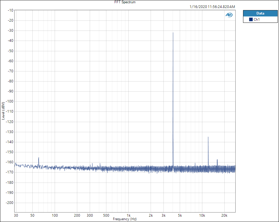

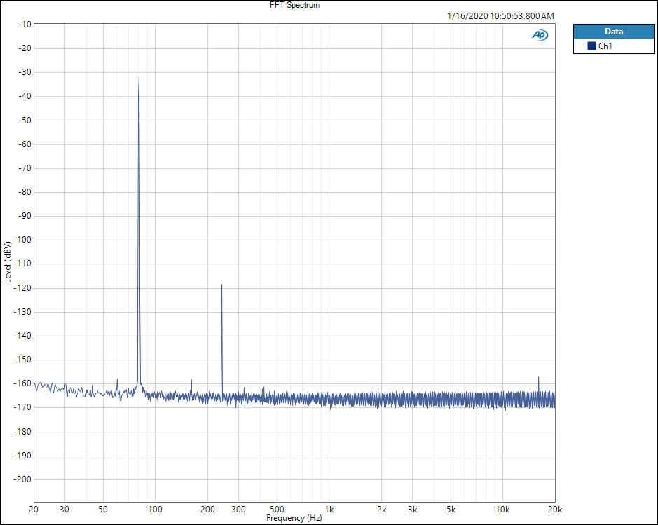

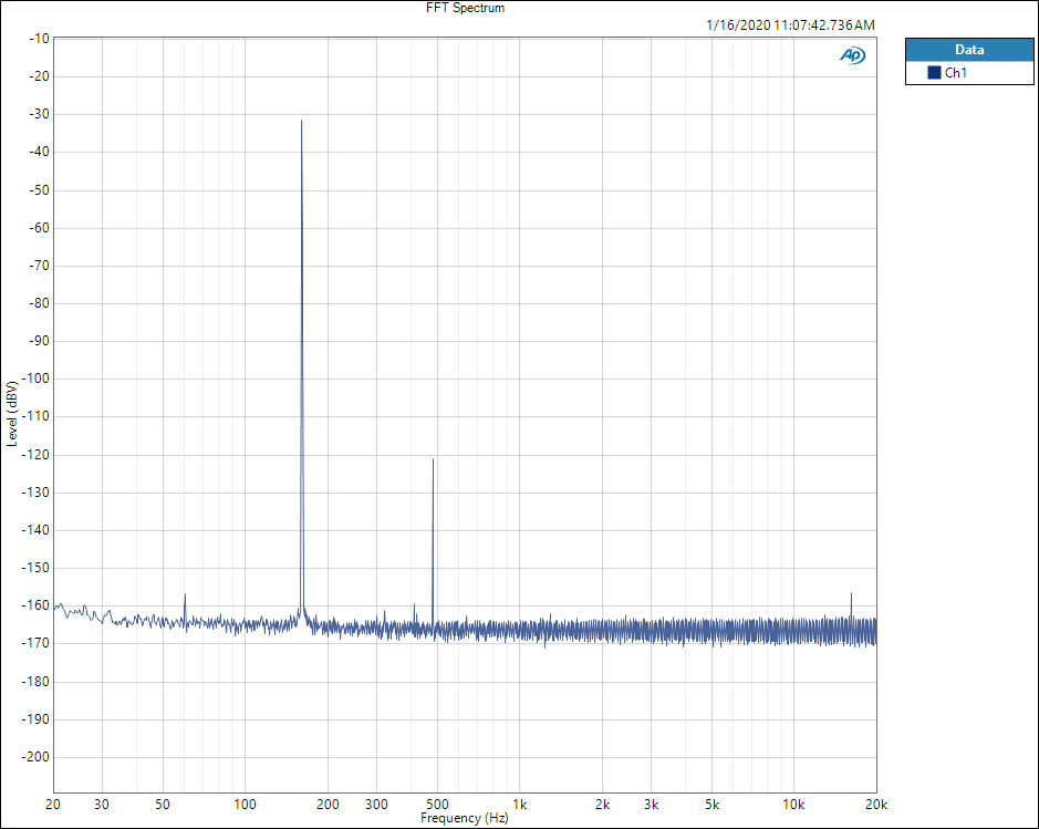

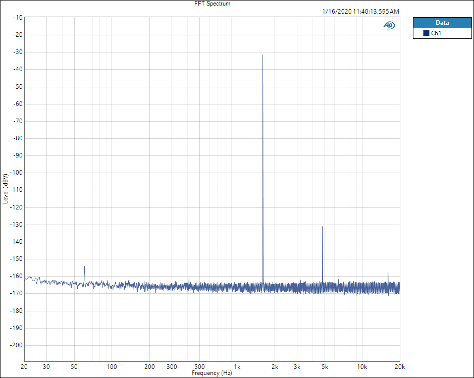

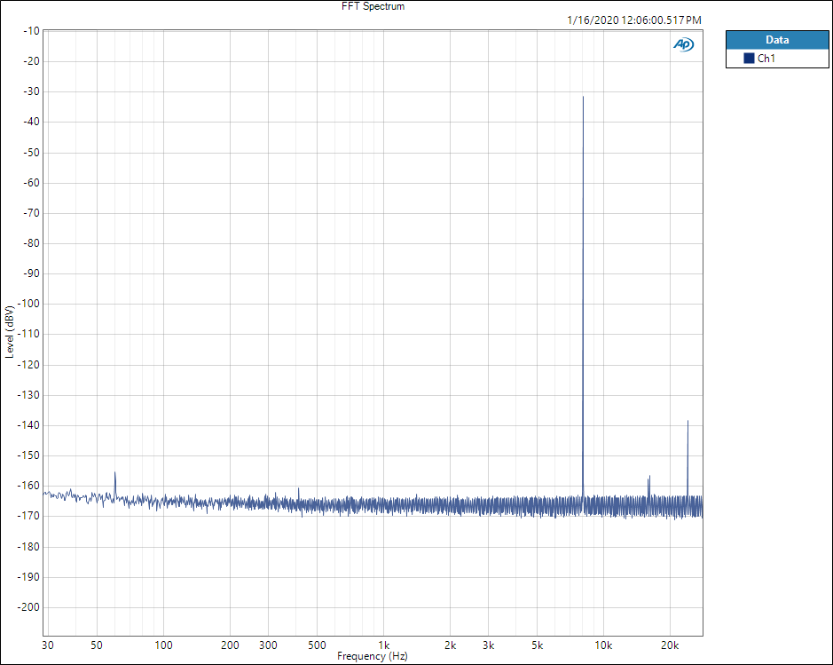

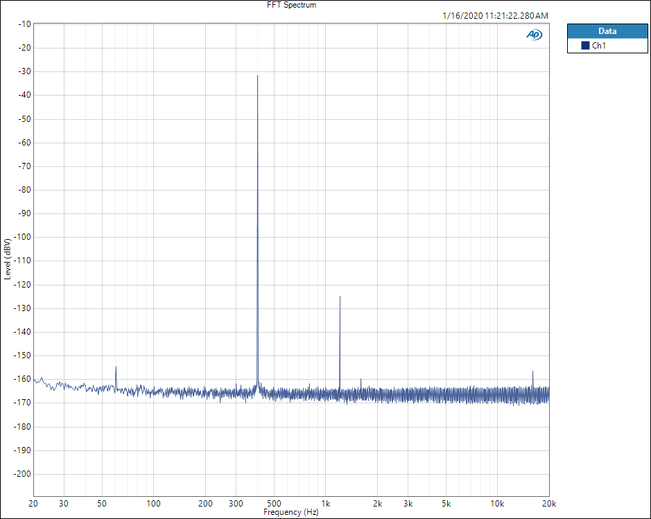

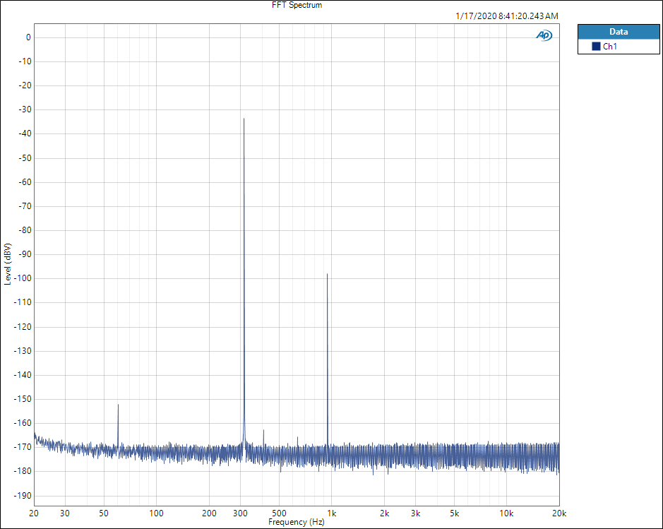

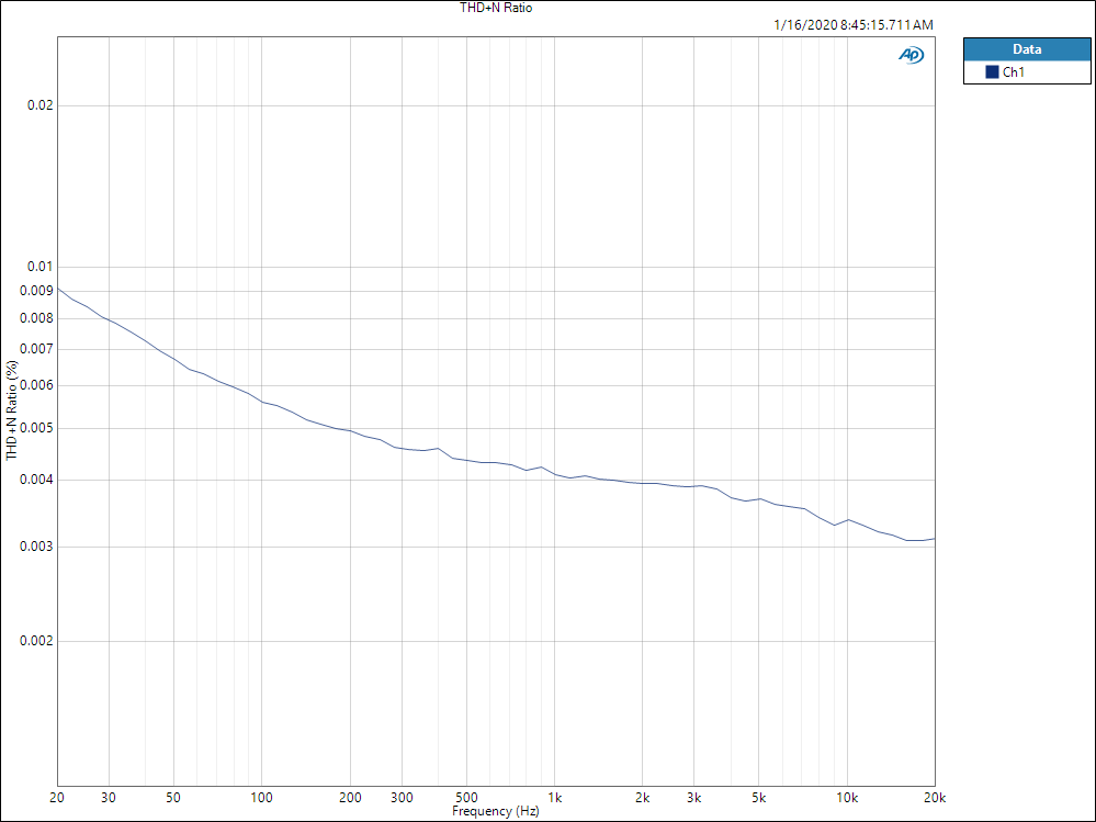

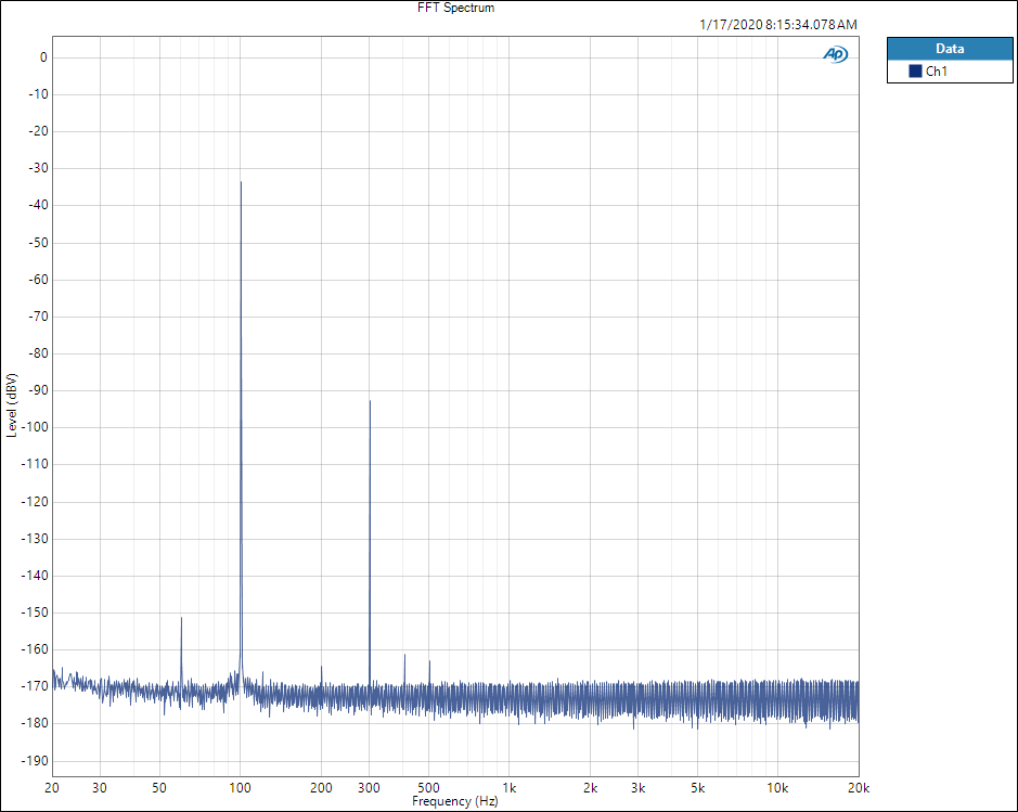

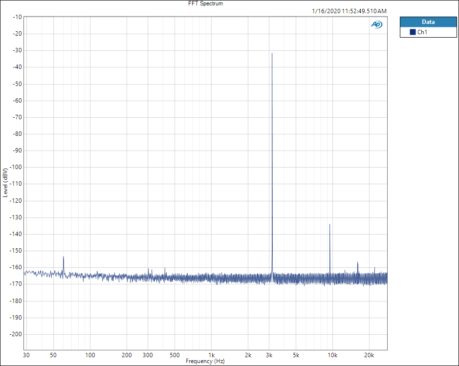

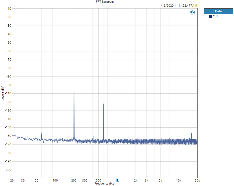

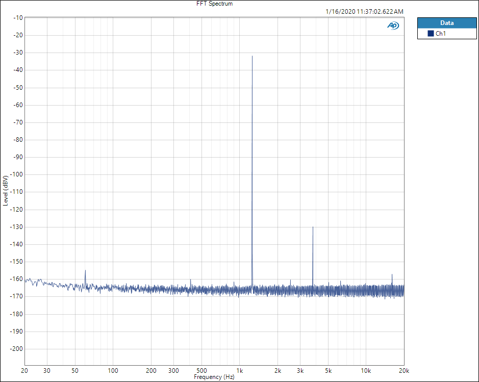

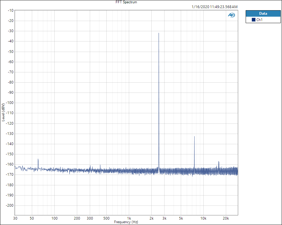

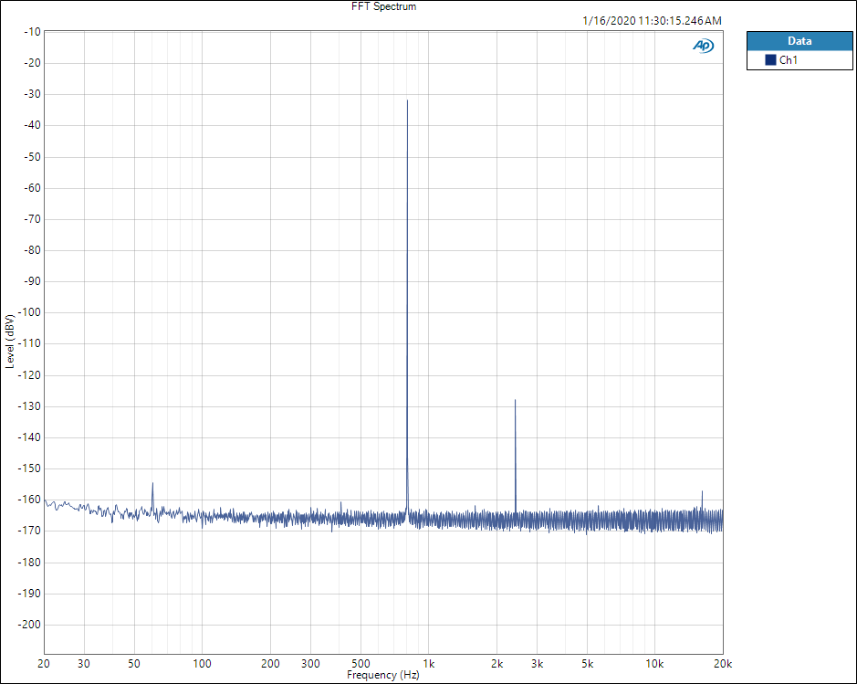

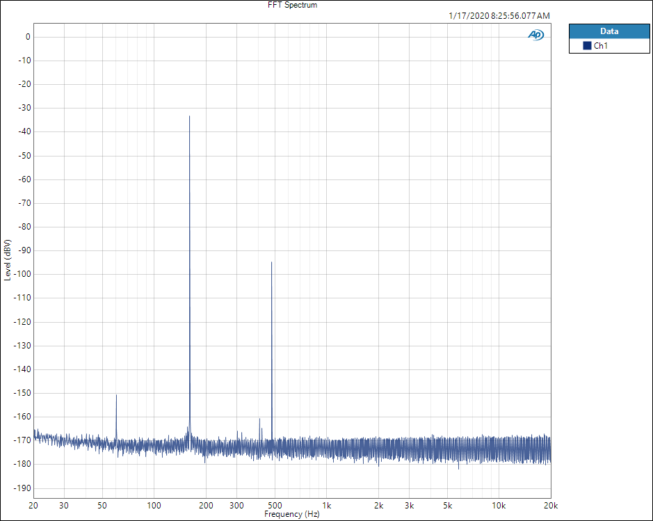

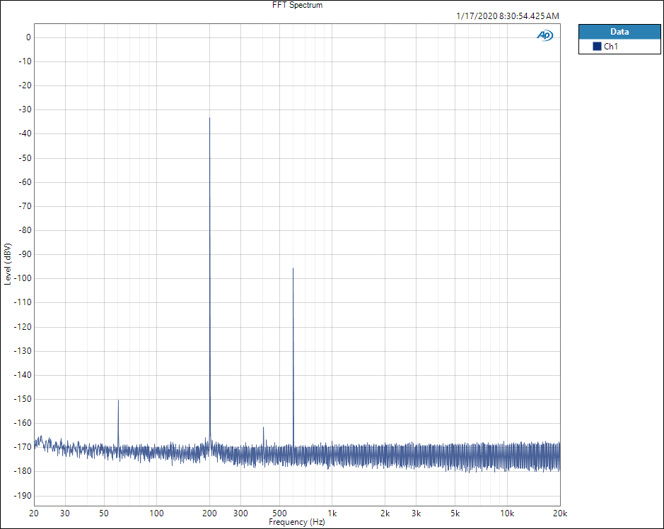

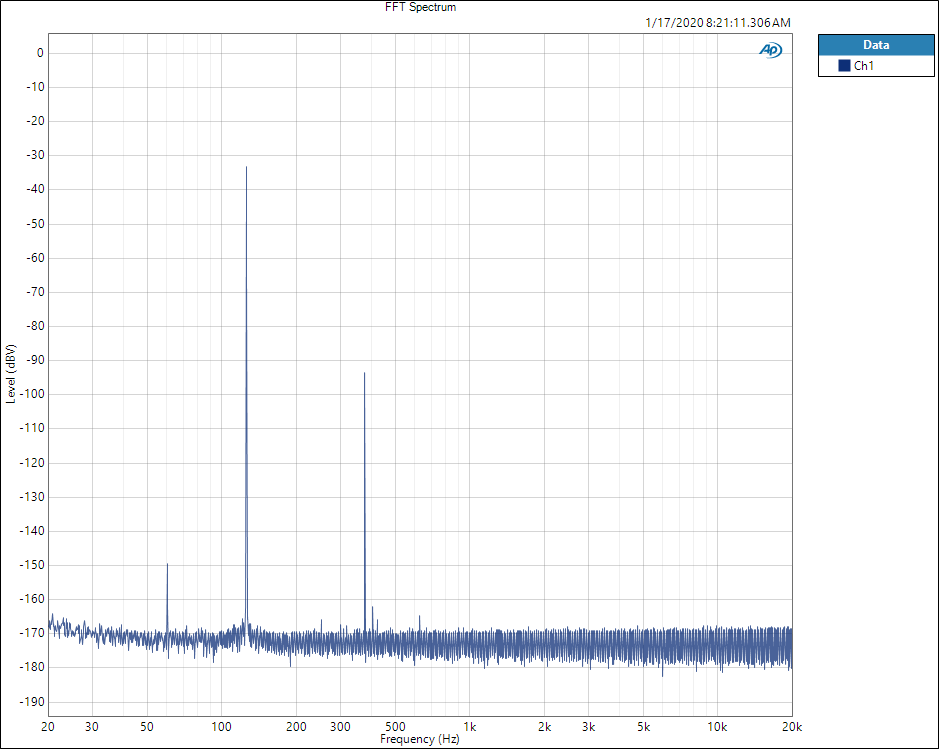

10 Vishay 1K Ohm 0.01% foil resistors are coming to my mail box today. 2 are going into the test bridge with the 8 Vishay PTF65 thin metal film reference resistors.
I ran a THD+N (20 volt) sweep, from 20 to 20K with the all PTF65 test bridge, that shows gradually decreasing THD+N with increasing frequency. Less steep in the middle from 500hZ to 3KhZ. See the Attached plot.
Later I will run the same sweep with the foil resistors to see if there any of those foil lumps or bumps in the THD+N plot.

DT I think you are measuring the noise and self-distortion of the AP which most likely is higher than the resistors.
Do a loopback and see if it is different. These measurements can normally only be done sensible with FFT techniques.

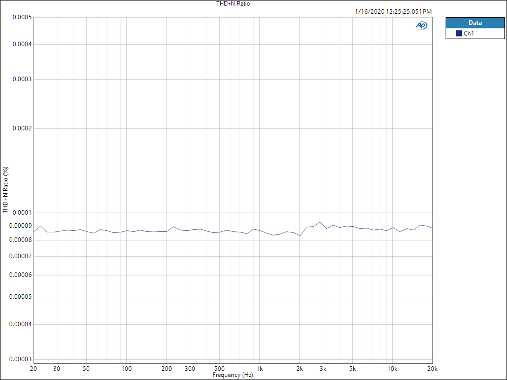

@Jan,
This is the instrument loopback with the same settings. It is not an apple to apples comparison.
The bridge setup has a large external null at the test frequency. I will need to break in and compensate for the null in the THD + N calculations.
The sweep plot of the test bridge does have a completely different shape compared to the loopback curve.
As you are interested in the frequency vs FFT’s plots they will be in the following post.
Thanks DT
@Jan,

Ahh yes the bridge, slightly complicating things. I was looking at an easy way to do a selftest first. Maybe do a run with the two bridge outputs shorted so that the only thing measured is the CM signal. That should be interesting.
Lookng forward to the actual FFTs!

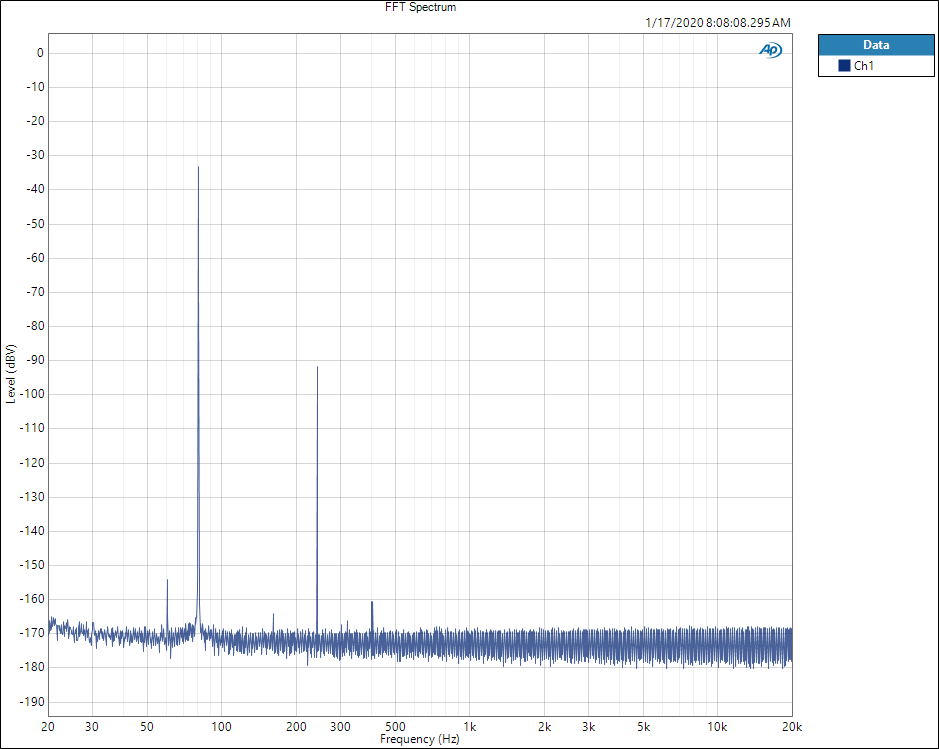

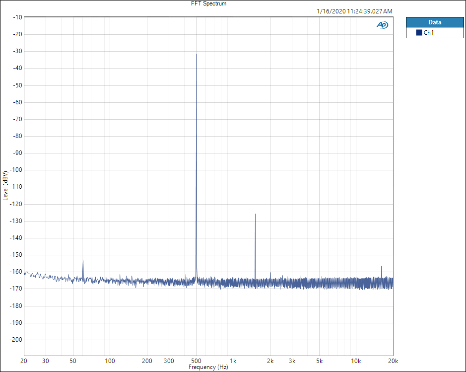

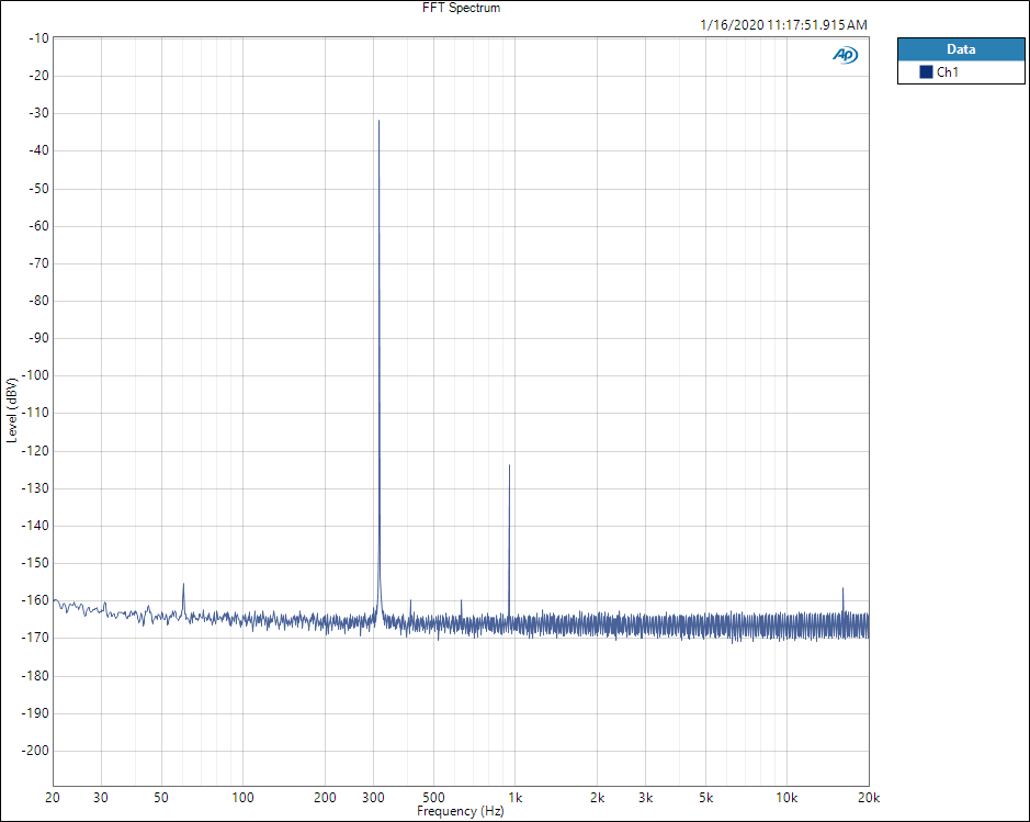

@Jan,
Too many plots?
I suppose that this could be automated and put all the plots on one graph with an offset looking like a waterfall. We will see. Using the all thin film NiChrome metal film resistors; 1K Ohms 0.1% 10 ppm, there are 21 plots stepping up from 80hZ to 8KhZ. As the frequency increases from 80 to 8000 the 3rd Harmonic smoothly decreases 20dB’s over that frequency. At that point the 3rdH falls off the high end of the frequency scale.
The file name of the plots includes the test frequency. All the tests were done at 20 Volts input.

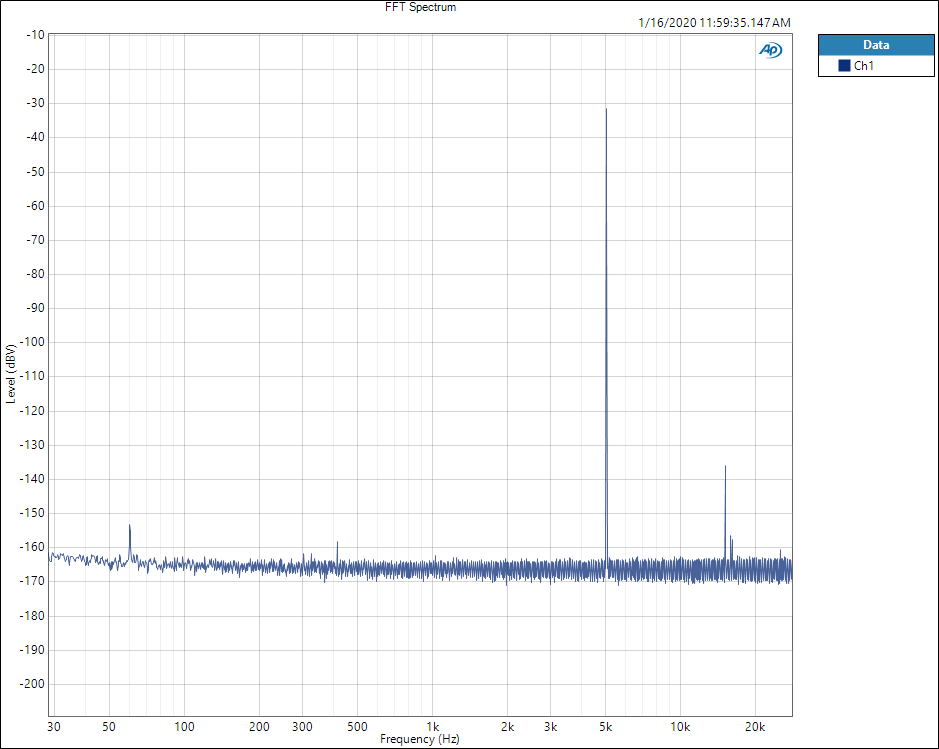

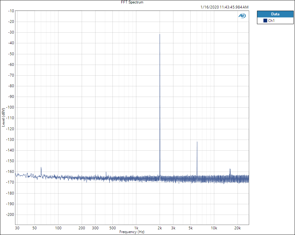

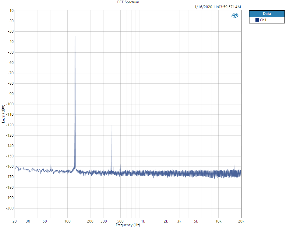

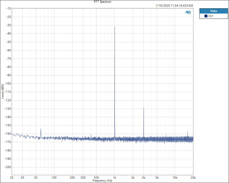

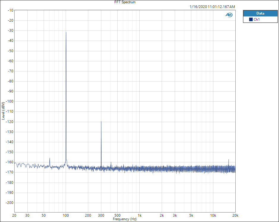

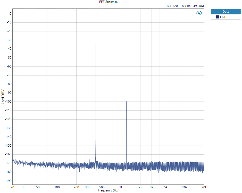

DT, impressive work. I have one Q though - why is the fundamental shown at about -30dB? Is that the attenuation of the bridge?
20V to -28dBV?
20V is +26dBV so if your 3rd shows -130dBV that 3rd is actually -156dB below the fundamental.
To avoid possible confusion is to set the graph to dBr and set the dBr reference for that channel on the AP to +26.
Then again, the input may be 20V, but what is the input across the resistor under test? These are sneaky things.
Jan
20V to -28dBV?
Jan
@Jan,DT, impressive work. I have one Q though - why is the fundamental shown at about -30dB? Is that the attenuation of the bridge?
20V to -28dBV?
Jan
Yes about -30dB is due to the attenuation/null of the bridge.
Yes the input is 20 Volts RMS.
Yes the 3rd is actually -156dB below the fundamental.
The delta across each single resistor under test is 10 Volts and 10 Volts across the reference resistor (4, 1K resistors in series and parallel, the assembly equaling a total of 1K).
Sneaky and tricky to put your head around all at the same time. Then try to calculate the heat inputs and temperature rises and model the distortion and noise.
My thought, measure first then model and calculate.
Thanks DT

Edit: about 30 db +26 = about 56dB so 56+ the measured -120dB is a total of -176dB's 3rdH
So then should we not use 10V across the test resistor as reference? 20dB instead of 26dB for 20V?

Yes,
I believe it is even more more sneaky after that.
There are two resistors under test one in the top of the bridge and one in the bottom on the other side of the bridge. The voltage and distortion across each are equal and opposite to each other, effectively doubling the delta measured across the bridge. If both of the resistors were both on the top or bottom of the bridge they would cancel each other leaving nothing to measure.
I am afraid that I still need to close one eye and stand on the other foot to get a handle on this thing.

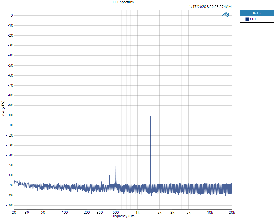

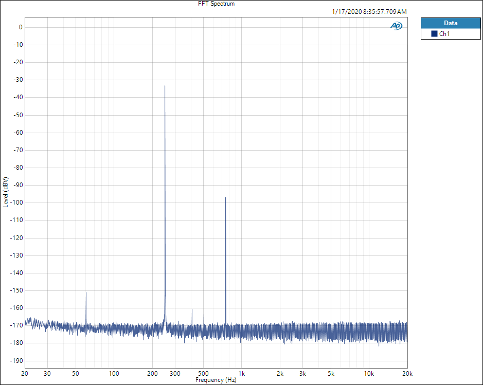

@Jan and All,
You were right in your math adding up dB’s.
Meanwhile I am going to keep the test procedures largely the same and do the test bridge accounting after the fact. I do not want to measure the foil resistors with a dBR scale and have different and confusing plots.
That being said I did do the set of FFT vs frequency plots for the Vishay S102 1Kohm foil resistors, this time with 10 averages rather than 20. The plots went faster and look nearly the same as the 20 average plots. The rest is same same with 20 Volts input to the test bridge.
The surprise to me is how much more distortion the foil resistors produce compared to the thin film / metal film NiChrome resistors (Vishay PTF65 resistors)
