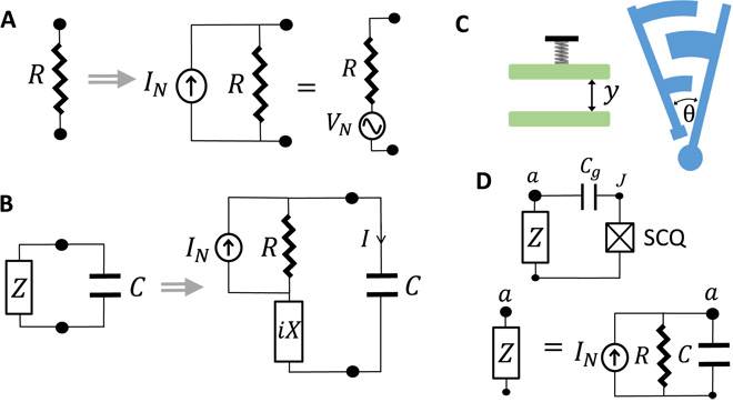

If this thesis is fact, then we may never get lower distortion than metal film.
The foil resistors introducing a casimir effect.
Electronic zero-point fluctuation forces inside circuit components
https://arxiv.org/pdf/1612.03250.pdf
