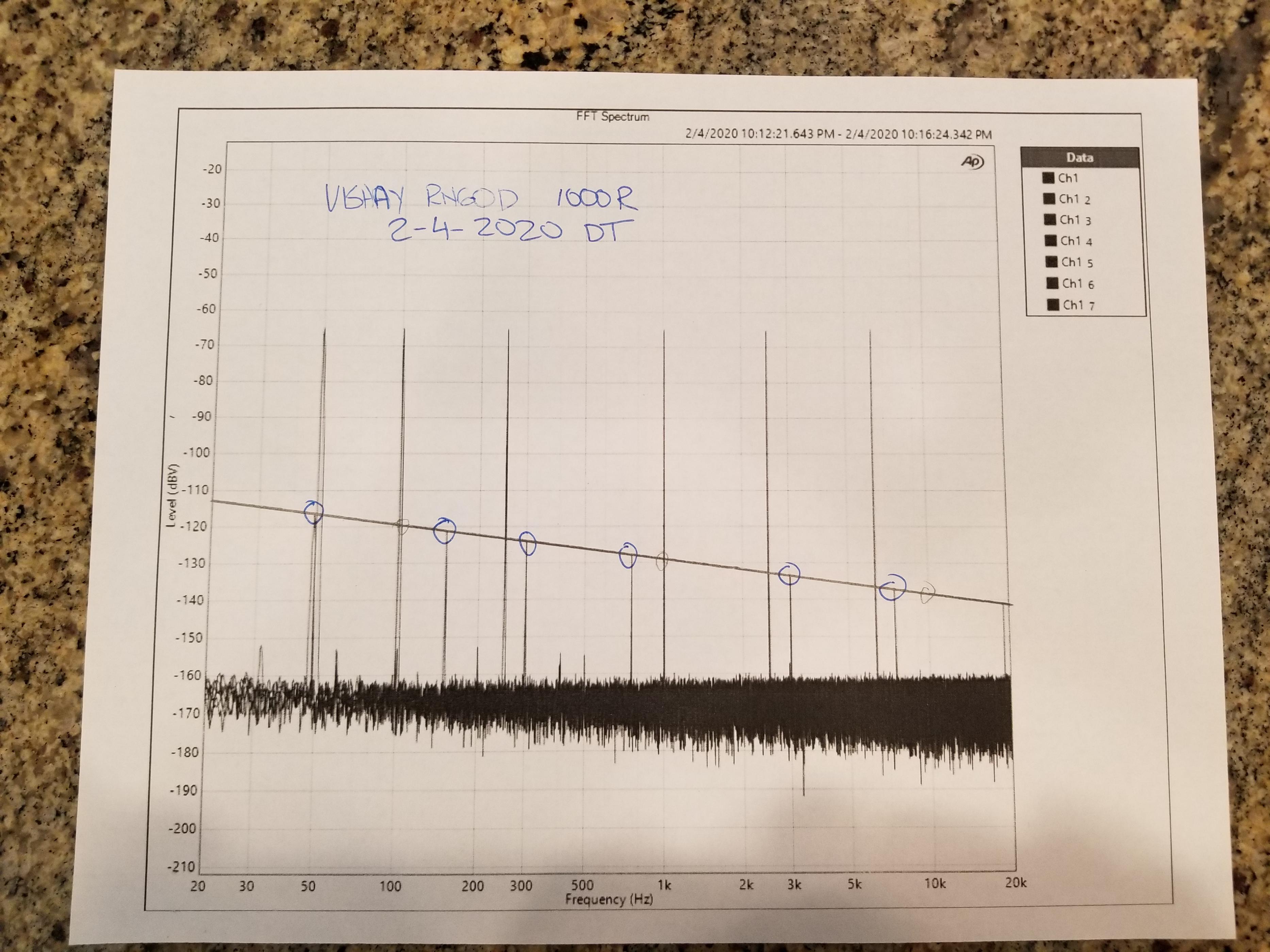

To add a bit of clarity and a reminder that the plots posted in post 214 had a voltage input of 20 volts in frequency stair steps. With the 20 volts input to the bridge the resistors under test had 10 volts across them. 10v times 10v /divided by 1000 Ohms is equal to 0.1 Watts dissipated in each of two resistors or 0.3412 BTU’s/hour heat input per hour.
In the plots what looks like the “fundamental” is the bridge leakage voltage in dBV. On the plot what looks like -42dBV is in fact +20dBV. For the 3kHZ 3rd Harmonic at -120dBV is -143dB relative to the +20dBV input voltage.
I appended the frequency stair steps on a plot and by hand added a straight line across the 3rd Harmonic peaks. The math for the straight line is straight forward.
For the plots in post 220 I held the frequency constant and varied the voltage input. See the plots. Using the voltage input across the resistor I calculated the watts dissipation at each input voltage 2v, 4v, 6v, 8v, 10v and 12v.
On the Y axis is the 3rd H and on the X axis is the calculated Watts.
Once again the 3rd Harmonic peaks are connected with a straight line.
I am getting a better idea of the distortion of thin (metal) film resistors. I have other resistor values to test if there is interest.
Thanks DT

DT, these are all interesting results. Not the increase with lower F and higher P, that we should expect.
But the neat straight line slopes through the various points gives even more credibility to the test method.
I should also mention that Ed Simon has agreed to do similar (I believe) tests on some Vishay Zfoil resistors and some precision miniMELF resistors.
That will then add even more to our store of understanding of such issues and, hopefully, help us to select the best resistor for a particular job with predictable results.
This thread should become a sticky.

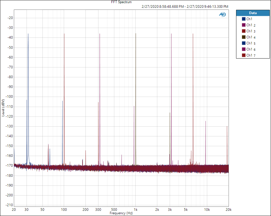

This is what “Naked” looks like.
Hello All,
This is a 1000r VAR, Vishay Audio Resistor.
This is 20volts 1M FFT length and 20 averages.
The distortion is a couple of dB’s improvement over the non “Naked” Z-Foil resistor but not nearly as good as the PTF65 5ppm, RN60 25ppm or RN65 100ppm resistors.
I think that is all about thermal mass and thermal time constant, more about that later.
Thanks DT

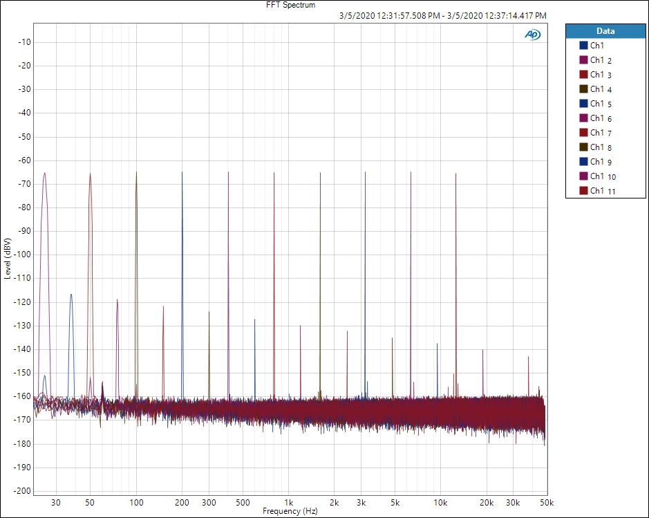

First step, I suppose is to sort putting an FFT method together that shows the FFT noise Floor at the real time noise voltage. I recall seeing an Audio Precision Note on the topic some time ago.
Also see attached plot(s) from Vishay PTF56 54.9R at 6.3Volts. 3rd H continues to gradually taper with input well above 20khZ.
