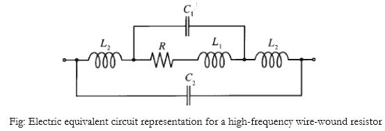

One nonlinear effect of any resistor is caused by the skin effect of any conductor. Resistors are made of conductor with a certain resistance. At high frequency, current tends to flow on the surface of the conductor, which reduces the effective cross section area of the conductor, hence increases the effective resistance of the resistor. In this sense, the resistance of any resistor is frequency dependent. I assume the instantaneous signal you mentioned include a high frequency component, at which the resistance should be higher than the DC resistance value shown in the resistor datasheet.
I did measurements of frequency dependance of impedance of various resistors. Because of stray capacitance, impedance usually decreases above 20kHz. This is valid even for MF resistors dedicated for high frequency applications (I mean here russian S2-10 resistors).
Aren't you mixing up frequency dependent and nonlinear?
Unless I'm missing something, with or without skin effect, when you increase the current by a factor of two, the current density in each part of the resistor increases by a factor of two, and when you apply the sum of two signal currents to the resistor, the current density in each part of the resistor is just the sum of the current densities caused by each signal current. That is, superposition applies in a resistor with skin effect, so it is linear.
Skin effect is not completely ignorable at audio frequencies, in fact, as its ~0.5mm for copper at 20kHz, which will impact high current wiring to loudspeakers especially for long runs where the wires have to be thicker - but usually you can ignore it.
The other area where skin-effect does matter for audio is that it controls the screening performance of metal enclosures - at mains frequencies the skin depth of copper or aluminium is large (~1cm) meaning mains-derived magnetic fields will penetrate these materials significantly, compared to magnetic metals like steel (more like 0.3mm skin depth).
Thus 2mm of steel should perform better than 1cm of copper for screening a transformer.
That's not non-linear. Its just a frequency response curve. Non linear means the output doesn't scale linearly with the input level for a given input signal, not that the frequency response is flat.
