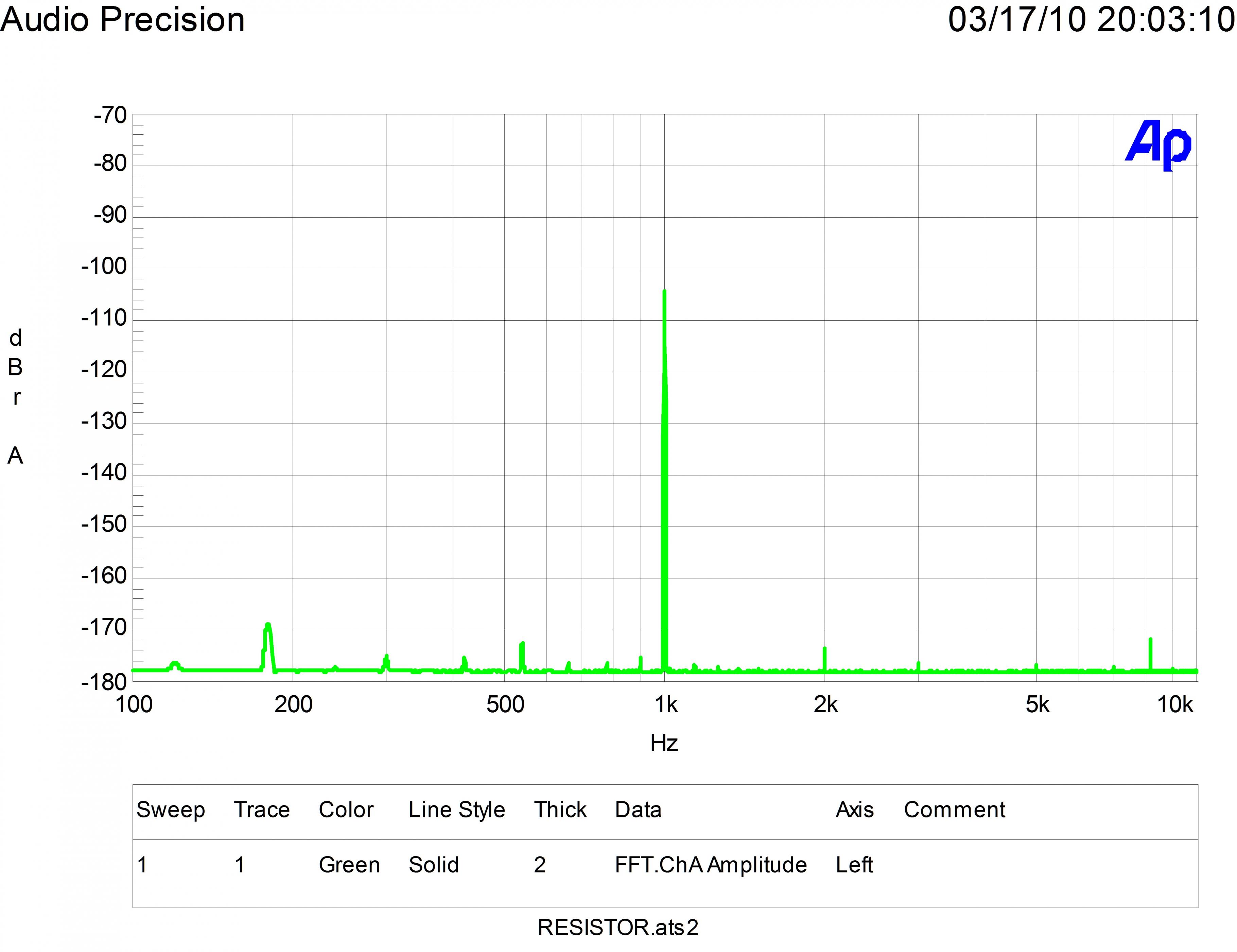

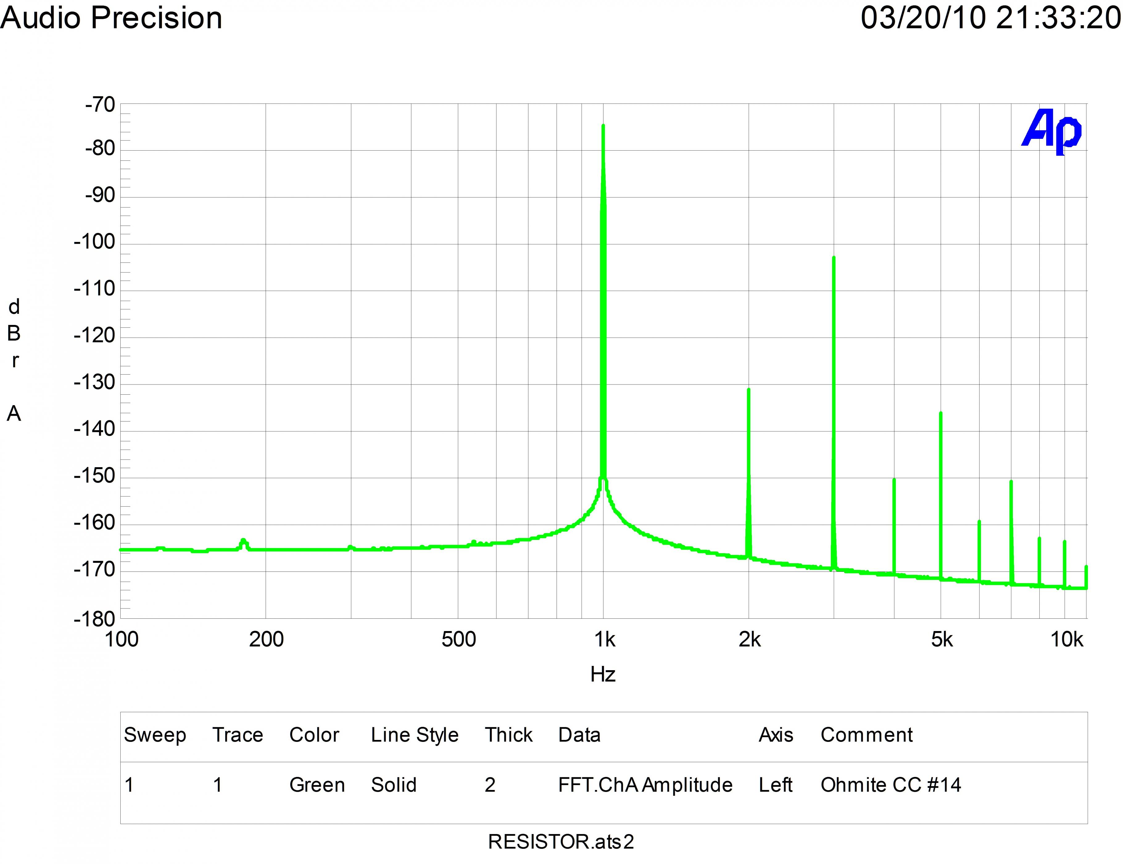

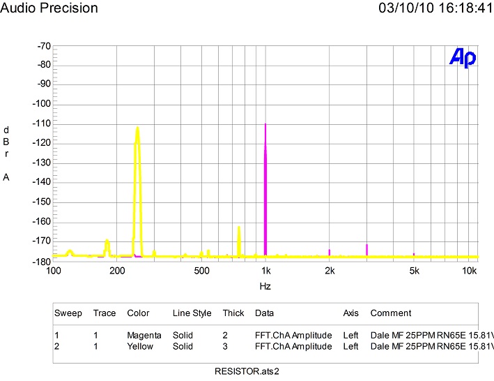

Three curves showing resistor distortion. Using my bridge technique the fundamental of 0 level is suppressed.
First a good Dale RN65 resistor, second an Ohmite 1/2 watt carbon composition type and finally the effect frequency has on another Dale.
On the CC resistor it is not just the added harmonics, note the base spreading which can be caused by an increase in 1/f noise.
On the third image notice how the third harmonic distortion increases as frequency decreases. Also not there is not much change in the second harmonic for a two octave change in frequency.
Thanks. That's something I have suspected for a long time, but never had the time/resources/will to confirm.
When idle, all resistors are made equal, they just generate thermal noise, but when a carb-comp resistor is subjected to an AC signal, it generates an excess noise proportional to the instantaneous amplitude of the signal, smearing and widening the original spectral line.
Beautiful demonstration, also showing that crappy resistors and potentiometers have an influence extending on the signal further than just their basic non-linearity
