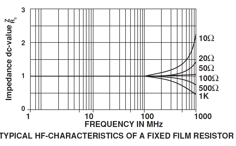

Jan,
Look at the data sheets to see distortion vs resistance values.
Perhaps latching a resistor into your Bode 100 impedance / phase tester will show that down at the -120dB level that there is capacitive and inductive reactance going on, not just E=IR.
Yes, the impact of parasitic C and L is documented; attached is from Vishay.
I have not been able to find distortion vs resistance graphs - in fact that was the question I had that lead me to open this thread!
