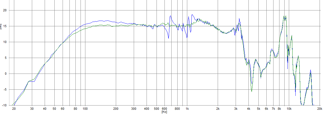

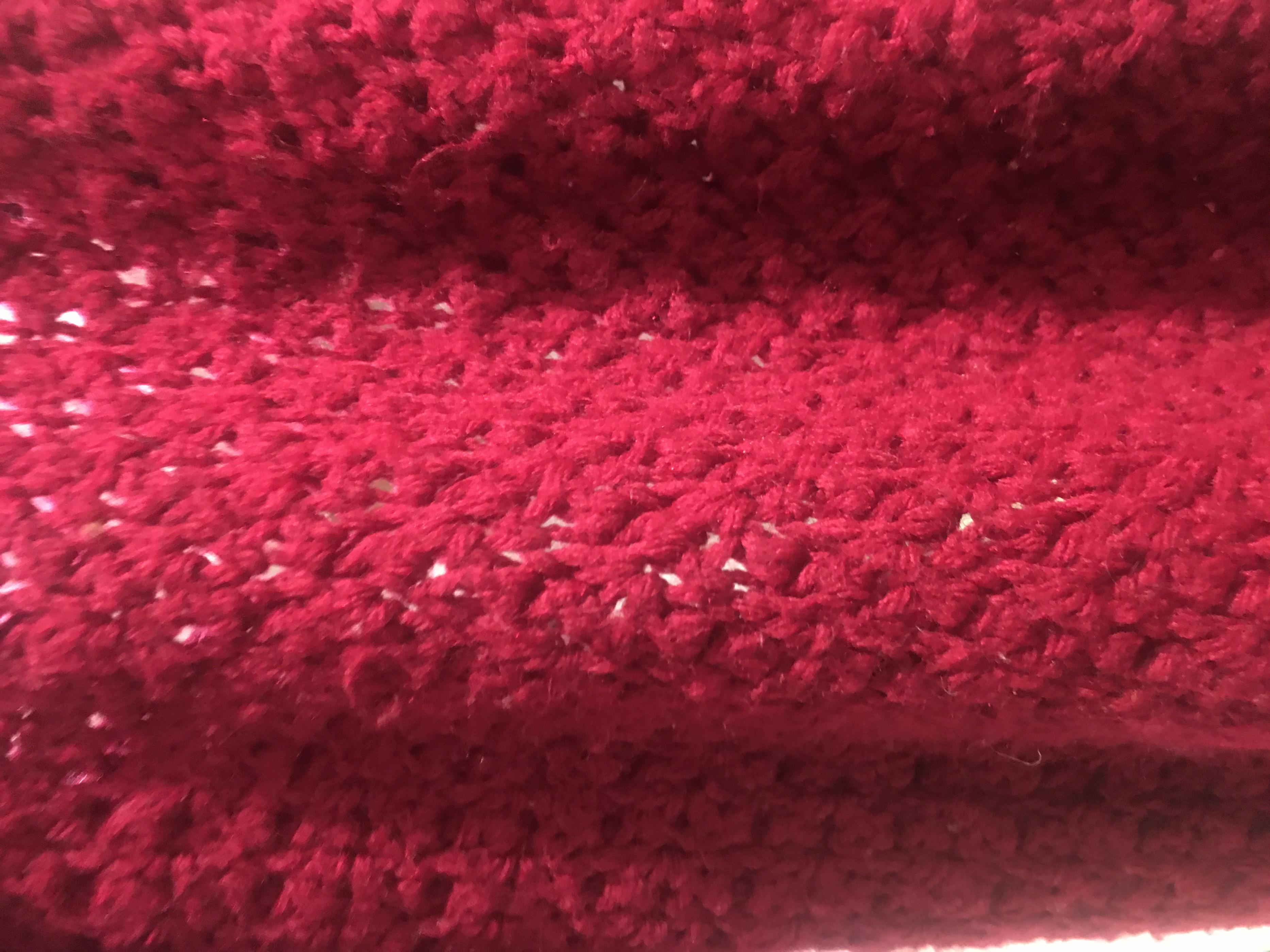

In my search for the cleanest non-boxy and non-resonant sound from a box speaker: while attempting to prove my measured TS Parameters through acoustic measurements coupled with measuring several different drivers in various box sizes with a few different stuffing materials, I discovered a few things.
For stuffing - felt and compressed poly fill help very little to lower box Qtc
My red blanket with holes did an amazing job as shown in my nearfield measurement, green is stuffed. Old news for some on here, but nice to see for myself:)
Comments on Post 63 about pours appears to align with my results!
A side note: If we use Manufactured TS Parameters, I believe it's a hit and miss game. All of my drivers TS measurements are out from the Posted specs, some wildly.

1/8 wavelength is of course just a rule of thumb, but it gives you a good idea how thick an absorber needs to be. you must also decide how large and where the absorber must be and which density
For a very tall and narrow box with a thin layer of which ever material will have almost none impact on damping the lowest frequency standing wave
So you ignore my reference in post 82? Which seems to indicate that a rule of thumb of 1/24 of a wavelength?
And then. I'm talking about reflections (try reading post 74), not standing waves. Standing waves are a different matter, as they're better addressed at the points of highest velocity (though don't ignore the beneficial effects of high density wall lining). Highest velocity exists in the middle of the box, but that's the most difficult location for absorptive material. Polyester filling is next to useless (though useful for "volume enlargement").
Use of stuffing in order to increase the apparent box volume isn't anything to do with acoustic absorption. It's to do with providing a thermal sink to regulate the air temperature during compression and rarefaction of the air inside the box due to the cone moving in and out. Conversion from what would be an adiabatic process to isothermal.
Only relevant for low bass frequencies. Even the otherwise useless polyester stuffing is useful in this context.
