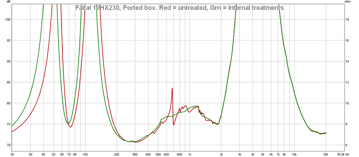

A useful test for the internal treatment of a cabinet is this: do an impedance sweep. Standing waves from the driver's come to various surfaces show up as small resonances, and applying absorption in the reflection path will flatten out those ripples in the impedance curve. You can see a comparison of two impedance curves in the attachments.
You can see a couple of photos of the speakers here: New Speakers
Both curves were taken with the speaker in the same position (on the floor, facing up), and I'd added some internal absorption in the form of 1/2" thick (approx) recycled wool underlay. 3x layers at the top and between the ports, 2x layers down the sides, 1x layer on the back.
As can be seen from the graphs, the resonances in the hundreds-of-Hz range have been damped and flattened. They haven't disappeared completely, but that's probably because I didn't use enough damping. Applying this much lost a couple of dB of output in the 70Hz range, because the port tuning also dropped and became slightly lower-Q. I didn't want to lose any more LF output because these are PA speakers.
Needless to say, my (sealed, floorstanding) HiFi speakers have lots of polyester filling in the bottom half, and lots of layers of recycled wool in the top half. I should probably take an impedance curve of those.
I plan on adding a bit of internal bracing to the PA cabinet in the form of a few batons connecting opposite faces, and seeing how that affects the impedance curve, too.
