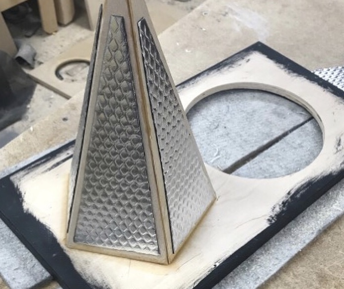

Make the box have less parallel - parallel walls. The extreme case is the B&W Nautilus. You can make a cheap and easy Nautilus using spiral chamber foam core box which I call the Nautiloss. The Nautiloss and trapezoid baffle measures almost identical to a large open baffle:
No coloration of the box at all. The dips and peaks are intrinsic to the CHN-70 driver.
A rhomboid shape box works too or a triangle. I use a tall pyramid which I call the Dagger. It acts like an acoustic Wood’s horn or black hole. Stuff it progressively denser towards the vertex and very loose near the mouth. This lets the acoustic impedance vary as the sound reaches father back. Use melamine foam to line walls. Make the baffle a trapezoidal shape or at minimum, a rectangle. Avoid circles or symmetric square shape. The diffraction pattern from a trapezoid is less than rectangle. A flower petal shape baffle actually works really well. But if you must use a rectangular prismatic box, line walls with melamine foam and use stuffing. Sometimes a diagonal brace inside can also help break up box mode resonances.
My Dagger with a trapezoidal baffle measures and sounds the same as an infinite baffle (open on the back).

Pentagonal pyramid aka the Dagger, has no parallel walls.
I am not sure what the angle of the cut is since it’s a pyramid.

For pentagonal parallel top and bottom I fit an angled deflector on one of them.

yes, the math that adds up says that. But, when you make the cuts, the angle on the edge is 54 degrees, not 45 degrees. I will double check; it has been decades since I did this. I did this very old school back in the day. I used graph paper and a compass and a protractor, etc.
I did the top at an angle of maybe 30 degrees. This was VERY tricky for sure. Looking at the front of the box; the top sloped down from front to back.
