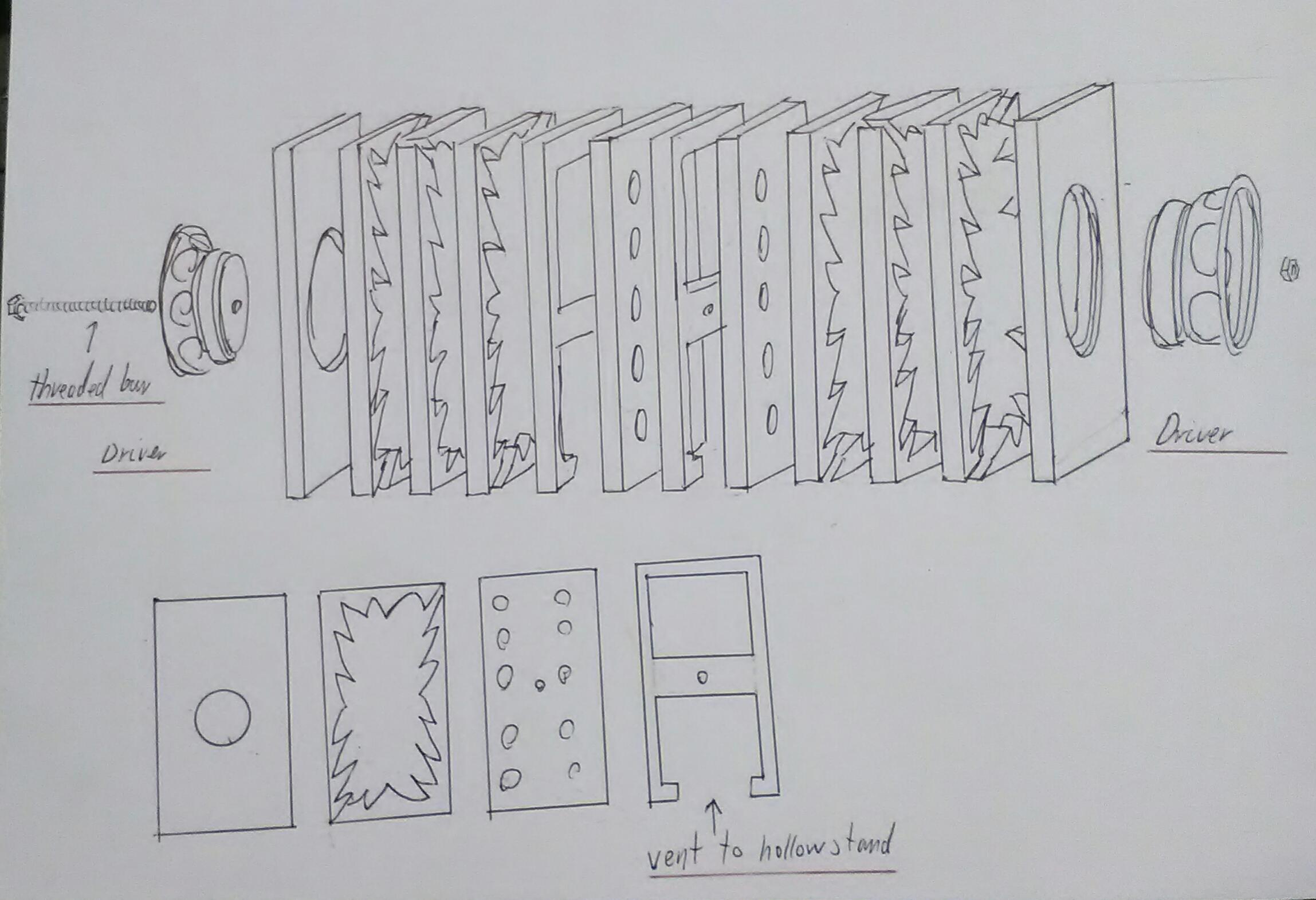

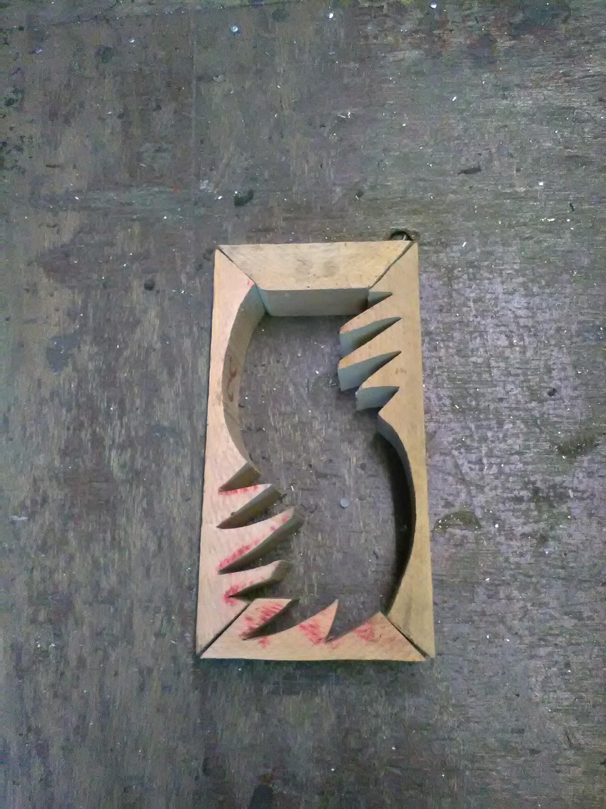

IMG_20200915_080200.jpg There are TWO causes of boxy sound, one is the sound coming from the back of the driver bouncing around the cabinet and either coming out through the driver, or through the cabinet walls. The second is the vibration of the driver shaking the cabinet, just like a violin strings vibrate it's wooden body, I have attached a diagram of my " ply woods " that use two identical drivers mounted back to back to cancel out the second, and a VERY solid enclosure to stop sound leaking through. To increase the effective volume, they have a vent in the bottom to connect with the hollow stand. There is a capacitor across the rear driver to bias the highs to the front. If you want to go the whole hog at reducing the boxy sound you'd probably be best going the Eclipse td way. The BBC ls3/5a has a very lossy cabinet, you could copy the screwed on back version.
An interesting belt and braces approach to cabinet vibration! I'm not sure it addresses potential reflections back through the cone as well though. Presumably the rear woofer needs some space away from any walls to breath, but with its low pass filter it's a neat answer to baffle step correction. A series inductor would be preferable instead I think, to keep the amplifier load reasonable?

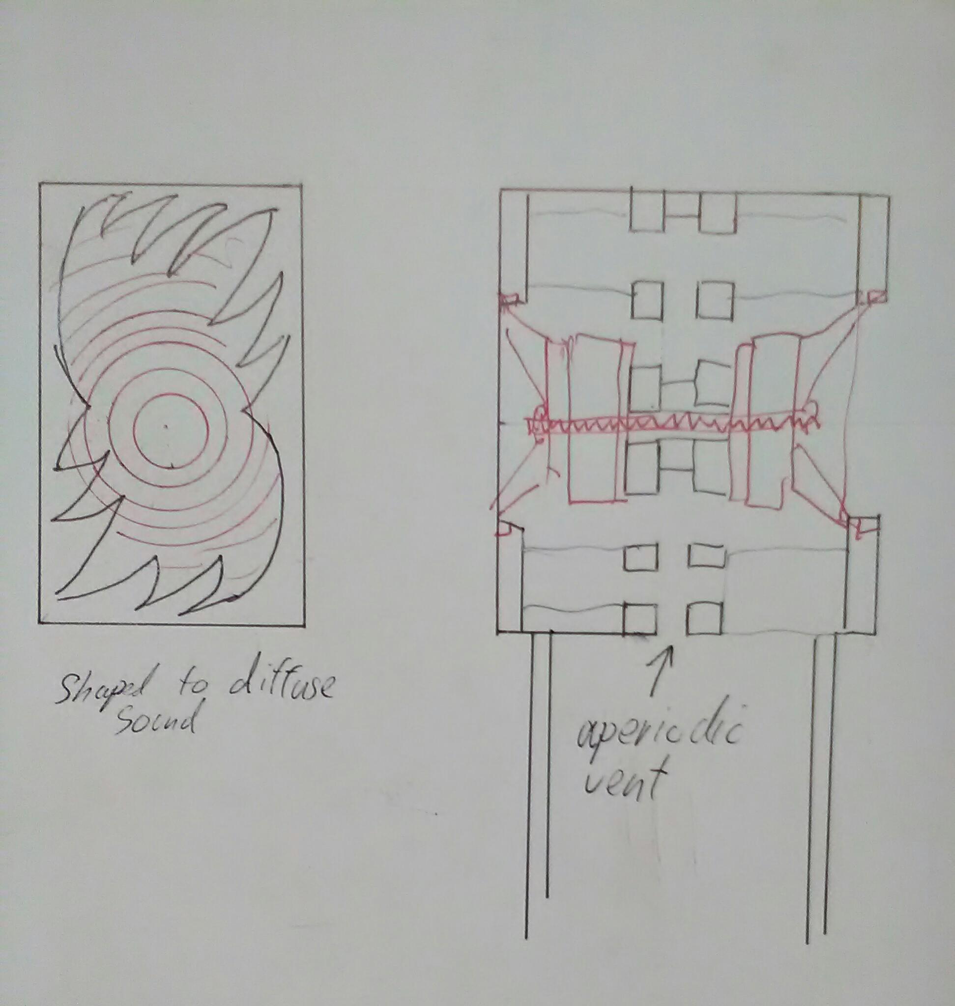

Both the rear and front are vented to the stand, the cap across the rear is only about 3.5uf, the impedance of the driver will have risen by the time is has an effect, as the drivers ( 4 ohms ) are in series I'll guess the speaker will be close to an 8 ohm load up to 20,000 Hz . The " walls " are shaped to give points to the sound wave from the driver, hopefully diffusing it. 4" car speakers aren't the best full range drivers, but if they're coaxial they'll have a hole through the magnet ( for the tweeter ) so you can stick a threaded bar through to clamp the whole thing together ( or the driver to a lump of iron ). I think an open baffle " tweeter " on the top would perhaps improve it.

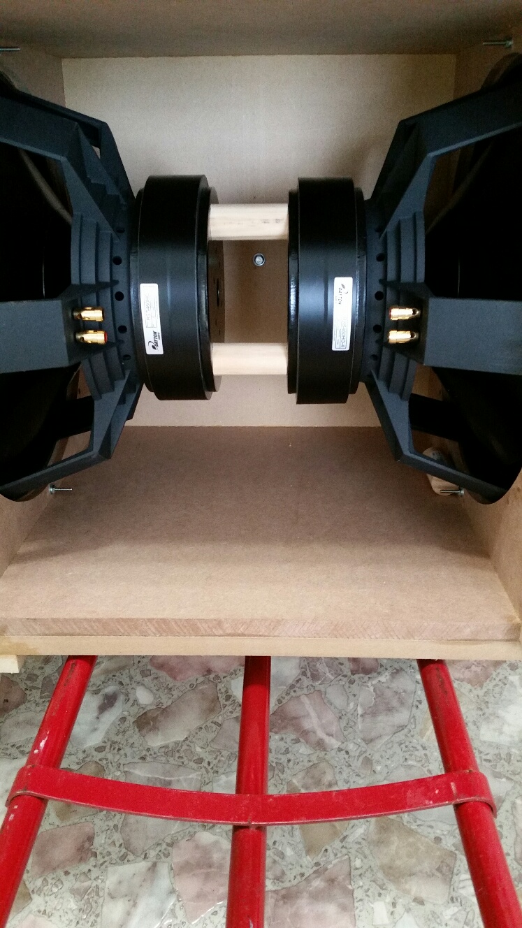

Nice. How about a wooden divider between them ( with the magnets butted up against ) to stiffen the sides. I did something similar with two phoenix gold 10" subs, but used threaded bar through the driver mounting holes from one side to the other, I'm considering ( if I ever get around to it ) to stick in two dividers to make it aperiodically loaded. PS. reducing boxeness has been my obsession for 15 years.
A similar method used for a bass section.
This stops the whole speaker jumping around but creates a noisy cabinet due to both drivers hammering away on it.
I looked at running long bolts with spacers between the two drivers mounting holes. This stopped the drivers hammering on the cabinet but the frame of the driver was still driven and it pinched a significant amount of volume. When I simulated the vibration of the cabinet the long slender spacers were resonating within the passband. Perhaps it could have been made to work but it is not elegant.
The right way to do it (if practical) is to rigidly mount the drivers back to back perhaps with a short possibly vented cylinder between the magnets of the two drivers if it cannot be done directly. This keeps vibration out of the cabinet and the frame of the drivers while providing at worst a short stiff structure between the two driven magnets.
Try Babybel cheese wax ( the red stuff ) between the magnets and the spacer. I have used some beside the magnet and basket ( the steel basket was flexing ) and it damped the vibration audibly. If you knead the wax it goes soft and tacky, I've used it between the magnet and rear of an enclosure before ( press the driver in so it squishes ). Works a treat.
