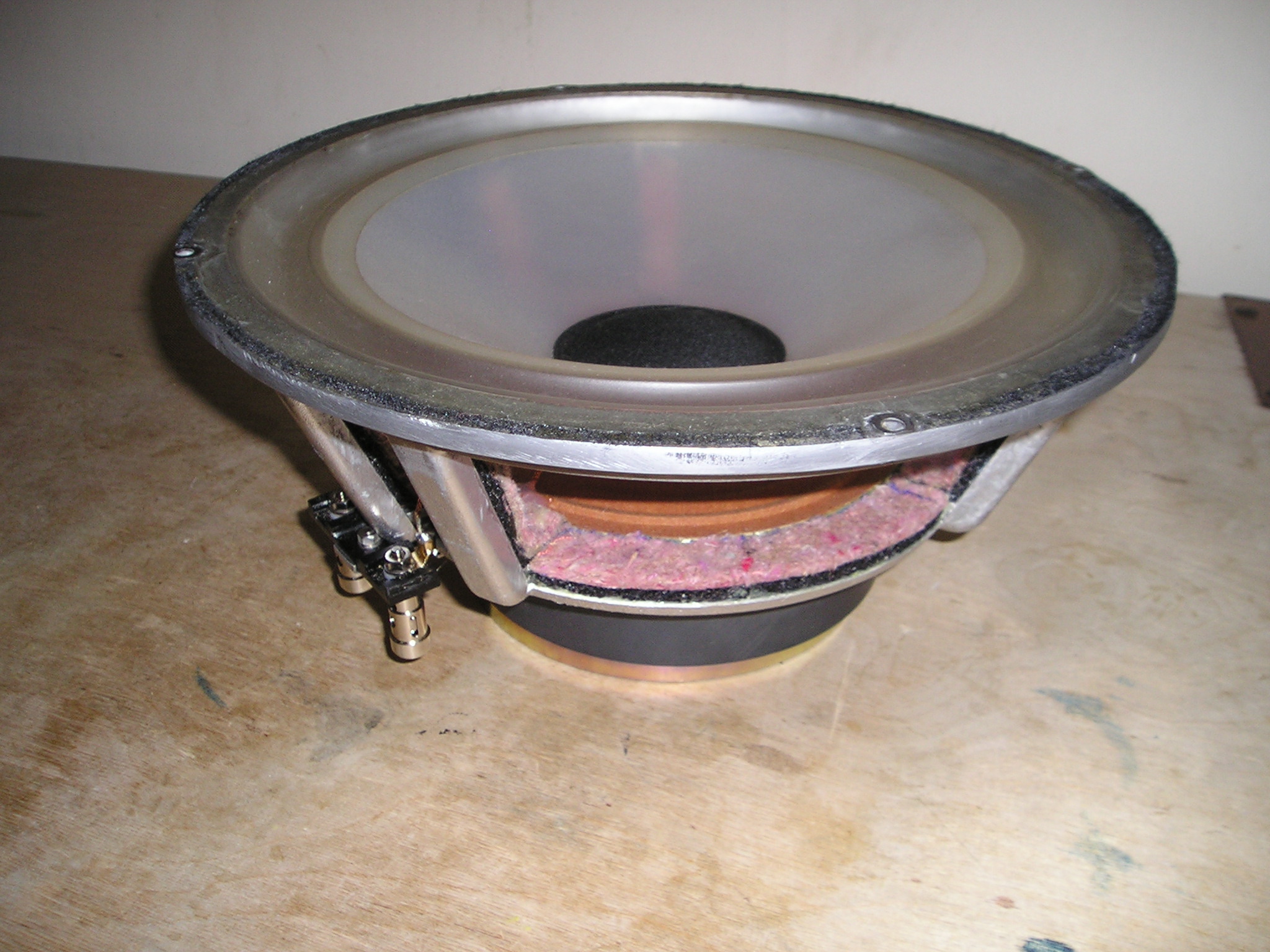

I also damp the driver frames, paying particular attention to the area behind the cone which will potentially reflect directly through the cone.

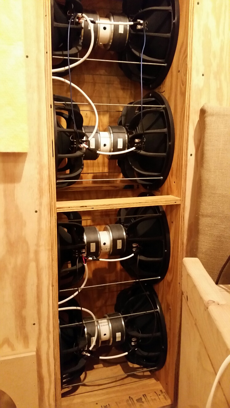

This stops the whole speaker jumping around but creates a noisy cabinet due to both drivers hammering away on it.
I looked at running long bolts with spacers between the two drivers mounting holes. This stopped the drivers hammering on the cabinet but the frame of the driver was still driven and it pinched a significant amount of volume. When I simulated the vibration of the cabinet the long slender spacers were resonating within the passband. Perhaps it could have been made to work but it is not elegant.
The right way to do it (if practical) is to rigidly mount the drivers back to back perhaps with a short possibly vented cylinder between the magnets of the two drivers if it cannot be done directly. This keeps vibration out of the cabinet and the frame of the drivers while providing at worst a short stiff structure between the two driven magnets.
I'd say your ideas are excellent, since I incorporated them in my infinite baffle bass build. This is somewhat of an inverted concept verses the last picture I posted in this thread. In effect, the listener hears the back of the cone.

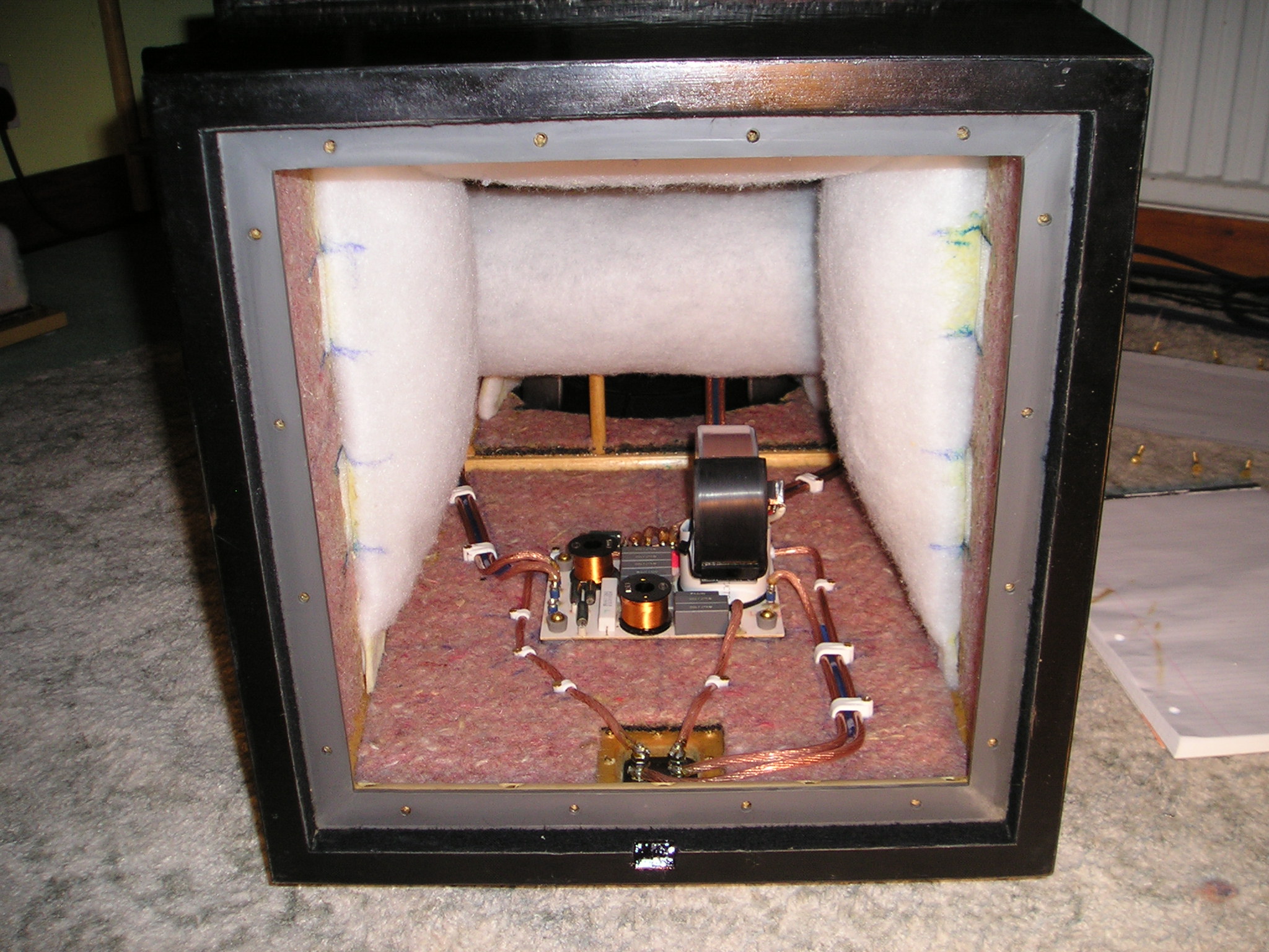

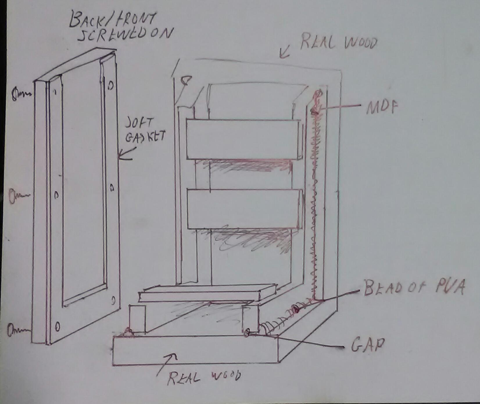

If you want a lossy box you could try this, based on the BBC Ls3/5a. The bead of PVA and gap provide a slightly soft joint and the difference between the real wood and MDF seem to give a very dead box. Having the front and back screwed on ( or held on by tension springs as I sometimes do ) also reduces sound transition. The ladder rungs attached to the MDF are baffles to help " defend " the sides from sound from the driver and to try and detract it as it bounces back. On my traffic light speakers I also added square steel bars to the front baffle to add weight and to stiffen it, quite a complicated speaker that one.

Making a box non resonant can be done, Arthur Khoubessarian of the Funk Firm said of my rebuild, (earlier pictures), that there was no box sound. Each had 53 braces in, but this is labour intensive, and perhaps proclusive in commercial situations.
