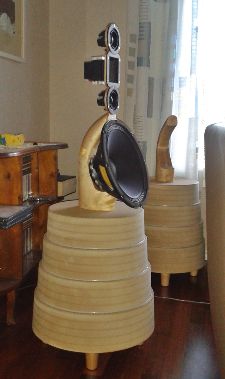

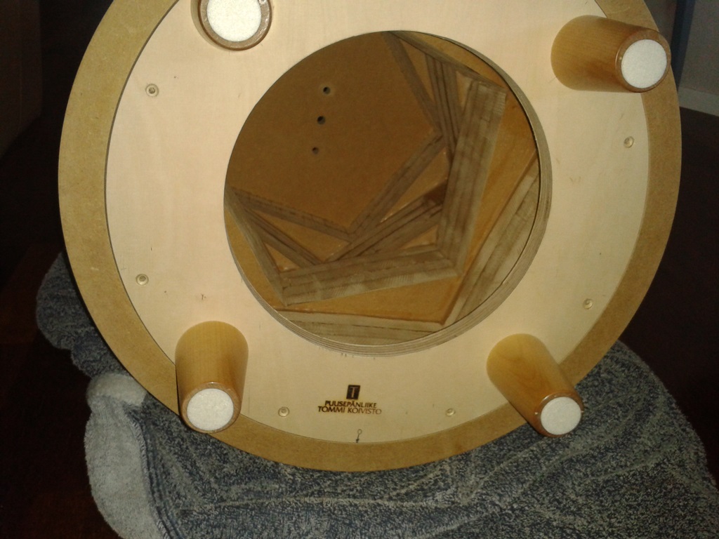

I didn't want my bass box to ring
Mid and tweeters are open frame dipole
You didn't want your bass box to ring, but you made them bell shaped ?
Interesting, references please.Actually, compression and rarefaction (Boyle’s Law) are not symmetric - hence why sound propagation in air intrinsically has 2nd order distortion, and why we associate that with natural sounding.
I don't want to sound disparaging, when bells ring they have four nodes and four antinodes, if you stick an odd number of lumps ( heavy, but damped; perhaps silicone mixed with lead shot would work ) evenly spaced around the bottom on the inside might make a difference, perhaps they just wont be exited. I'd go for an odd number of feet as well.You didn't want your bass box to ring, but you made them bell shaped ?
