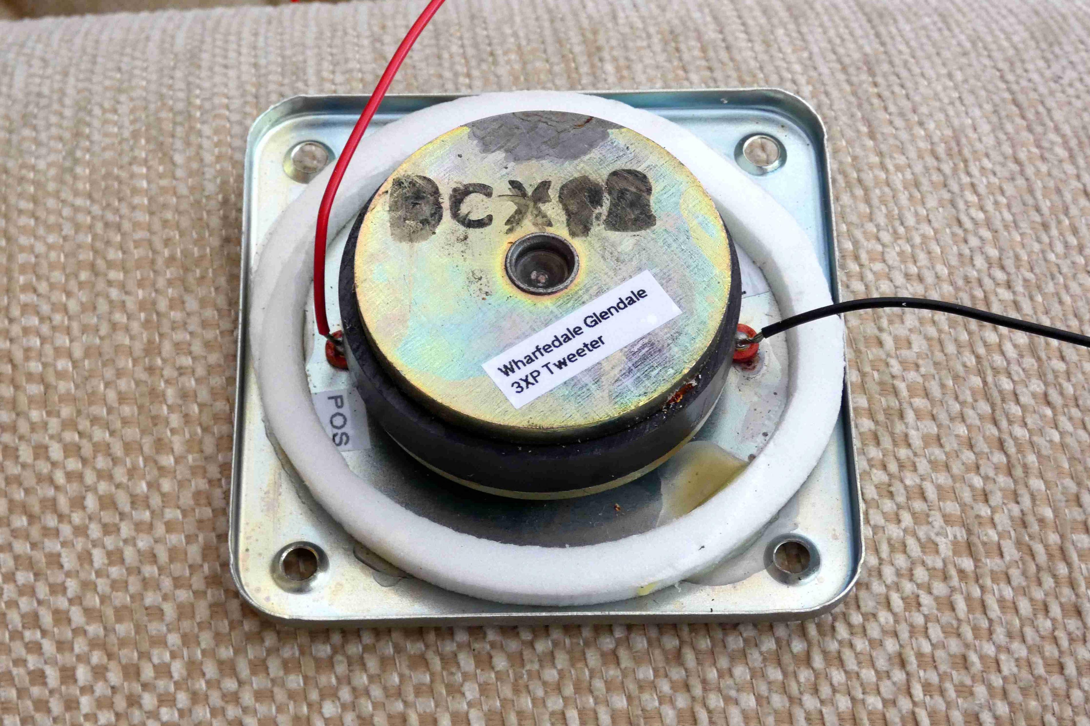

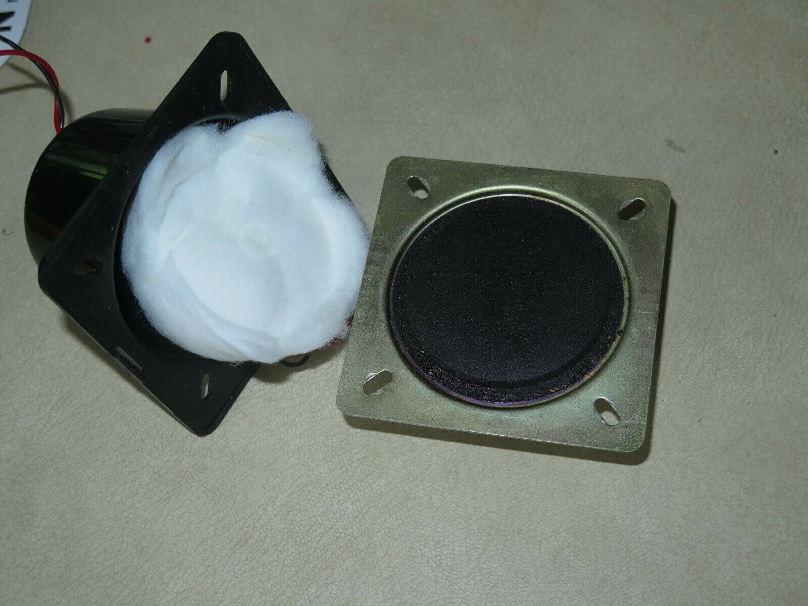

...they look very similar to the 3XP ones from the front but different at the back.

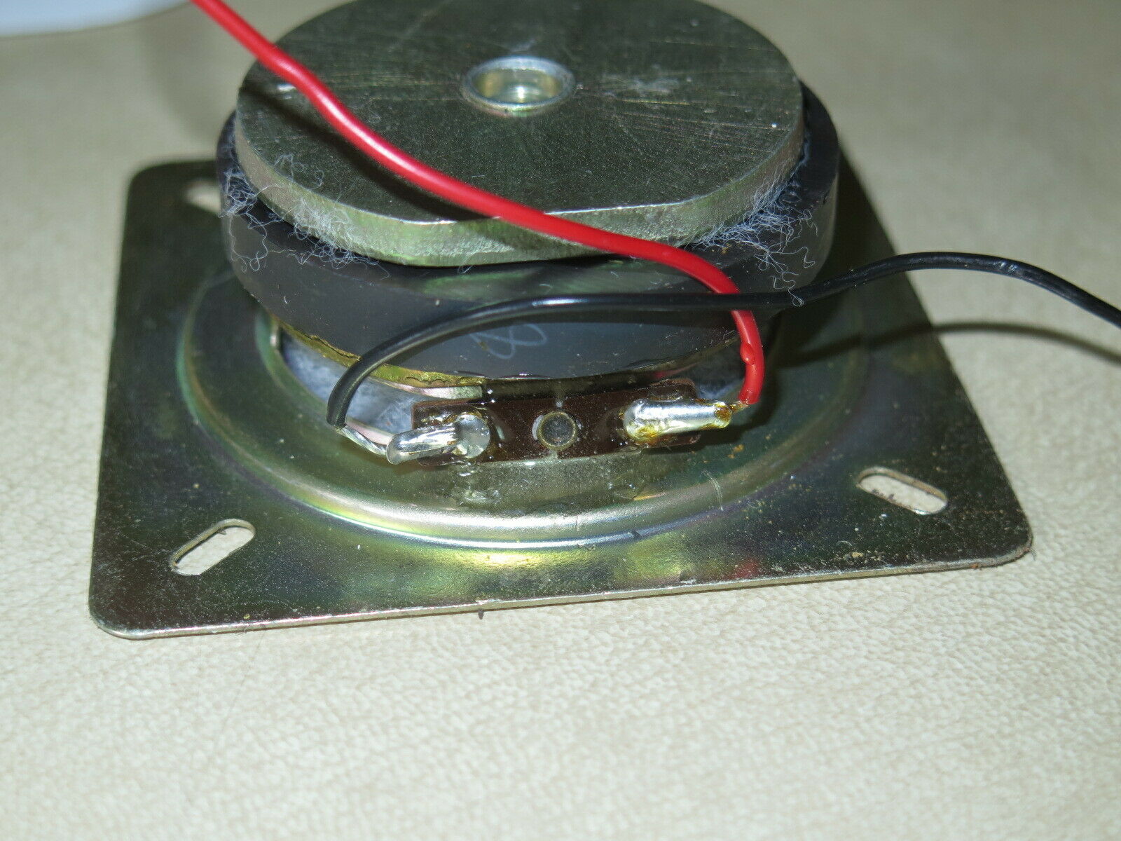

Does your 3XP tweeter have a closed back chassis as it appears to have in my photo on page one?
Or is it an open back tweeter like the one attached, which requires a rear housing?
What you are seeing in the third image of the ebay listing is the rear housing.

Hi all,
Must admit you are probably right about the tweeters and I will not touch them - just interested in whether they are suitable and I do realise that what is shown is the rear housing although the fronts look pretty much identical to the 3XP ones.
The tweeter I already have does not have its own rear housing but does have a large circular magnet, similar to your photo but round. They fit in their own cardboard tube which is in the cabinet separated from the mid and bass units (except right at the back where there is a piece of foam between the end of the tube and the rear cabinet wood panel) and the interior of the tube is filled with sound deadening "wool" as is the rest of the cabinet.
I might add that the screw fitting holes in the tweeter are also round something to look out for when I am searching for a replacement as I think the Denton ones have oval screw holes but otherwise look identical from the front, however somewhere I have read that they are the same tweeters but I am not so sure.
My other pair of very good 3XPs have exactly the same units as these two latest ones just received although this latest pair do seem to have brand new woofers in perfect condition, totally unmarked.
Geoff.
The midrange drivers will have a rear housing in the form of a cardboard tube such as you have described.
So, are there two cardboard tubes in your enclosure?
I ask because the rear housing for the open back tweeter is usually a small plastic cup or metal can - see attachment.
No, sorry my mistake - had a hell of a weekend and still very very busy! It's the mid-range that has the tube. There is nothing on the back of the tweeter of course other than the heavy magnet. There is no plastic or metal cup.
Geoff.

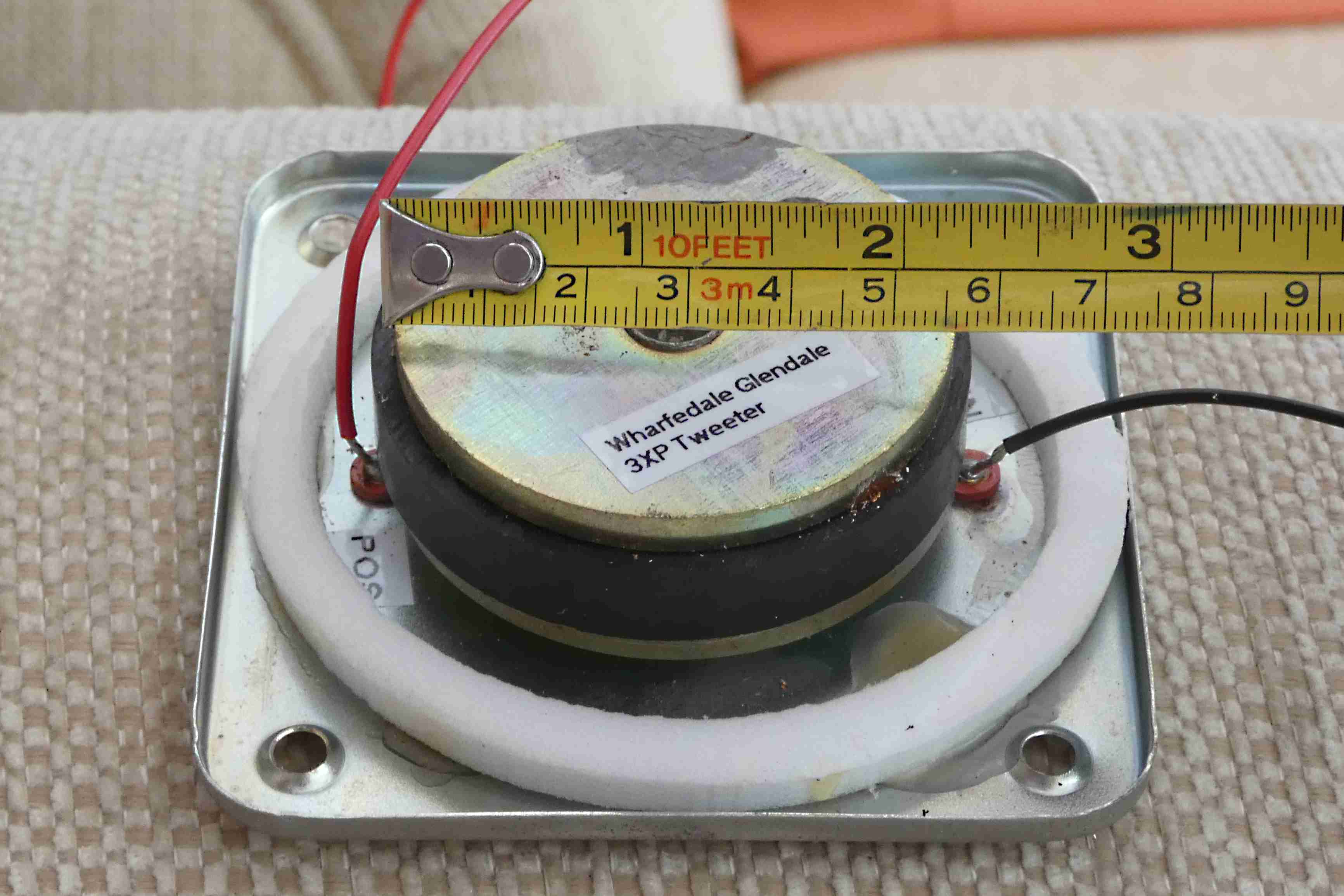

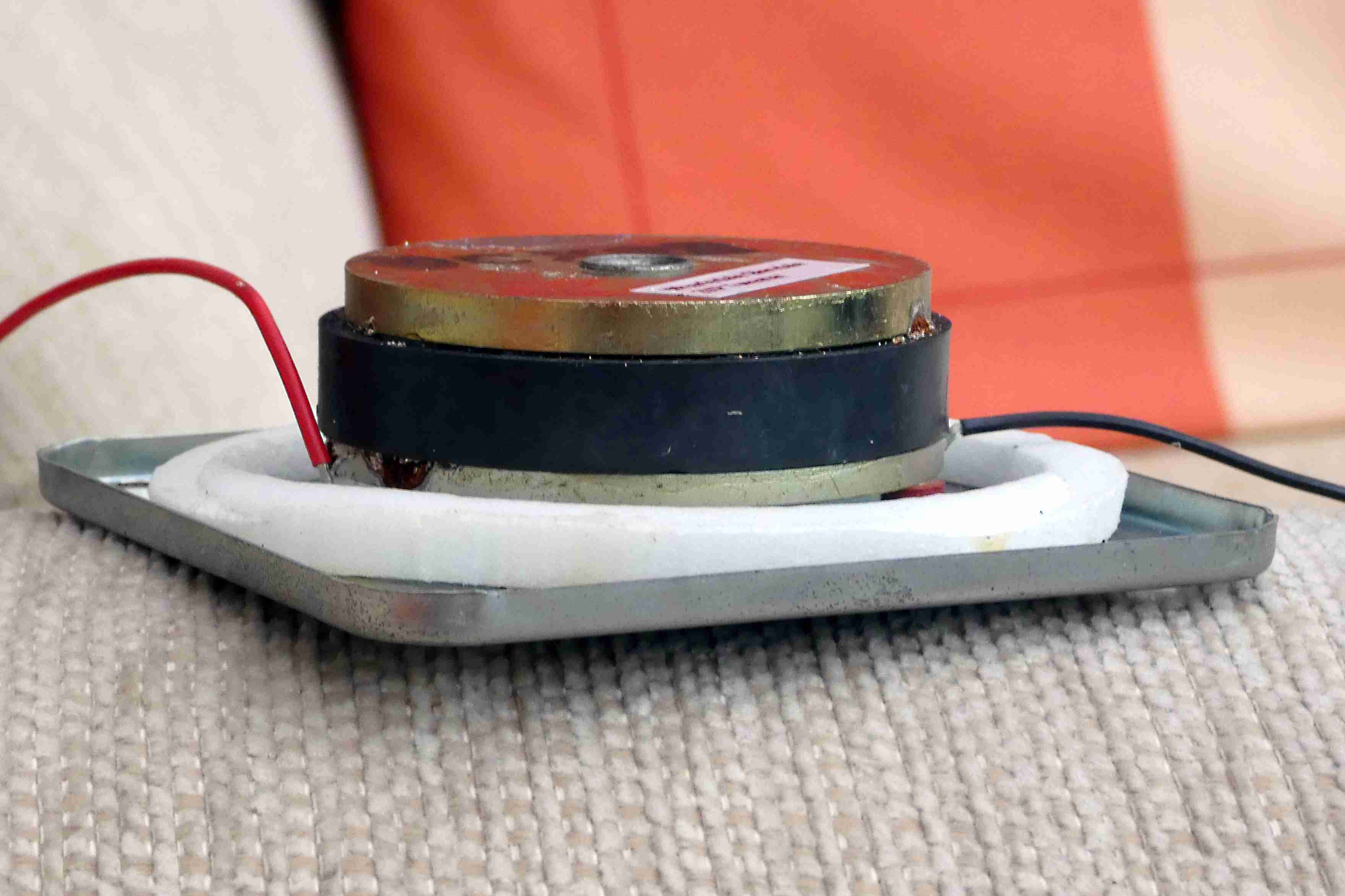

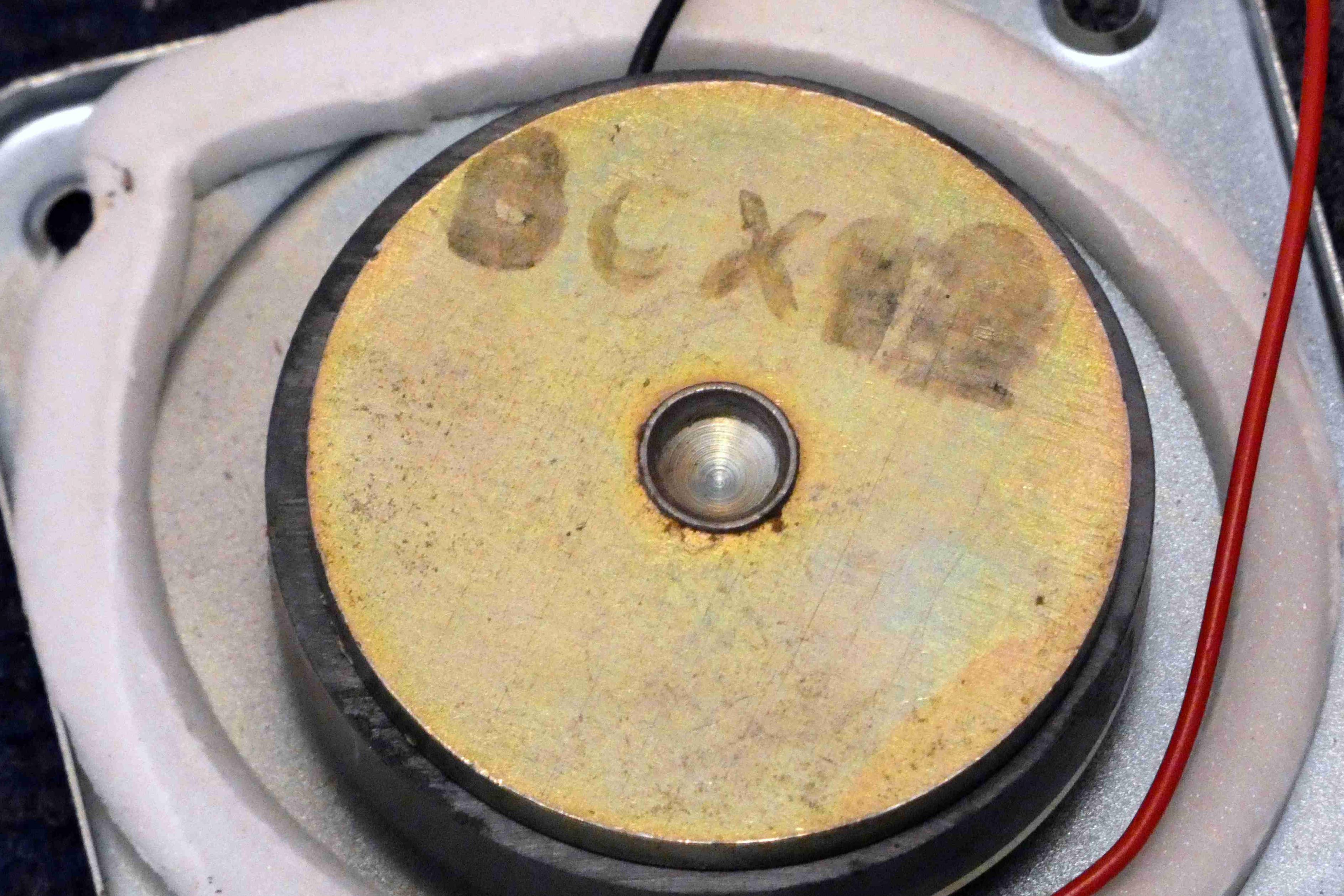

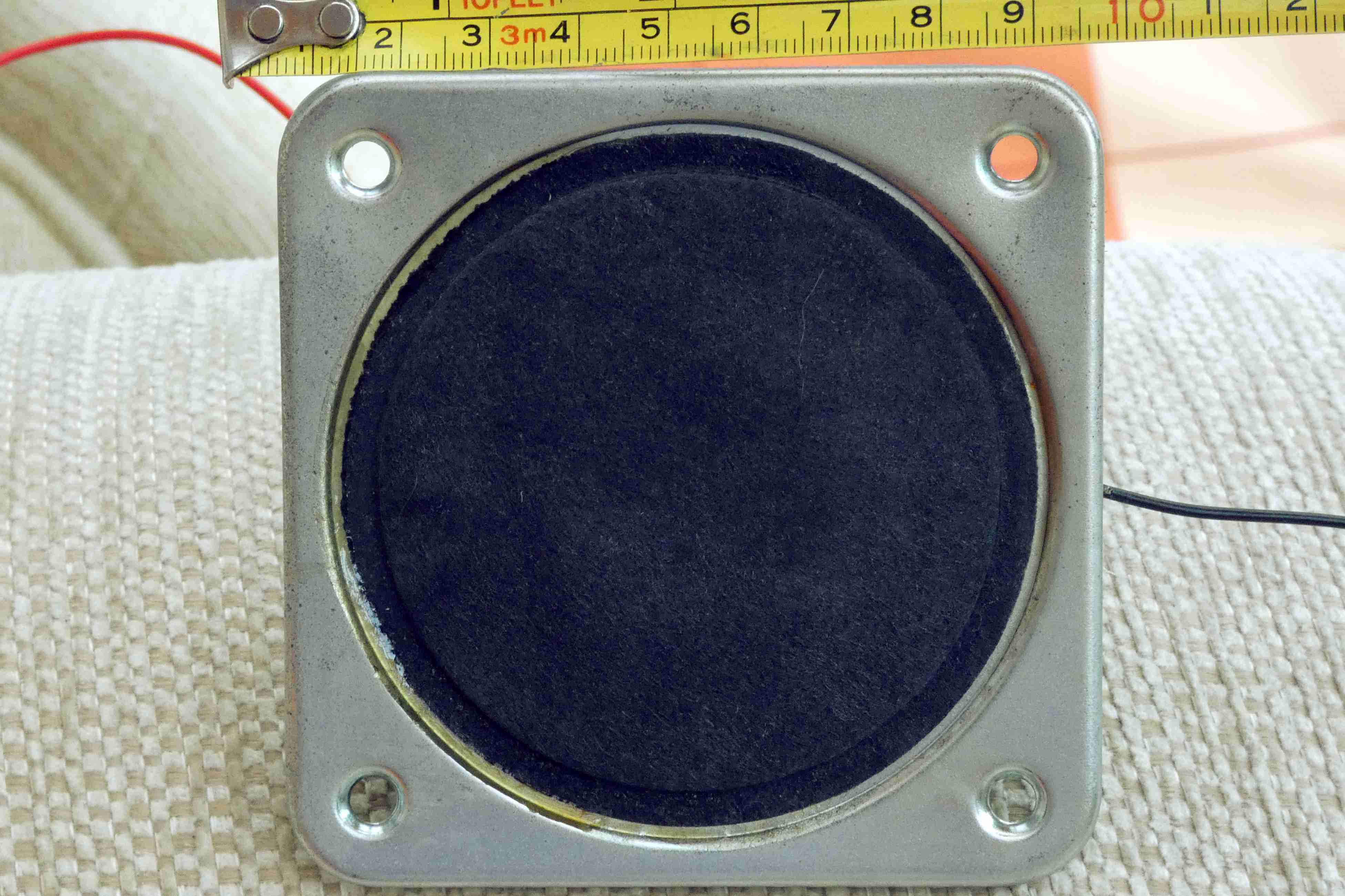

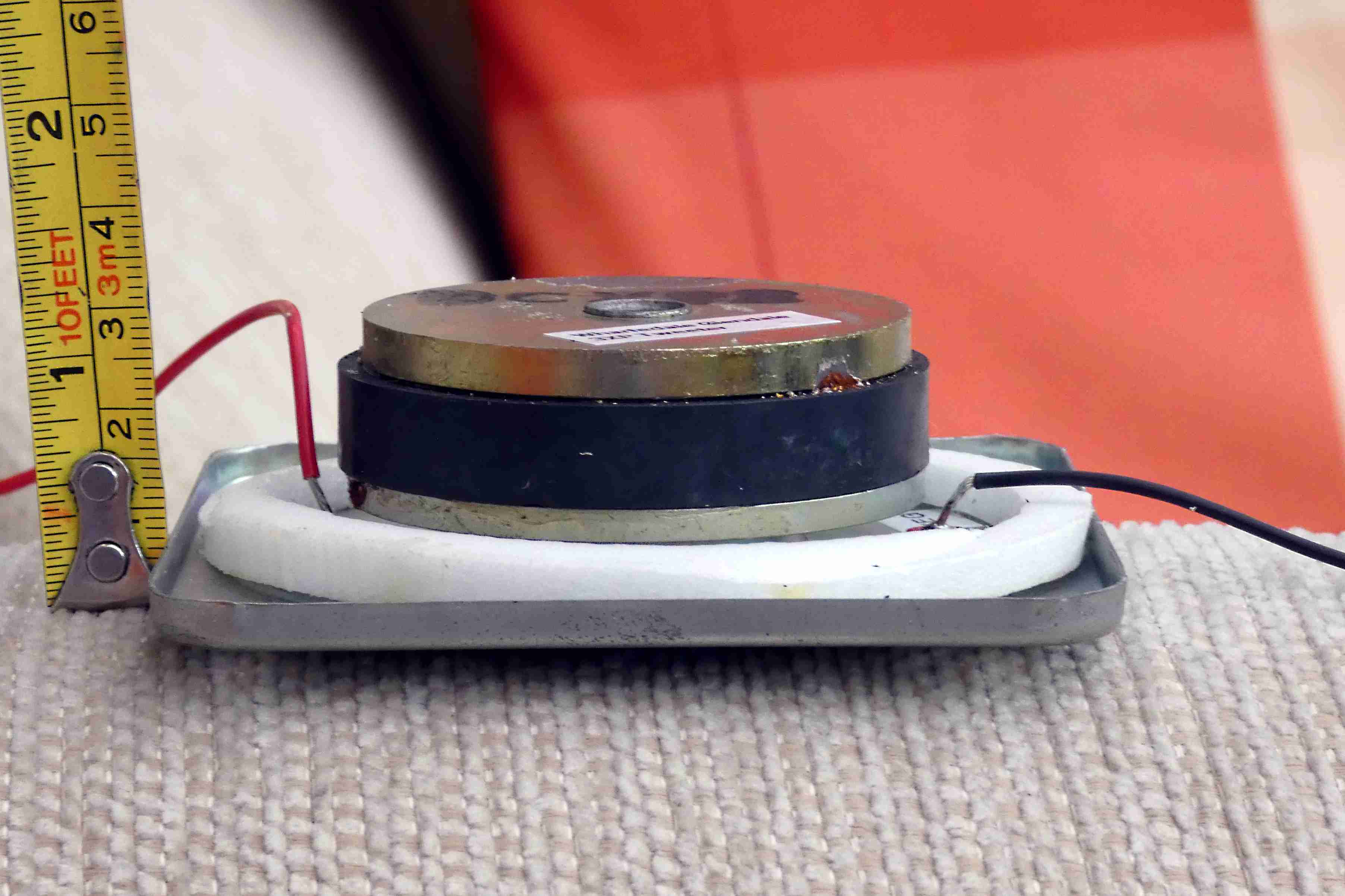

Hi, Photos attached. Diameter of the cut out is 8cm.
Hope these are of use. They are the Glendale 3XP tweeter but I guess they could also look like those in other similar models of Wharfedale speakers of the time - eg Denton perhaps - quite how you tell the difference I have no idea as, from the front they look the same.
Regards and thanks for your help.
Geoff.

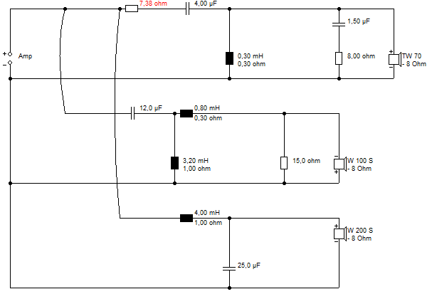

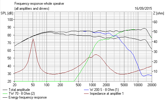

Galu will know what I am going to suggest here:
Monacor HT-22/8 10W Cone Tweeter PS9.35 IN STOCK (31 Aug 2021)
MONACOR: HT-22/8

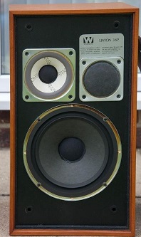

We have done this sort of thing with the Wharfedale Linton and Glendale 3XP 3 ways:
481390d1430874209-wharfdale-linton-3xp-mid-response-recap-wharfedale-linton-3xp-speaker-jpg
481392d1430874209-wharfdale-linton-3xp-mid-response-recap-wharfedale-linton-3xp-replacing-tweeter-cone-type-png
4uF-4.7uF and 0.2-0.3 mH seems about right for 3kHz. Some attenuation needed I think. At least we know the polarity of the drivers.
504558d1442506288-classic-monitor-designs-filter-png
504559d1442506288-classic-monitor-designs-cone-tweeter-png
Get some 2.2R and 3.3R resistors in 3-5W and be prepared to wire them at the front of the filter.
500404d1440474047-classic-monitor-designs-modified_ma-r300md_ht22-8-jpg

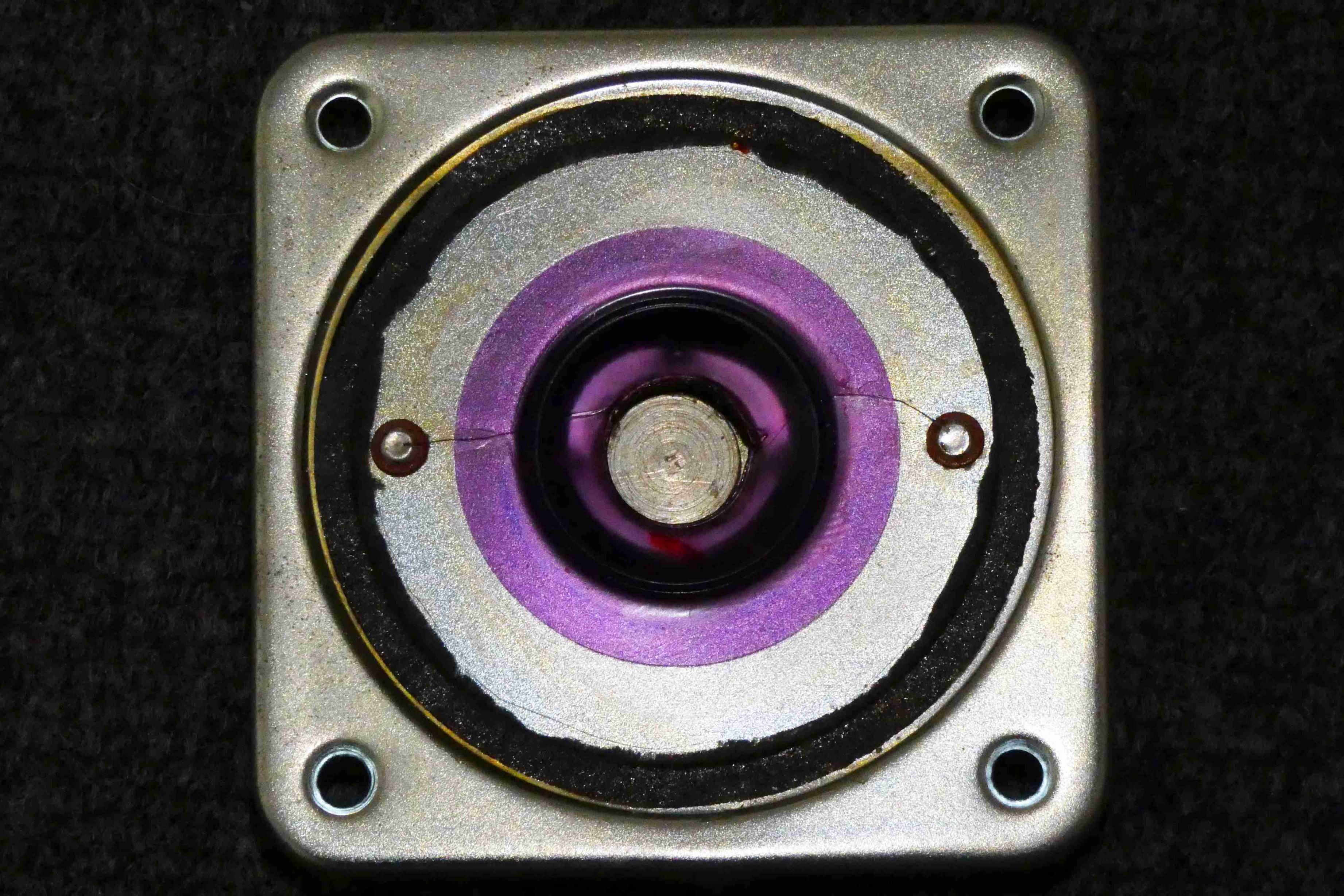

I will get the tweeter photographed a little later today for you.
Geoff.
Thanks, that would be life a lot easier.
Photo attached of the inside of the tweeter with its cloth cover removed.
Bit of a mess as the whole of the magnet assembly had fallen off in transit damaging everything and pulling out the rivets holding the assembly in place.
Anyway - hope this helps.
Geoff.
