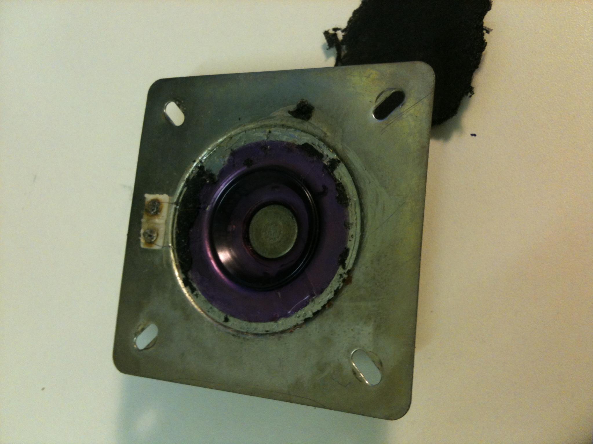

Re tweeter: As suspected, the famous Wharfedale synthetic purple tweeter material is used for the cone.
Here they are with fabric cover removed.Actually the tweeters i may have are from Leak 2020s. Still a large fabric covered thing but not sure if exactamundo the same thing. I shall still have a look!
Very similar to the 3XP tweeter.

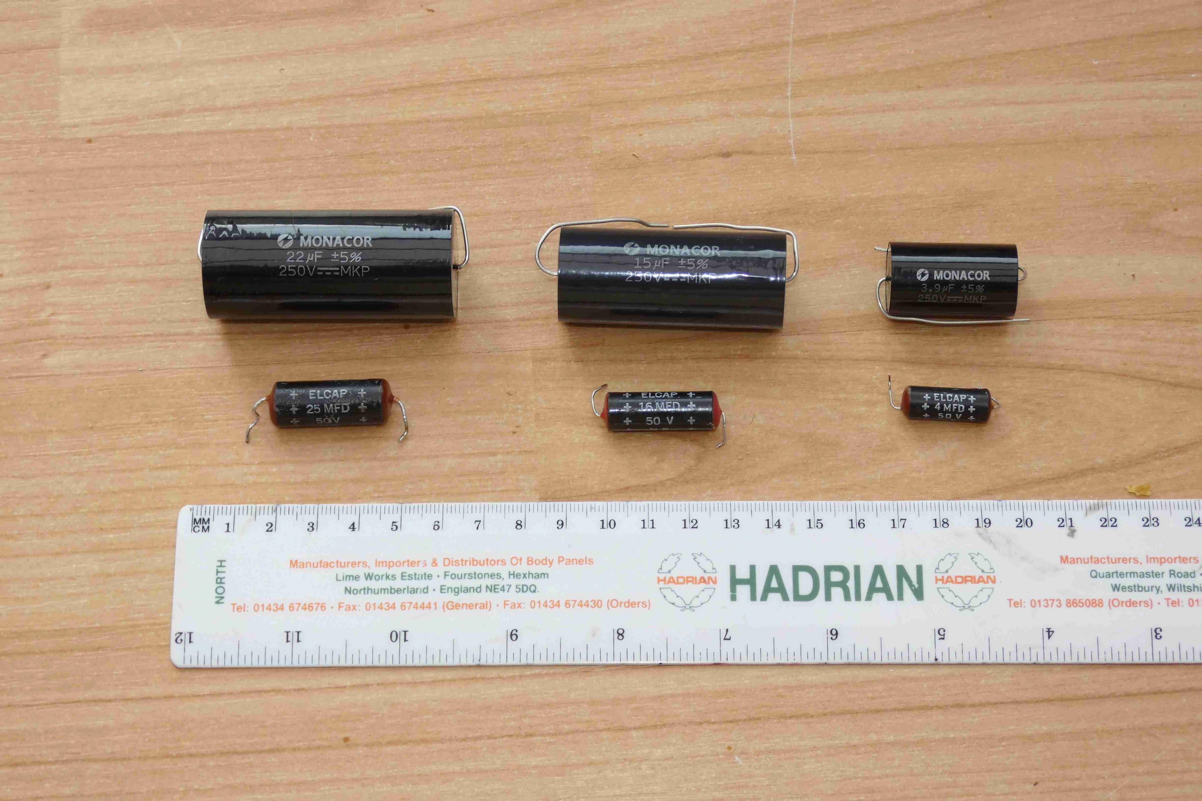

About to order the following capacitors Monacor 22uf and 15uf and 4.7uf all 250v 5% Bipolar MKT Polyester (Metallised Polyester Film) - hope that is ok? From Willys Hifi.
The equivalent from CPC comes out at £23 more (I need four of each for the two sets of speakers).
Most are all a bit big but there is plenty of room to fit them in.

Just found that Wilmslow Audio also do similar Capacitors but they are Polypropylene as against ones that Willys sell that are Polyester.
Any preference or does it matter as the Willys version are a bit cheaper? Totals being £54.80 with Willys and £61 with Wilmslow.
With both companies they are all Monacor capacitors.

I notice Wilmslow have a 3.9 uF which is closer to the original 4uF than a 4.7uF.
I wouldn't sweat over it though!

Well, bought and fitted new capacitors to my 3XP crossovers and, sorry to say, although the base and mid are perhaps a touch better the treble is much more harsh, thin and scratchy.
In fact, overall I am not sure there is any real improvement as the smoothness seems to have disappeared. Base is perhaps not so deep and cuts off more quickly, the mid is very slightly more forward but it is the treble that sounds a lot worse with all the smoothness gone unfortunately and very uncomfortable to listen to.
Photos of capacitors attached and as fitted.
Question - which capacitor is used for the tweeter - 25, 15 or 4 uf so I can put the old one back?
