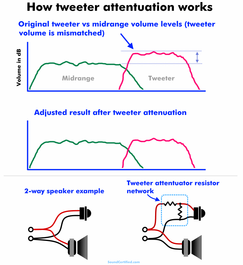

The way to adjust the level of the tweeter is not to alter the capacitor value - that would change the crossover frequency.
The tweeter can be attenuated using a pair of resistors arrange in an L-pad circuit (see attachment). This is placed between the high pass filter and the tweeter. I can suggest resistor values to try if you wish to pursue this course.

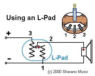

If you were willing to mount a switch on the back of the enclosure, then you may wish to consider mounting a variable L pad control (see attachment).
This will allow you to adjust the treble up and down in level to suit your taste.
A major advantage of using a variable control is that we won't have to experiment with fixed resistor values.

P.S. An L pad is not like an amplifier treble control that rolls off the higher frequencies more than the lower ones.
An L pad moves the entire treble frequency range up and down in a shelf like fashion as illustrated in the attachment.

Good idea - I will go the L-Pad route.

Dealing with the practical question, the operation of the L pad is independent of the capacitor value.
