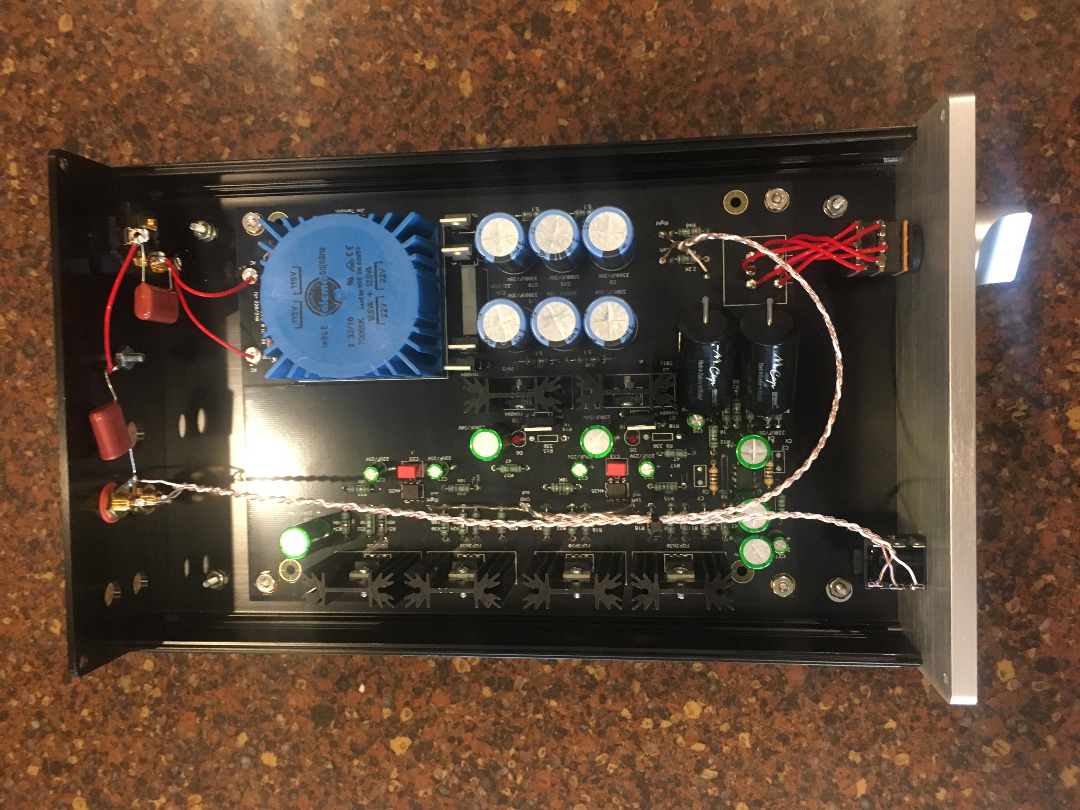

Odd hum
My second whammy is experiencing an odd hum. When I made it, I used some cheap mic cable for the inputs and outputs, and it had no hum.
I swapped the cheap cable for some pure silver solid core wire I had leftover from another project, and now when I have nothing plugged into the input and I turn up the volume, I get a hum. When I plug in RCA cables and connect them to a source, (still nothing playing), there is no hum.
Any ideas?
Any ideas?
Mic cable works better. Go back to it.
I'm gonna guess because of the shielding?
All I have in my junk drawer is quad cable; 4 conductors and shield. Any recommendation on whcih wires to use to for what?
Shield for ground, inner conductors for signal. Double up or leave some conductors not connected as you like.
With nothing plugged in you have a high input impedance amplifier and unshielded cable. A perfect AC power line detector.
You may want to try Mogami Gold mic or instrument cable. It's pretty neutral and super shielded.

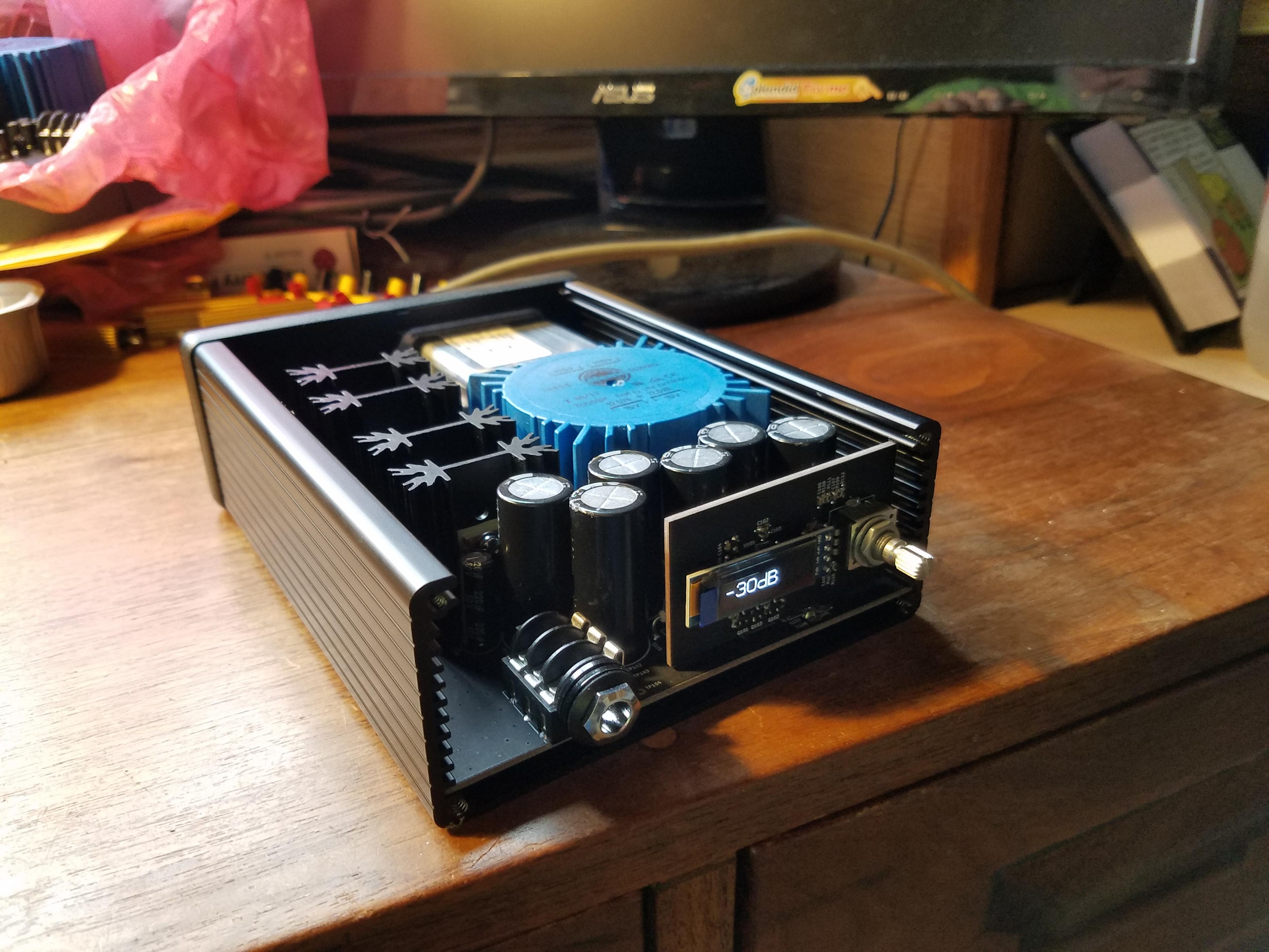

... a reduced size WHAMMY using surface mount components for much of the design ...
This is completely awesome!
fwiw I used CANARE L-4E5C star quad microphone cable for hooking up my Whammy which was left over from making a replacement headphone cable for my hd800.
Use all 4 connectors just double them up to make pairs when you need a 3 or 2 wire connection.
You can see the white ground cables of the star quad doubled on the headphone jack and pcb in this pic its the same on the rca inputs

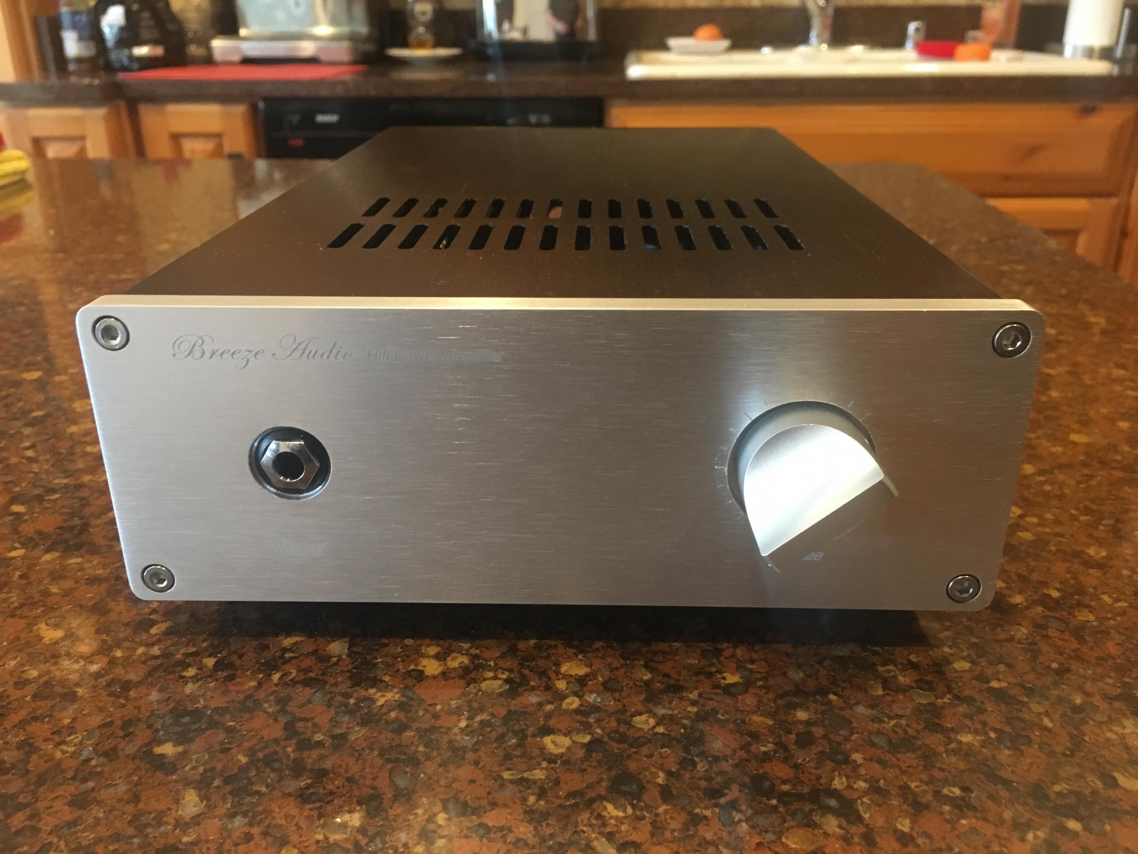

Finished my build yesterday. Has burned in for about 24 hours. Feeding it directly from a Border Patrol DAC and it sounds very nice and is dead quiet. Nice alternative to my Bottlehead S.E.X. Big thanks to Wayne for sharing the design and everyone that worked to put this kit together.
