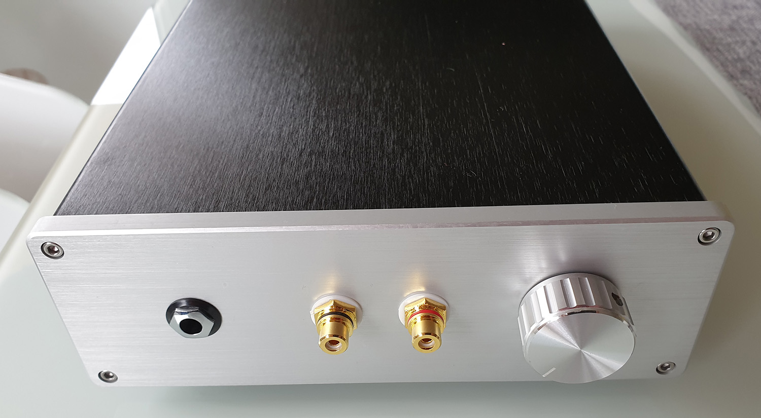

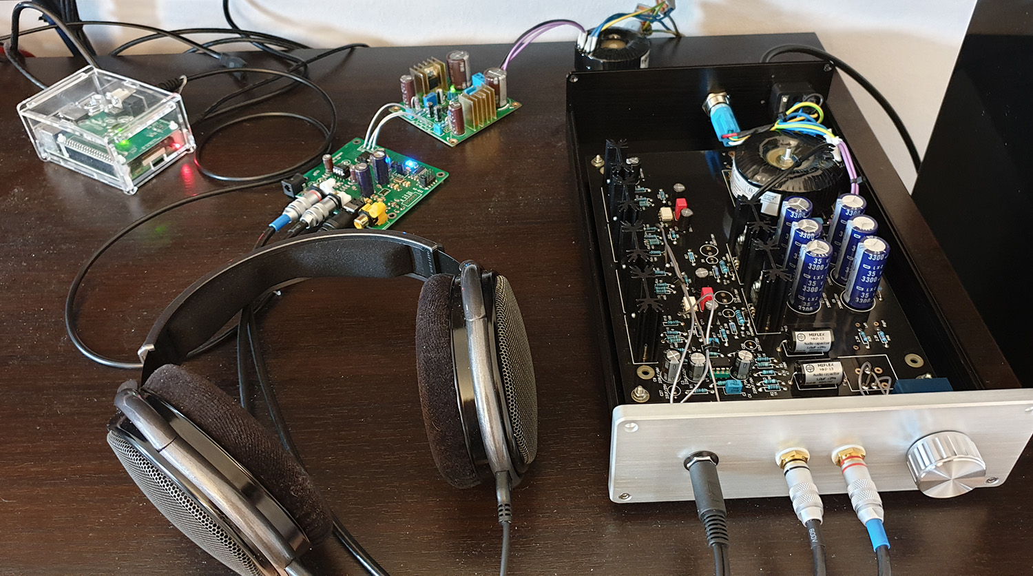

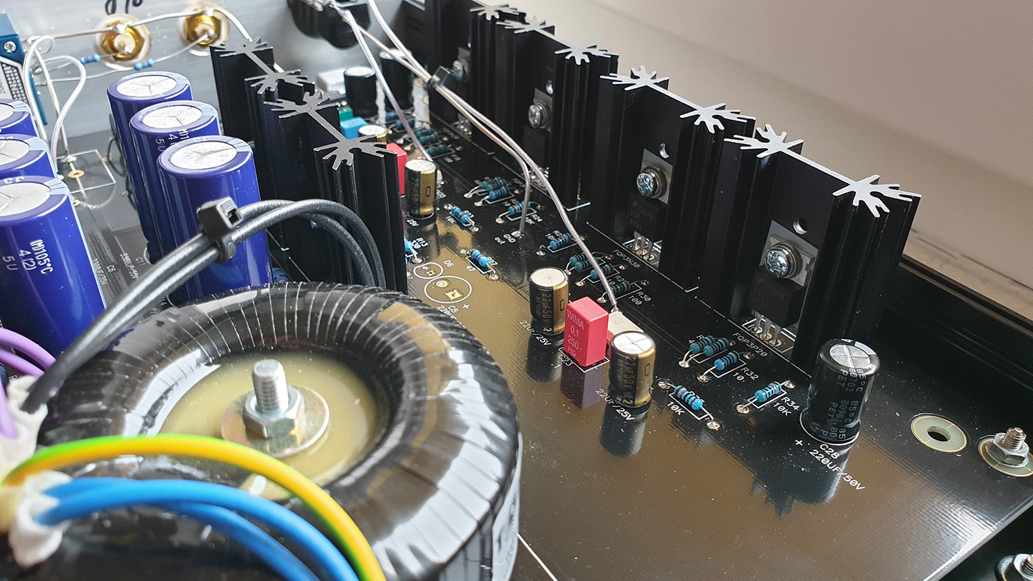

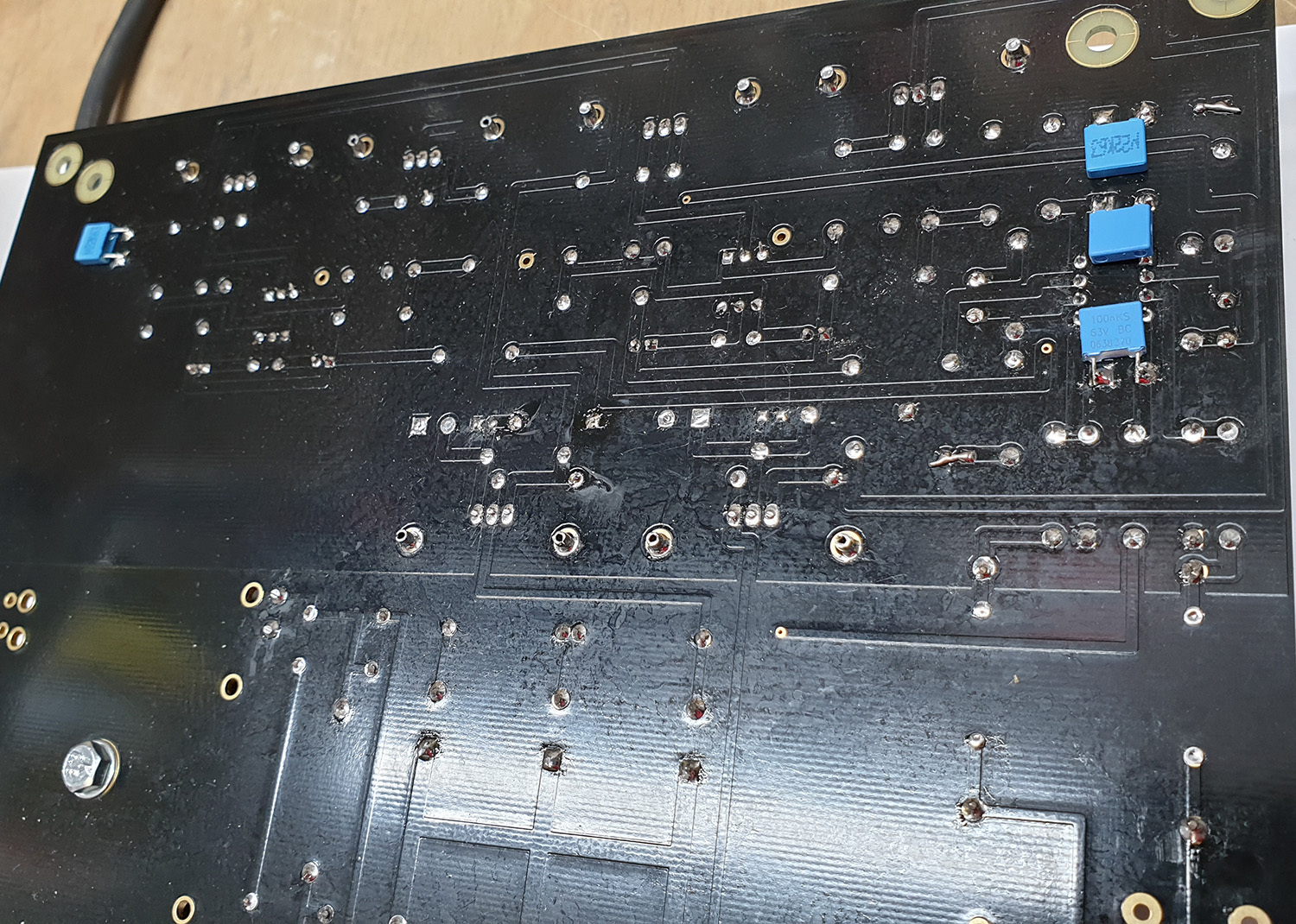

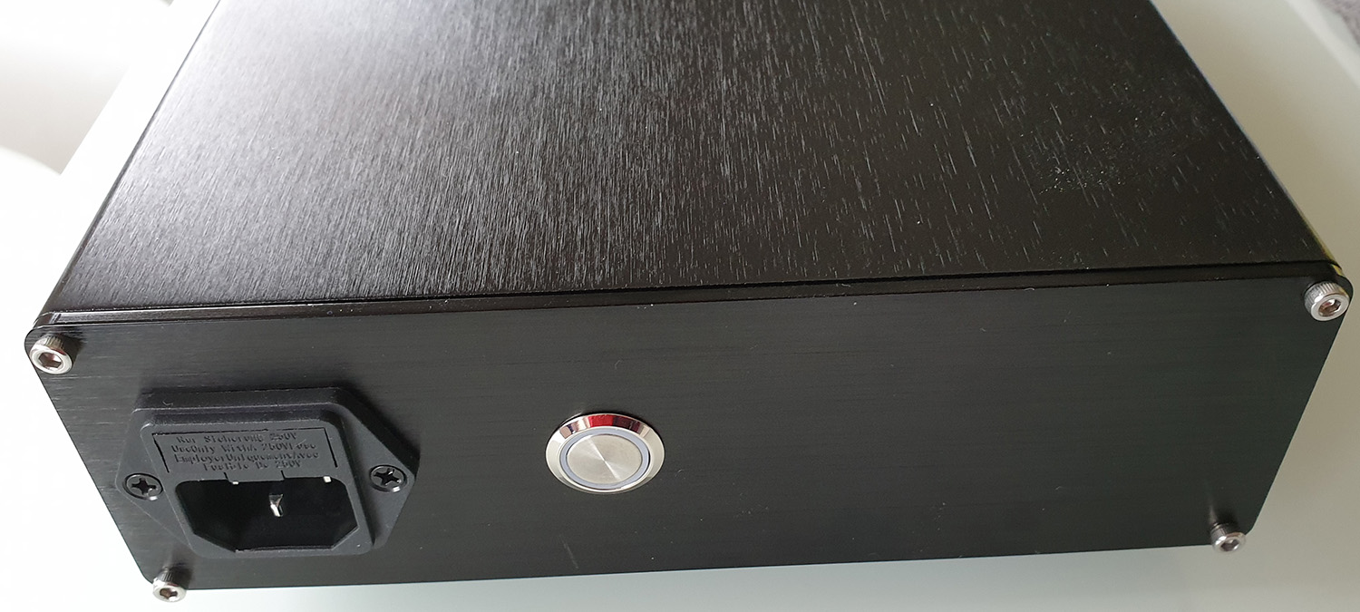

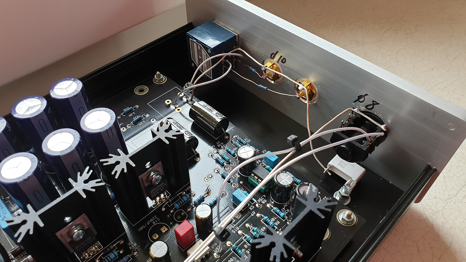

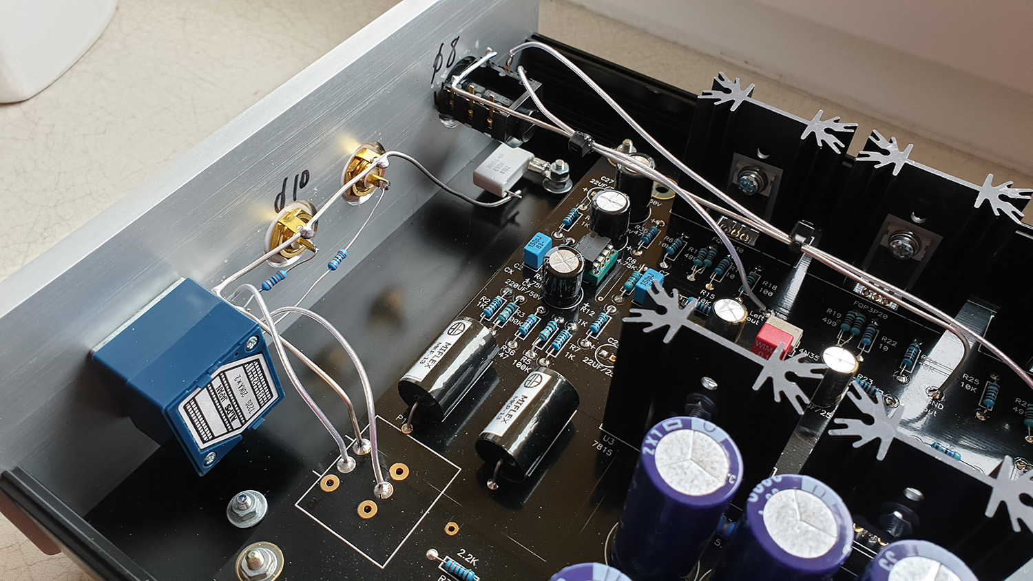

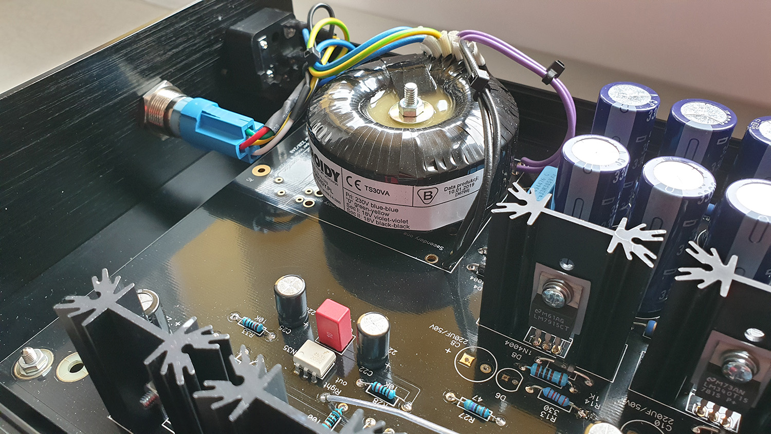

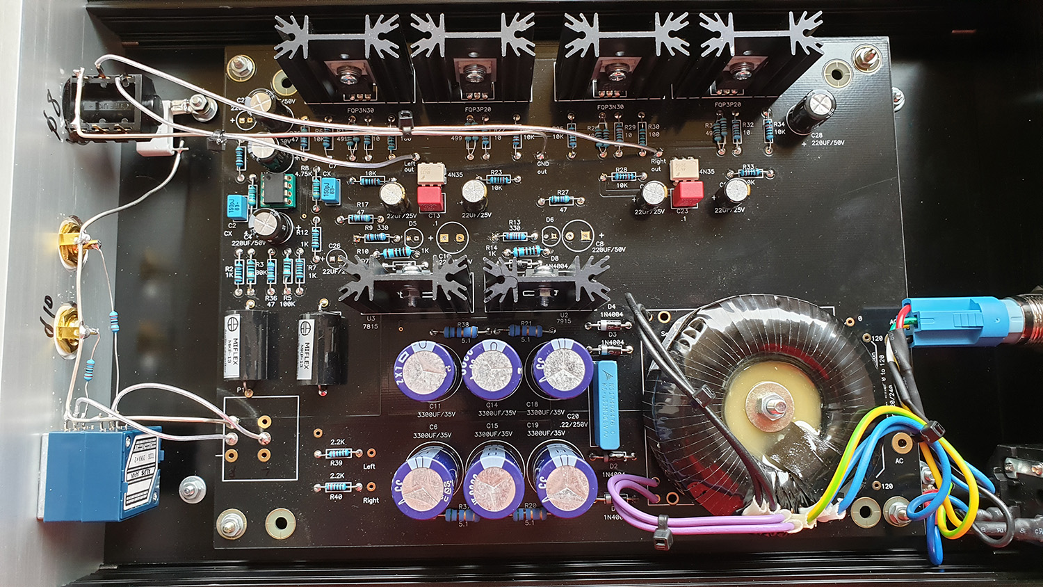

I finally finished this build yesterday, but firstly I have to thank Wayne for an excellent DIY project.
I have been running this PCB in my garage for about 300h, so it should have settled by now. My first initial impressions from today are that this amp is really good. What especially stands out is the extremely natural mid range. Lower and upper frequencies are also very good.
The OPA2604 sounds really good, surprising because this op-amp does not sound good in any of my other amps or DACs (very dark sound).
I am very satisfied with the build, especially the wiring turned out nice (using a 1,3mm diameter silver coated solid copper wire for the grounding) , box looks elegant.
My Specification: Polish toroidial transformer 30VA 2x18v with shield, Voltage after regulators +/-17V, Fairchild FQP3N30 / FQP3P20, OPA2604, Miflex PP 1uF caps, Ali express case
Listening setup: Raspberry pi3b running picoreplayer, DAC modded Chinese ES9038Q2M with muses02 opamp, headphones Sennheiser HD650
Mods: not much, just some extra 100nF filtering caps on the other side.
Some build issues: I had some problems getting a symmetrical voltage when using LEDs for the regulators, I fixed this by removing the LEDs and putting modified values for R9/R10 R13/R14, I also needed to put 150pF for CX otherwise the amp was not stable.
Output offset voltage is now approx 10mV, The muses02 has a lower offset Voltage but I am using it in the DAC.
Future planned mods, I have ordered more muses02 op-amps, this amp is amazing in the DAC, also in a LME49600 headphone amp. In the future I will try doing a blind test comparing three other headphone amps.
here are some pictures:

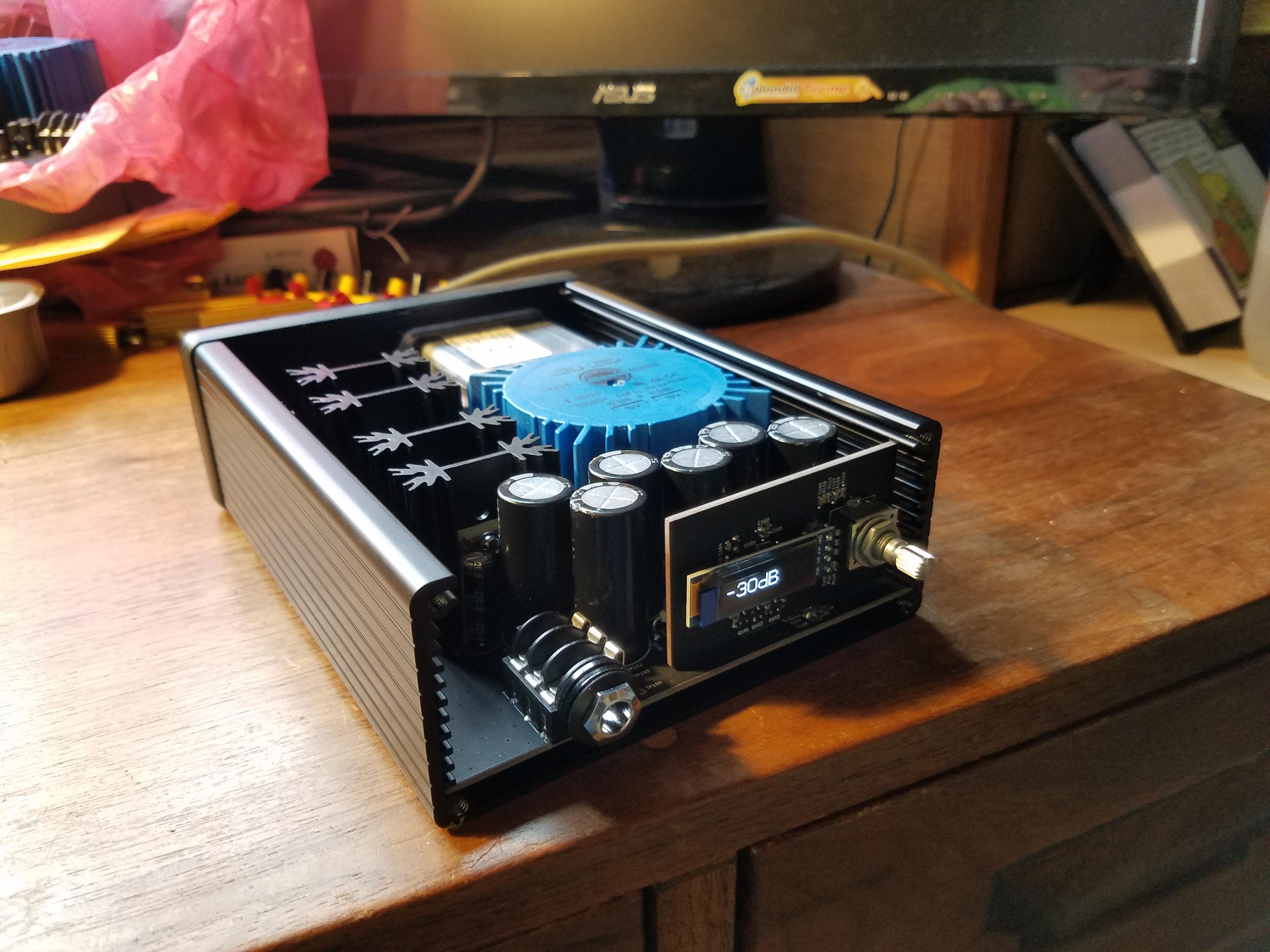

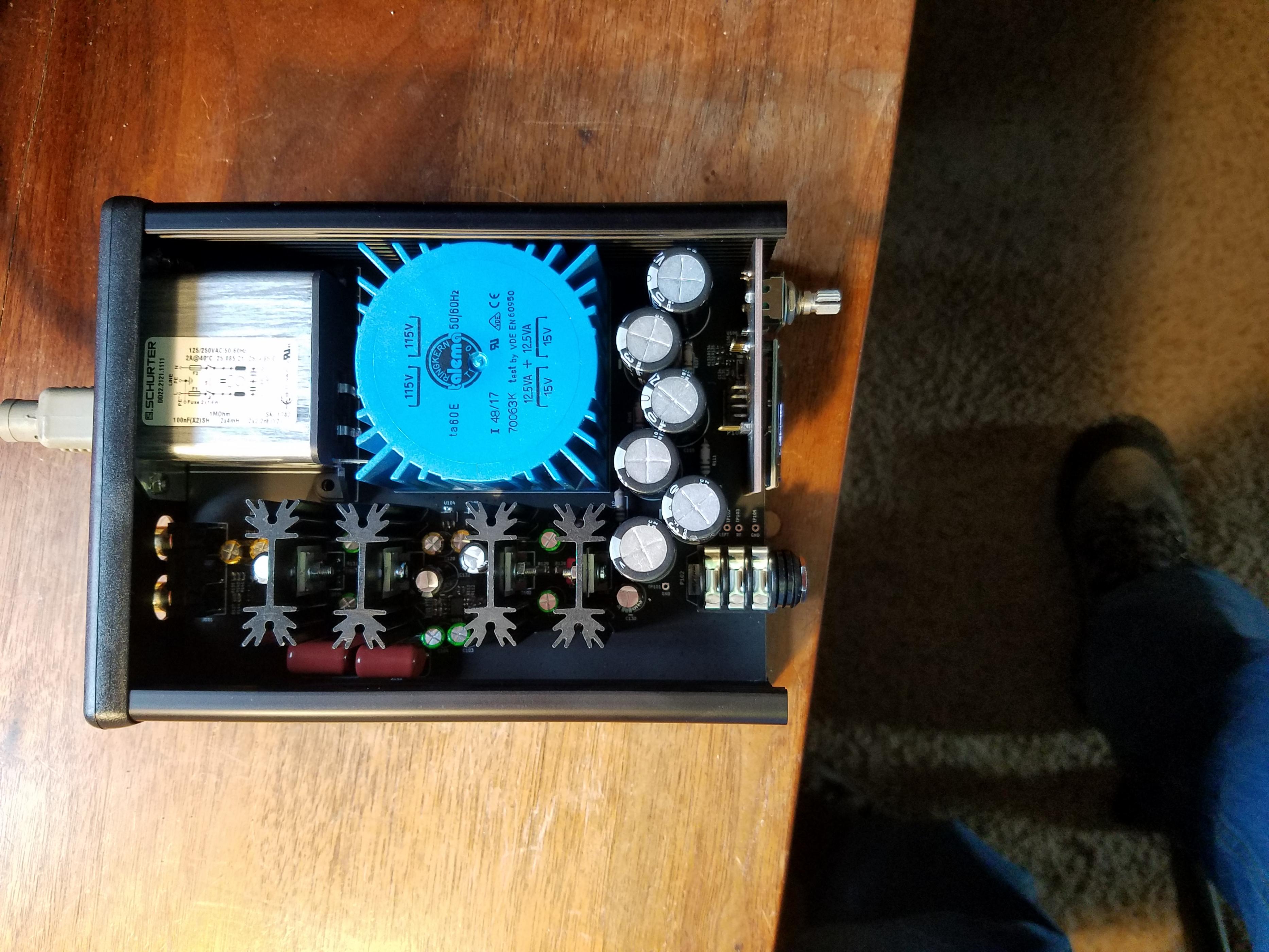

WHAMMY variant
I posted some information in post #388 about my try to make a reduced size WHAMMY using surface mount components for much of the design and I may have followed up with some information about having a high frequency oscillation that subsequently got solved.
After working on the design for awhile and testing a FET switch based stepped attenuator I designed with the board I ended up not using the attenuator design.
I then did an iteration on the main board design to move to the Talema toroid transformer instead of the Hammond transformer I originally had in the design. I also added a DS1882 attenuator to the board for volume control. The attenuator is controlled by an MSP430FR2433 processor mounted on a small front panel along with a small OLED display.
The design includes a board mounted input jack and board mounted power input module. It all fits into a Hammond 1455 series chassis that's a smaller version of the original WHAMMY. And there are no wires.
A couple pictures showing the board in the enclosure and the front panel display.
answer to jhofland #1257
Hello Jhofland,
very nice and compact build! Very good implementation of volume control with
display.
I like it! Listen and enjoy.
Greets Dirk
Hello Jhofland,
display.
Greets Dirk

I love this.. Any chance you will make this board available?
