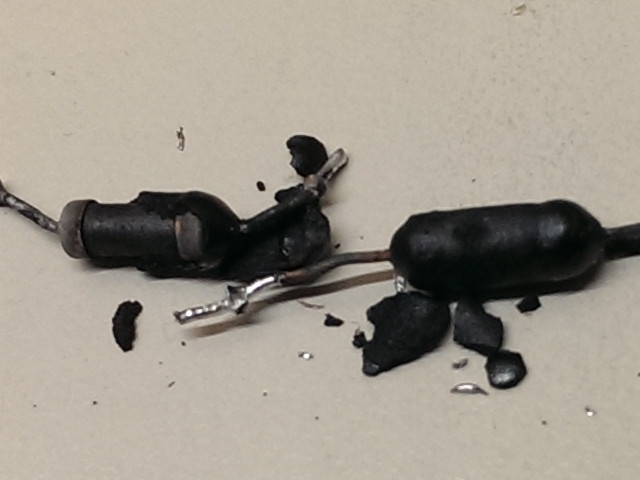

I misinterpreted something I read: heatsinks did not electrically contact the mosfets. The reason for the funky heatsinks - I thought the originals would not fix in the box. I suppose I can run an open working box instead of a closed nonworking one. And turn it on without closing the box next time.
On opening up the box, one mosfet has goo above it, in the box. Would you recommend changing just this one or all of them ? There is also a funny smell.
This coupled with the regulator funniness tends to make me want to replace both regulators and the 4 mosfets. Any other suggestions to test first ? Currently configured as straight regulators. The negative reg. with LED didn't work as expected. I tried the voltage divider but removed it later to use opa2134.

Goo above a mosfet can be very bad it takes a lot of heat to do that. The Toshiba mosfets are a isolated package the others are not.

It continues. I took out all the regulators and mosfets. I started to put new ones in with the correct heatsinks. Then I noticed that R20 and R37 were .... different. It does not seem to be from the caps. See the nominal and new look ones. They still measure 3Ohms though. Started out as 5 Ohms.
