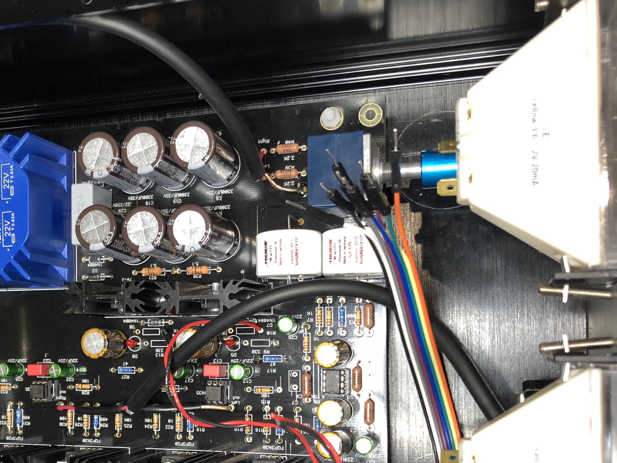

I also don't see the ground connection made near the 2.2K input resistors by the pot for the RCA.
Thank you Wayne! This cured it. Somehow I overlooked it.
No I will solder it in.
I appreciate it!

aheck - please post well-lit, in-focus photos of your build and we'll start to look for anything that seems weird. 😀

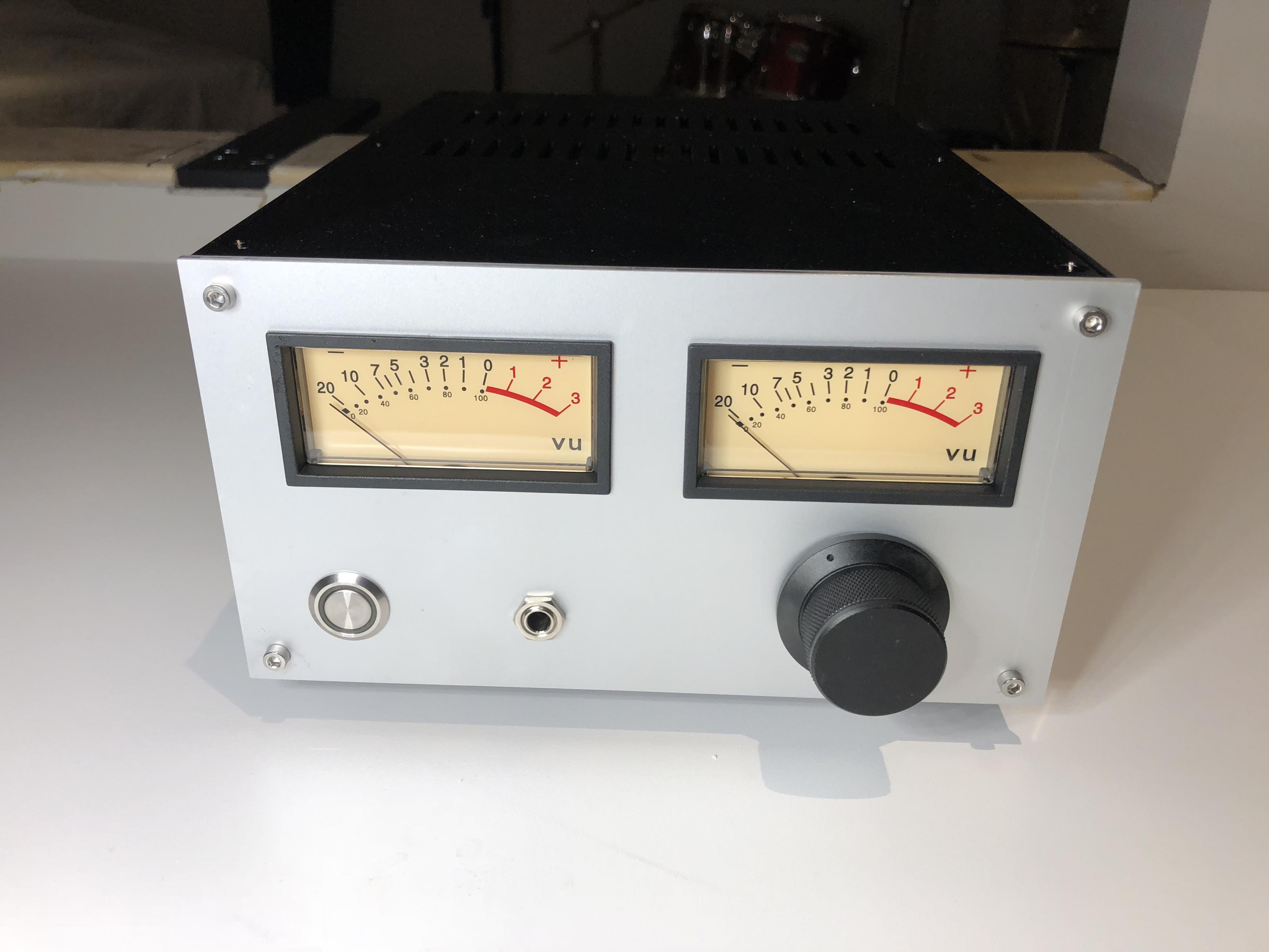

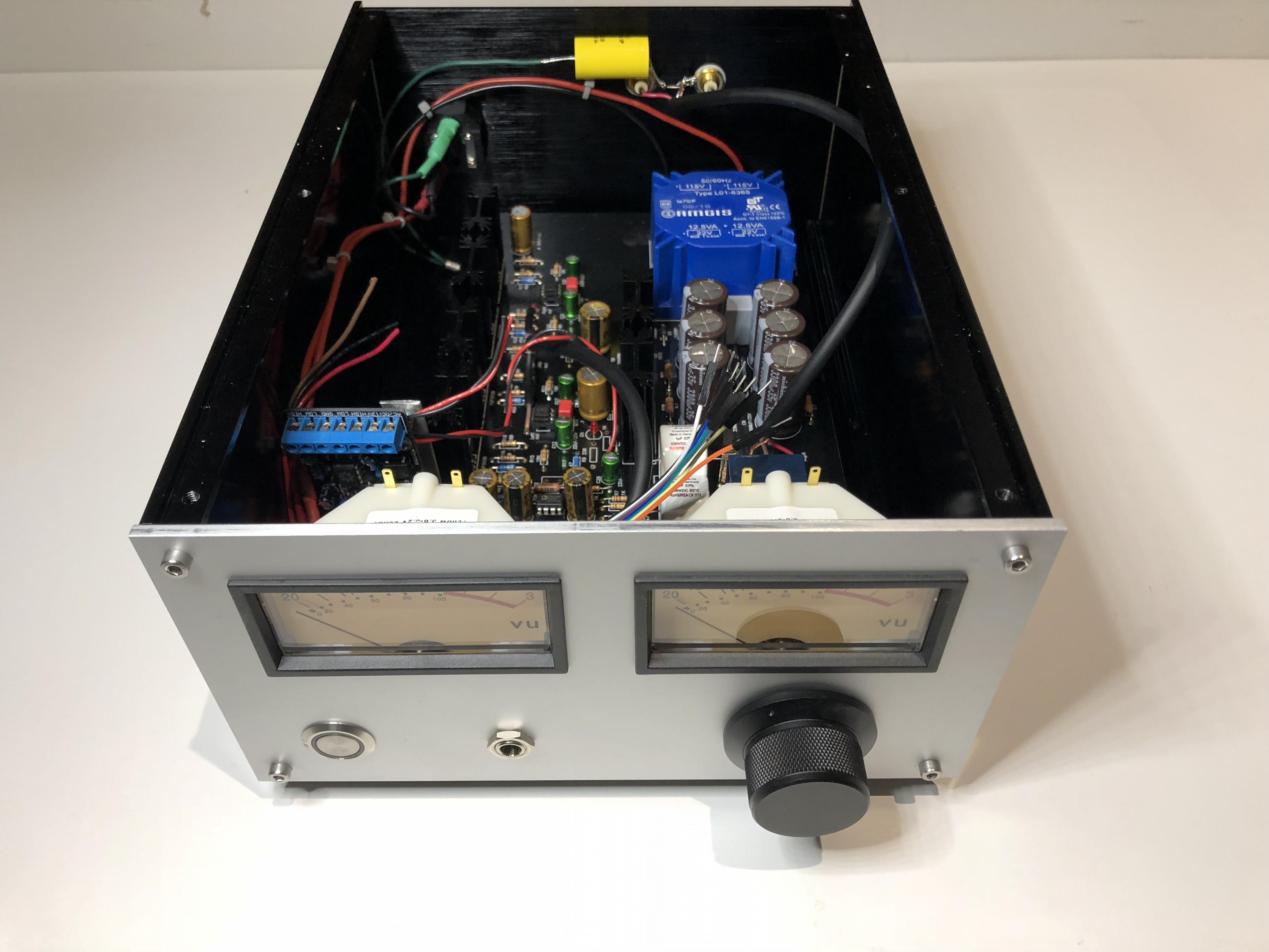

The sound is great. I am not 100% finished yet. Still working on the VU meters and power lights hook ups.

Nice meters. Where do you get them ?
I got them from ebay about a year ago. It is TN-73 VU meter. Multiple places sell them.
