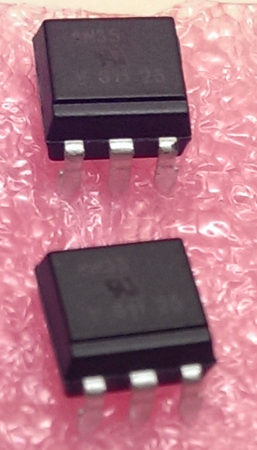

Vishay opto coupler 4n35
Which is pin 1 ?
I don't see a dot. The notch along the side of the package is similar to the build guide I hope. Meaning the V marks pin 1 ?
Reference:
http://www.vishay.com/docs/83717/4n35x.pdf
Sorry about the fuzzy phone pic.
Which is pin 1 ?
Reference:

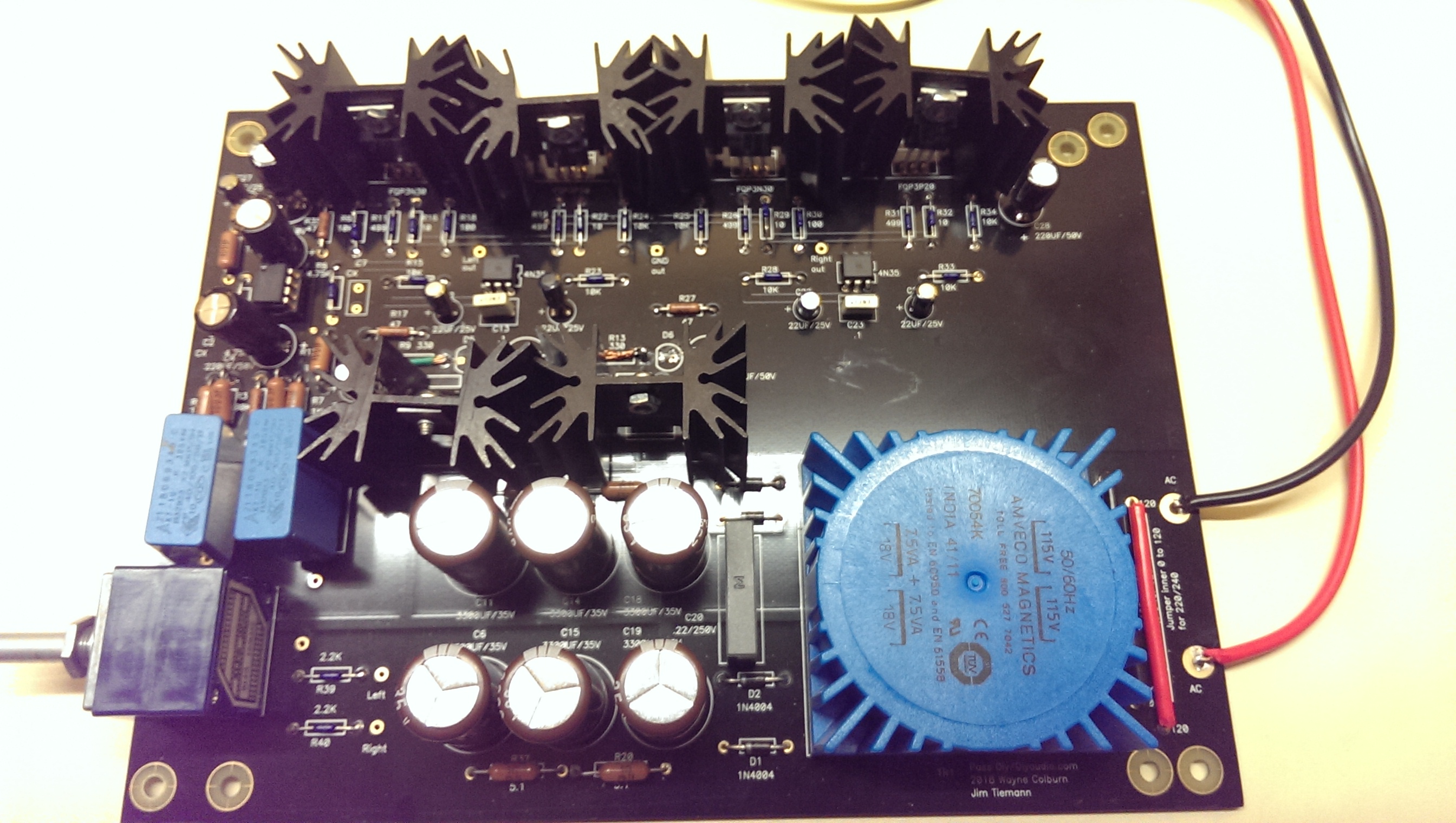

With a LM4562, output offsets are
L -1 mV
R 0.8 mV
I'm tempted to call it good and stop fiddling. Any thoughts?
Missing headphone jack, input and output wiring. Hopefully soon. I surprised myself by not cannibalizing cords.
Though I am an ME by education, I seem to forget to check mechanical dimensions. 🙂
L -1 mV
R 0.8 mV
