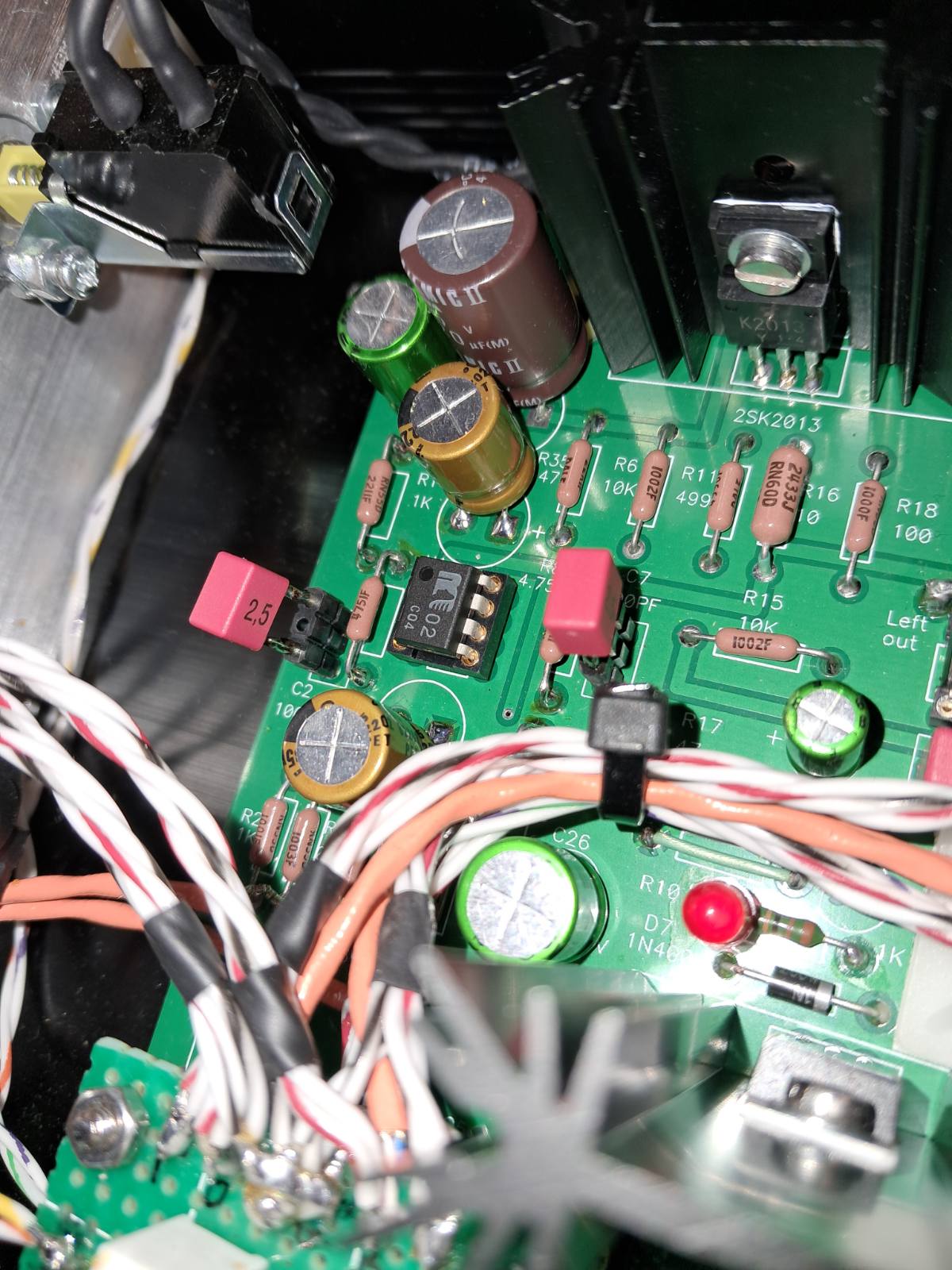

I played around with various opamps, and came back to the Muses 02. Somehow that one fits best with the Whammy. Yes, the Burson V7 Classic sounds a little better, but that opamp heats up like crazy at +/-15V, so it's not my first choice. The box is closed, I'm afraid of what will happen in the summer when the temperatures rise. At @mikorist Whammy 68pF compensation was needed for Muses, here 33pF is enough. Obviously it behaves differently with Toshiba mosfets .I rarely use headphones, but it's great as a Line preamp, and that's how it'll be used mostly. I think I closed the box for some longer period of time. 😁
Of the important changes compared to the original schematic, I have:
1. R1/R12 - 2k2 (lover voltage gain: 3,15x)
2. C26/C27 - 100uF 16V bipolar (Nichicon ES MUSE) for a lower cut-off frequency: 0.7Hz -3dB (original 7Hz -3dB)
3. C12/C17/C22/C25 22uF 16V bipolar (Nichicon ES MUSE)
4. C2/C7 - 33pF (Wima PP) for Muses 02 opamp
5. Without C1/C5, signal cable connected directly to R2/R7 and GND
6. Output DC protection by @miro1360
7. Mute assembly
8. 7815ACTG & 7915ACTG voltage regulators
(R16/R22/R29/R32 - 10ohm Dale RN60D, everything else Dale RN55D)

When C1/C5 1uF are not used (DC connection) , you can expect a small change in the DC offset at the output depending on the used opamp (fet/bipolar inputs) and the value of the potentiometer. Specifically for 100k pot and Muses 02 DC offset changes from 0.7mV to 4mV with potentiometer rotation. It is in principle negligible, and with fet inputs opamap is less, and with a smaller value potentiometer it is also less.
What I noticed with the Burson opamps is the large DC offset. Specifically, with the V6 classic and V7 classic, it starts from 20mV when switched on and then drops to around 8-10mV. The small trimmer is available on all of them for adjustment, but on the V6 it is closed and inaccessible from the outside without opening it, and on the V7 it is available, but removing the small white sticker seems to void the warranty. DC offset adjustment is tricky, it's small trimmer and very sensitive to the slightest movement, but it can be adjusted to +/-1mV when warmed up.
I've been rebuilding a Whammy I bought used from the bay of fleas - should have built one fresh but you live and learn, but have a new board in it now with Sparkos regulators, an Evotronix Saligny mosfet regulator and I was plannnig on MUSES02 op amps, which I've not tried yet. I've got Burson V7 vivids already and in a Lehmann amp they sound quite full with a forward mid compared to a 2134, which I'm not keen on for a headphone amp, so I'm hoping the 02 will add to the 2134 sound with a touch of bass and sound slightly more open, that would be ideal. I've got 100pF comp caps in at the moment but I've not finished building yet, I'll keep your mods in mind, many thanks !
The Muses 02 certainly sounds more open than the OPA2134. I don't have them, but I expect that. The NE5532 Signetics, bought second-hand from the Chinese, has a good bass, but it is murkier for me at high frequencies. The OPA2604 also has a lot of bass. The Sparkos SS3602 has a very, even overly open sound in Whammy.
As for the compensation of various opamps, as I already said, without a generator and an oscilloscope there is no way to do it.
From the small technical details, I would add that plastic spacers of 1mm should be placed under the heatsink (on the soldering pins), so that the heatsinks do not touch the PCB. The probability of accidentally breaking through the insulating varnish is small, but it still exists.
