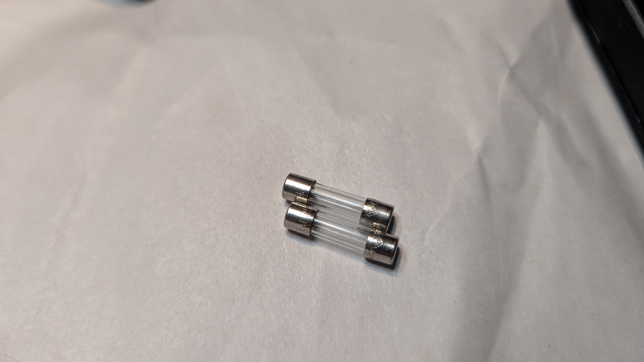

Both look great!Unplug from the wall and remove and check the fuse.

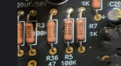

I think it would be good to take some in focus close up views of the bottom of the board. Seems like you could have some possible cold solder joints just looking at the top pics. I guess if it was working for a while, then it's unlikely a solder joint gave way.

Both look great!
With your DMM on continuity mode (“beep”), verify the fuses are intact. They can look fine and be blown.
I heard beeps on bothWith your DMM on continuity mode (“beep”), verify the fuses are intact. They can look fine and be blown.

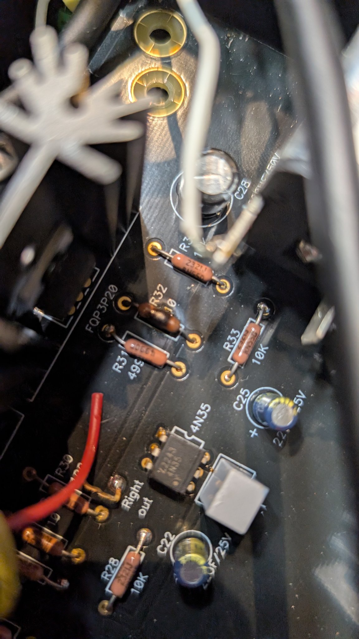

Okay, I would but, r32 started smoking. It scared me so I turned it offOk, good.
Put your fuses back in the fuse holder if you haven’t,
Set DMM to AC volts,
With power on, carefully read voltage at the AC pads near the back of the transformer, where the AC from the power inlet module attaches to the PCB
replace what is burned
obtain new optocoupler, mount it properly
check the other one
see post 5452, 5460
Hi 1nfinity, it appears that the opto-isolator is still backwards. R32 is in the circuit that controls the opto.
Gotcha, gonna order the parts and replace itreplace what is burned
check the other one
see post 5452, 5460
