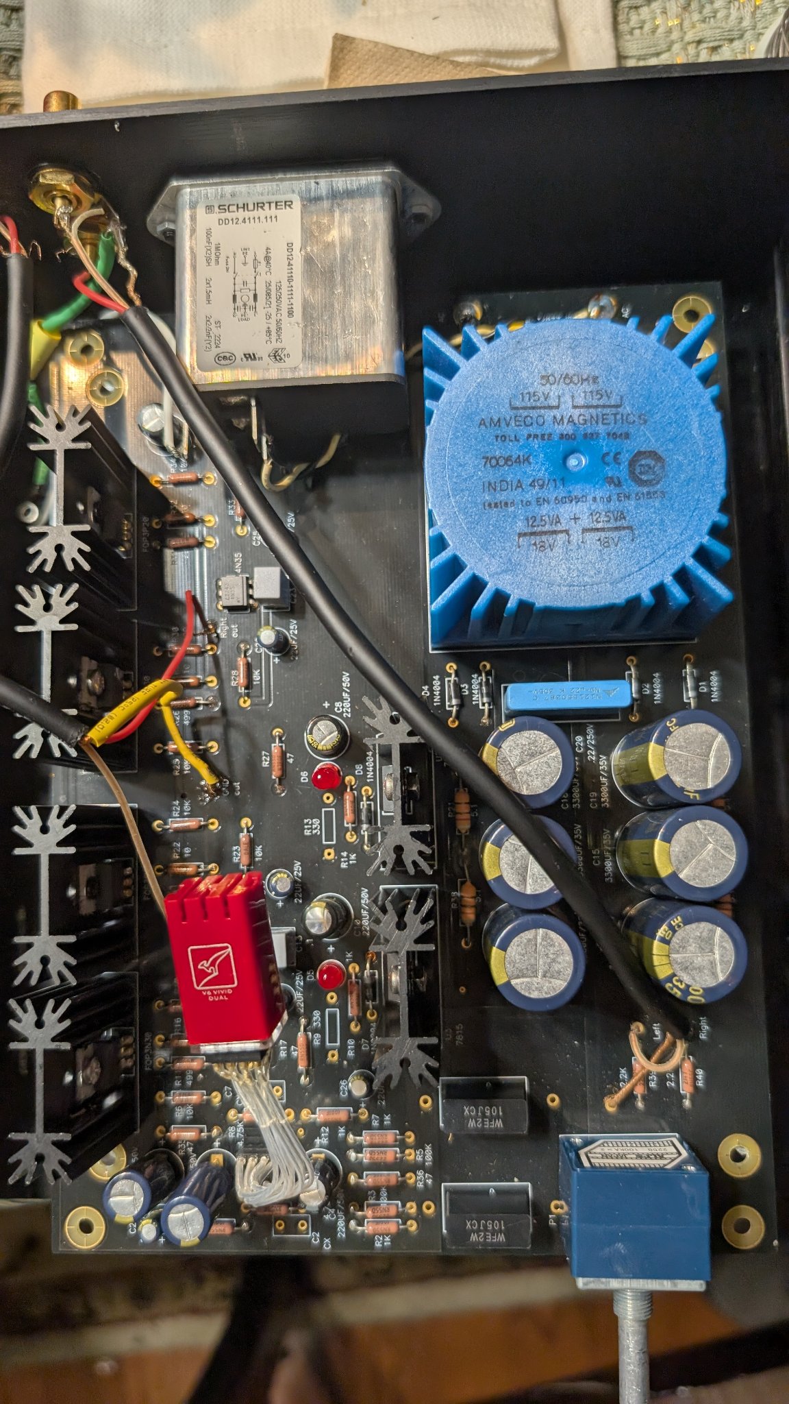

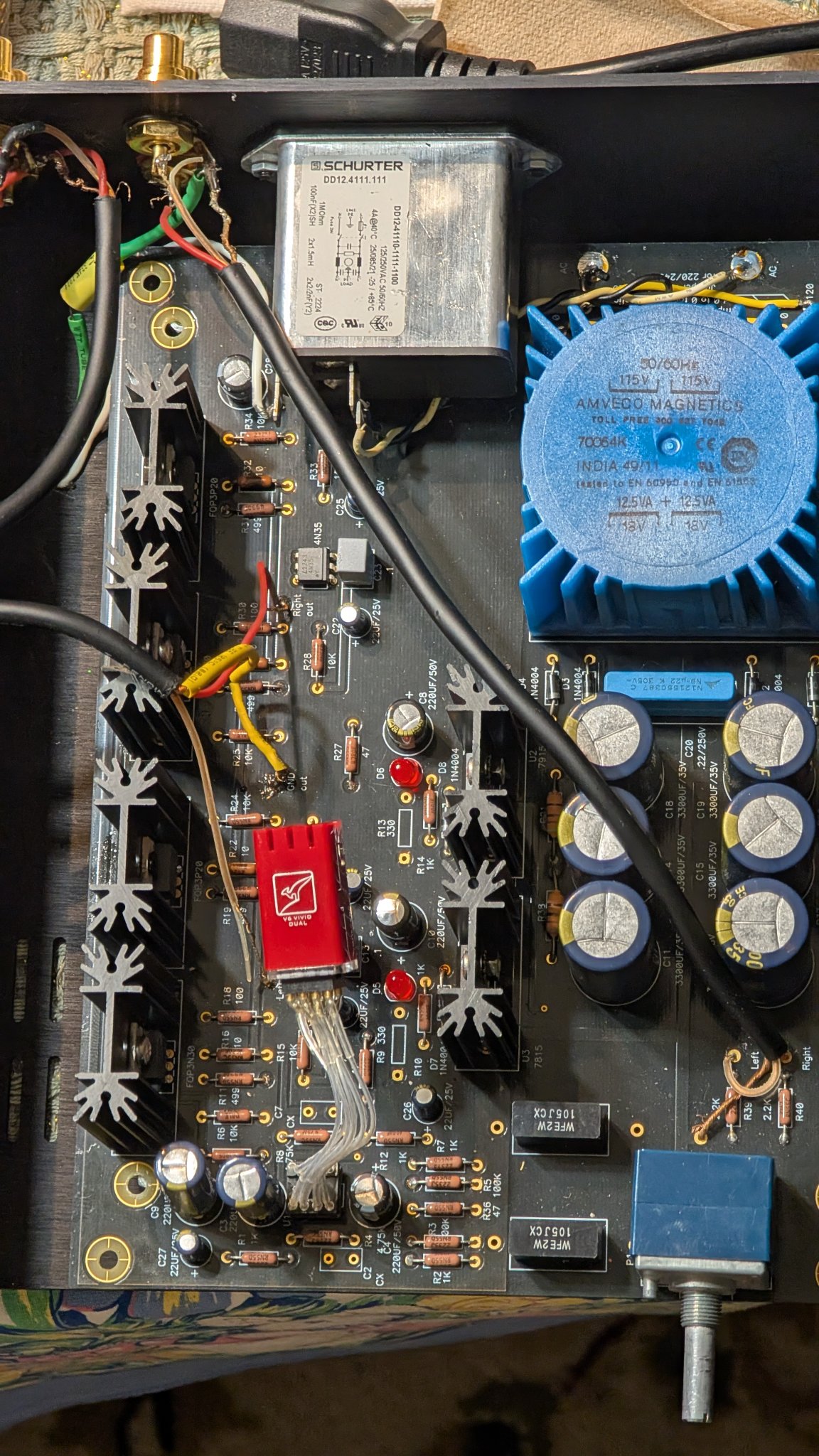

@1nfinity Please post a series of well-lit, in-focus photos of your whammy, it will be extremely helpful for the troubleshooting process
Here are some I hope will help

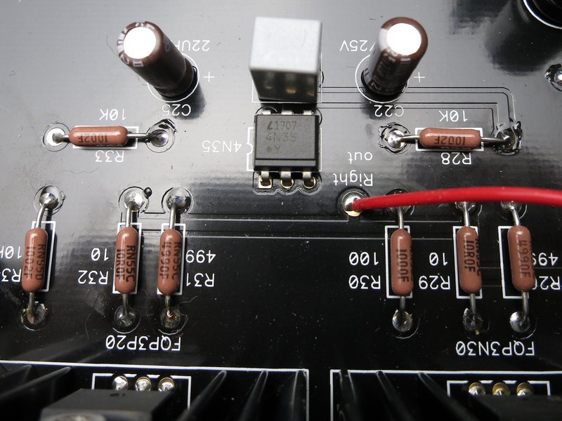

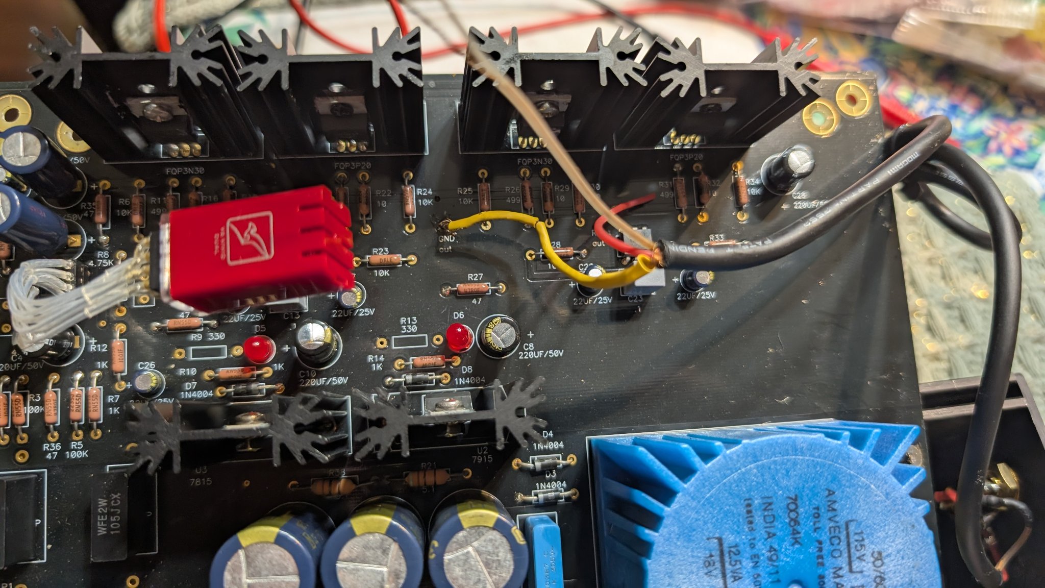

R32 is burnt up, so something was trying to send a lot of current to the negative rail.

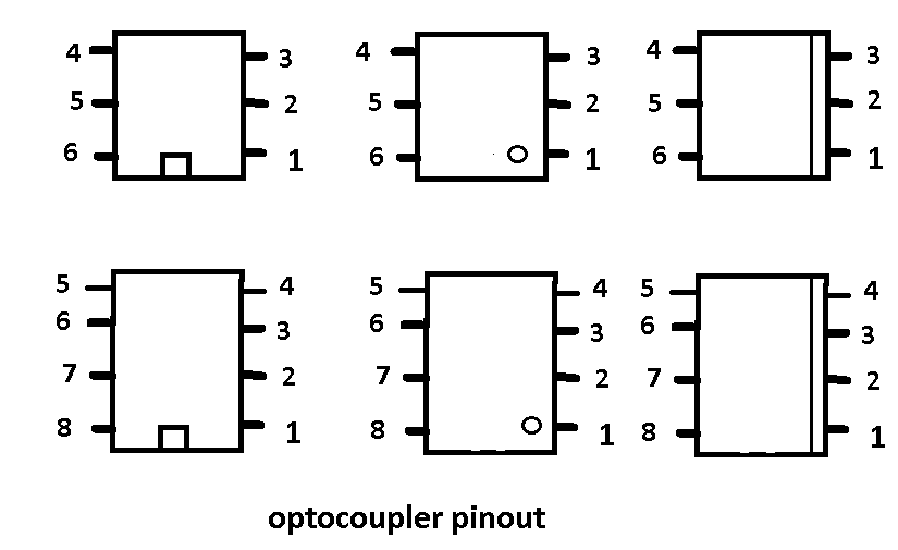

As @ZUM911 noticed, the 4N35 that’s visible in the photo is installed backwards.
The Burson on the fly leads isn’t helping the anything, but may not be the culprit.
If the LED are out, there’s no power to the regulators, so the PSU needs to be probed and determined where the loss is.
What is the raw supply measuring?
