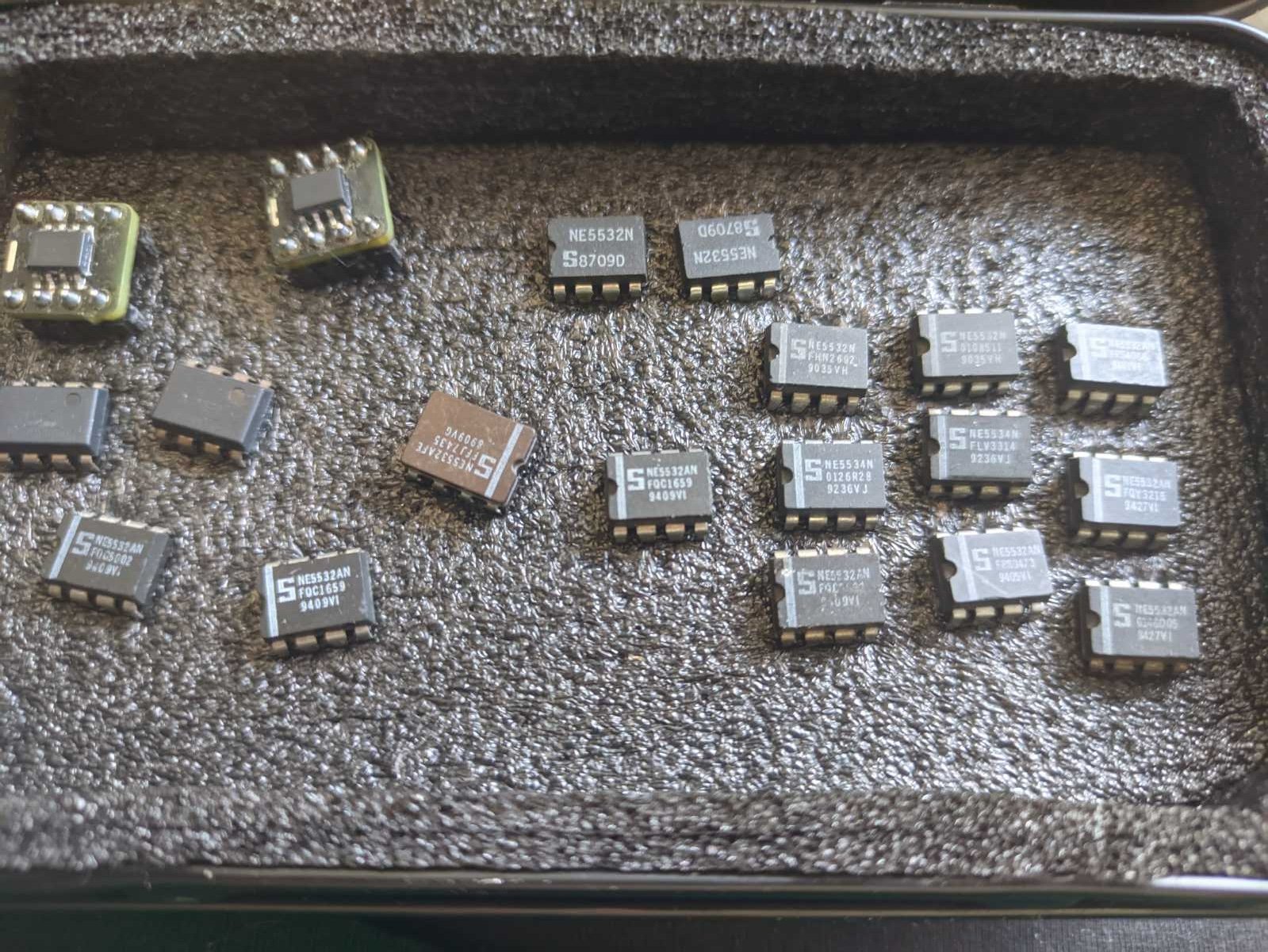

As we chat I stick the Signetics NE5532 into the Whammy. By far the best bass I've heard from the Whammy. The highs are not too sharp, in a strange way it suits him. Bought second-hand from the Chinese. Plucked from who knows what device.
You've never tried the ceramic version of the the Signetics NE5532. Come to me, and I'll give it to you as a gift. I have some extras.😀

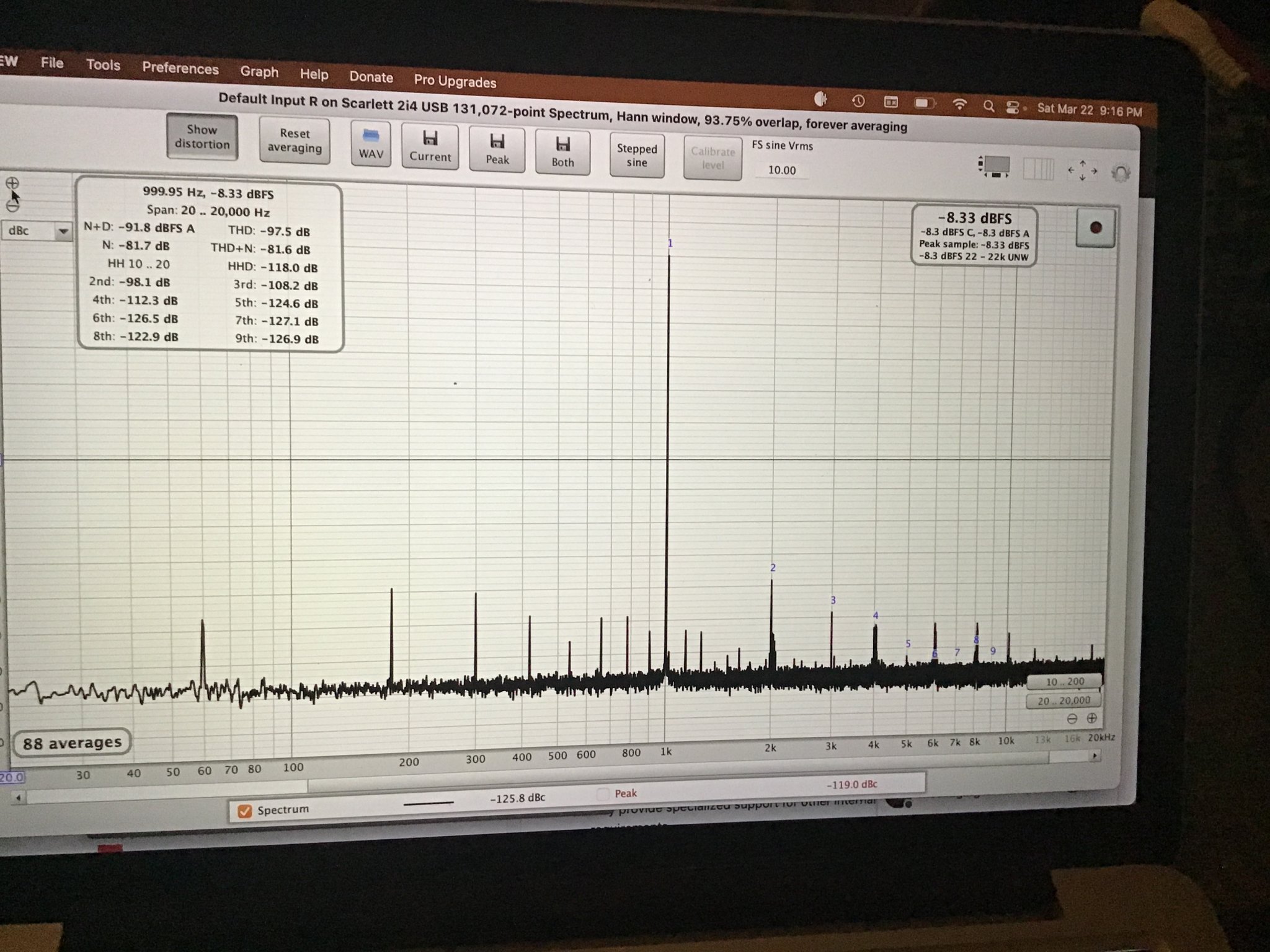

So this is the FFT I got from the Whammy I was loaned.
It’s not bad of course.
But that is with the spikes below 1khz and the harmonics odd thickness structure if that makes sense

And mind you this is done with my Focusrite and a DAC3 feeding the 1khz signal.
So the Focusrite isn’t the best of course

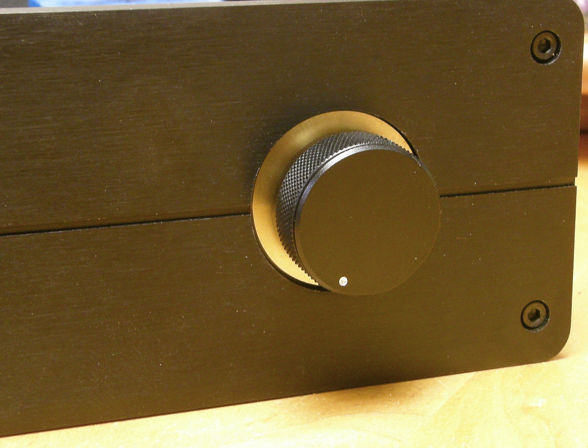

Just something a little different. I have a great selection of knobs, but so far, this one stands out. Also, I decided to use a thick brass disc in the pit, 'cuz that is my mark. I have another on order to fit the headphone jack too. We will see how that looks.
Ahh yes, the ceramic version of the Signetics NE5532! The ceramic version was what was used in the SSL 4000 series recording console. I was a recording engineer and maintenance tech in the Nashville area in the '80's. This was where subbing out an NTE generic replacement part got noticed and I was called out for that. They do sound better than all 5532s and for people who's job is to listen to music all day and be aware of changes, you can't fool them. Also noted was a break in period where the sound of the op amp improved.View attachment 1439049

The spikes below the 1 kHz fundamental are 60 Hz and its odd harmonics: 180 Hz, 300 Hz, 420 Hz, etc. That's why I modified the power supply to a choke-input, with the accompanying change of power transformer, of course, especially since I biased the outputs to about 200 mA each channel.
