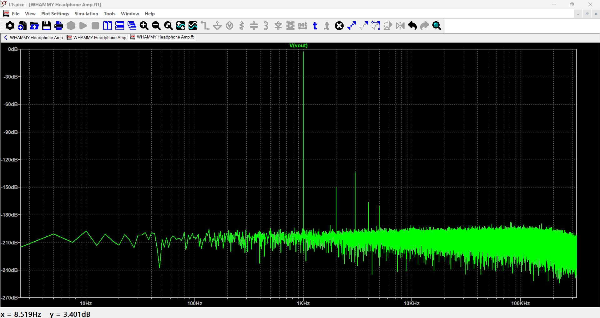

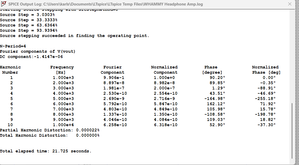

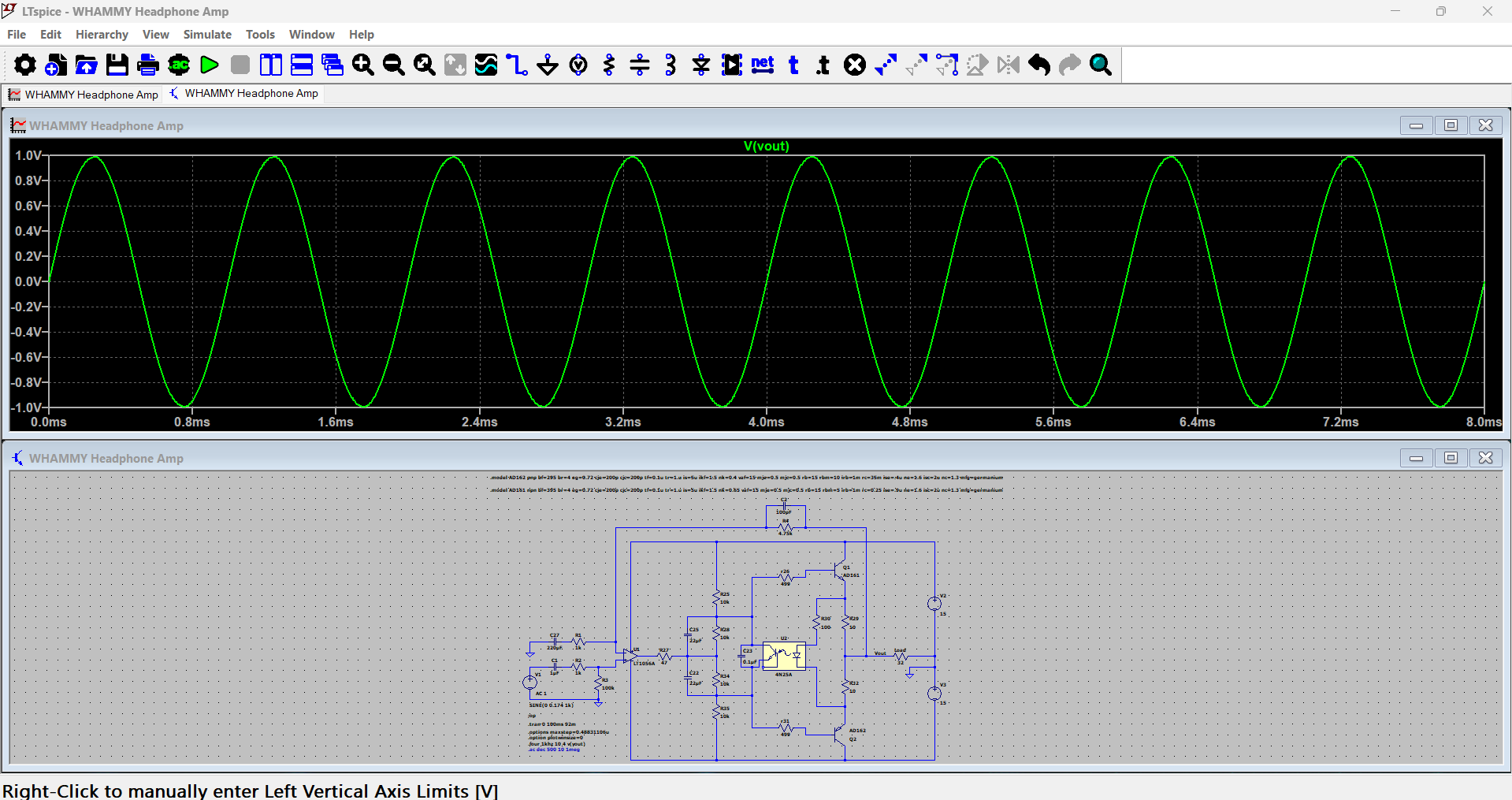

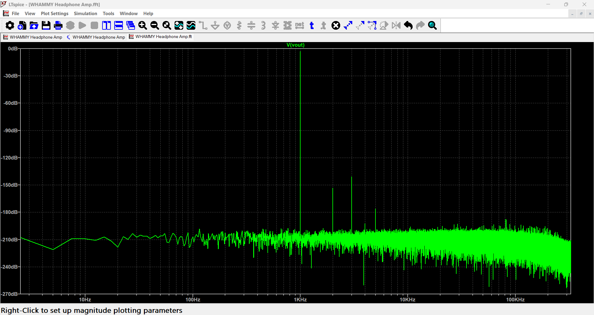

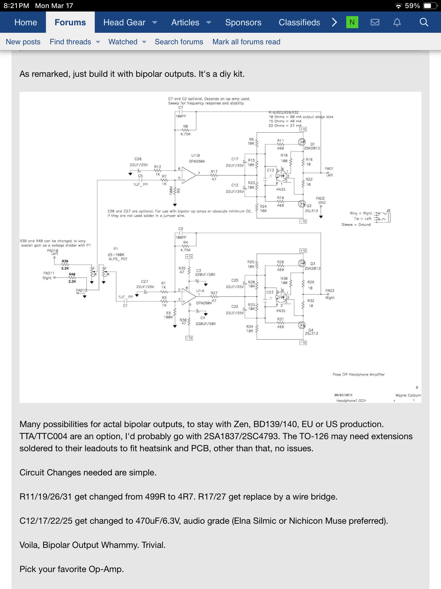

Can the amp run with BJTs instead of Mosfets and would the correct changes be done as the below instructions state?
Much appreciated!
Yes.

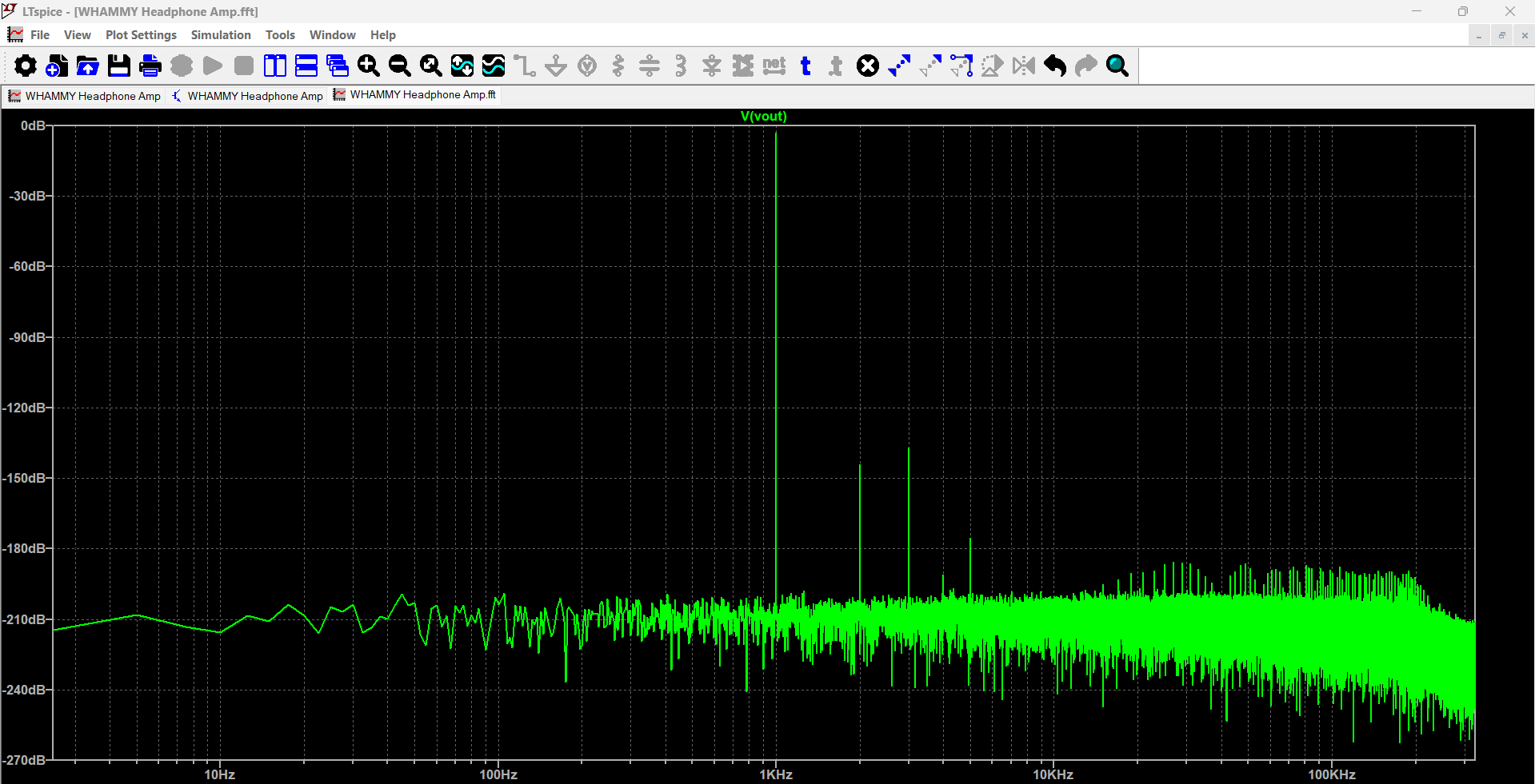

This is the distortion profile in simulation with first FET and then BJT + mods. It could be argued the BJT version is fractionally better although the reality is the simulated result differences are half of a quarter of nothing 😀
Ha, that’s pretty funny.
What are the sound differences ? Classic MOSFET vs. BJT sound differences? mosfets a bit warmer and fuller and BJT faster ?
From those graphs it looks like there was no difference in sound.

mosfets (be it Toshibas or plain IRF) are much easier load for opamp
Perhaps builders can avoid this by carefully selecting BJTs which present an extremely light load to the opamp. Maybe BJT-enthusiastic WHAMMY builders might want to carefully research

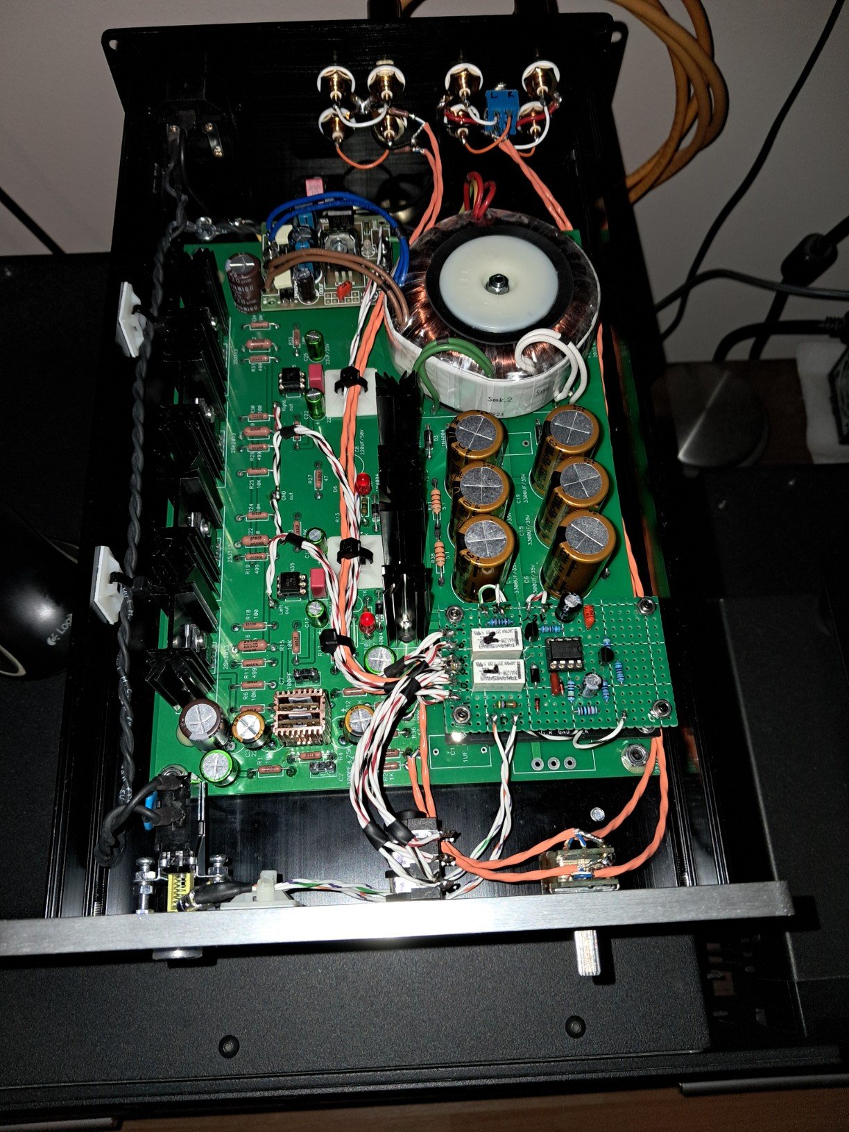

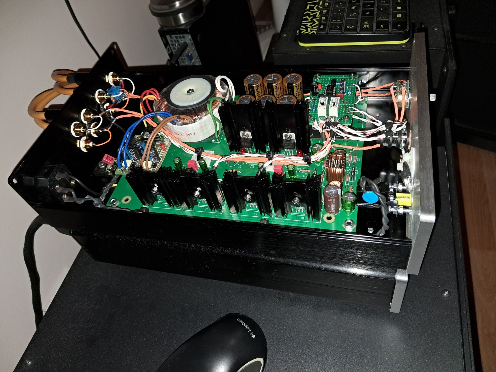

Here is my copy of the Whammy in action. Compared to the previous one, I have Toshiba 2SJ313/2SK2013 at the output, the opamp is Burson V7 Classic, the rest is more or less the same, including the box. Mute+DC protection are default. Power supply is +-15V (7815/7915 ACTG). Burson is stable, it does not need compensation. The same is true for the OPA2604 and NE5532. I haven't tried the others. I'd like to keep the Burson, but there will be a sound test with other opamps.

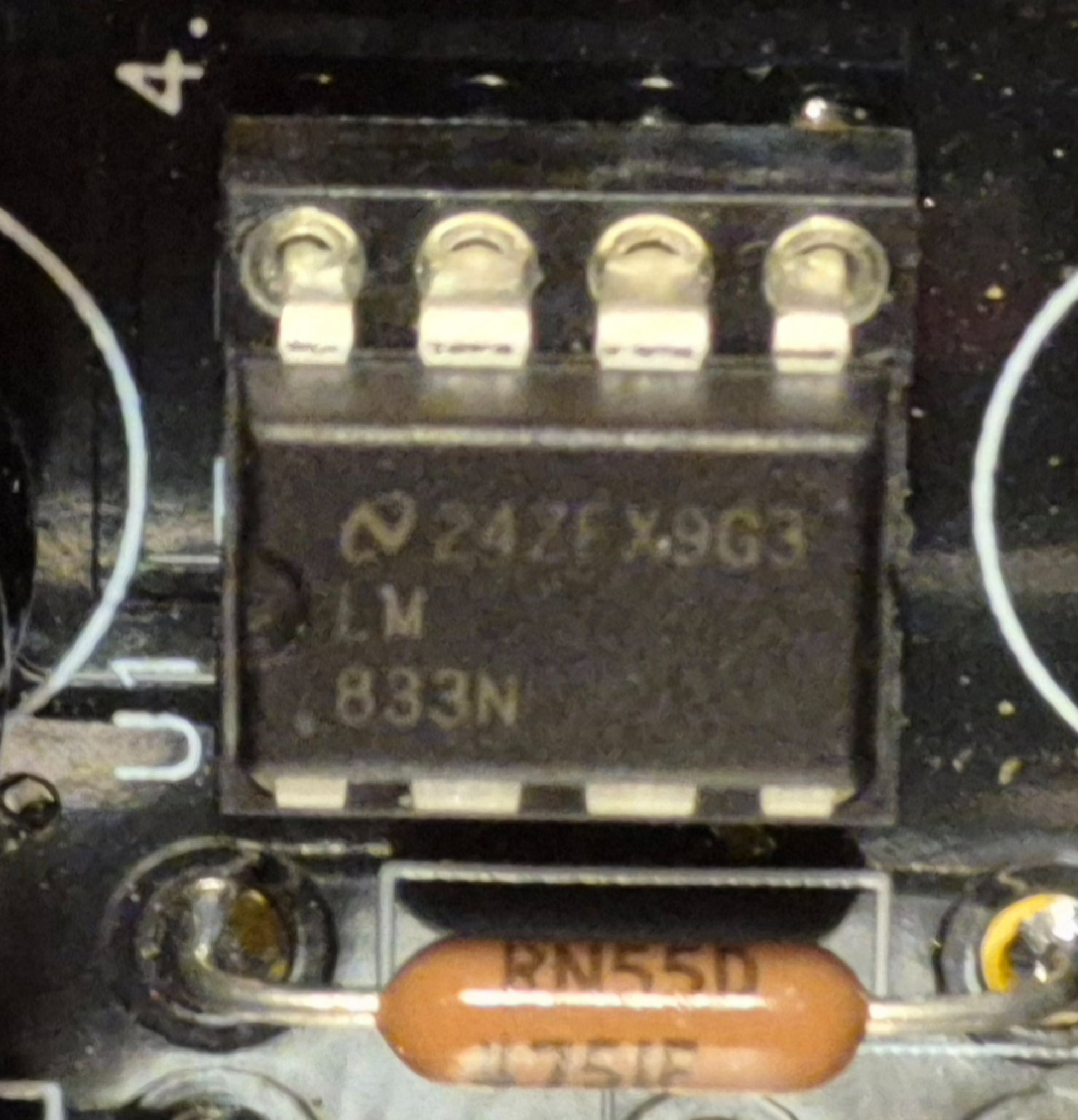

The LM833 was and still is an excellent device although bizarrely two quite different versions of it exist, the original with the complementary output stage and also a version with a quasi complementary stage.

Which version is this?

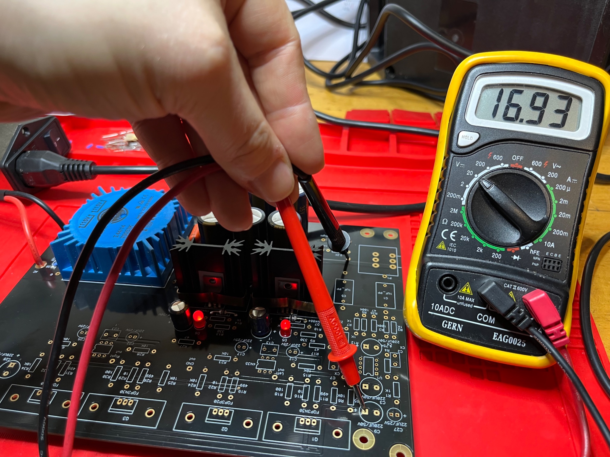

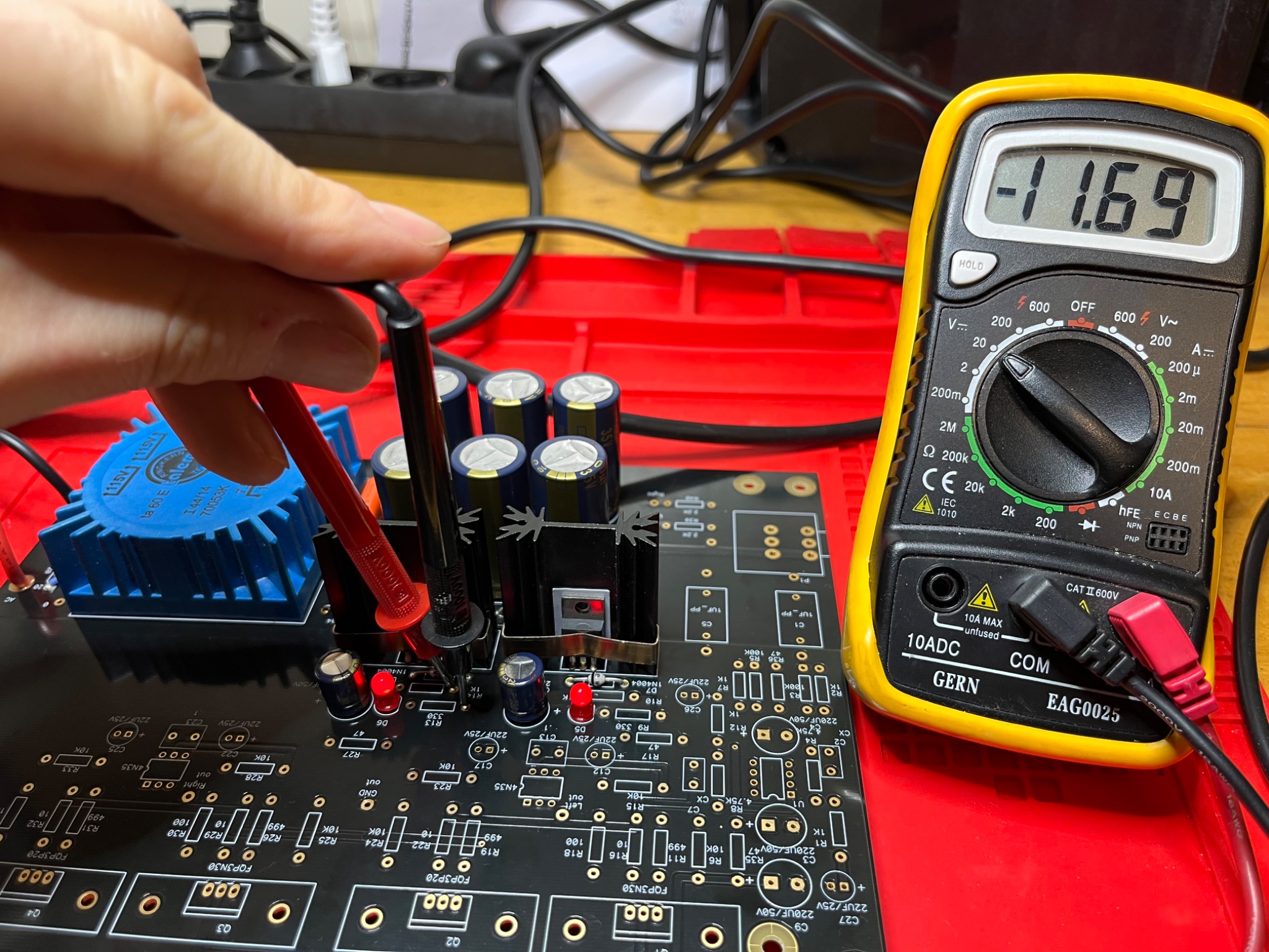

hi, I just started building the whammy and completed the PSU today. While taking the measurements I noticed that the negative rail is off by quite a margin, it’s -11,7V. The positive rail seems like expected.
Is this something I need to worry about? Any tips on how to continue troubleshooting?
