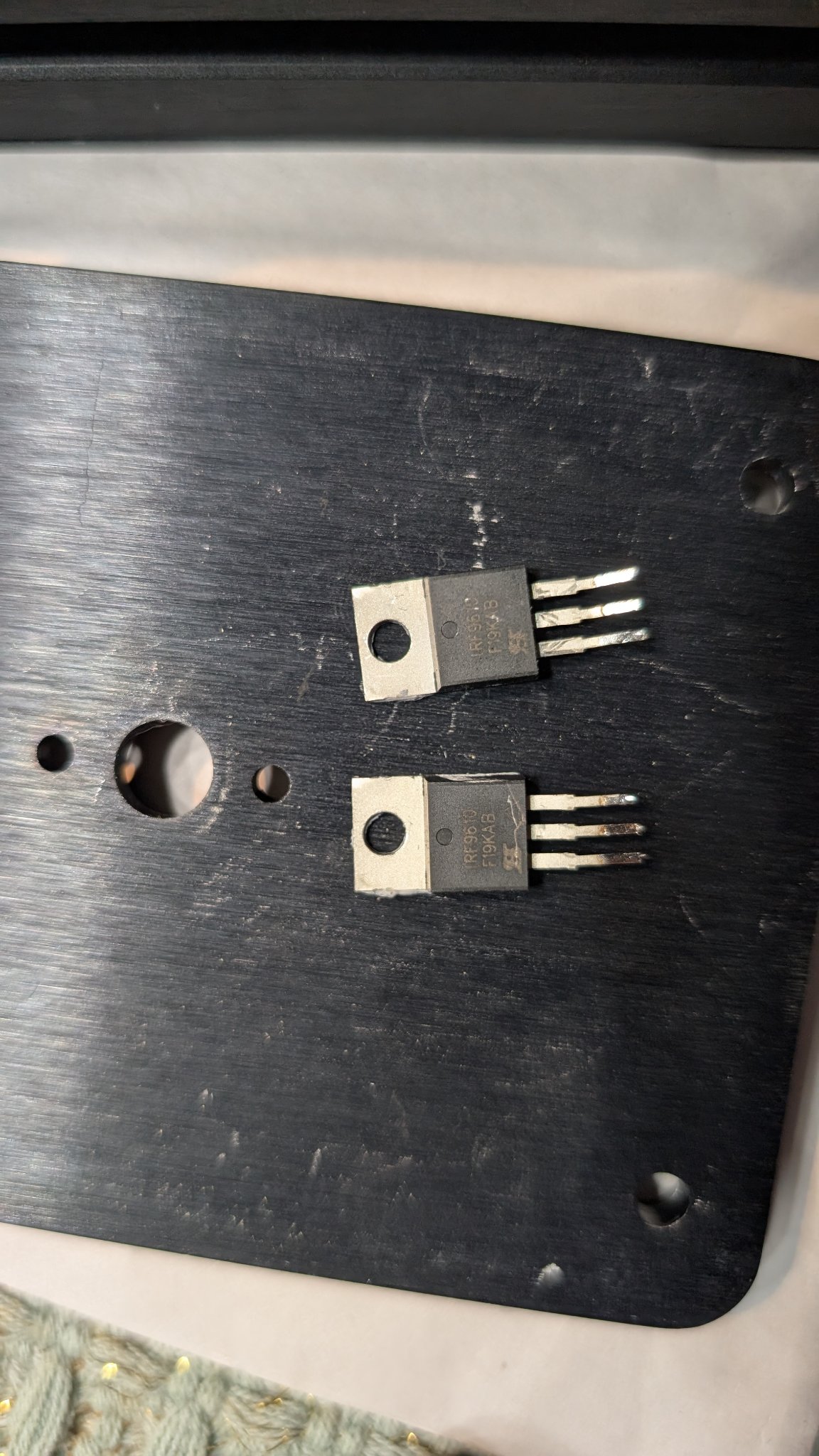

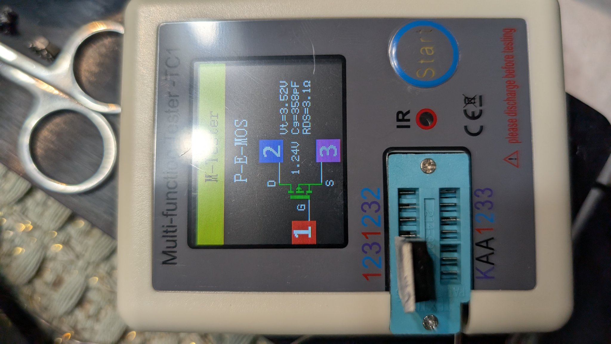

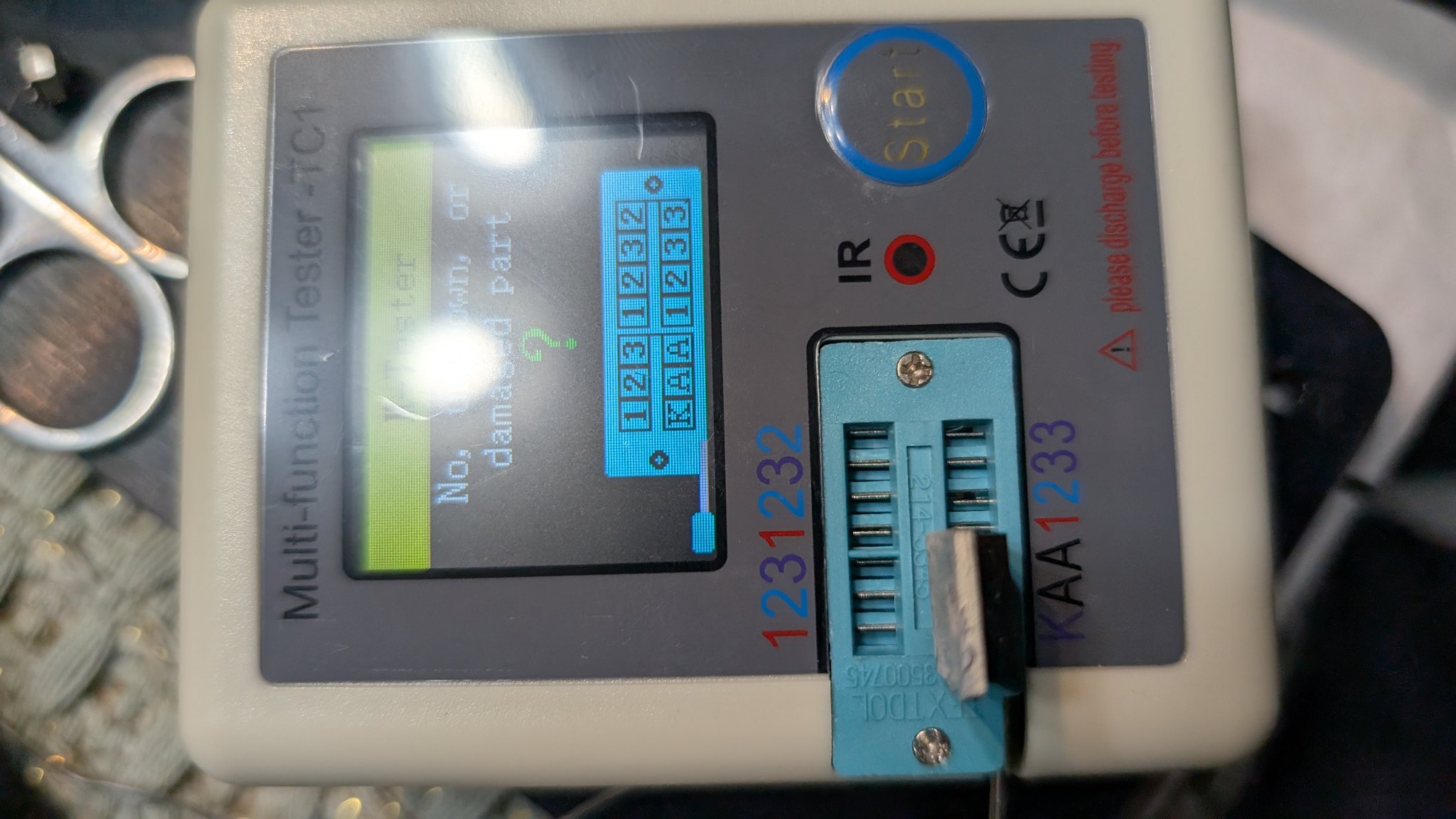

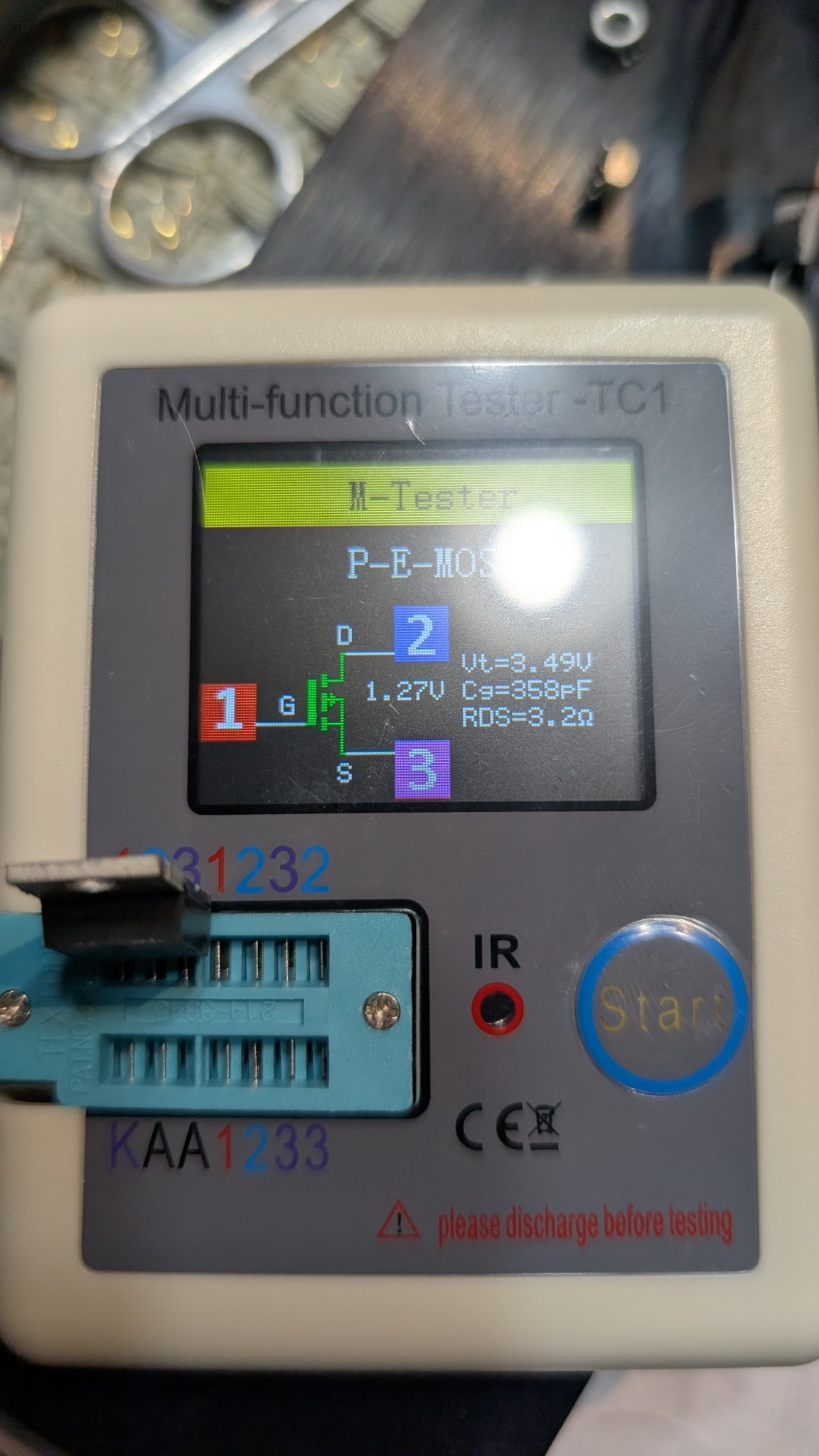

Hey! I'm back again and i desoldered the FQP3P20 (both of them) and here are the pictures from the tester. First picture should be the FQP3P20 closer to the op amps and the second is the one closer to the RCA@1nfinity, I just read through some of the previous posts as I didn't realize you had actually built this WHAMMY and had it running back in 2023. If that's the case, your problem isn't likely an ungrounded pot but can you confirm that you've had it running for 2 years with the 4N35 backwards?
Given the overheated resistors, I would suspect the FQP3P20 has potentially sustained some injury on the problematic channel. Do you have a (cheapie) component tester to check it with? You'll have to desolder it from the board to test it unfortunately.

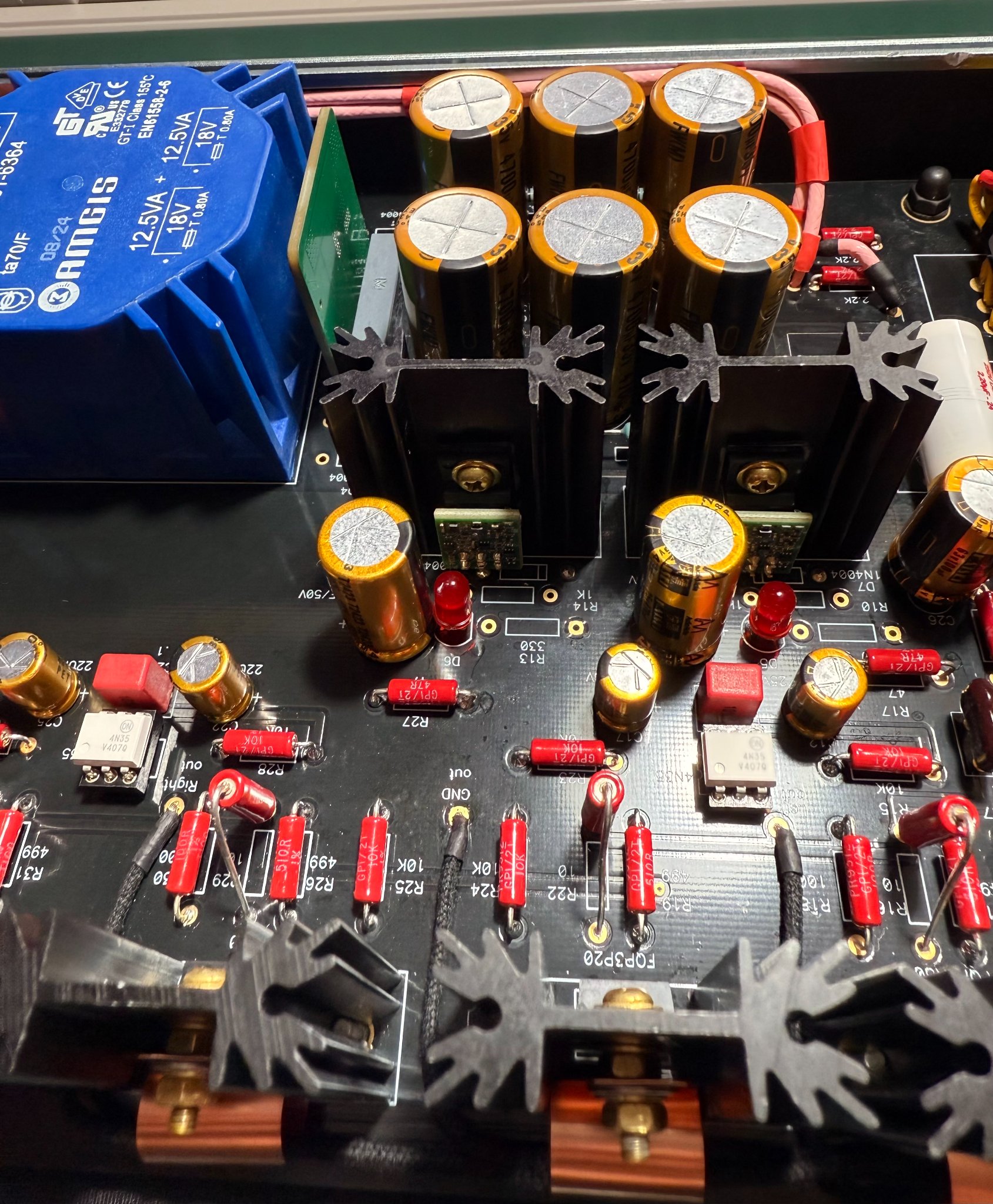

I tested using a multi meter 7815 says 0.85 and 7915 says .08 (hope I did that right, I feel dumb)7815 and 7915, middle of the PCB, near the red LEDs.
Meter to DC volts, black probe on ground, measure with red probe,
7815 pin 3 should be about 17V,
7915 pin 3 should read around -17V

They are Integrated Circuits, so the pins are IN, GND and OUT, and though IN and GND are different on the 7815 and the 7915, OUT is pin 3 on both. 🙂
Thanks for clearing this up, I'm learningThey are Integrated Circuits, so the pins are IN, GND and OUT, and though IN and GND are different on the 7815 and the 7915, OUT is pin 3 on both
7915 is -16.45 and 7815 is .25 (this one kept fluctuating and started from -.80 and went slowly up to .25)Turn it on, please.
I'll desolder it and order a new one along with FQP3P207815 is dead.

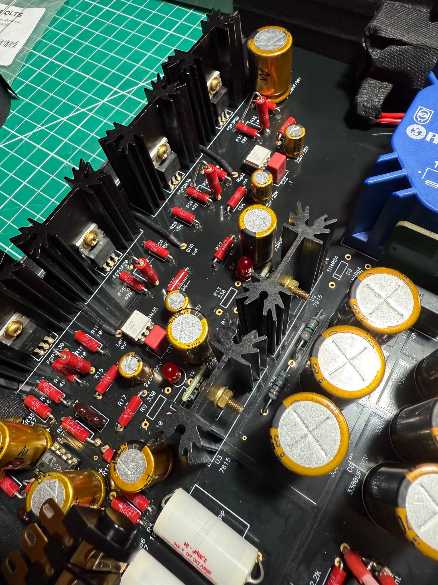

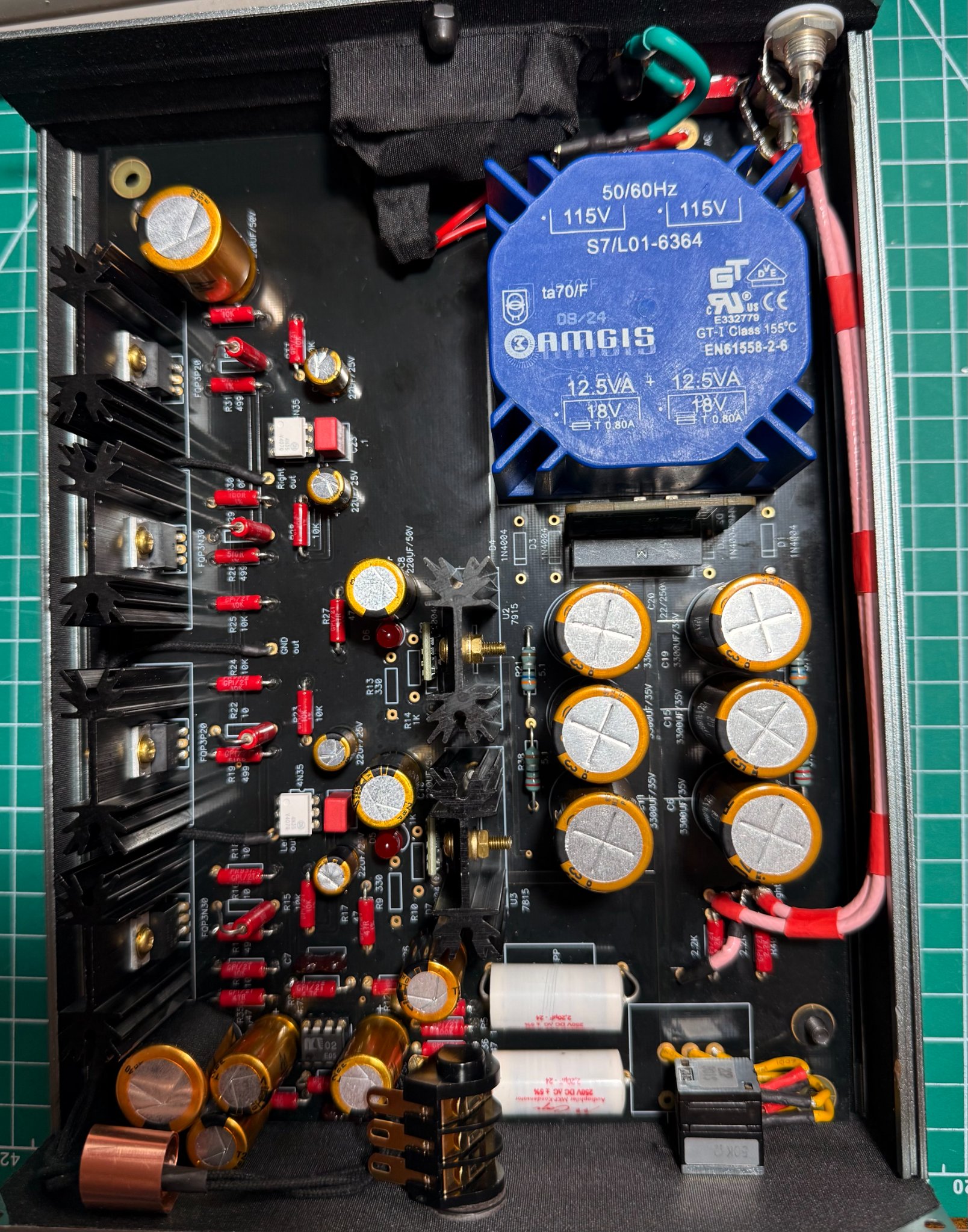

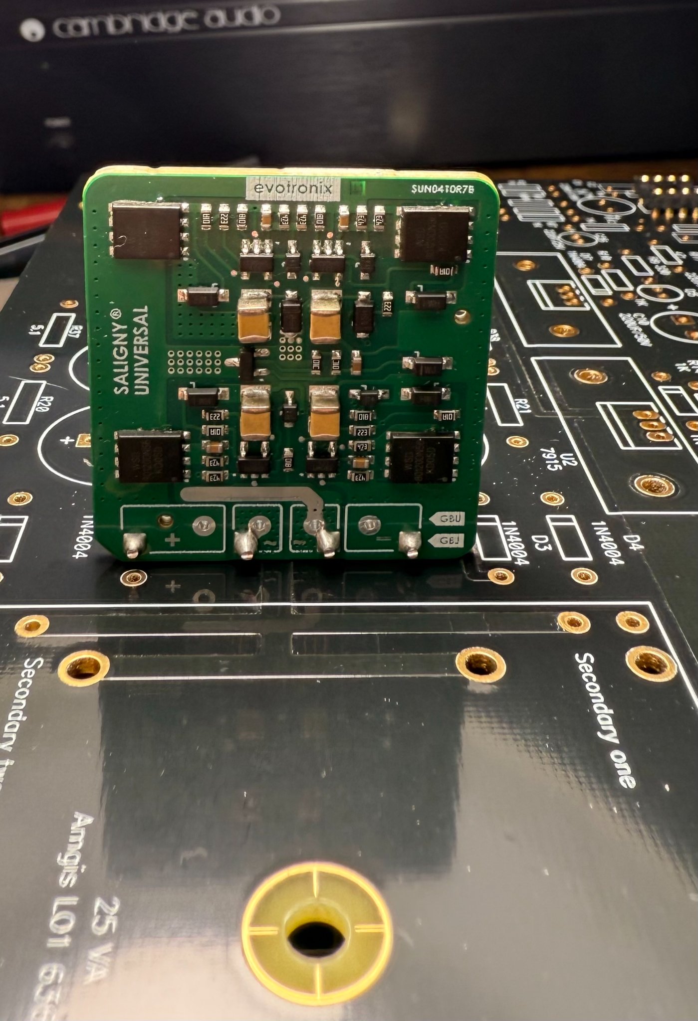

Another Whammy up and running ! I bought this used from eBay but desoldering a double sided board with ground planes wasn't worth the hassle, especially as the new boards are black and looking so good ! There were a number of things wrong with the board and the case, which I ought to have changed too - but that's a fresh build, so I had to keep something. So the enclosure is original and I'm not happy with it still, but everything inside in new.
I tested it with a 5532 and it was good but not exceptional - the plan was always to use the Muses 02. I put a 2134 in and it was definitely better, reinforcing what I'd heard with the Lehmann BCL, then the Muses 02 and it's certainly the best of the op amps I've tried so far, including the Burson V6 and V7. The bass is deep and strong, again much better than my Burson Soloist amplifier with the latest SP02 regulators and the V7 vivid op amps.
I've used an Evotronix Saligny universal rectifier rather than silicon diodes, just to try something new really. My scope isn't working right now so I can't measure the noise and I'm not sure I could go down that low anyway with my kit, it's just a shame it was appropriate to put it in with components facing the transformer due to the orientation of the pins, I'll consider swapping it round later.
Regulators are Sparkos discrete regulators, I didn't feel like using 7815/7915 again, been using those for years so tried something new. Sparkos don't recommend adjusting the ground the device sees and Id' already fitted Audio Note capacitors when I read their application note that suggests a specific Panasonic 100uF cap, I'll change it later and see if makes much difference, they appear to be running perfectly currently. The heatsink is reaching about 45C, just slightly higher than the mosfets.
The pot is a TKD 601 stepped dual log pot, thought I'd try something different from the Alps, working perfectly. The knob is an Aliexpress special that arrived pre-scratched, such is life !
Power caps are Nichicon 4700uF, all the other electrolytics are Audio Note Kaisei, the main rail caps are 1000uF 25V, I've got some Charcroft silver mica caps to go in, Wima bypass with a couple more on the back of the board. The resisters are PRP PR9372 half watt which is why they're a tight fit, the 10 ohm are 1 watt, probably unnecessarily, except the power supply resisters where I reused some Takman metal film I had.
The input cable is BICC silver plated OFC copper, output cable is Duelund CC08, solid copper with a cotton and oil insulator... sometimes it's nice to try something new 🙂
Just listening to Anne Bisson, Do what you Please, and the double bass in the background is perfectly defined and deep with her voice quite forward and the percussion, cymbals, still clear and sharp. This amp is pretty good ! Kraftwerk earlier with Computer Love and Robots remixes was really enjoyable. Even Joni Mitchell CD, Blue, sounds enjoyable which it isn't always on cheaper kit.
The photos are from the first trial fit in the case, so I still need to clean the board a final time and adjust the length pf the input cables, I'm also really unhappy with the IEC mains connector, I covered the inside of the case with heatproof cloth tape to match the black PCB and ot some over the IEC connecter until I can decide what to do. I'm not sure about the copper coil cable holder either.
