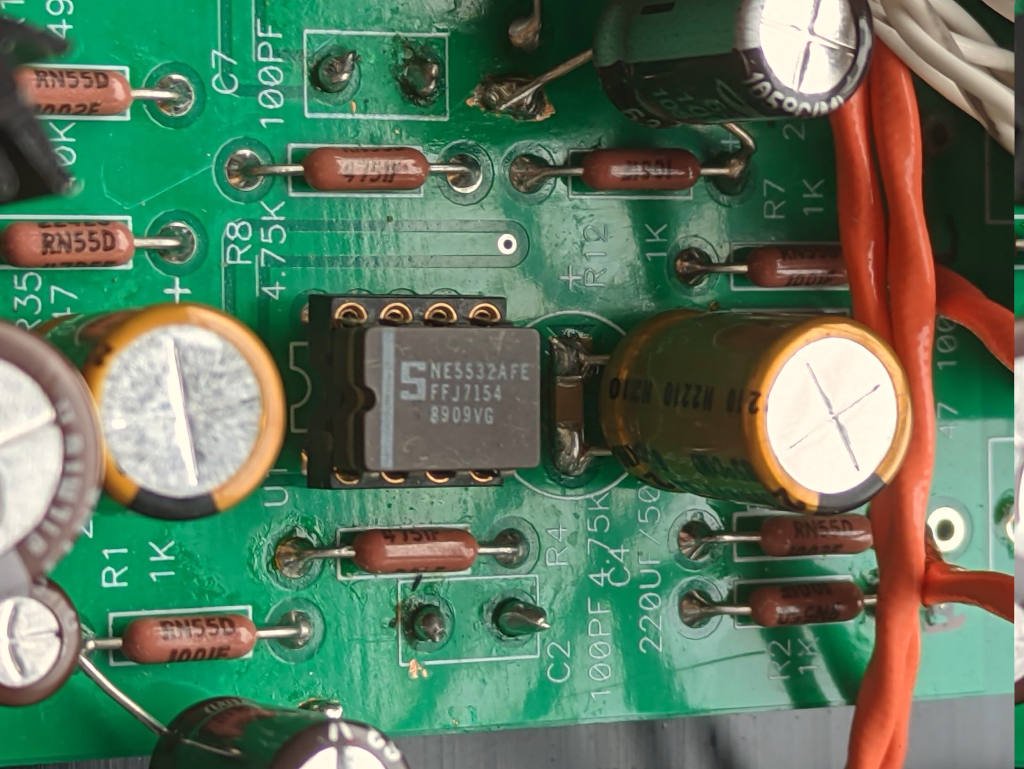

I've started assembling my copy of Whammy so I'm wondering about a few things.
Instead of C26/27 22uF 25V I will put a Nichicon MUSE 100uF 16V bipolar capacitors. For this I'm sure it's fine.
Can I use Nichicon MUSE 22uF 16V bipolar capacitors instead of C12/17/22/25 22uF 25V? Does this generally have any positive effect on the sound or not?
The supply voltage will be +-15V.
I’d recommend sticking with the version you assembled for me.😀 The chosen components were tested for optimal performance. While Nichicon MUSE bipolar capacitors are high quality, they may slightly alter the sound’s characteristics, and it’s uncertain whether the change would be beneficial. If you’re looking for a specific tonal adjustment, it might be better to experiment with op-amps or a handmade attenuator with Dale resistors instead.Does this generally have any positive effect on the sound or not?
I’m currently using the Signetics NE5532AFE.
