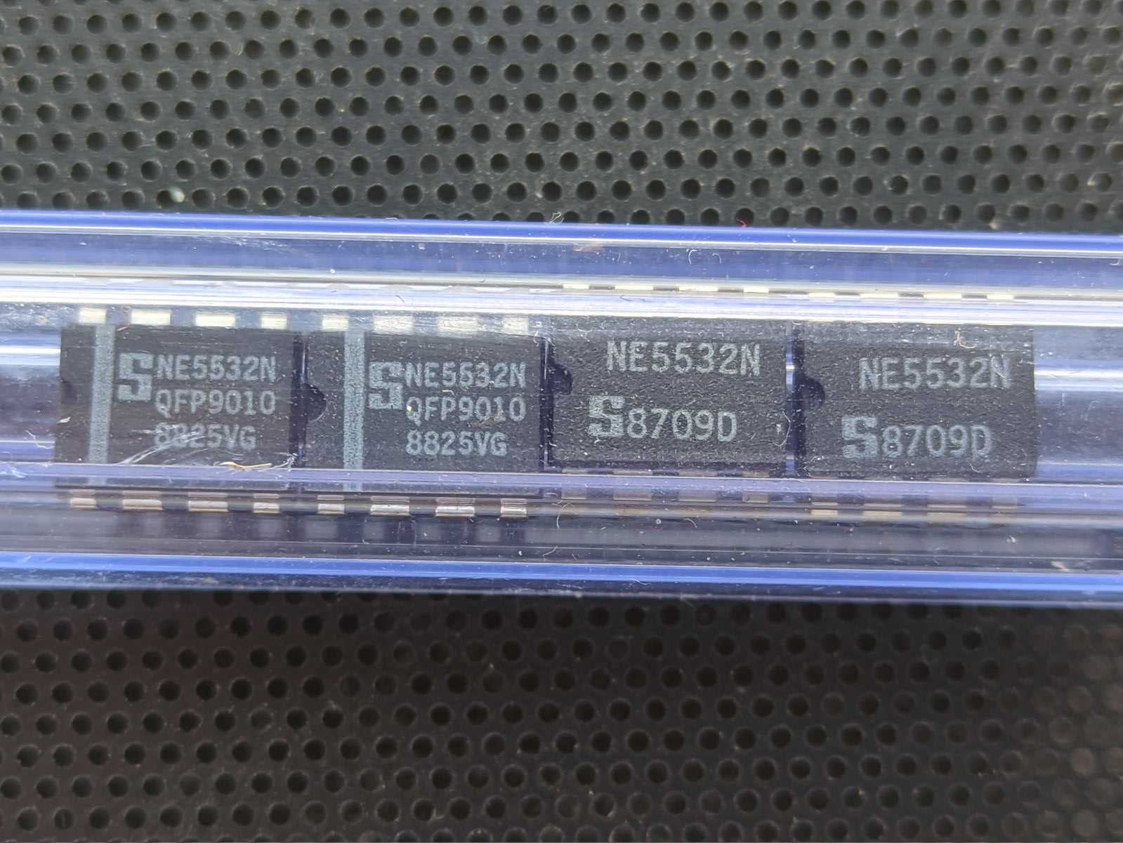

I replaced the Muses02 with Signetics NE5532 in the Whammy…
It is like voodoo magic and gives me butterflies in my gut.
DC Offset: Signetics without a line (series 8709D): -3.5 mV and -4.5 mV.
This specific op-amp was removed from an old Yamaha equalizer, where we also salvaged the PCM63P-Y.
