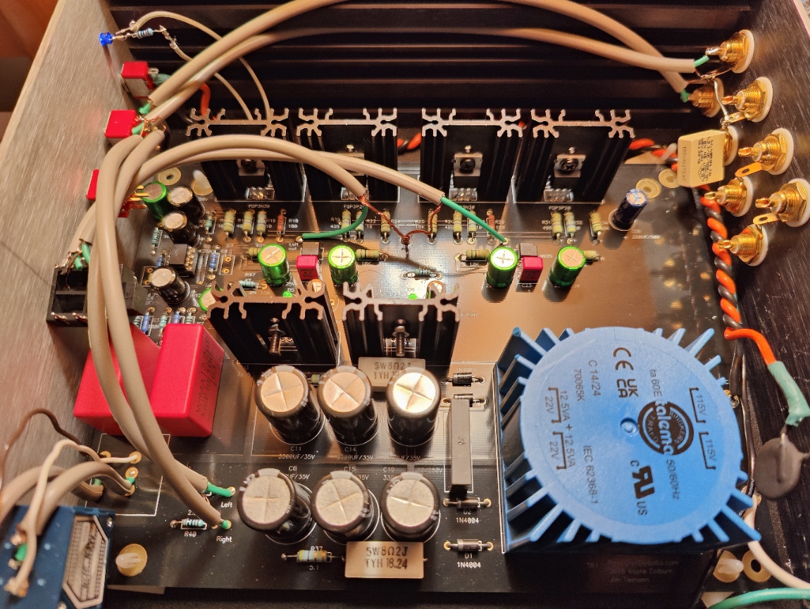

Here's the schematic with the values I used highlighted in red. Nothing too wacky, a couple values were chosen because they are convenient, but most were chosen because they keep the offset to within a couple millivolts while accounting for the NE5532's input bias current. Plus, I wanted a gain of exactly 4, again for convenience (I always set every preamp I build for 12dB of gain so I can swap them around and keep the gain structure constant). 47uF Nichicon bipolar Muse caps are very good to use for this circuit and push the -3dB point down to just a couple Hz. For the input caps, 2.2uF/100V WIMA MKP10s with the 27.5mm pitch fit perfectly and are probably as good as any Mundorf or Jantzen you can buy.
Note that I'm running the output devices at ~120mA. Not noted here is that I used IRF610 and IRF9610 FETs and green 3mm LED voltage refs for the regs to yield +/-17 V. And I put a 0.1uF poly cap across the positive and negative power pins of the op amp. One more tip: use a thermistor at the AC inlet, and consider larger resistors (10ish ohms) in the power supply. These will both save your transformer and regs a bit. As it is, I might add bigger resistors to the the PSU, as the regs still see +/-26ish raw volts and run HOT.

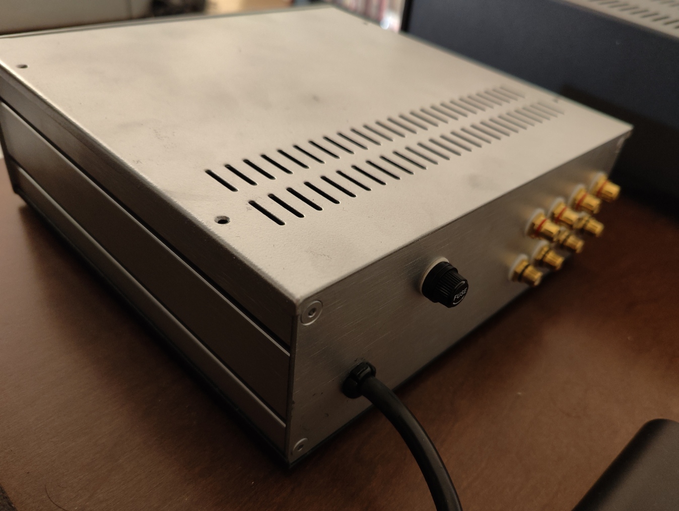

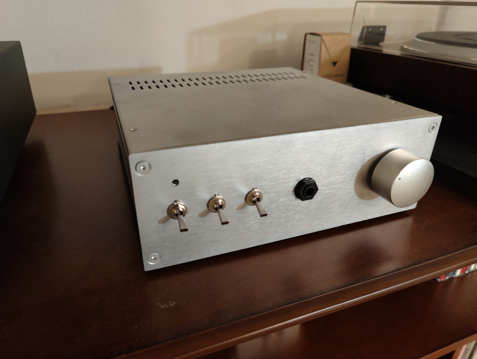

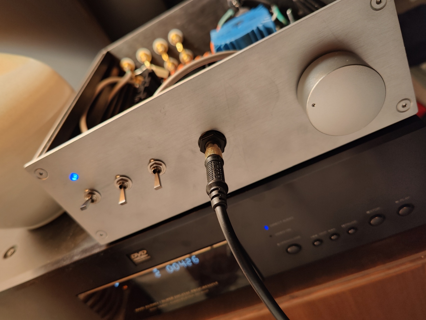

Made with a Modushop chassis, the same as the Whammy kit, but with the 3mm front plate. I realized that if you are OK with a captive cord and screw-in fuse compartment, you don't have to cut a weird-shaped hole for an IEC inlet. Joke's on me, I didn't have the right tools. Spent a lot of time with a metal file getting those holes right... Just buy the kit from the store.
I do have source switching capability and two line-level outputs, though neither is hooked up yet. The third switch, closest to the output jack, is an auxiliary so I can add a crossfeed or bass boost circuit later.

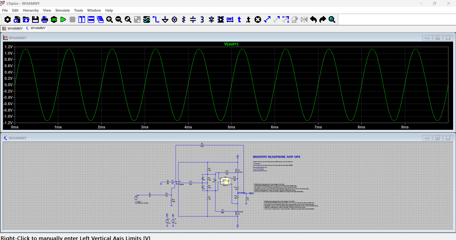

Here's how the LM833EN measured on my whammy:
Here at highest level just before clipping on 150Ohms load, 9.6Vrms = 614mW, harmonics are >100dB below fundamental.
ASR-style SINAD would probably fare a bit lower with 4Vrms output..Without my mods I expect it to measure roughly the same.
But I can tell you that this amp sounds miles better than a Topping A30 pro which measured much better, so SINAD is far from depicting the whole performance!

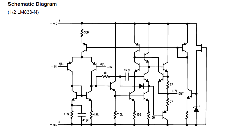

I wonder which version that one is, whether the original with NPN/PNP output stage or the later NPN quasi.Here's how the LM833EN measured on my whammy
Its super confusing which is which. This is what TI told me around 10 years ago.
LM833-N is an op-amp originally from National Semiconductor. NS named this device as LM833. As for the package, LM833N means a PDIP package LM833-N. NS calls PDIP package as “N” package.
TI developed another LM833 as 2nd source device and named it LM833. When TI made LM833, TI changed its output stage to NPN type from VPNP.
After TI acquired NS, TI renamed NS’s LM833 to LM833-N in order to differentiate the LM833-N from TI’s LM833. Please don’t be confused by LM833-N and LM833N.

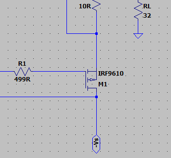

It lists r15,r23,r28,r33 as 5Kohm instead of the 10kohm in the original schematic. It also lists r16,r22,r29,r32 as 1 ohm instead of 10 ohms in the original. My mosfets get super hot very quickly, I have only let it run for 30 seconds.

I'm no expert but 1Ohm output resistor seems suspiciously low. The output Bias current is directly determined by this resistor value as the voltage across it is determined by the Optocoupler's LED.
I would think that it's a typo, and start with 10Ohms instead of 1Ohm as in original BOM.
