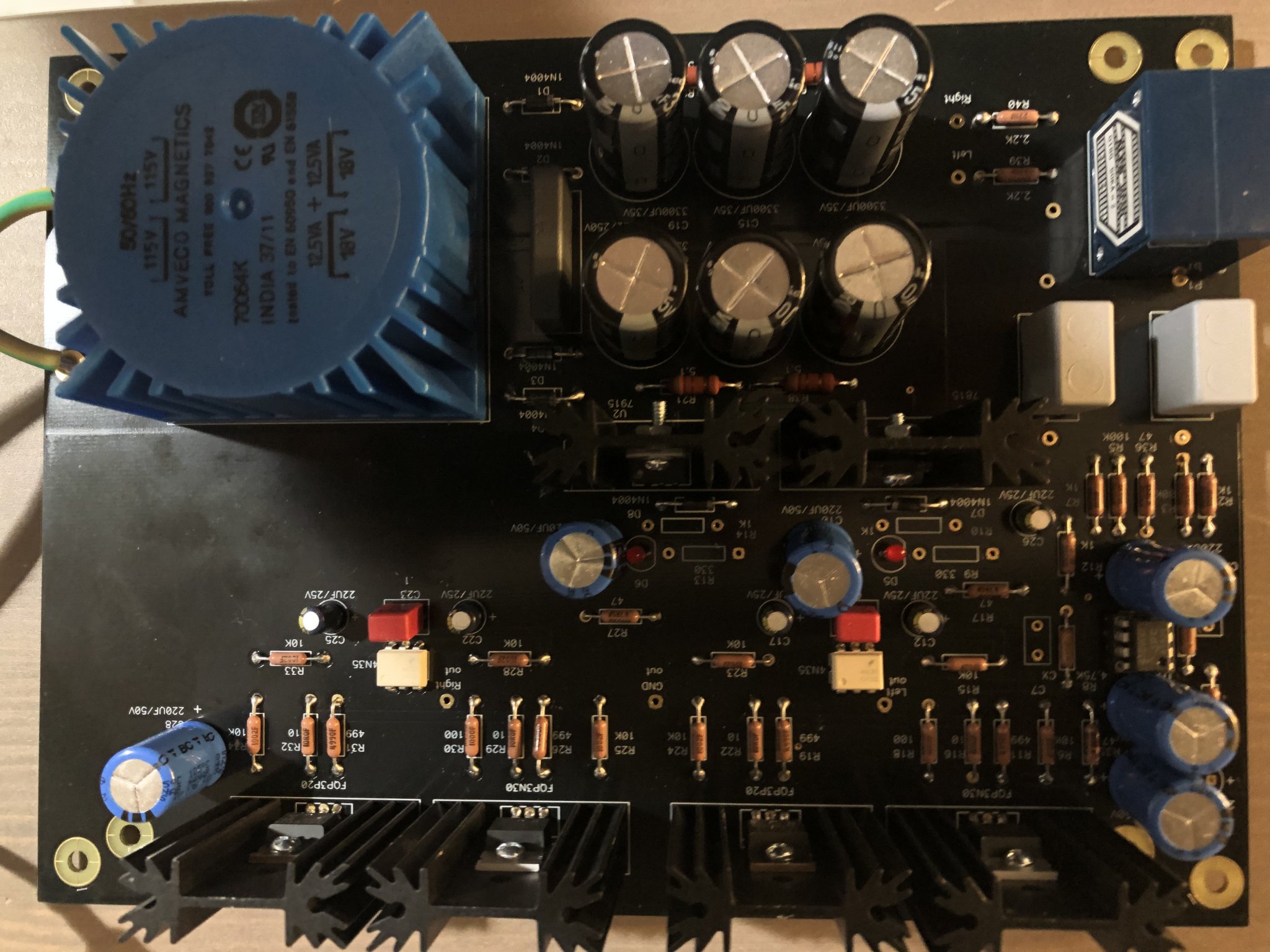

Hi -- I've followed your issue with the whammy build & I have a similar situation -- except I'm not as adept as most with DIY & have an issue trying to troubleshoot.
I've gone through this twice -- with the same results ( two identical boards -- and two identical parts kits) -- when the first issue happened - I decided to get a new board rather that trying to remove all the components, although I salvaged the volume pot - & I took extra care with the soldering and board layout the 2nd time around ( which is why I'm so baffled at having the same issue again).
I've checked all my solder points with a DMM and confirmed there are no shorts anywhere - I've measured all the resistors on the board after they were installed to ensure they where labeled and installed properly & they all measure as they should with the exception of all the 10K resistors ( all of the DALE 1002F resistors only measure roughly 8.4K not 10K as spec'd ) - I've used the LED version for the power supply & both times - voltage checked out fine with the DMM before I began to stuff the board according to the guide
I've confirmed that the regulators & MOSFET pcs are in the correct pair orientation -- all diode and capacitor polarities are correct. I'm at a bit of a loss for the 2nd time around & I'm curious if you were able to determine what the most probable cause was of the extreme heat on the power supply 5.1 ohm resistors -- as I really would like to avoid starting all over again with a new board.
Do you think the 10K resistors might be an issue at only reading 8.5k ? --------- How can I properly trouble shoot this with a DMM without powering it on ? & is there a guide somewhere that tells me what readings I should be seeing on the various areas of the board to isolate the issue --------- as I'd like to salvage the project this time around.
Any guidance you can suggest would be greatly appreciated ------ the guide on the website is a few years old -- the board and the kit are the newest versions -- Is there anything that the guide overlooked relative to the new board and parts kit --- everything seemed fairly straight forward ( other than the confusion around missing bolts for the mosfets & the 25 v vs 50 v issue with the 220 uF caps - so I'm miffed at why I have the same overheating issue twice - with new parts. -- is this strictly related to the MOSFET's possibly not operation as they should ( I've confirmed there are no shorts on any of the mosfet pins)
I've attached a shot of the board in case I've overlooked something that's obvious to others
thanks a lot and seasons greetings -- ( My partner thinks I should be doing something other than this on Christmas day -- So I don't assume too many are reading this today )
Bart
Sorry, ignore my help request --- I re-read the initial instructions & re-checked the MOSFET's & I do in fact have them in the wrong spots ( on both boards - reversed 610 vs 9610 ) -- I'm not sure this will fix my problem - but I've removed the heat sinks & MOSFETS -- I'm going to order new regulators - as I had to put a lot of heat and stress on these taking them out -- I'd rather not risk re-using them. I'm hoping this is the issue. -- But I'm still puzzled by the 8.5 k ohm reading on all the 10 k resistors..

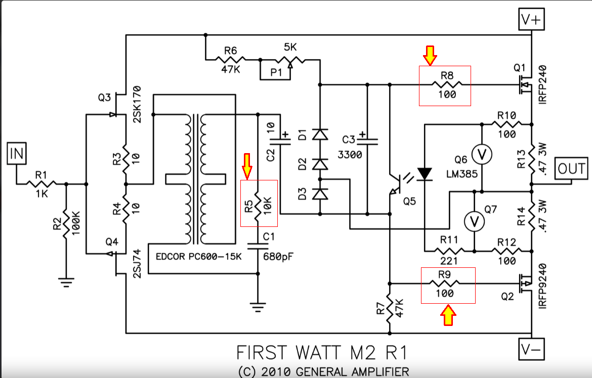

You can never trust ohmmeter reading of resistors in circuit, as there are other components that are invariably in parallel with them. I'm pretty certain this isn't your problem. If concerned, lift one end and measure.
I recommend caution here; in my own experience, bold statements & claims which include "never" and/or "invariably" are usually mistaken, and counterexamples are usually available and well known.
For example, Nelson Pass generously donated the schematic of his now-discontinued First Watt M2 amplifiier product, that retailed for USD 3000:
https://www.diyaudio.com/community/threads/official-m2-schematic.281520/
Examining Nelson's schematic, from a real-life + real-world amplifier: We immediately find three resistors whose only DC current path from one terminal to the other, is the resistor itself. An ohmmeter connected to the two resistor terminals, injects a DC current "I" into the network. This current flows in the resistor and nowhere else. So the meter's measured voltage "V" = "I" * Resistance, which is exactly as the ohmmeter designers assumed, and the ohmmeter's output display ( "V" / "I" ) is correct.
In other words, here are there counterexample when you can sometimes trust ohmmeter reading of resistors in circuit; sometimes there are no other components in parallel with a resistor-under-test. Not always, of course. But not never either.
