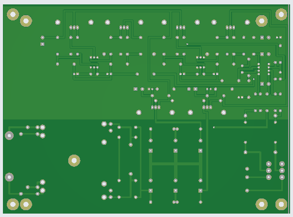

As I'm in the UK I'm trying to find a link to the Gerber files , so I can make this without paying ridiculous import fees from customs. can anybody help please
Here is the link for the gerbers:
https://www.diyaudio.com/community/...adphone-amp-now-available.271662/post-5025571
But this version is missing the resistors on the input.

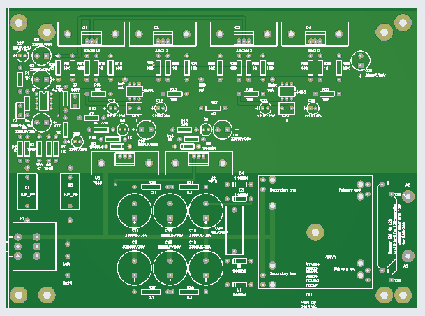

No "official" Gerbers are available to the best of my knowledge (for what should be obvious reasons). However, there are quite a number of people that have created their own versions of the WHAMMY board layouts. They may even be created from the same schematic. Perhaps one of them will reach out to you. Alternatively... someone may be willing to ship you a board as a "gift", but that's up to you, your conscience, and your customs agent. 🙂
Edited to add - See, someone already beat me to it.
Here you can find an alternative version with gerbers:
https://theslowdiyer.wordpress.com/2017/10/24/project-files-passhp-headphone-amp/
Thanks really appreciate your help. I have gone for the split design.. couldn't get the original wayne file gerber to detect the outline..Here you can find an alternative version with gerbers:
There is a correction for the drill file in this post:
https://www.diyaudio.com/community/...adphone-amp-now-available.271662/post-5028774
If I use this one no problem with the outline.
By the way there was also a nice SMD version:
https://www.diyaudio.com/community/threads/whammy-pass-diy-headphone-amp-guide.317803/post-6630881

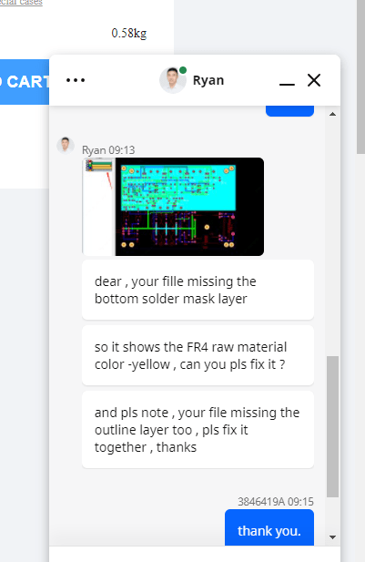

Im still looking for the working gerber, as the files on here arnt complete, have a missing outline.. thanks
The yellow is an error, just talking to JLCpcb , they are saying bottom solder mask is missing

Is there nobody else to help mrfunk on this topic?
Maybe the outline could be created manually? I tried this by modifying the outline from B1 gerbers, see attachment. The coordiantes would maybe still need some fine tuning by a few mils.
For the bottom soldermask I just made a copy of the top mask. Then I renamed all files according to the guide of JLCPCB.
https://support.jlcpcb.com/article/29-suggested-naming-patterns
This is looking better now in the gerber of viewer JLCPCB but I am not sure if this is ok to produce the boards.🤔

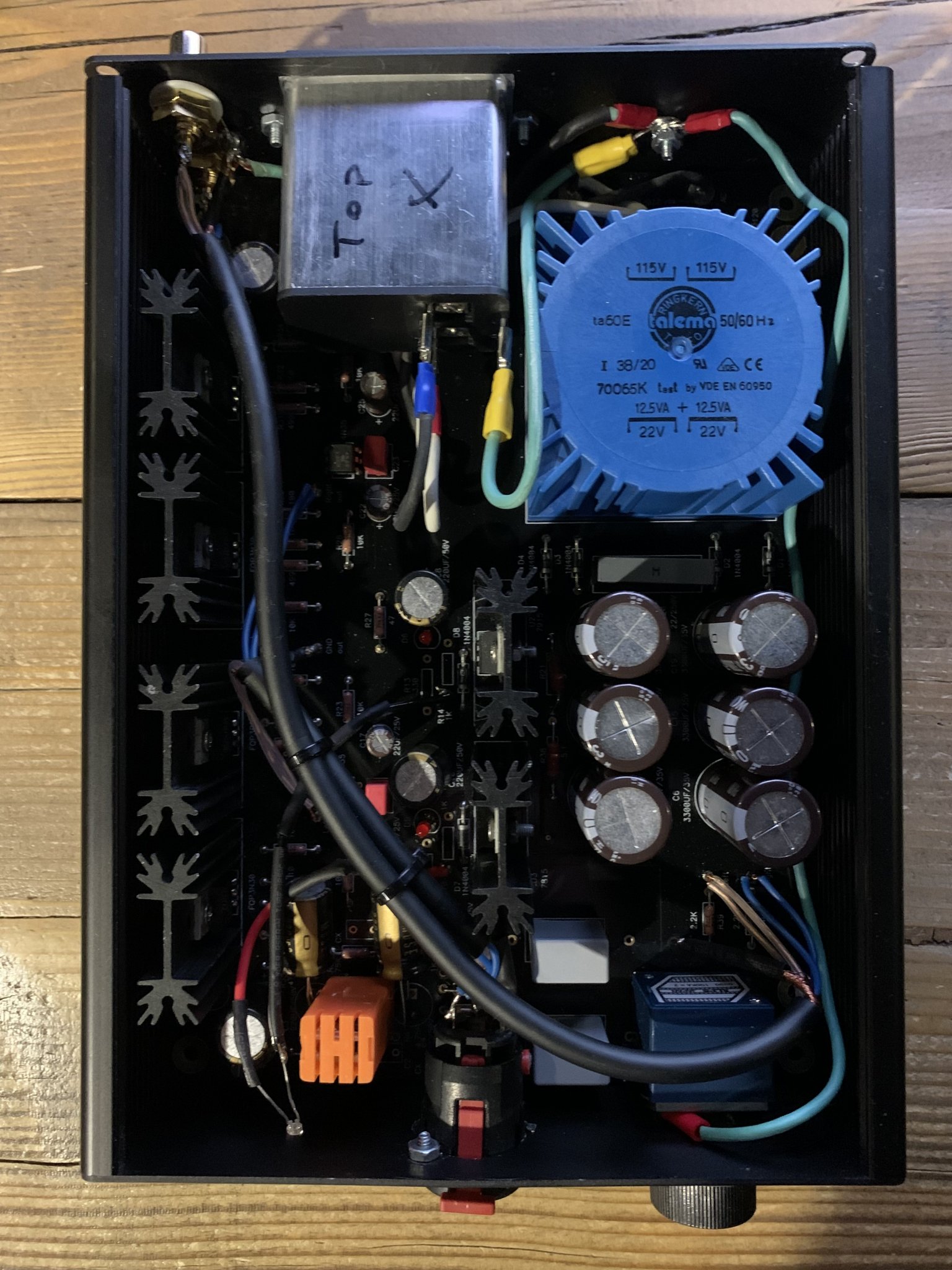

Hello guys,
I'm back here because of a big transformer problem.
After 4 months of beautiful work of my Whammy, now it seams completely dead.
My blue led is not working and D5 + D6 red led are both off.
I checked current on the main cable, checked the fuse and the Schaffner power inlet but current is there.
My transformer is a Talema ta50E 70065K 22V + 22
The only thing I did yesterday morning was to listen about 3 hours of music, I kept the Whammy on for lunch and when I come back for some more listening, after 1 ore of music it was completely gone, I mean dead.
I don't know what to do in terms of checking and measurements, my idea is that the transformer is friend but I'm not scientifically sure.
Could you guys help me on this in order to be sure that the problem is with transformer?
I have warranty for that so if the Talema is defective I will ask for a new one. BTW attached a pic, but
I can't see any signs of burn here.
Thanks in advance for your time and your patience.
