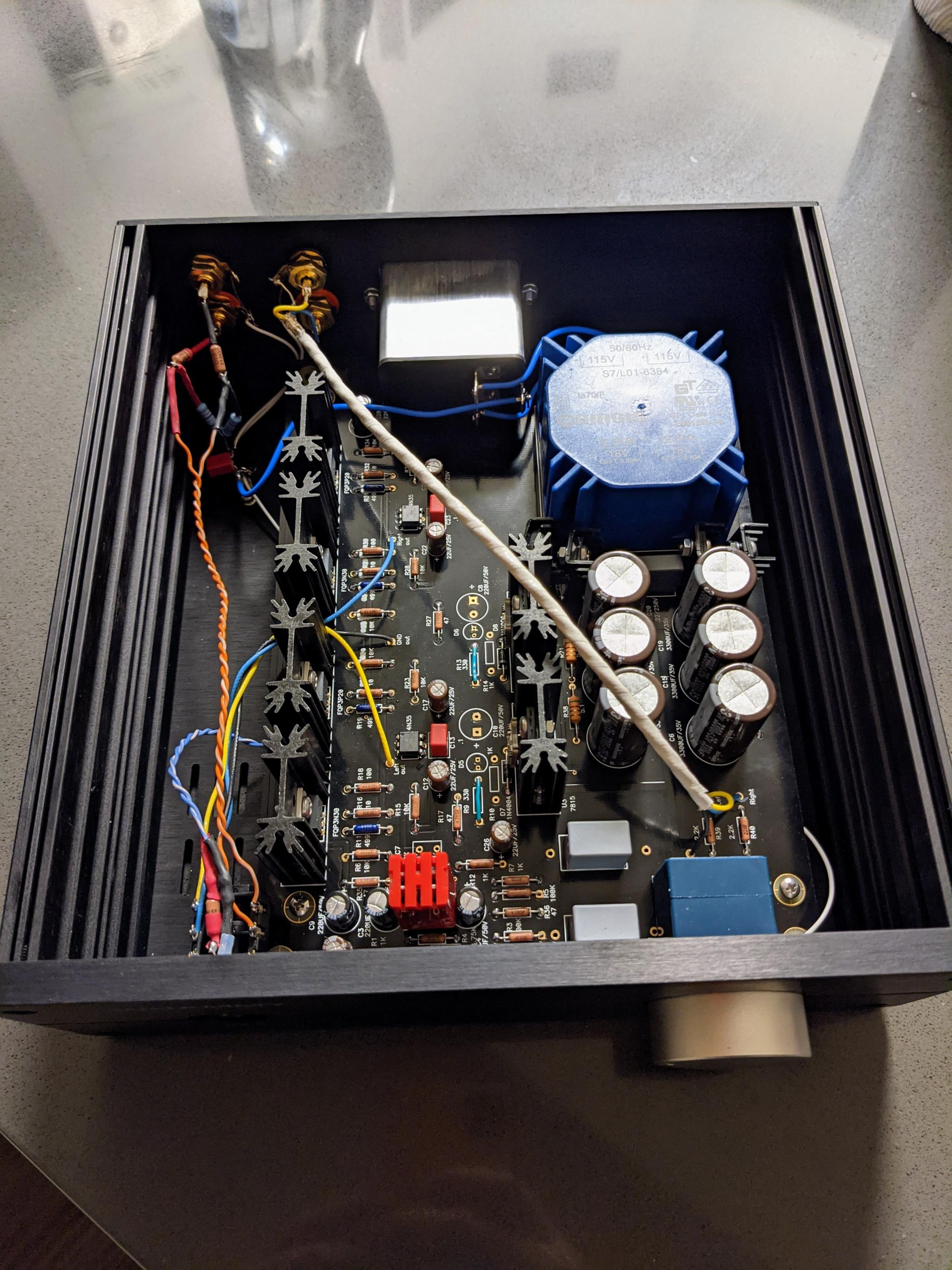

Here's an image of how I wired mine up to the Neutrik switching output jack. It's not a great image, nor am I the most tidy, but may give you an idea.

Are you using the complete kit? Does the output jack you're using have 6 solder lugs (3 on each side like in my picture)? If it does, it's a switched jack and you'll need to wire it a specific way for it to work. I believe Neutrik uses the same wiring scheme for all of their models, which would mean having the the output wired on the left, and pre-out on the right with the solder lugs facing up like in my photo.
Double check the wiring from your input and to your output, and make sure your opamp is installed correctly -- pin 1 & 8, or the dot on the opamp, should be facing to your left if you orient your board the same as my picture.

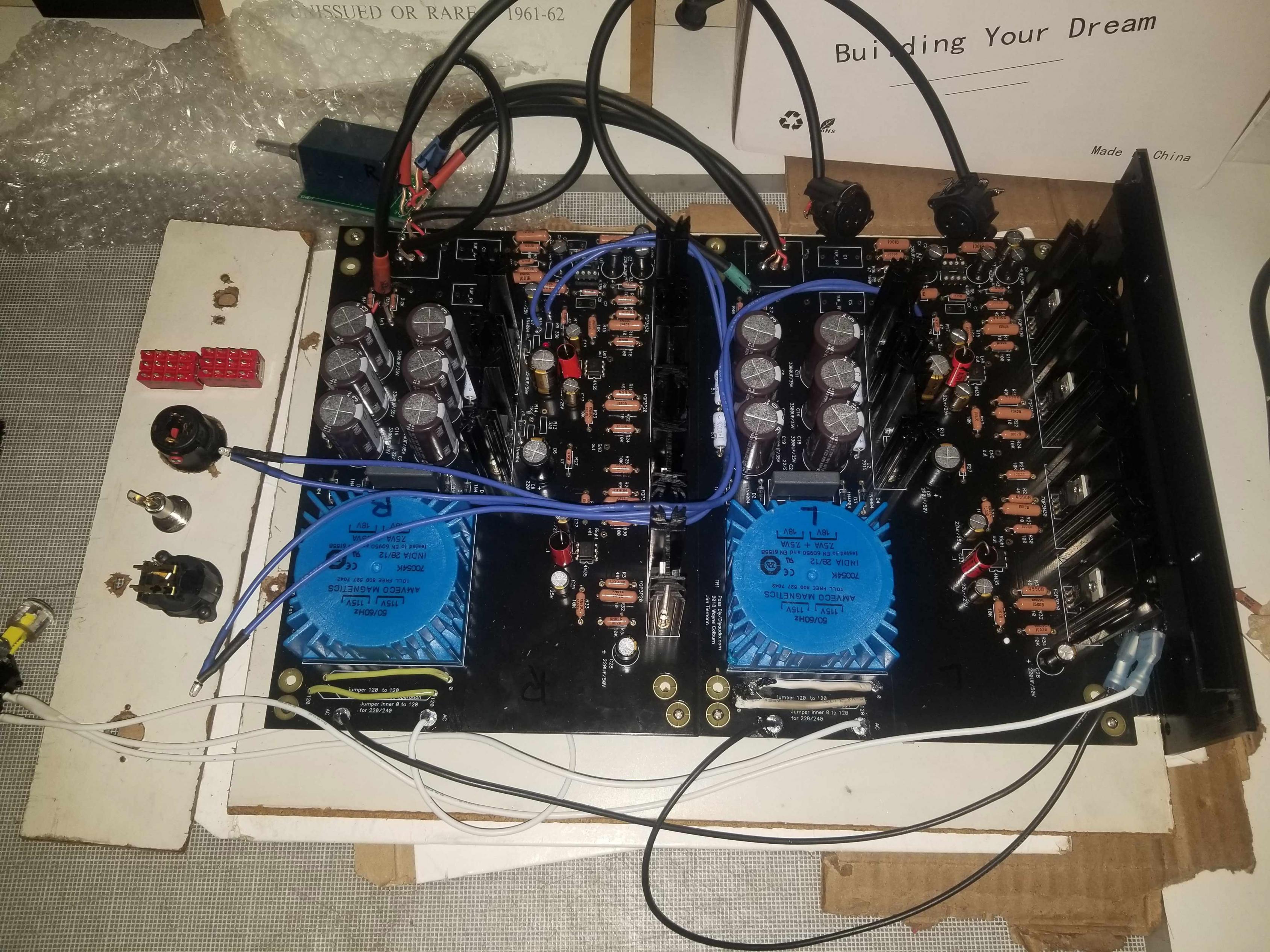

Progress on my balanced Whammy
Here is the progress on my Balanced Whammy.
Decided to try this just for the fun of it.
Have some optimistic plans for the build based on ideas from this thread.
Khadas DAC
Muses Volume
OLED display
The case is tighter than I expected so will have to see.
Anyway, hope to test for sound this weekend.
Any comments and suggestions are welcome.

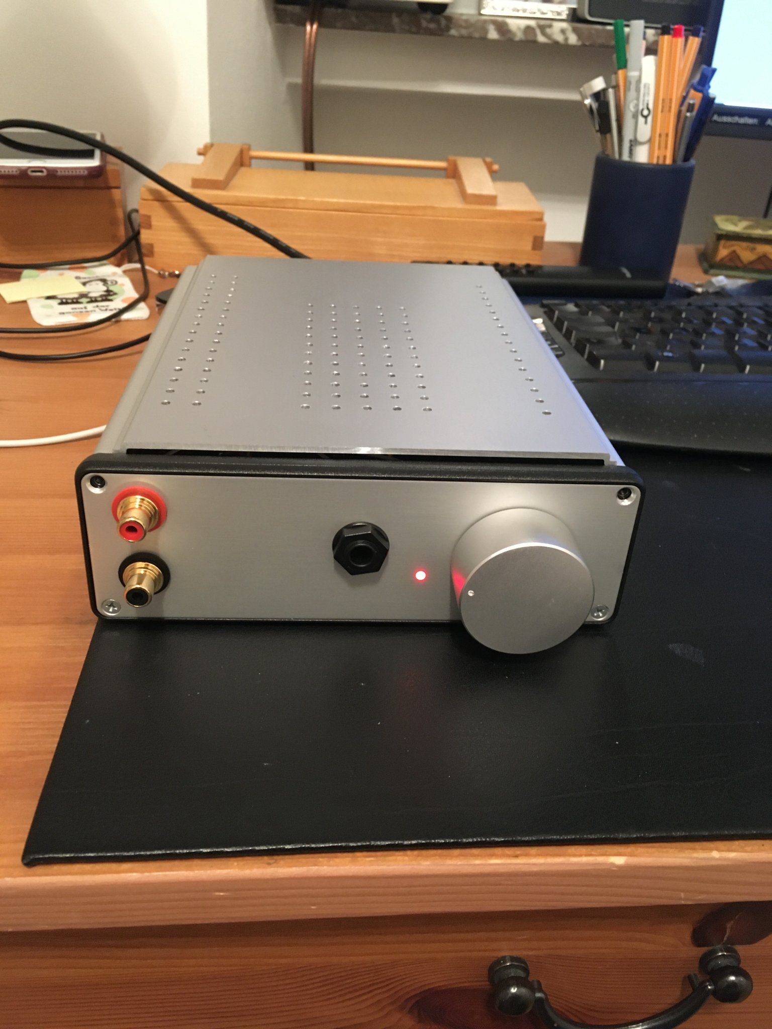

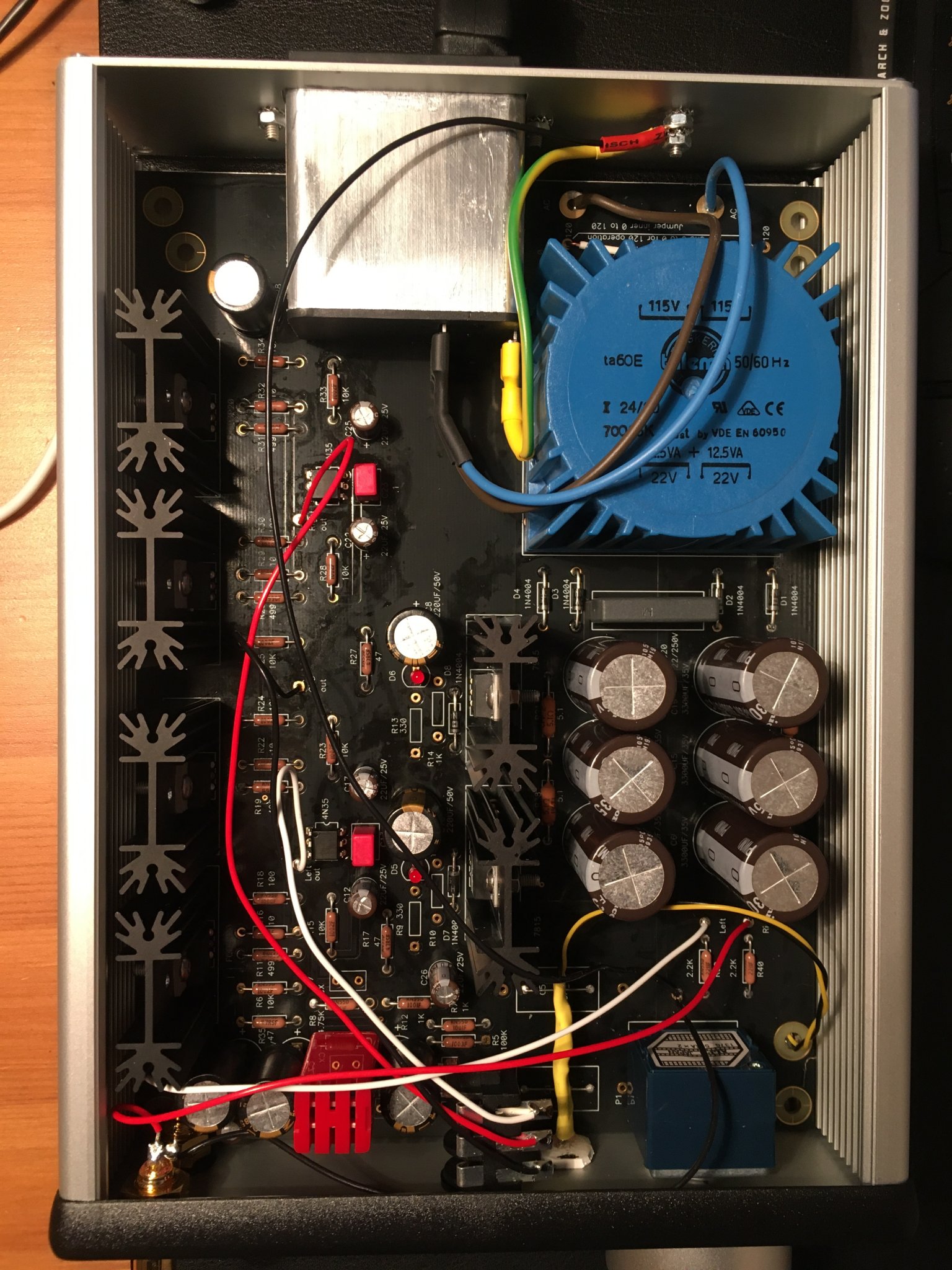

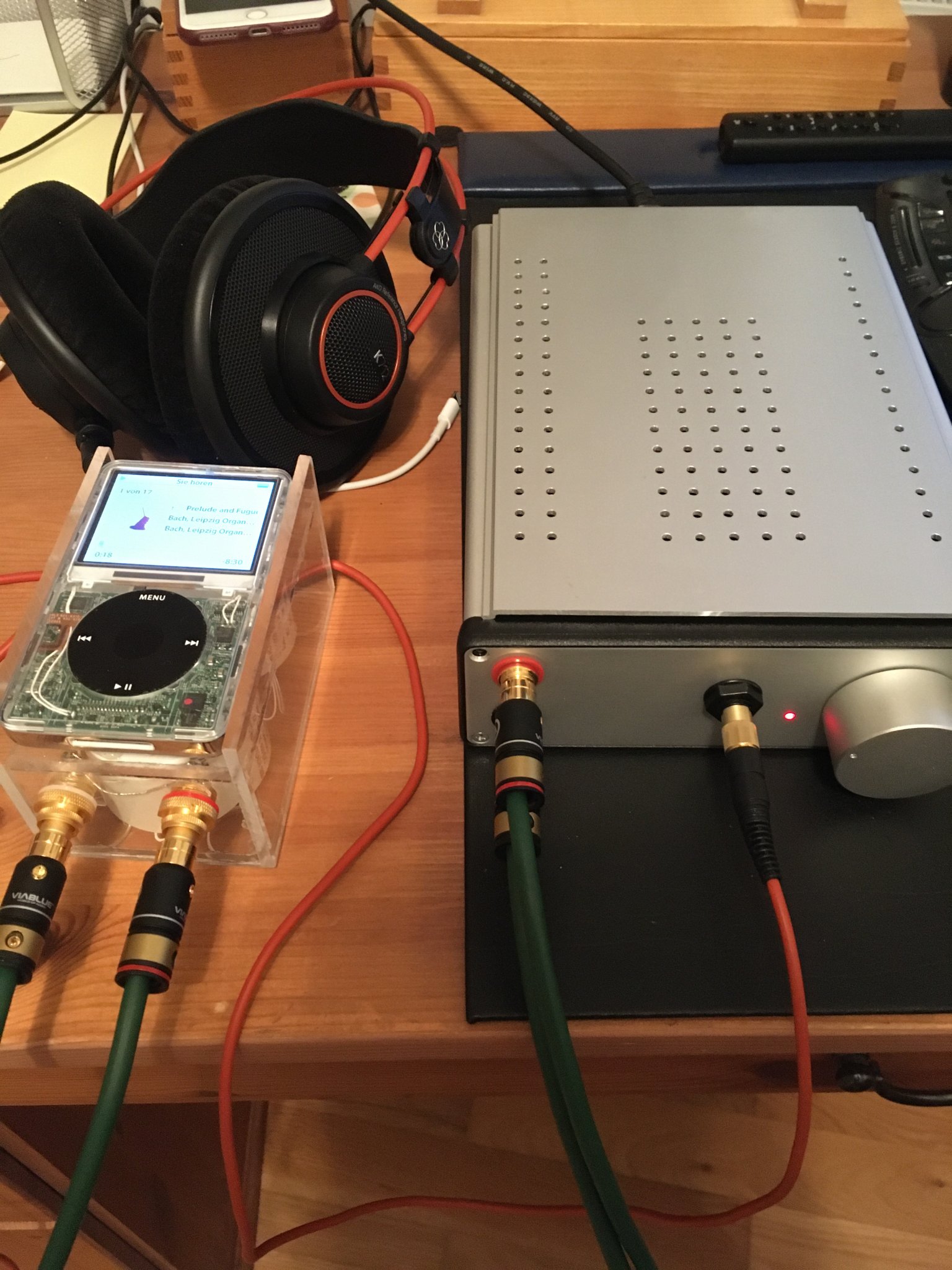

I just finished my second whammy-build and would like to share the result and some ideas. The 22 V transformer outputs around 30 V. The spec for the regulators is max. 35 V. So it is within limits. But next time I would consider the 18 V transformer even with the LED reference PSU because in my build, the regulators get quite hot. 60 C /140 F. That‘s okay, but just not necessary. The Burson Vivid sees +/- 15.6 V (measured) which is just perfect. It gets slightly warm: 40 C / 100 F. Perfect temperature for an electronic component. Current to the vivid is 2x 11 mA.
I used a 50 K log POT which has higher resolution in the low-volume-range. So if there is no specific reason to use 100 K, I would rather recommend 50. This provides enough input impedance for most applications.
I also tried the MUSES 8920 opamp. Also very good sound, but personally I prefere the VIVID.
The feeder is a modified IPod 5.5. I removed the internal SMD decoupling-cap and connected the DAC-out to the whammy via two Mundorf evo-oil 22 uF-caps. Nothing else is in the signal-path. The sound-files on the iPod are ALAC and stored on a 512 GB sdxc-card. I replaced the original harddrive by the card.
The whammy sounds great and I am very happy 🙂
