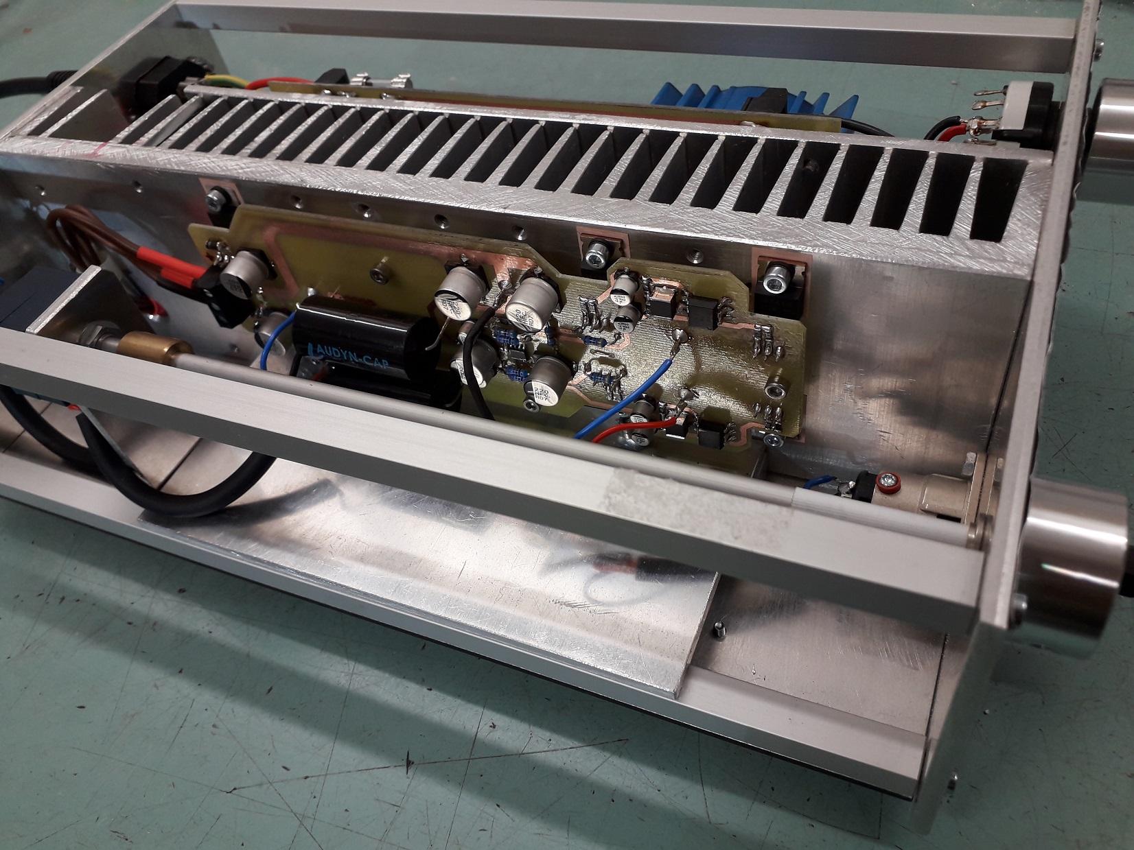

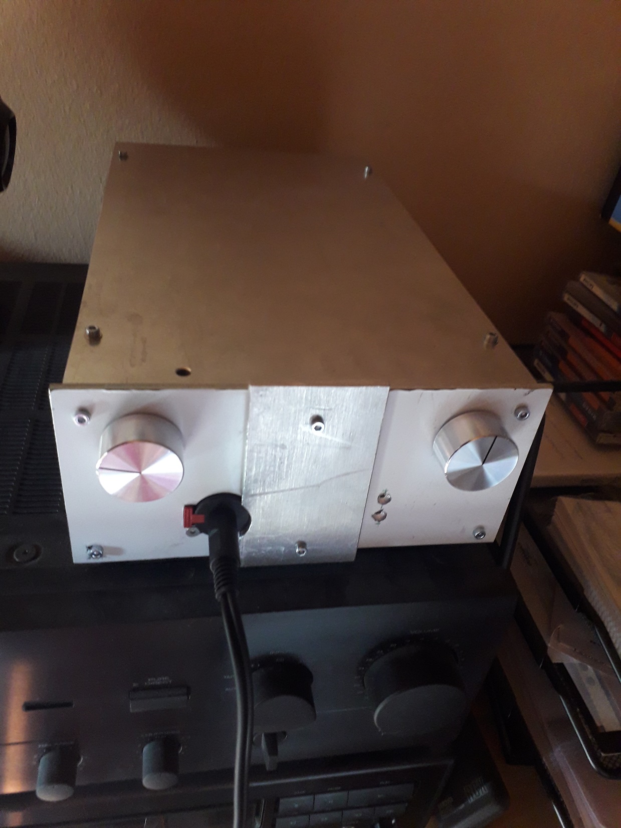

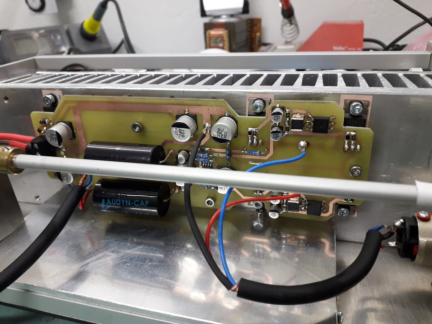

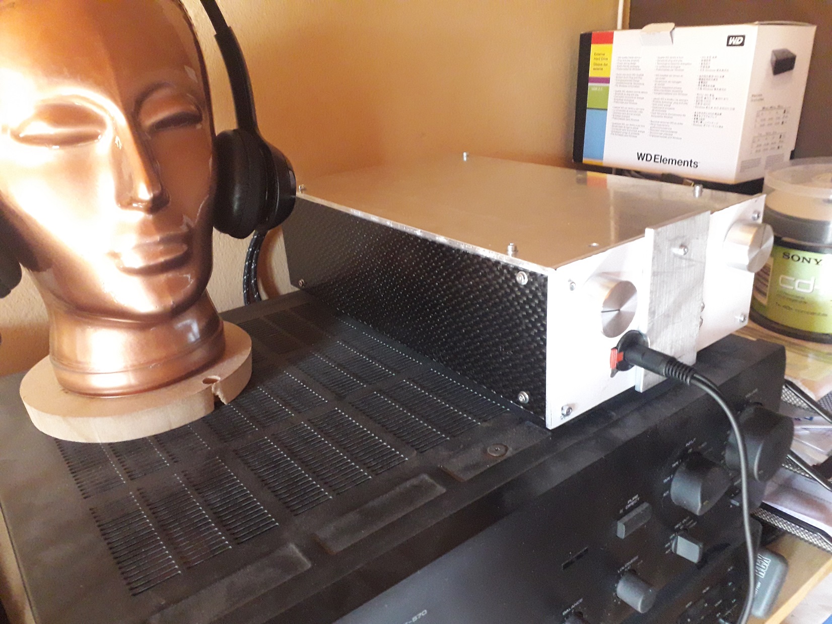

First SMD Whammy had some problems in Soundquality no way to find the reason.
So what to do?
Make a PCP redesign take it apart, put it together again and since some weeks it plays
A little painting is still to do but this can wait.

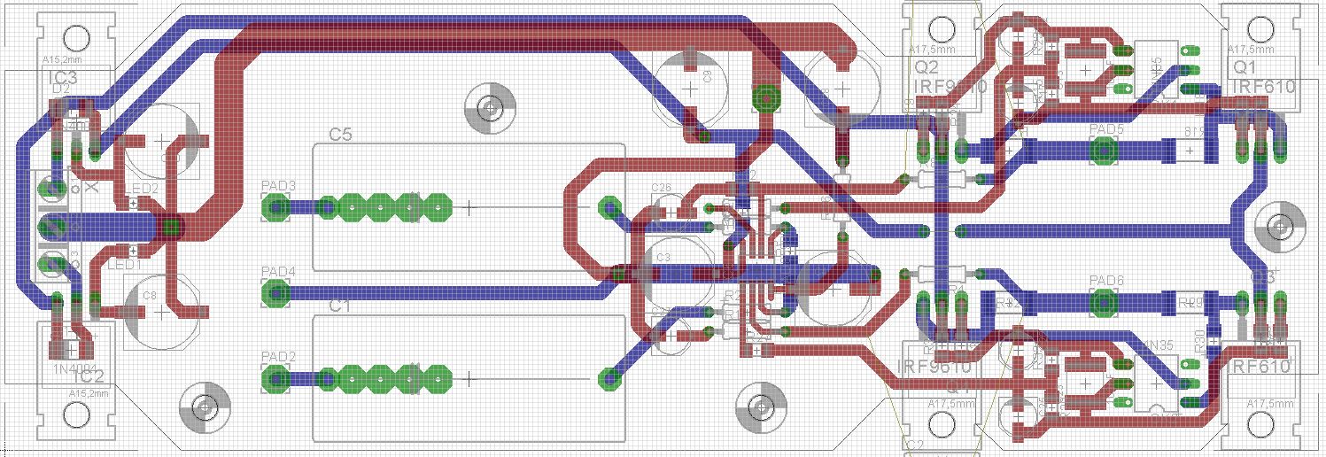

Wow, great looking board Danger Mouse! Any chance you can share a 1:1 pdf for etching? Is it single layer? I know everyone is into small order pcb fabrication these days (including me) but I still have a few bottles of FeCl in the garage and a 24"x24" sheet of FR4, photo paper and a laser printer from 2002 that does great toner transfers.
It is double Layer. I`ve done mine with toner transfer method.
If you are still interested i will share some PDF`s
