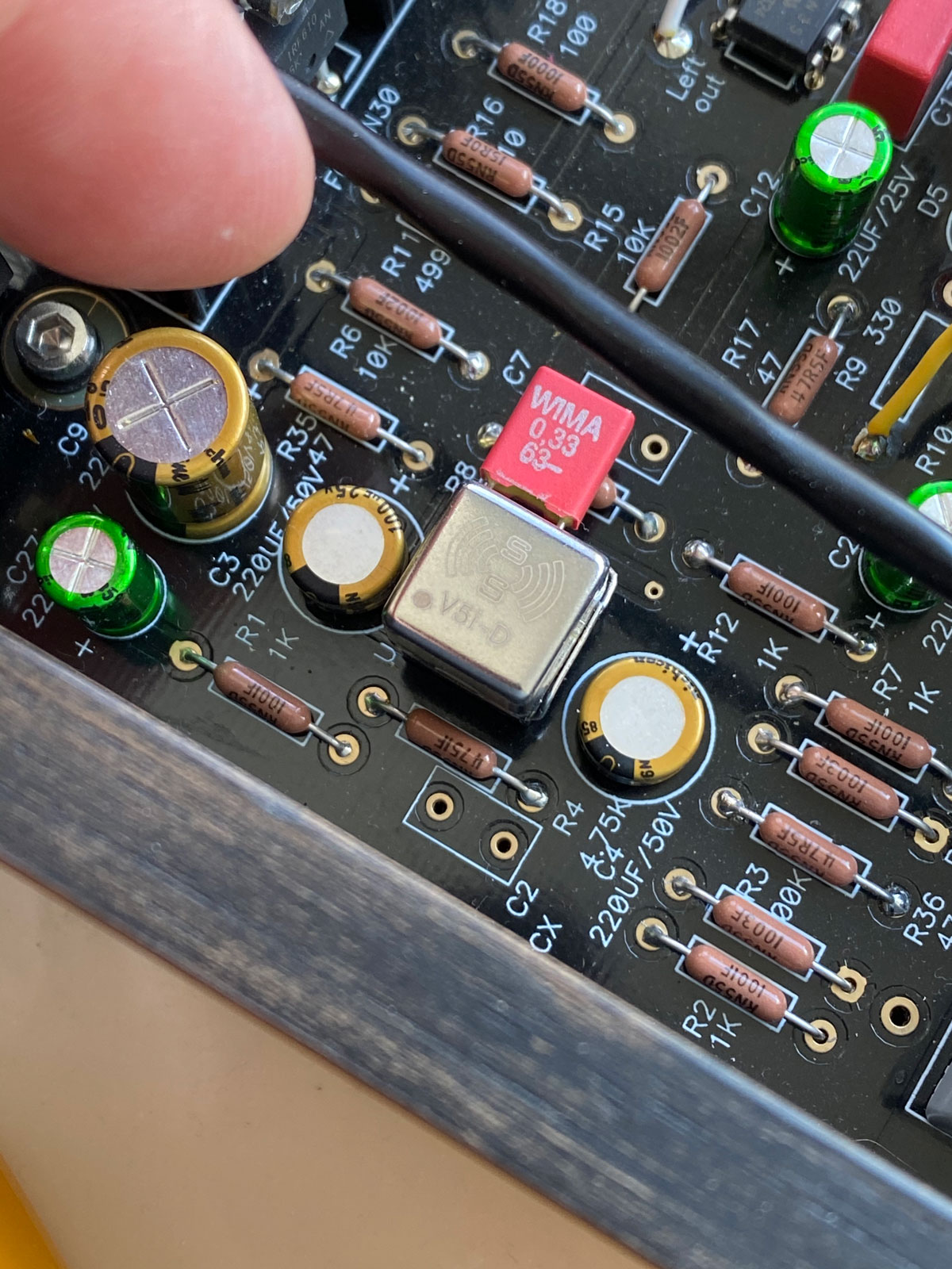

Well, you can also run naked regulators, right? Or is there an advantage on keeping the led ref circuit and then add transistor cap multiplier topology?
Let them run continuously for at least a week - the 'sound' improves dramatically.
If you haven't added the small caps directly to the chip's socket pins, suggest you do this.
For rails of +/-18V, you can add a simple transistor cap multiplier type circuit and drop a couple of volts or add a low dropout regulator in place of the series resistors to pull rails down to about +/- 15v.
This? (See pic) Love it since it's attached to the extra adapter (was in the V6 case) and therefore reversible for other rolling.
@advdesignguru has a couple of posts about this from back in Sept. (#2911). I happened to have the .33u on hand... 15.1VDC now... case is 12 degrees cooler... thanks for the awareness check @RafaPolit!
No comment on audio—first blush, no real change—but need to listen more of course.
Update: Temp on case of V5i came up to where it was before at the slightly higher, but debatably over juiced voltage... guess around 100F is normal?
Thank you actually, as if this works, it’s something I am willing to give a try.
Your temp is 100 F? That is really cool in my opinion. I thought you meant C! At 100F this thing should be cruising without a hiccup!
