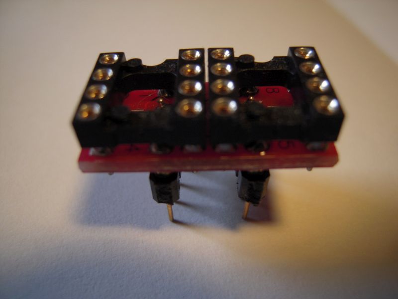

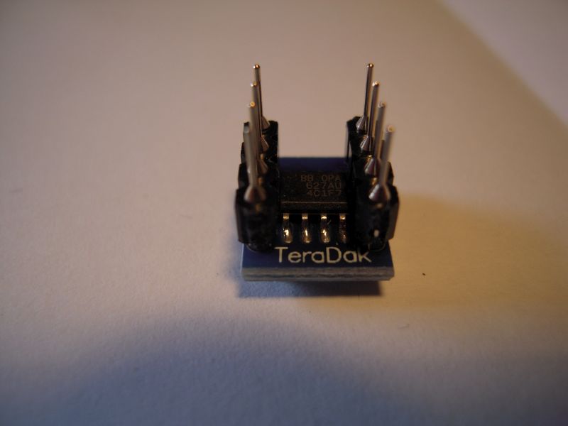

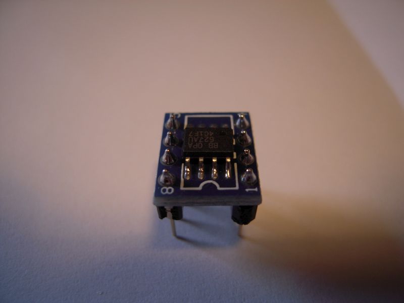

There are many adapters available:
- 2- single - opamps to dual - opamp
- SOIC8 to DIP8
and many more...
The problem is often the space around the opamp socket on the WHAMMY-pcb.
The caps byside the opamp will have to be bent away.
Sparkos Labs, Inc. SOIC to DIP adapter for surface mount applications
Single-to-Dual Op Amp Adapter - BrownDog Adapters - 021001
and many more....
Greets
Dirk 😀

The OPA627AP has only a single amplifier in it. The Whammy needs a dual amp chip.
Just to compound on this answer, in case there is need: the opamp implementation on this Whammy requires a dual op-amp that amplifies both channels. You have a single op-amp, so you have a full channel silent, as you have already figured out.
You just need to put in place a very basic dual opamp to check that all works, and then you can start swapping / rolling opamps.
I would suggest to try the LM833... something very basic! Then put on the more expensive parts.

sure you need two OPA627 (one for each channel) on a single-opamp-to-dual-opamp-adapter.
I did this. It is possible.

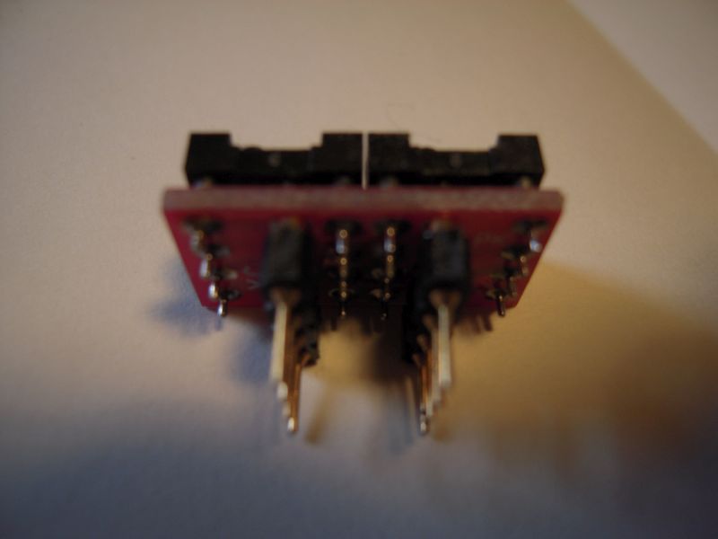

You can also implement two SOIC8-single opamps to a DIP8-dualopamp-socket.
One single opamp is on top of the mini-pcb, the other 'downside' or under deck.😉

I forgot these very nice adapters:
Sjostrom Audio - ADP01 ADP02 ADP03 ADP04 High End SMD to DIL adapters
