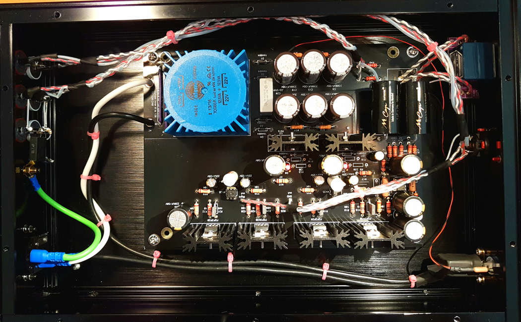

Another one in the wild. Bias set to 112mA. 2SK2013/2SJ313 output devices. LM4562. Sounds awesome, thanks Wayne!

Great builds here and lot of knowledge. I see some of you are using Audio grade capacitors for C1 and C5. Is this a good alternative to C1 and C5 capacitors?
Mundorf 1mfd EVO Oil Capacitor
The Mundorfs would work just fine. I used Clarity 1 uF and a Vishay/BC 1uF PP
that fits right in. They both worked fine.

will there be a big difference if he will fit lm317 and lm337 instead of 7915 and 7815 because they are better?
LM317/337 have a different pinout and will not fit.

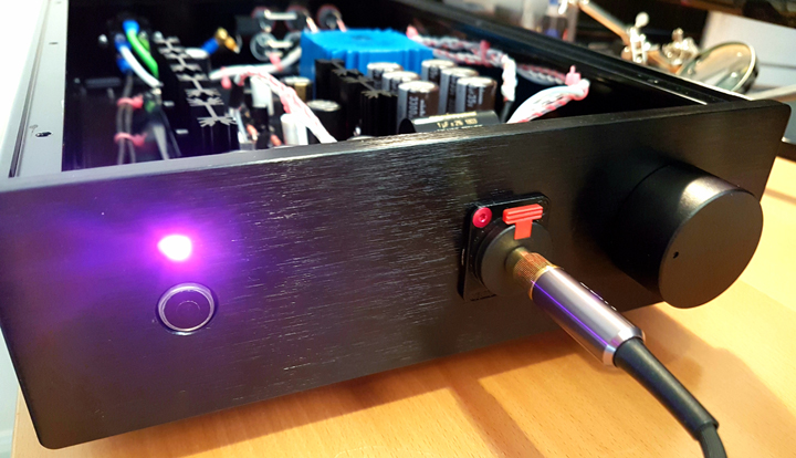

Here is my first Pass amp, learned a lot here. I've tried a few OPAs and finally settled with AD823 so far, will try OPA627 X 2 soon, this amp sounds amazing 🙂
Ok but adapting to an external card is not improving compared to the simple 7815 and 7915?
Considering how low the ripple is from the passive filtering, it's doubtful the 317/337 would be much improvement.
However, It would be interesting to know for sure and very easy to implement. Give it a try!
