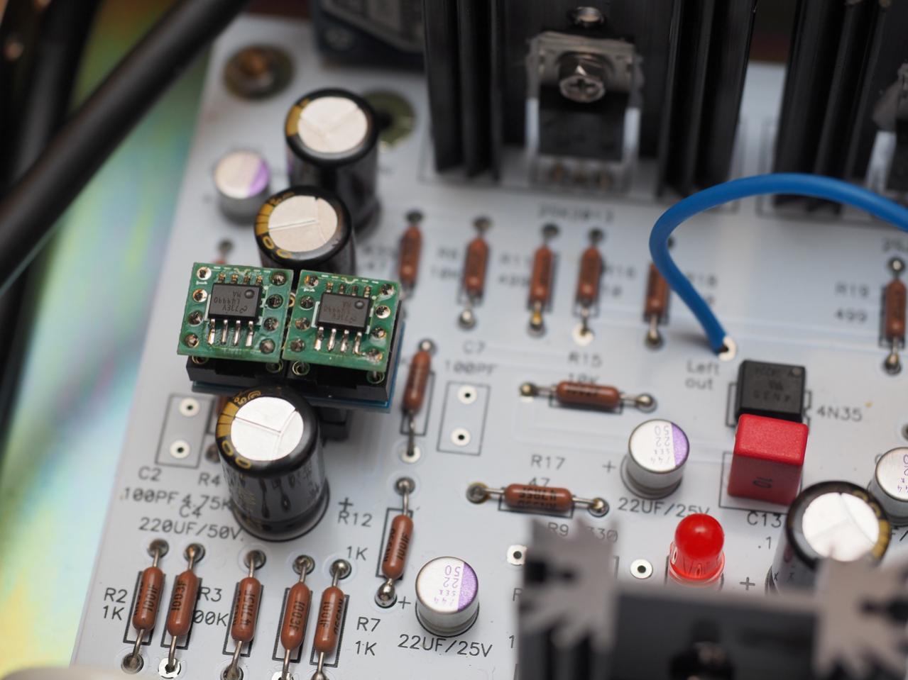

I also tried op amp rolling with LM833, MUSES 8920D, AD823 and LME49990.
Listening with 2 headphones: SONY MDR CD900ST and Philips SHP 9500.
Source: iMac with BitPerfect and Schiit Modi 2 Uber DAC.
LM833:
Balanced treble, mid and bass. Bass is punch and assertive. Maybe not sound detail as other op amp but good enough to enjoy the music for me. If you don’t have idea what to use, LM833 definitely worth to try.

What adapters are you using for the opamps? It’s nice to see they can all fit between the caps.
I have a pair of AD8620s in my Arcam 5 CD player @15v.... they have survived for the last 5 years, and sound fabulous.0.2V offset is quite a lot, are you sure that's not a typo?
AD8620 is a great sounding opamp, but just remember that it's only rated for +/-13V supplies 😀
Great observations! Thanks for posting them. 🙂
What Mosfet are you using?
I use FQP3N30 / FQP3P20.
I bought these adapters online in Taiwan.
The SOIC to DIP8 is less then USD$ 1. The foot print is just slightly bigger than a DIP8 IC.

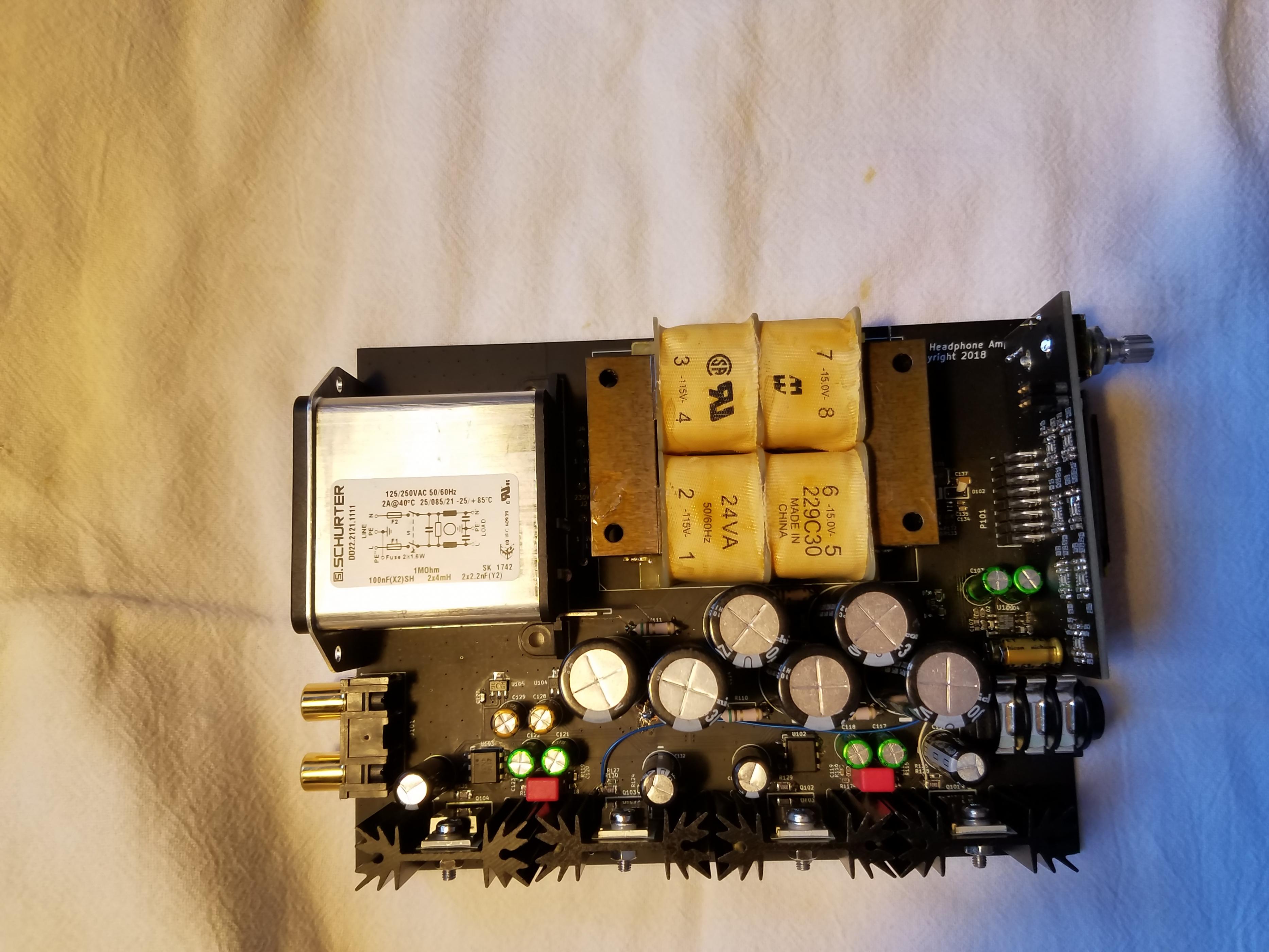

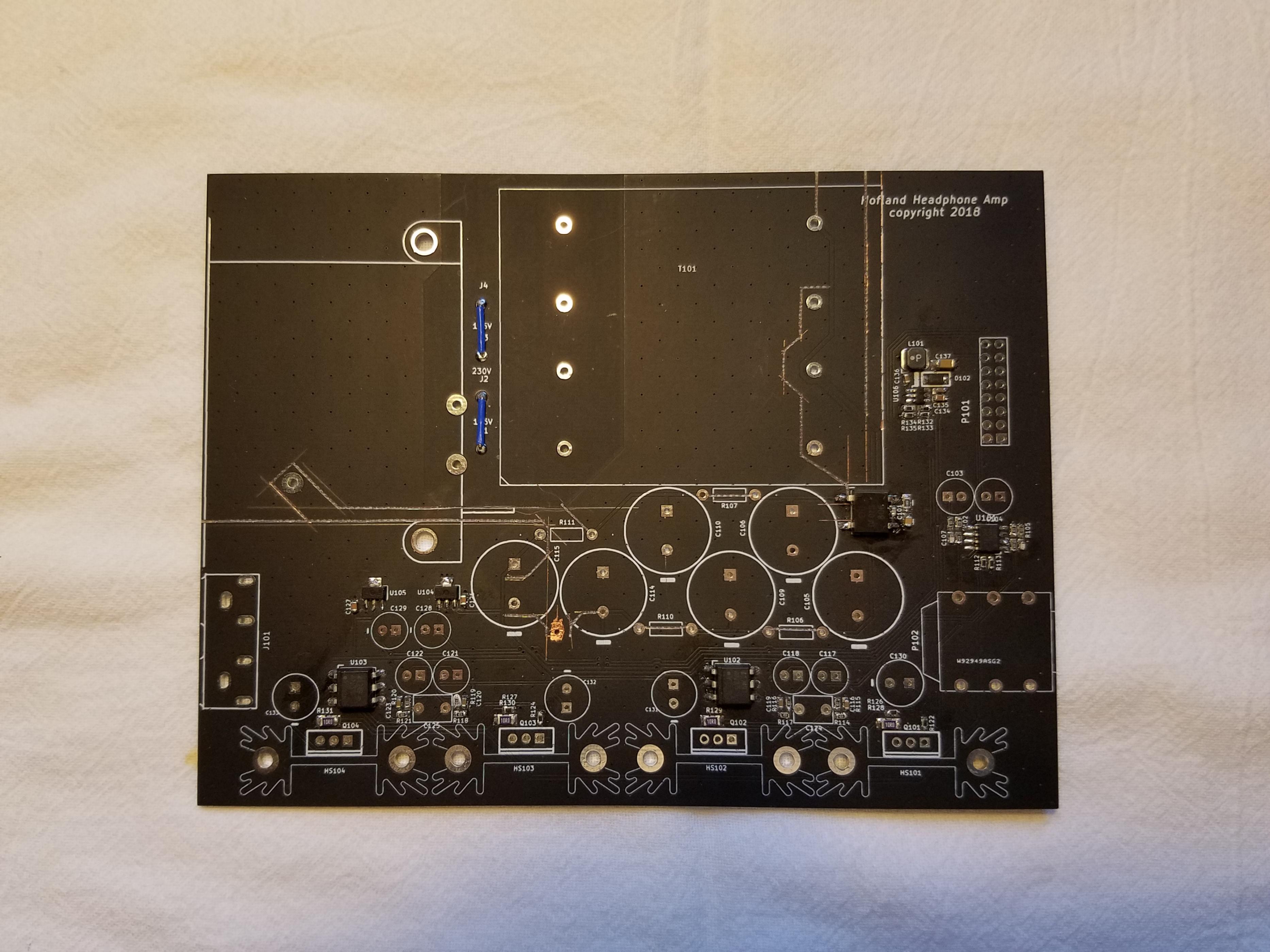

I've been following the thread for this design with quite a bit of interest. I'm also in the process of building a stepped attenuator for volume control and this seemed to be a fine vehicle to use to test it out. I was also interested in making it a bit smaller. I made the following changes to the design.
Changed the supply voltage for the output MOSFETs to use the unregulated rails. This allows the regulators to be quite a bit smaller and you don't need to heatsink them. The +/- regulated voltage is used on the resistor network driving the gates and for the op amp rails.
I chose to use surface mount parts where it's reasonable to do so to save space.
All of the input and output connectors are board mounted so there isn't any wiring to do.
The power transformer is a Hammond low profile 229 series unit.
There is an added DC/DC converter circuit to provide 3.3V for the attenuator.
The resulting schematic is attached.

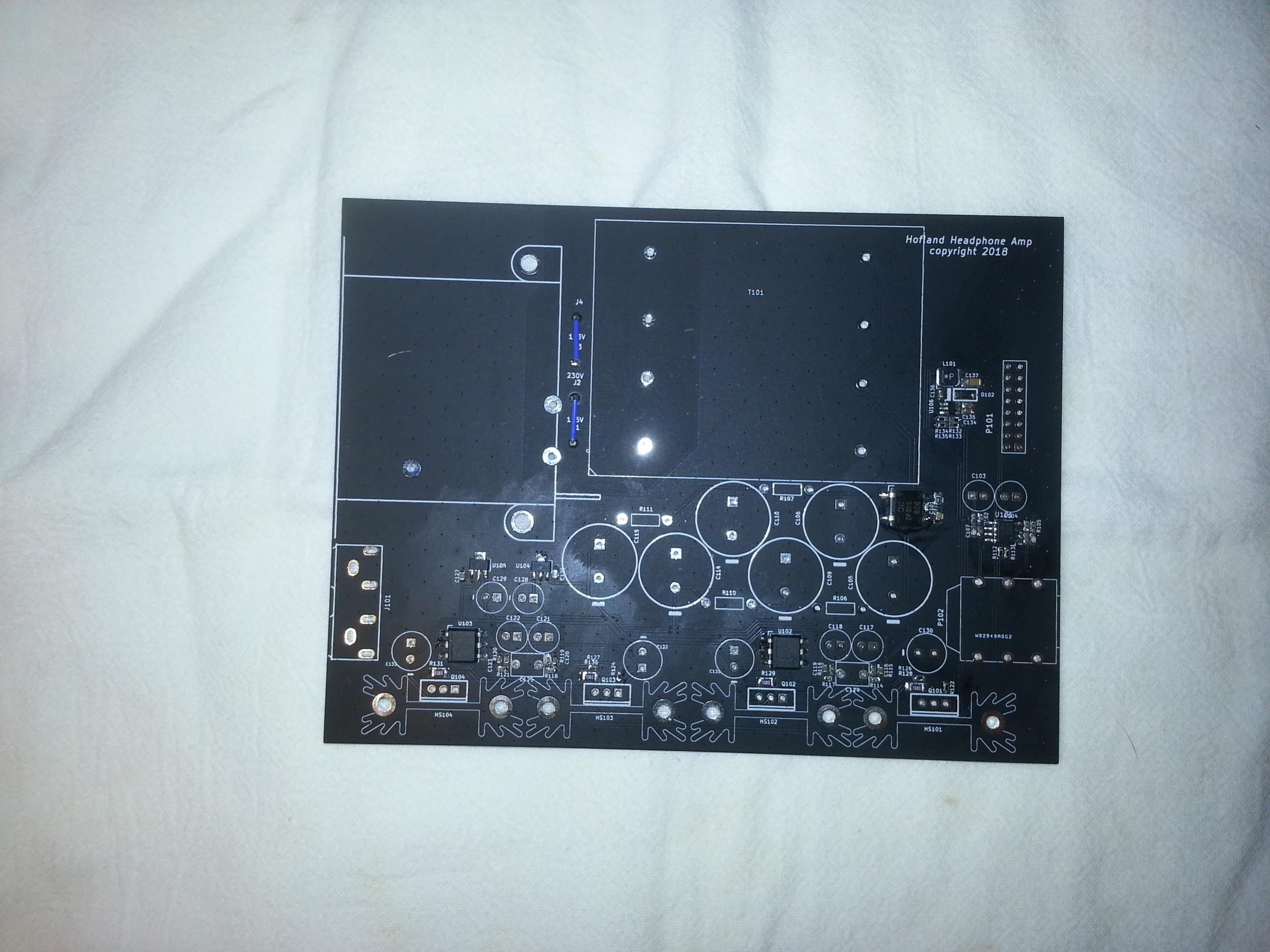

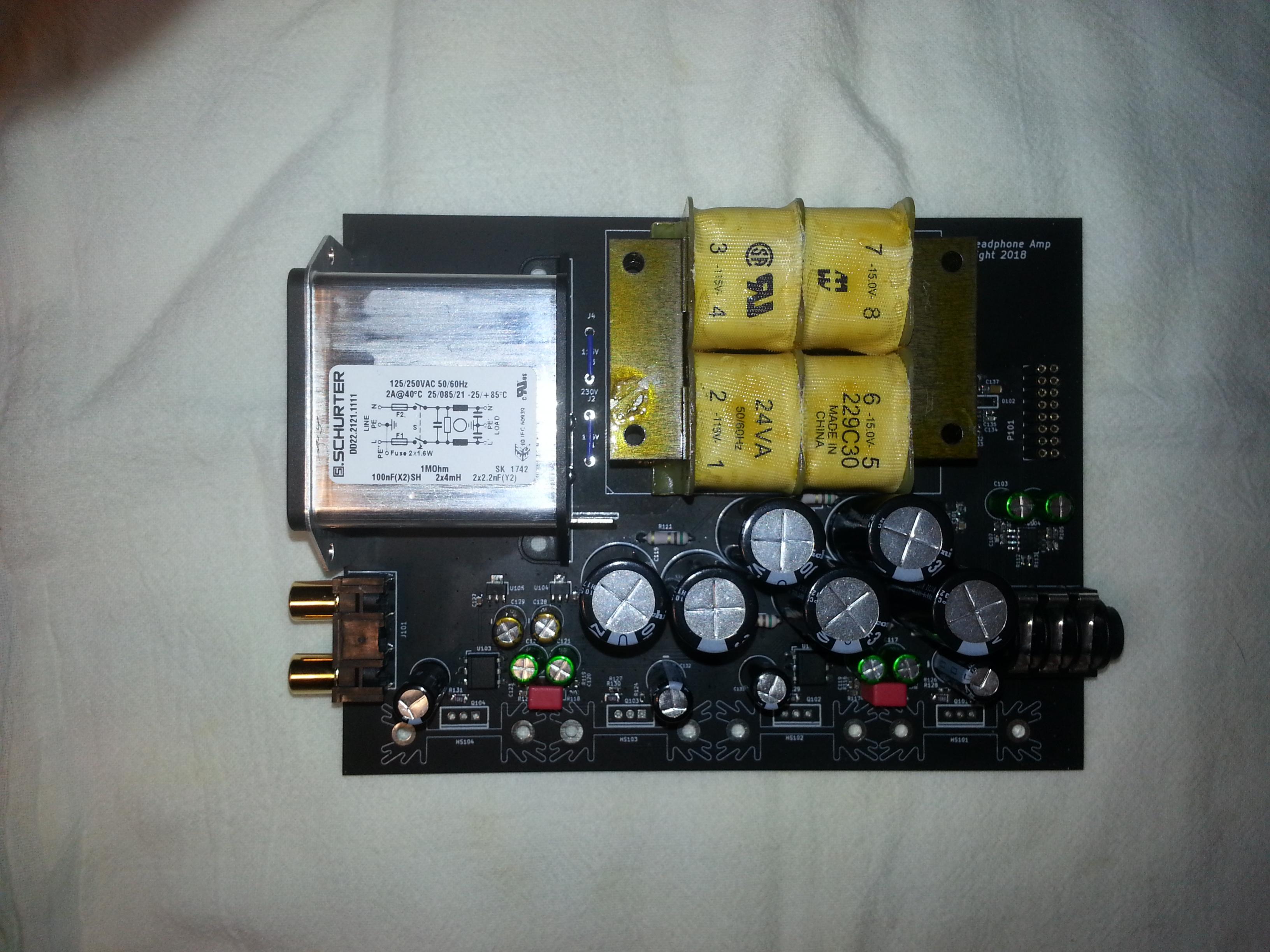

When I first turned the board on I had ground loop noise issues. So I hand modified the board a bit to pick a virtual star ground point at the power supply output and reroute the output ground, the power input module common, and the low level stuff to that point. It quieted things down quite a bit.
Pictures of the board with the surface mount components in place before and after the ground changes are attached.
The next picture is of the board with most of the through hole parts loaded.
The last two pictures are of the board fully populated and in the chassis.
The board dimensions are 120mm by 160mm and it fits into the same sized Hammond 1455 series box. That's about half the size of the original WHAMMY.
I did run into an oscillation issue. The first version of the design had some 220pF caps in parallel with the 4.64K feedback resistors. Seemed to be the right thing to do to limit the bandwidth. Both channels oscillated at about 16 MHz, 500mV amplitude. I ran a circuit simulation and discovered some gain peaking well above 1 MHz. The solution turned out to be removal of the 220pF caps. Thanks to Wayne and Jim for suggestions on where to look.
I'm still working on the control firmware for the stepped attenuator so I haven't put a signal through it. It is quiet with no signal input. DC offset is a bit more than 1mV left channel and less than 2mV right channel.
